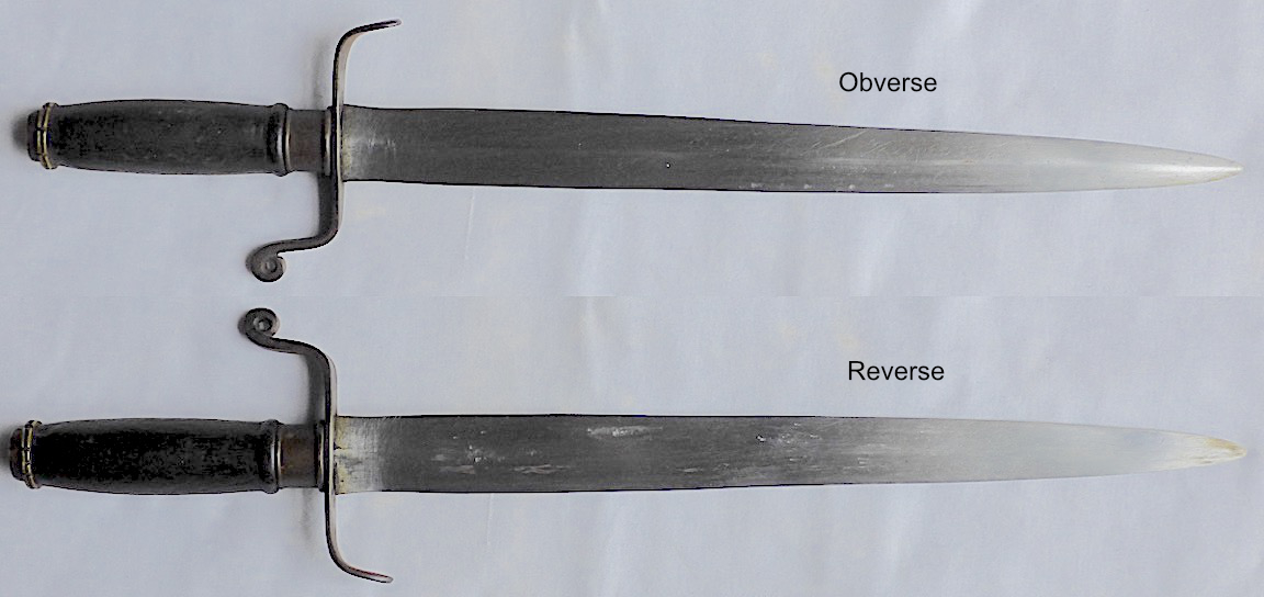

Default Luzon or Panay?

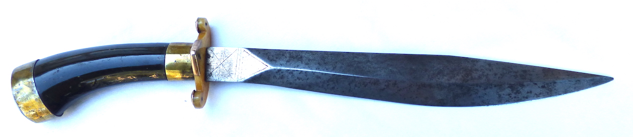

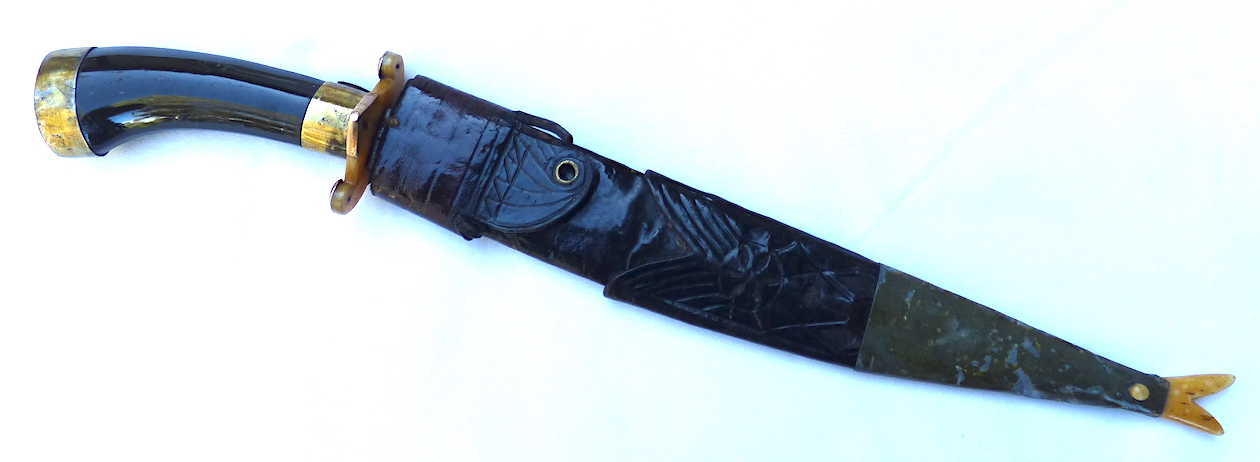

The overall style of this knife seems Luzon but lack of peen, chisel grind, and leather scabbard throat are all common Visayan features. Ferule is brass, guard is copper. OAL 16" with 12" blade.
Old 14th December 2024, 11:19 AM   #2
Posts: 9,769
Hi Jeff,
Nice long dagger you show us! And I can understand your question, I am not really sure as well! But I am sure that I have seen similar ones before.
Old 14th December 2024, 01:05 PM   #3
chmorshuutz
chmorshuutz's Avatar
Join Date: Jul 2021
Posts: 58
I'll lean towards Panay. It looks similar to those from Iloilo or Antique province, though not certain about the blade profile.

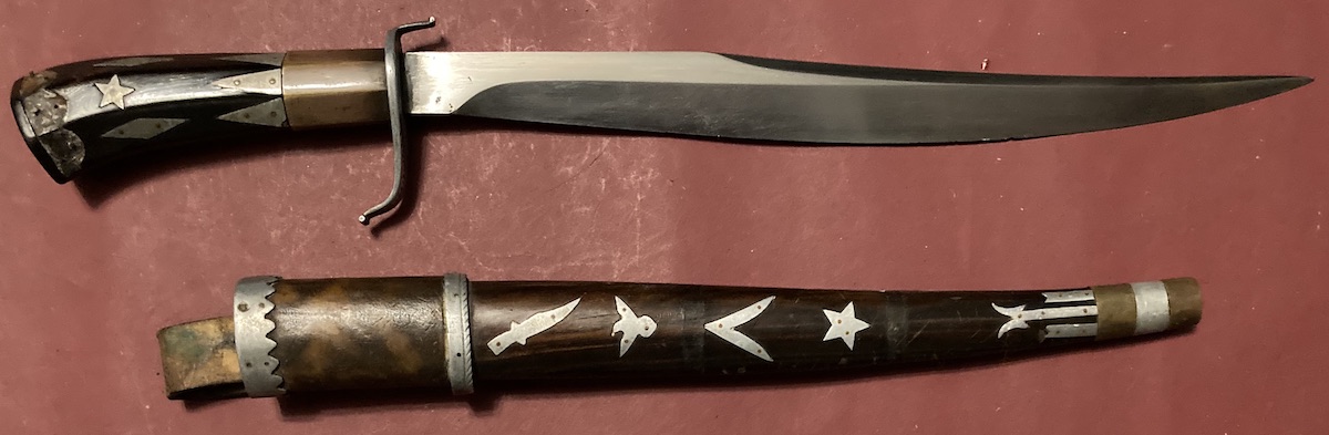

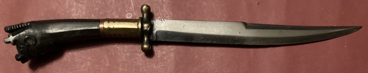

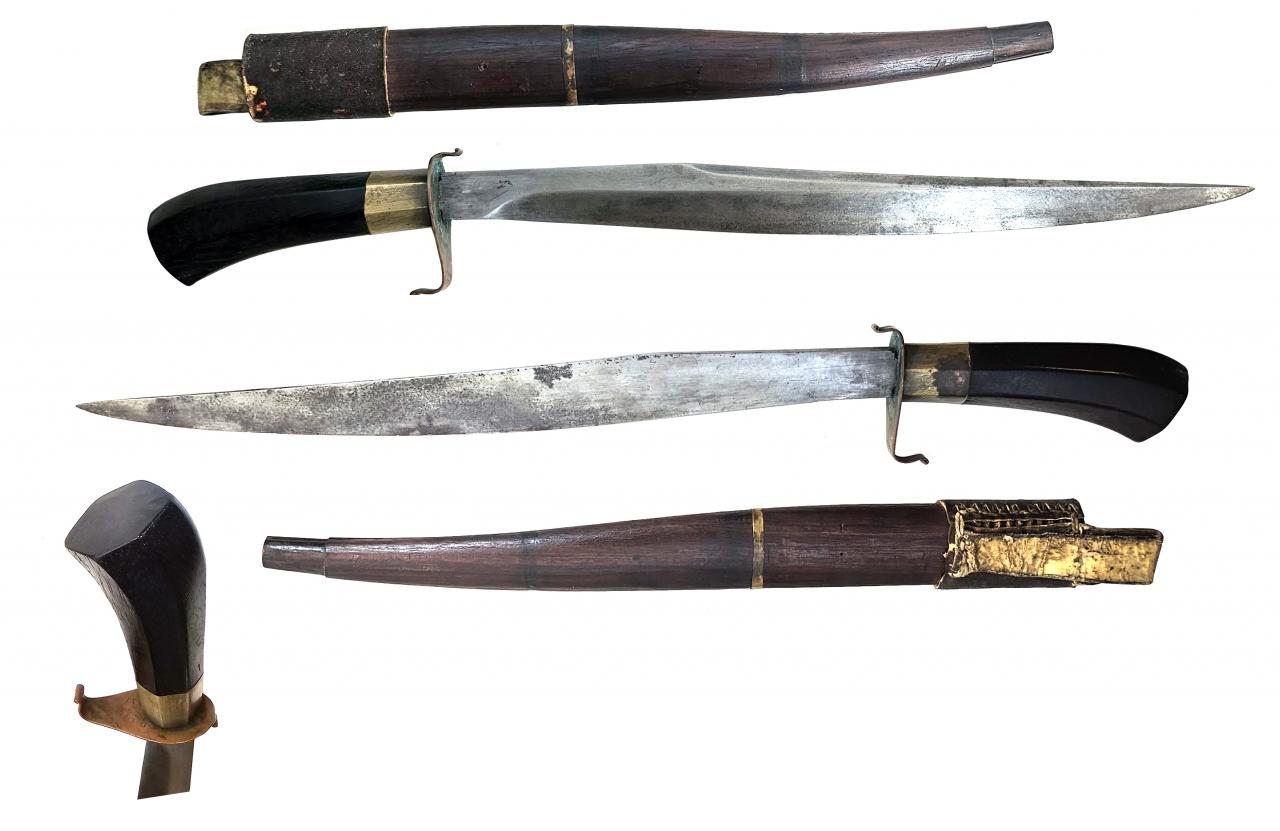

Default Will This Help?
Hi All,
My example is probably newer but perhaps it will help with origin.
Specs: 9.875" Girunting Blade, Dark brown wood hilt with aluminum inlay (pommel inlay missing), Brass ferrule and ”S” shaped aluminum cross guard, Wood sheath with aluminum inlay, aluminum and leather throat, Brass and aluminum chape.
Sincerely,
RobT

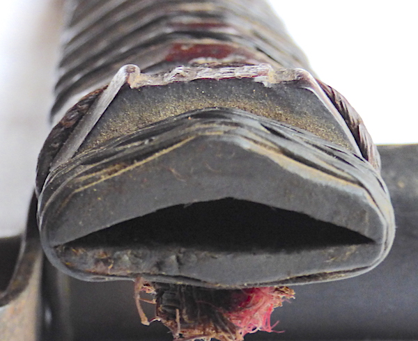

Hi Rob,
Does your example have a full length tang? There seems to be a plate at the end of the hilt.

Hi All,
Sincerely,
RobT
Shows this is a style vs odd ball since I agree my example seems older. I was curious how the round chape would look, great to see one intact.

Hi Ian,
It is a blind tang. What you are seeing as plate is actually the end of the wood hilt. It looks like a plate because it stands proud of the shallow cut outs for the missing (presumably aluminum) pommel ornaments.
Hi JeffS,
Yes, given the close similarity of the two pieces in blade, hilt, and sheath, it appears to be a type and not just a one off. It is the only Philippine "Bowie style" blade in my collection with a chisel grind. It makes me wonder even more strongly if the Philippine "Bowie" wasn't developed in the Philippines independently of the US Bowie style. The two clip points differ markedly with the Philippine clip point being far longer than the US version. Is it possible that the Philippine clip point was already in existence prior to WWII and just found favor with US service men because they were used to the clip point form?
Sincerely,
RobT

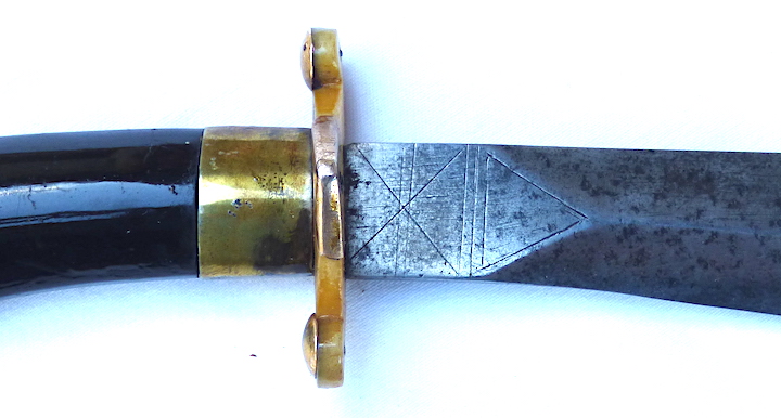

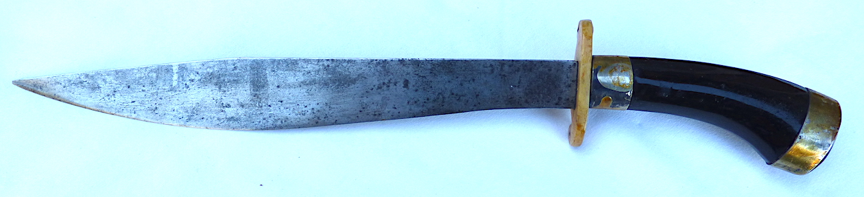

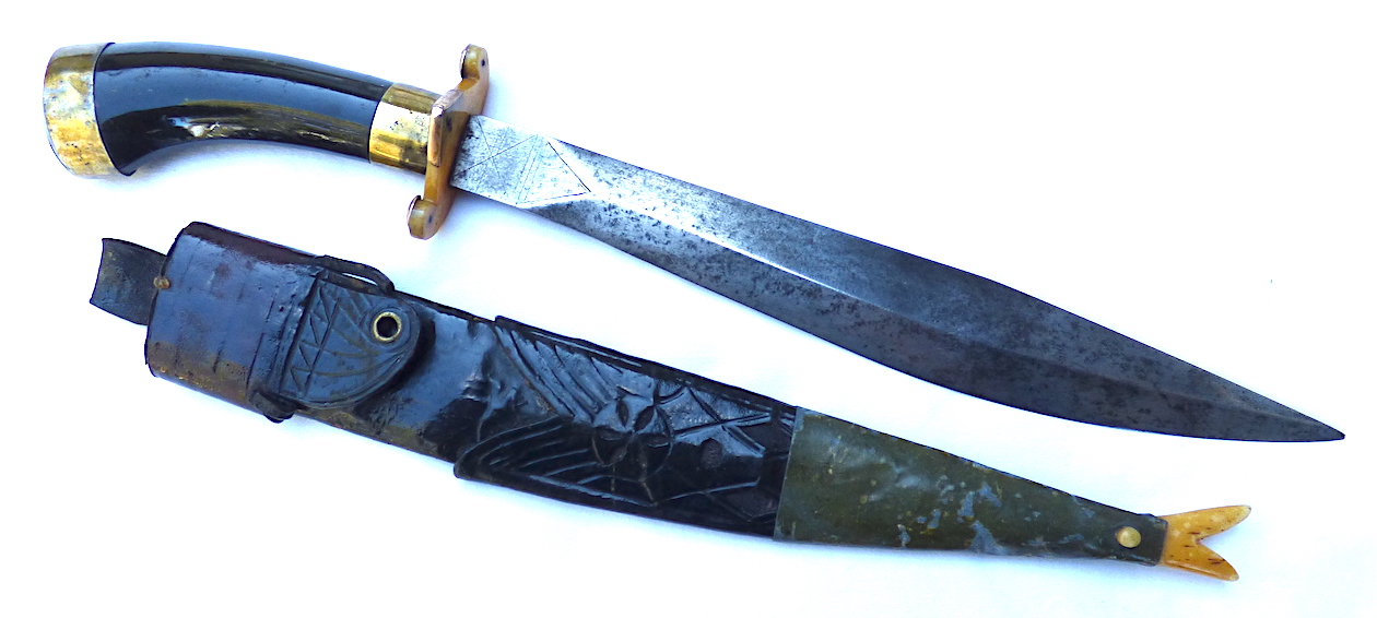

Posts: 4,722

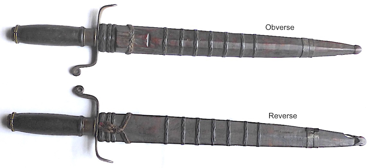

Rob, this one may be more convincing. It is a Spanish-Filipino knife with a blade of triangular cross-section. There is a small bone guard tipped with brass. The tang does not extend to the end of the hilt. It may have been made in the Visayas. Being from the Spanish Colonial period in the Philippines, it would pre-date 1900.
Blade length = 8.5 in.
OAL = 12.5 in.
I'm still looking through my collection.
Ian.

Actually, not just very convincing, completely convincing if the age estimate is correct. I am posting a knife in my collection that has a nodding similarity to yours but that I had always assumed was post WWII. The blade length of mine (8.625”), is similar to yours but the OAL (14.5”) is greater than yours due to the Janus head pommel. No Sheath. Could it be that mine is a lot older than I thought? Both of our knives check all the Bowie boxes and the chisel grinds indicate that they weren't just a bespoke blades made by a Filipino smith following the instructions of a European or US client but rather a knife type that had been absorbed into the northern Philippine culture. Could the triangle at the base of the blade on yours perhaps point toward a Philippine independence group? That would further cement the 19th century date. I would love to see any other examples you (or anyone else) may have.

Thanks for the comments Rob. Yes, this does seem to be a recognized style of Philippines knife. Triangular cross-section blades are also found on swords. I have one from roughly the same period that has an inscription, Recuerdo Republicano, at forte. There was some debate about what this actually meant, but the consensus was it probably stood for "Recuerdo el Republicano," or Remember the Republican. So there may be a link to the Katipuneros. The marks on the ricasso of the knife above are not specific to the Katipunan or the Philippines revolution AFAIK.
Blades of triangular cross-section were probably made in Manila and surrounding provinces during the Spanish era. I have nothing specific to point to for this notion, other than it was the major area of Spanish concentration and the nice knife I show above likely would have belonged to a rich Spaniard or perhaps a rich Mestizzo. The yellow metal areas appear to be gilded.
The blade on that knife is pretty convincing for being about 100+ years old. It has a nice patina and the "spidery" marks of an old high carbon steel blade.

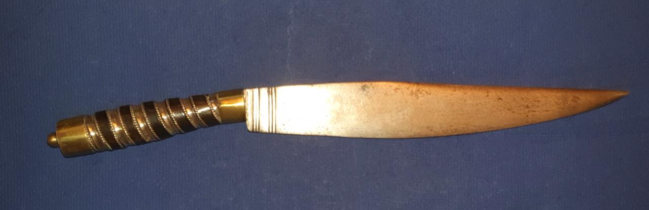

Here is another Spanish colonial knife from the Philippines. Unfortunately, the blade has been polished to mirror brightness by a previous owner. I don't think you would call this a "Bowie" but it does have a fairly large blade of about 10.5 in. and a guard. There is an unsharpened false edge along the distal part of the blade's spine.

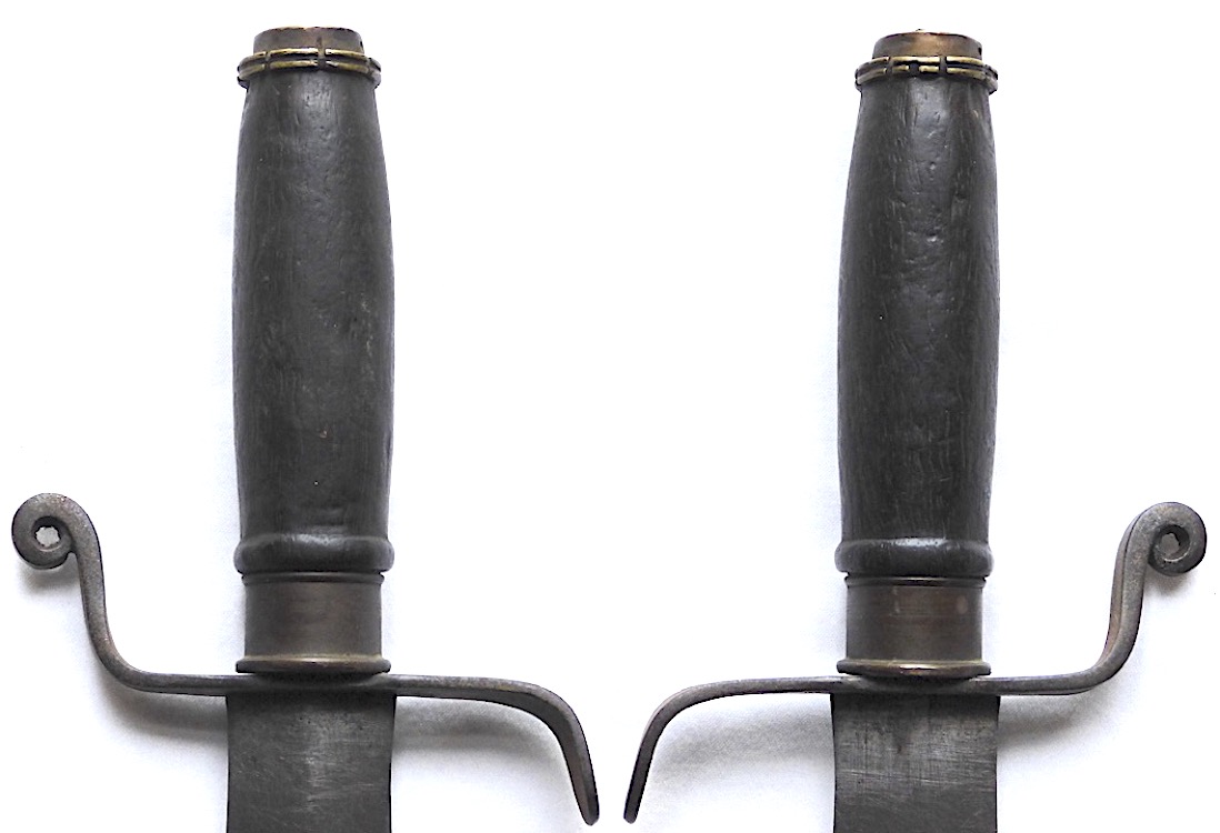

And a straight version of the triangular cross-section blade. This one appears to have some age. I would say WWII era, perhaps a little earlier. Despite having a symmetrical double-edged blade, it has an asymmetrical S-guard. OAL out of scabbard is about 15.75 in.

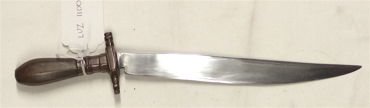

Ran across another from the Lew Waldman collection hosted on this site, posted as reference.
