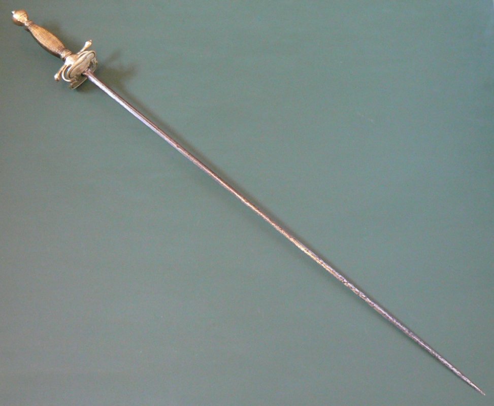

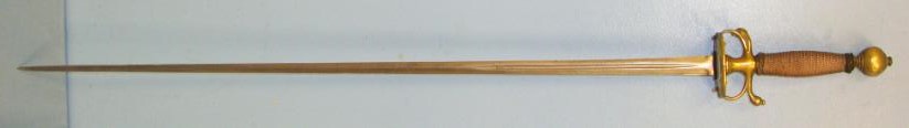

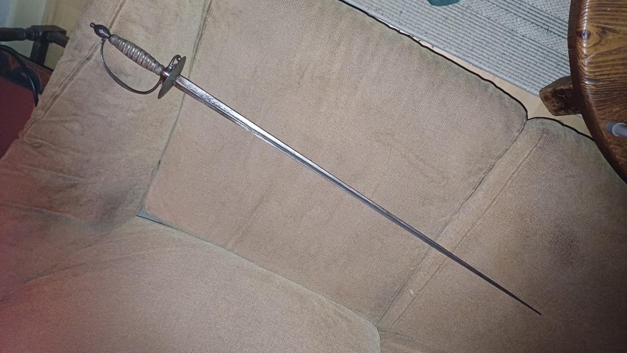

Hello everyone,
after years of lurking and passively learning from you all, I figured it would not be a bad idea to become a more productive member of this society (or that's the hope, at least).
So for my first post I just wanted to share two small swords I own, which share a lot of characteristics, in terms of measurements and feel, though not necessarily in style. The handling similarity is so striking, I now tend to think about them as a pair, though they most definitely are not, and were not even bought together.
Anyway this is my introduction post. Happy to be here, and happy to hear your thoughts on these two pieces.
Here they are in full.
The bivalve guard one is 107 cm long and weighs 505 grams
The one with the disc guard is 106,5 cm long and weighs 496 grams
The hilts are very similar in size, thought there are obvious differences, with the bivalve one being more stocky and with shorter quillons, while the other one has more thin quillins that protrude further.

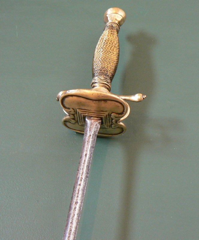

Another difference is in the shape of the quillon blocks. One is more blocky and angular, the other more rounded.
As mentioned the guards are different in both shape and decoration (or lack thereof)

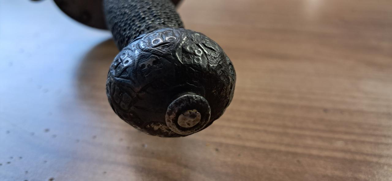

Pommels are both round-ish, with one being pierced to match the decorations on the guard shells, and the other being solid, but decorated

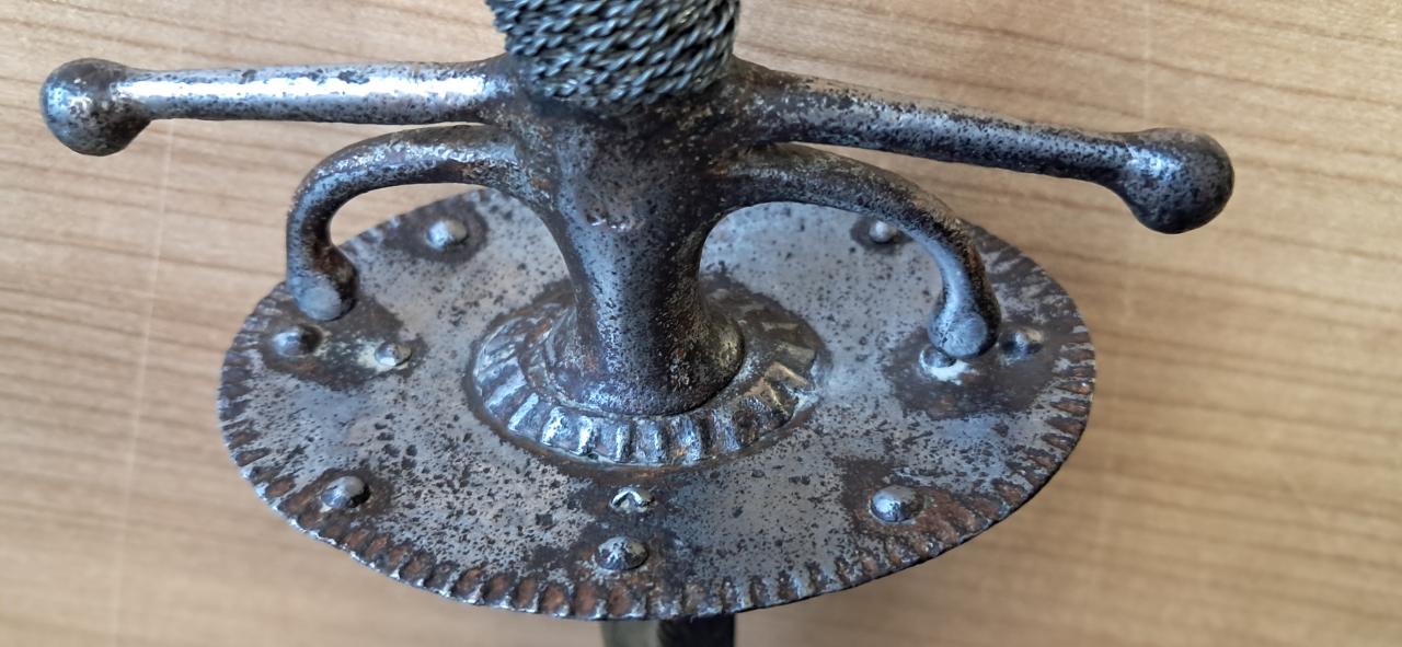

But the owner of the disc hilted one was not a total minimalist, and did seem to enjoy some basic decoration on the other side of the guard.

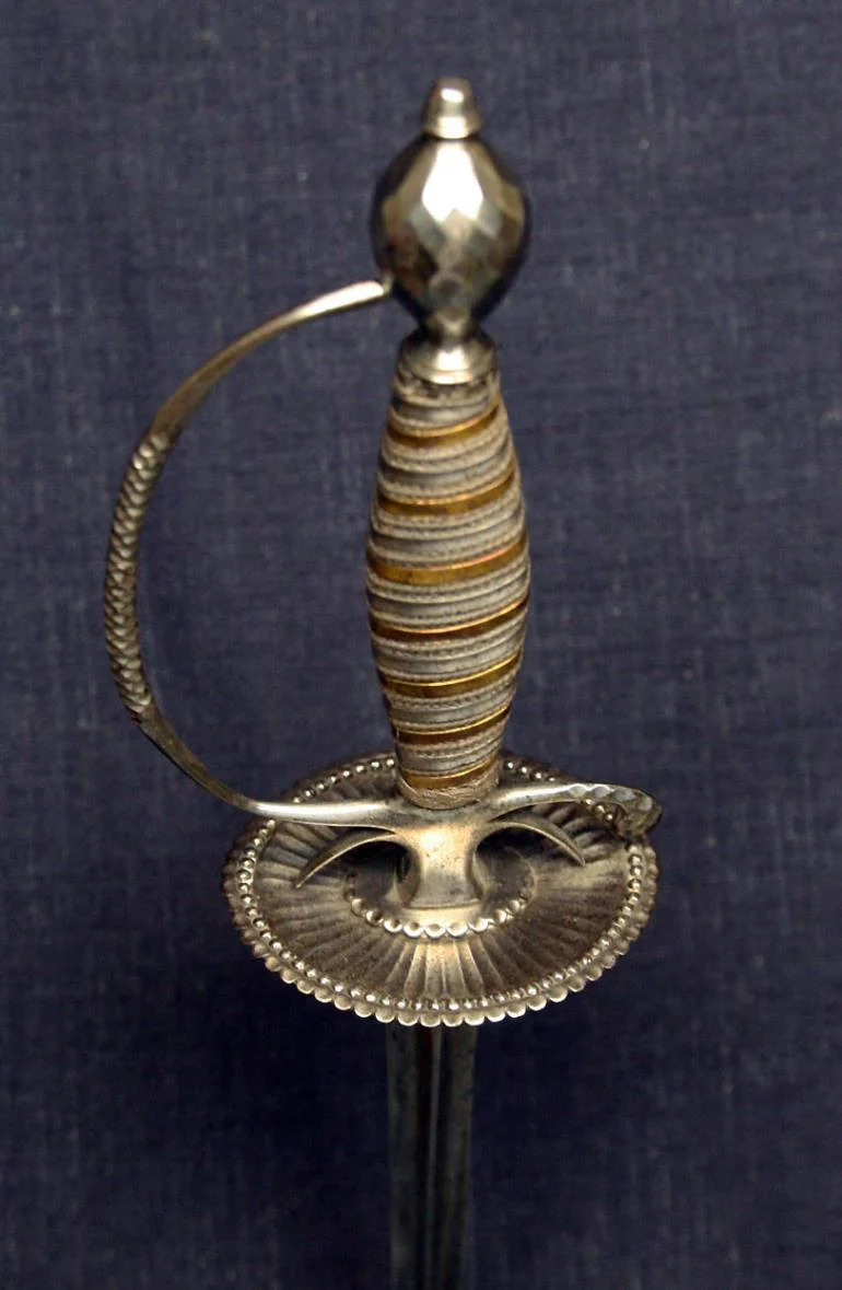

The relatively wide globular pommel style and wide pas d'ânes on both of these look to me like a 17th century style, and that matches the blade cross section and relatively long blade length, and while I'm not sure, most of the smallswords I've seen without a knuckle guard are also 17th c... But the disk guard looks more like 18th century (specifically it reminds me of some cut steel ones, see attached: not mine, ca 1780 - though that may just be a superficial resemblance), and of course clearly the wire has been replaced and the pas d'âne rings don't quite reach the guard. Could that disc be an old replacement?

Jelle, your considerations match what I have been thinking almost perfectly. As far as I can tell, most of the characteristics on these two point to 17th century early small swords, but the disk guard is certainly a bit puzzling.
The peen does seem to be less patinated than the rest of the pommel, so it's definitely possible there was a re-hilting at some point whether to change the blade or simply to change the guard I do not know.
As for the guard, It has been cleaned together with the rest of the hilt, so any consistency between parts is possibly misleading.
I get what you mean by its resemblance to cut steel, but the decorative buttons on this one are not faceted, or very crudely, if so. Also, they are not "riveted" in place through the baseplate as most of the cut steel studs I am aware of.
For this one I am leaning towards a generally 17th century piece with a guard that was substituted at some point between the appearance of disk guards and the rise of the cut steel trend, so maybe mid 18th century?
Of course it could very well be a "poor man's" attempt at cut steel, as far as I can speculate.
As for the timing of the rework, I have the feeling it is of the time, as the sword feels consistent and usable, and is strikingly similar to the other, more age appropriate one. This makes me think that the change was not done to simply assemble random pieces for display, but rather as an "upgrade" to a sword that kept usability and overall ergonomics and geometry in mind.

I'd agree on the features, especially the bivalve one, being C17th. The work on the quillon block on the bivalve one is quite crude though, in form and finish. Replacement?
