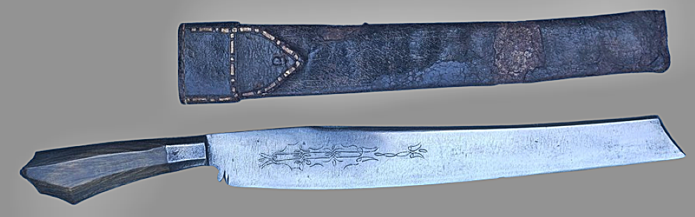

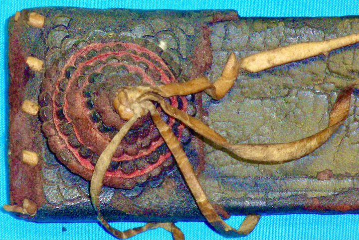

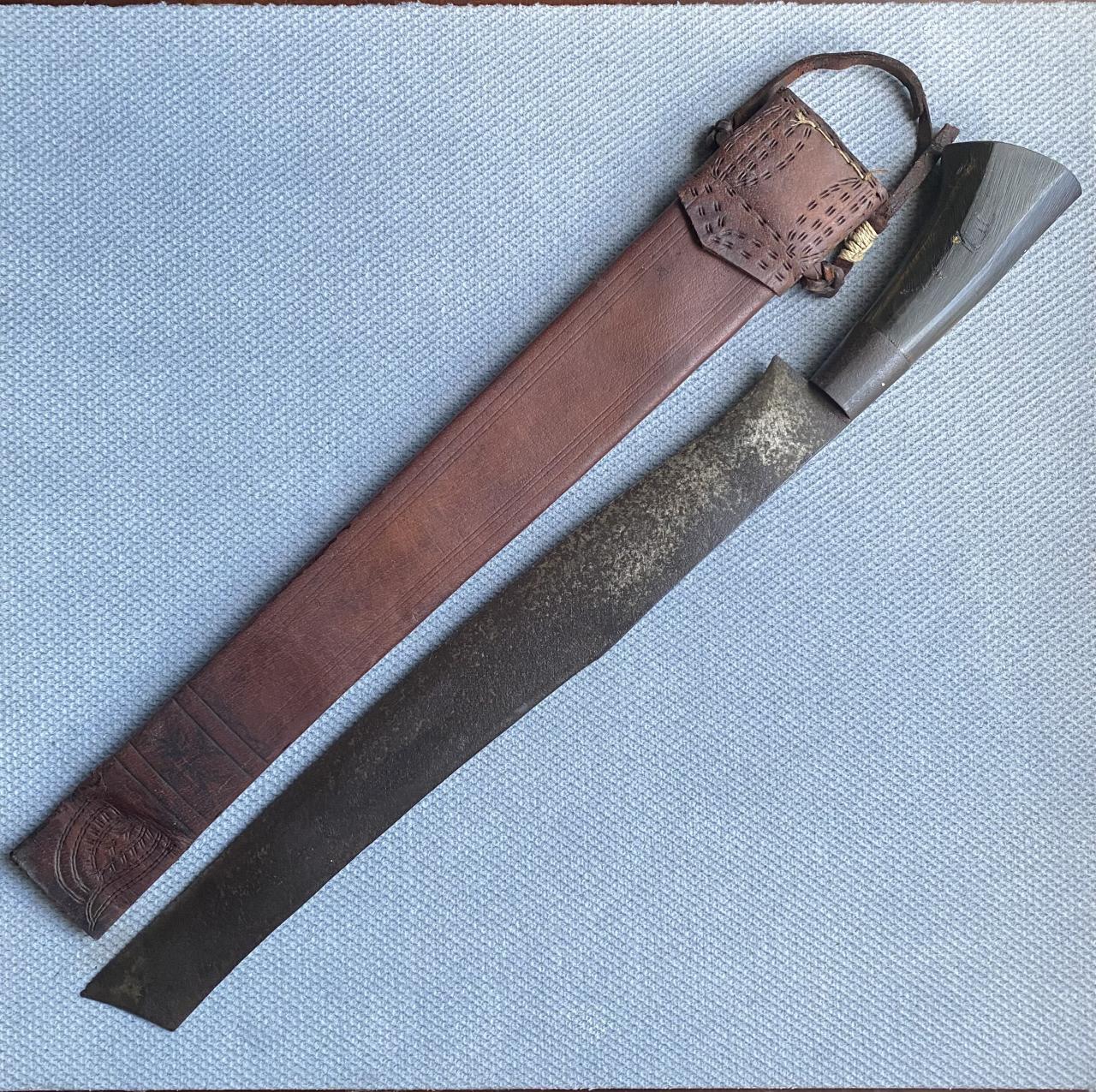

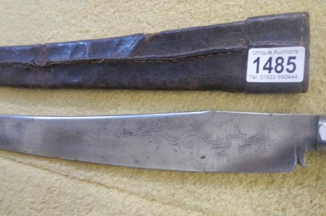

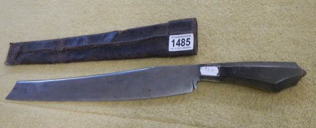

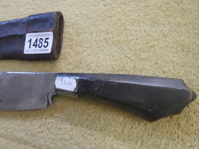

This bolo from Luzon will enter the collection. It's 49 cm inside scabbard.
Pangasinan?
All comments are welcome!
Old 20th September 2024, 08:59 PM   #2

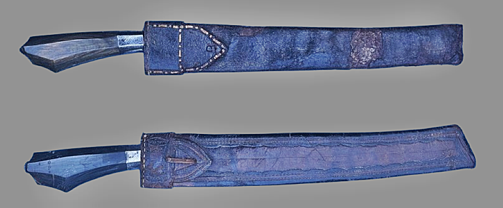

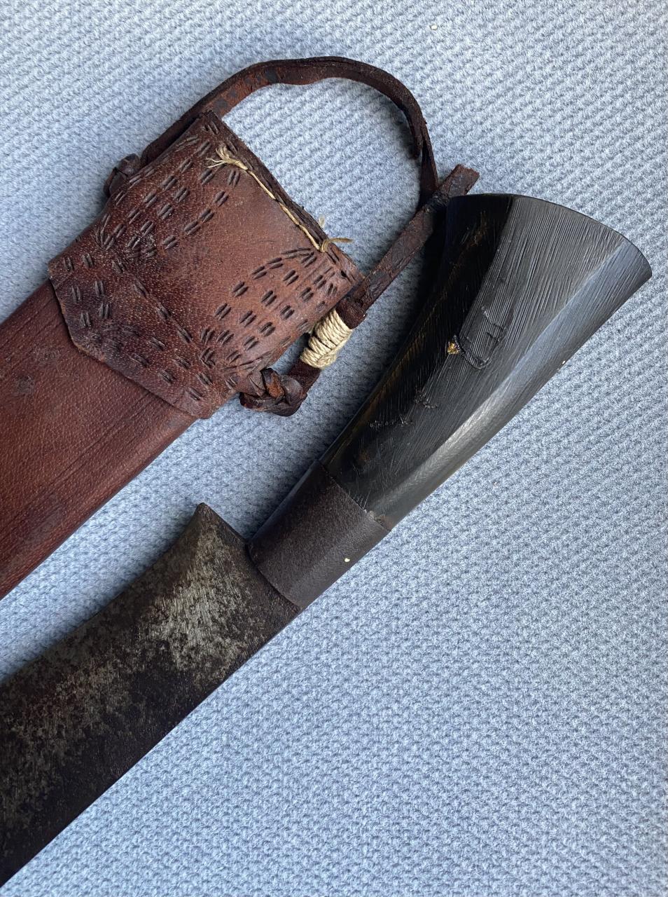

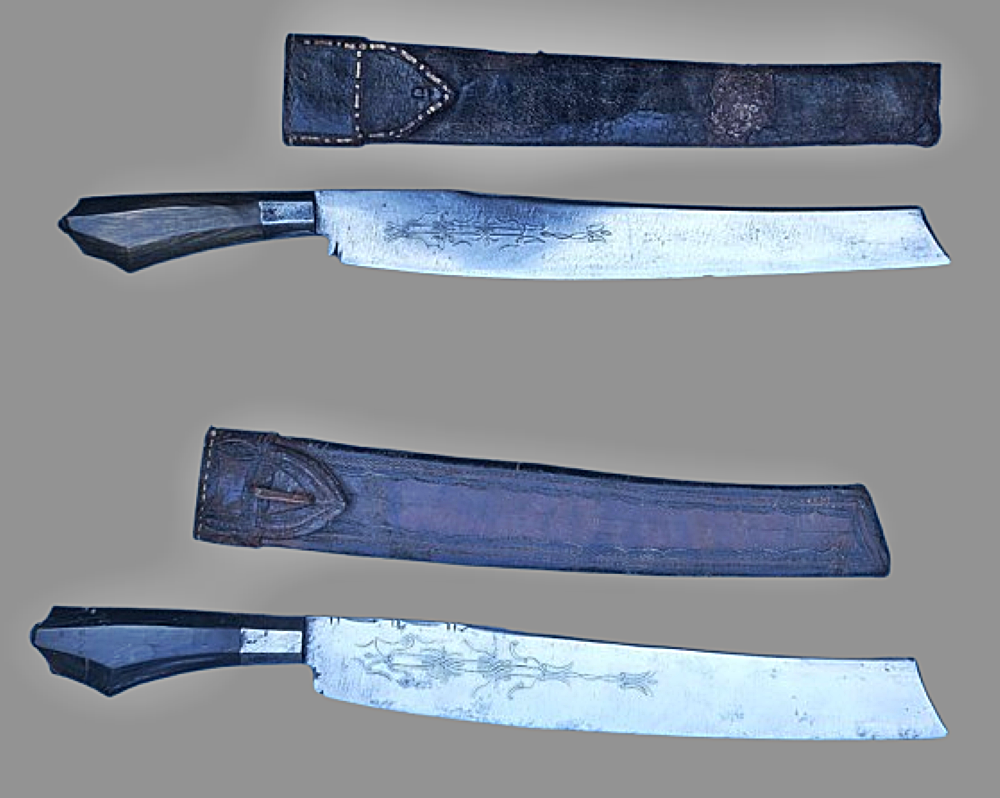

Here some new pictures.

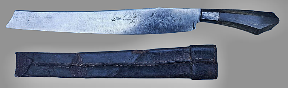

Old 20th September 2024, 09:04 PM   #3

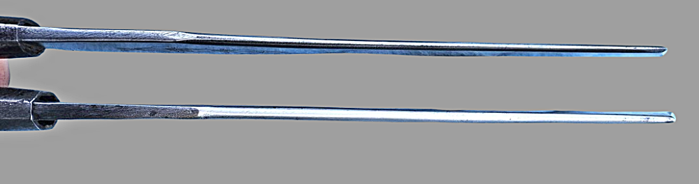

And here together with a very similar one my friend got recently, the one from him is a little bit more heavy but seemingly from the same workshop.

No comments??
Old 21st September 2024, 05:55 PM   #5
xasterix
xasterix's Avatar
Join Date: Oct 2018
Posts: 714
No comments??
I vote Pangasinan on this one

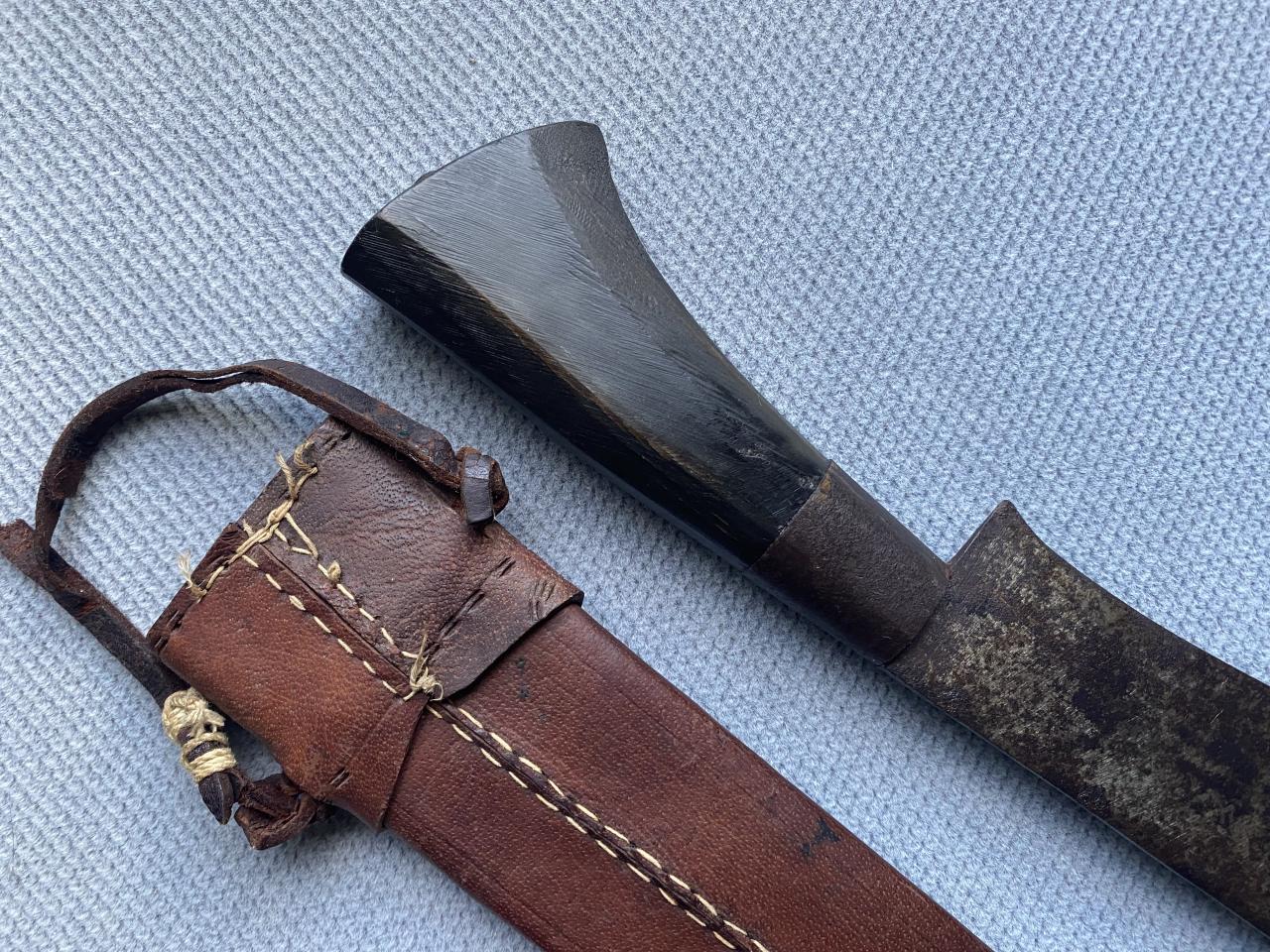

Coincidentally I just received this similar bolo - there are some differences of course but they appear to belong to the same “family”. The end of the sheath is open. The notorious “katana” of central Luzon perhaps?
TL 54cm
Blade length 41cm
Width 5cm
Old 22nd September 2024, 03:20 AM   #7

In my research, the original (and proper) term for the Pampanga-made "katana" blade is "tulipas." This has been mentioned in both documentation and oral tradition- of Pampanga-lineage blacksmiths.
I believe the blade in question is Pangasinan since:
1) I've never seen a Kapampangan-made blade with that engraving. In contrast, I've seen those on Pangasinan blades.
2) A feature of the "brother" blade- a spine gimping pattern- is also present in one of my younger, Pangasinan-provenanced blades. I've not seen that applied in Ilokano or Kapampangan blades.
3) I believe the blade in question is a truncated-blade form of the Pangasinan blade known as "barang." In its truncated form, it looks "similar" to tulipas, but they have differing blade profiles and alignment.
Old 22nd September 2024, 10:25 AM   #9
Thank you Ray! Would you agree that the both shown bolos are from the 19th century? And is the handle form typical for Pangasinan?

Thank you for sharing your bolo with similar blade shape but I am unsure if your bolo is also from Pangasinan because of the different handle form. Maybe Ray can give us an answer!
Can you show us a pic from the spine of your blade?

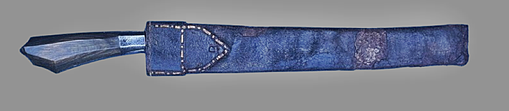

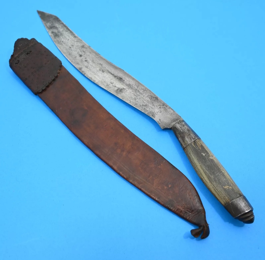

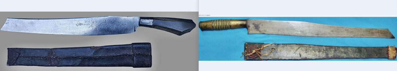

Would this be Pangasinan or Pampangan as well? The curved spine and belly are quite different. Recently won but haven't received, photo from Ebay.
Nice one! Outbid me LOL 😂

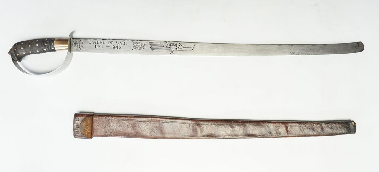

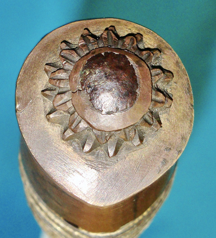

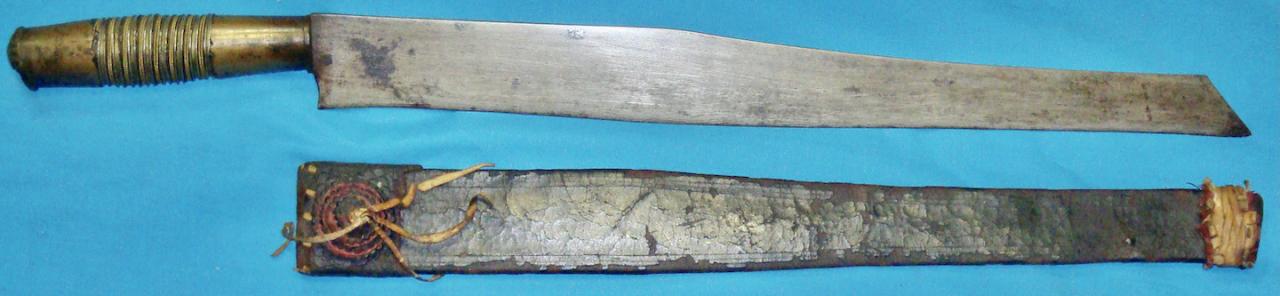

Posts: 7,406

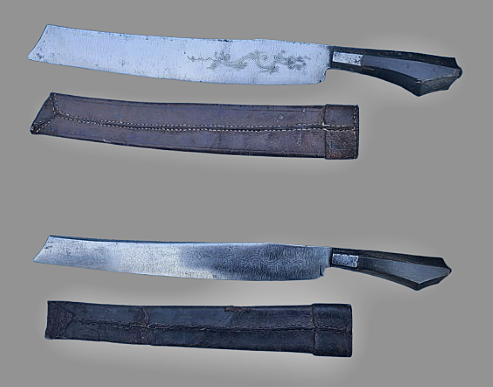

Here is my piece. Thought it was Pampangan. Is it Pangansinan? Sun on the butt of the hilt - Katipunan group?
Brought back from a US service man who was in the PI back at the beginning of the 20th century.
Old 23rd September 2024, 05:25 AM   #15
xasterix
xasterix's Avatar
Join Date: Oct 2018
Posts: 714
I believe this is from Rizal area that's one of their prominent blade profiles.
Old 23rd September 2024, 05:55 AM   #16
xasterix
xasterix's Avatar
Join Date: Oct 2018
Posts: 714
I believe this is Kapampangan, "tulipas." The blunt blades of the Northern/Central Luzon area (Pangasinan, Ilocos Norte, Ilocos Sur, Tarlac, Pampanga, Bulacan) can be very confusing...I spent the whole pandemic figuring them out before realizing the subtle differences among the blunt bolos. Notice how, when put side by side, the Pangasinan blunt bolo (which I believe to be the angled-tip talunasan variant), edge profile curves up. But in tulipas, the edge profile goes down and stays down.
The spine profiles are also different. There's a curve in the Pangasinan talunasan's, following the edge profile's curve-up towards the tip. The tulipas just slopes down without curving back up.
The reason for these subtle differences is because they were 'cut' from different blades. Tulipas was from a Kapampangan narrow-tipped blade (whose name eludes me), while talunasan is from the Pangasinan "barang" blade.
Hope this clarifies things!
Because the Northern Luzon / Central Luzon areas are pretty much close to each other, there may be handle similarities that can make things confusing. The scabbard can also be misleading, as traditionally those close-knit provinces supposedly source scabbards from only one area (somewhere in Ilocos). That's why I focus on the blade, engravings, and telltale carvings primarily The peen may also be helpful, but can also be misleading. Those close-knit provinces copied blade dresses from each other, but they "stayed true" to their native blade profiles.
TL 54cm
Blade length 41cm
Width 5cm
This blade is, I'm guessing, from Ilocos, the blade profile is mostly straight with minimal curves, it's an all-rounder blade which they call nowadays as "para gaw-at."

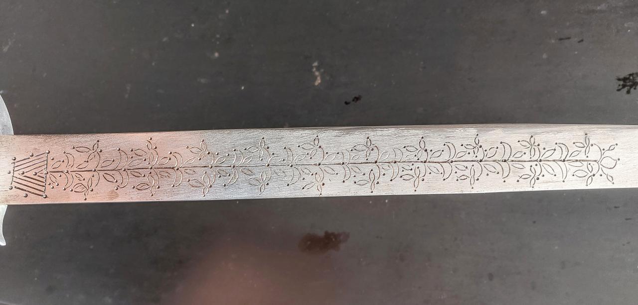

Posts: 714

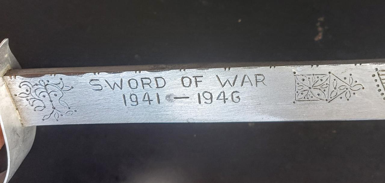

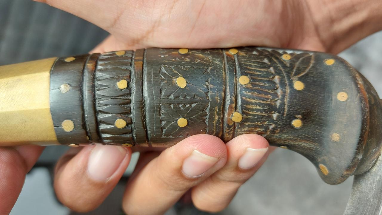

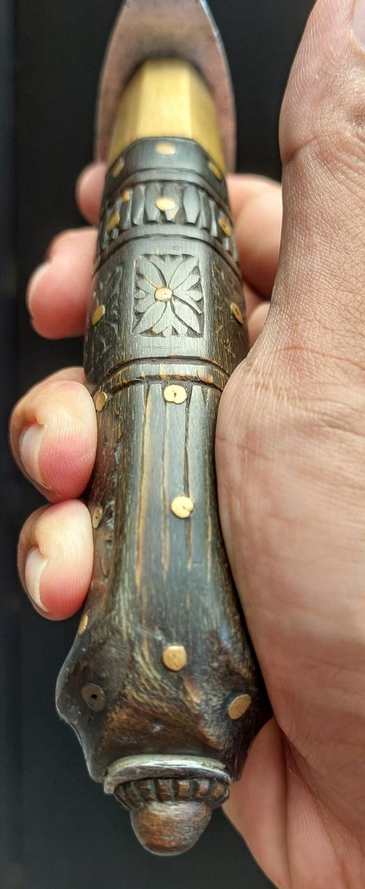

Here's some pics of my WW2-era Pangasinan talunasan, round-tip variant. The spine gimping is the same as one of Detlef's samples. The blade engravings, while not 1:1 with Detlef's blades, has a similar theme.
The hilt profile also appears on Ilokano blades. The peen style also appears on Pampanga and Ilokano blades.
The hilt carving is distinctly Pangasinan, I've not encountered that on Ilokano, Kapampangan, or hilts from elsewhere in Luzon.
I absolutely adore this talunasan...this is how it looks like in action: https://bit.ly/talunasan
The round-tip variant has a similar nuance to round-tip minasbad. The thrusts are wicked.
