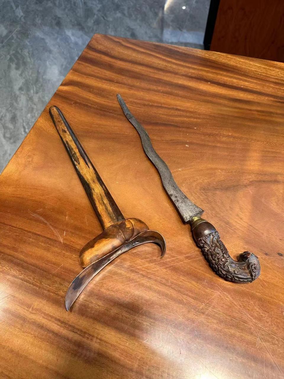

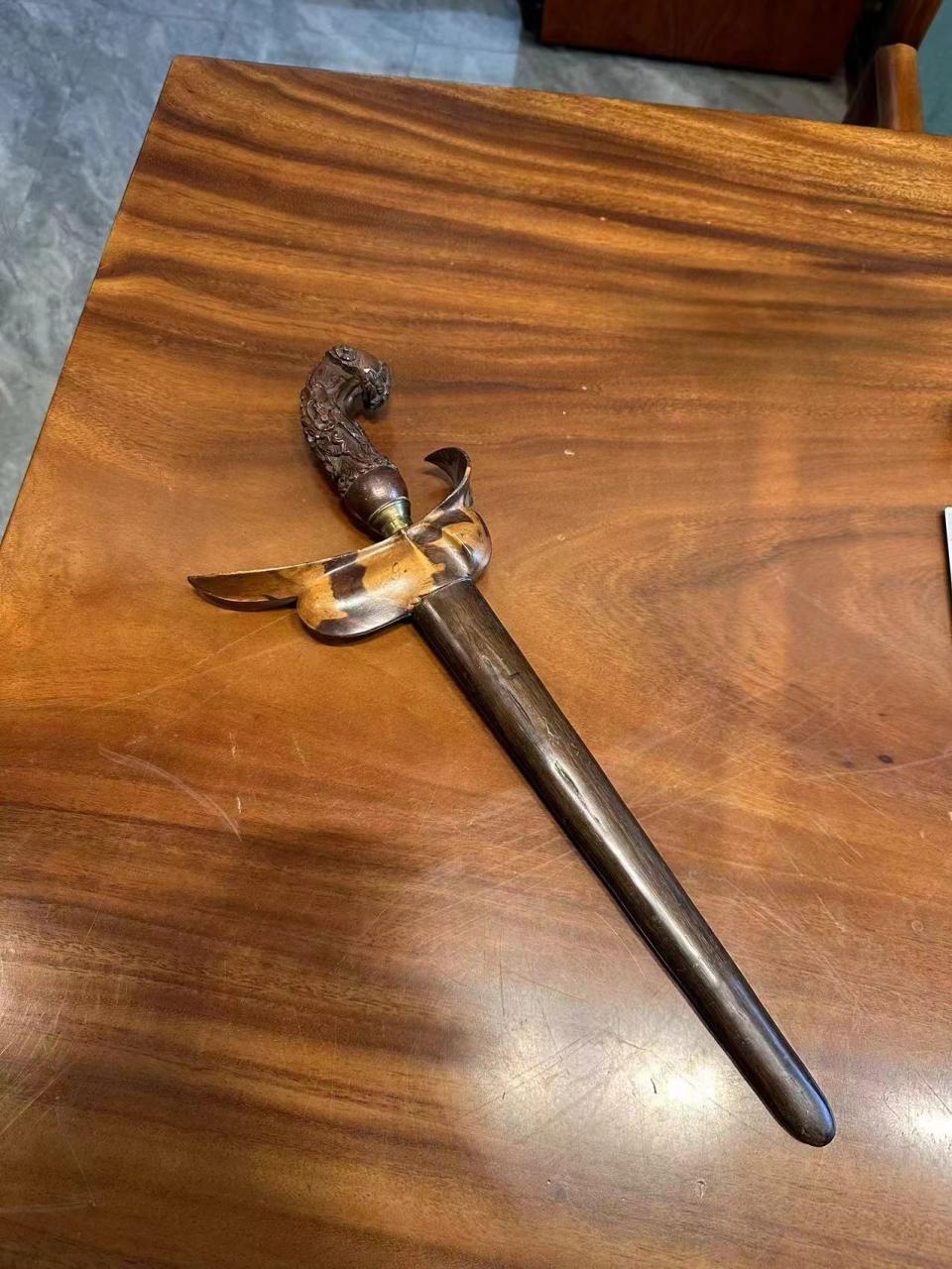

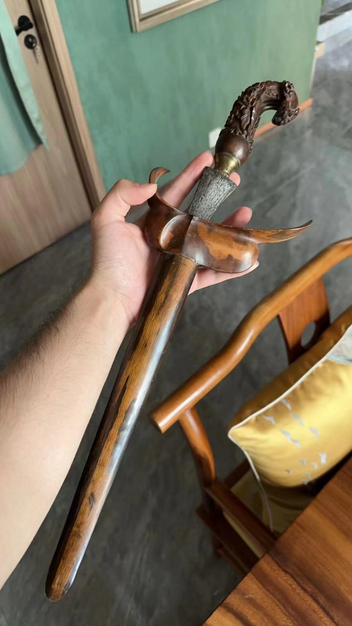

Default Keris or not?
Seems lost many elements in upper area.
HughChen is offline   Reply With Quote
Old 3rd September 2024, 12:38 PM   #2
Posts: 7,230
Yes.
Cengkrong luk lima.
Old 4th September 2024, 03:15 AM   #3
Posts: 7,407
So Alan, this is normal for this type of keris? No ganga I noticed.
Old 4th September 2024, 02:11 PM   #4
Posts: 7,230
Yes, form is correct, but sometimes they will have a gonjo, sometimes the gonjo might be iras, ie, just marked on the blade, not fitted separately.
The ones with no gonjo have sometimes had a gonjo fitted & it has been lost, other times they appear to have never had a gonjo.

Posts: 500
they seem to exist with and without a Ganja.
The dress and hilt are Madurese and I think that, once cleaned and stained, the blade may, possibly, show as being pamor adeg rambut

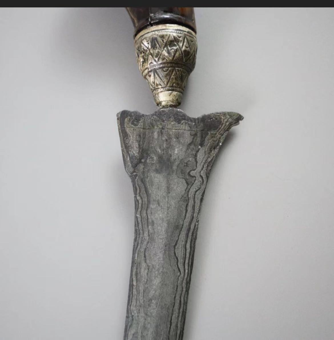

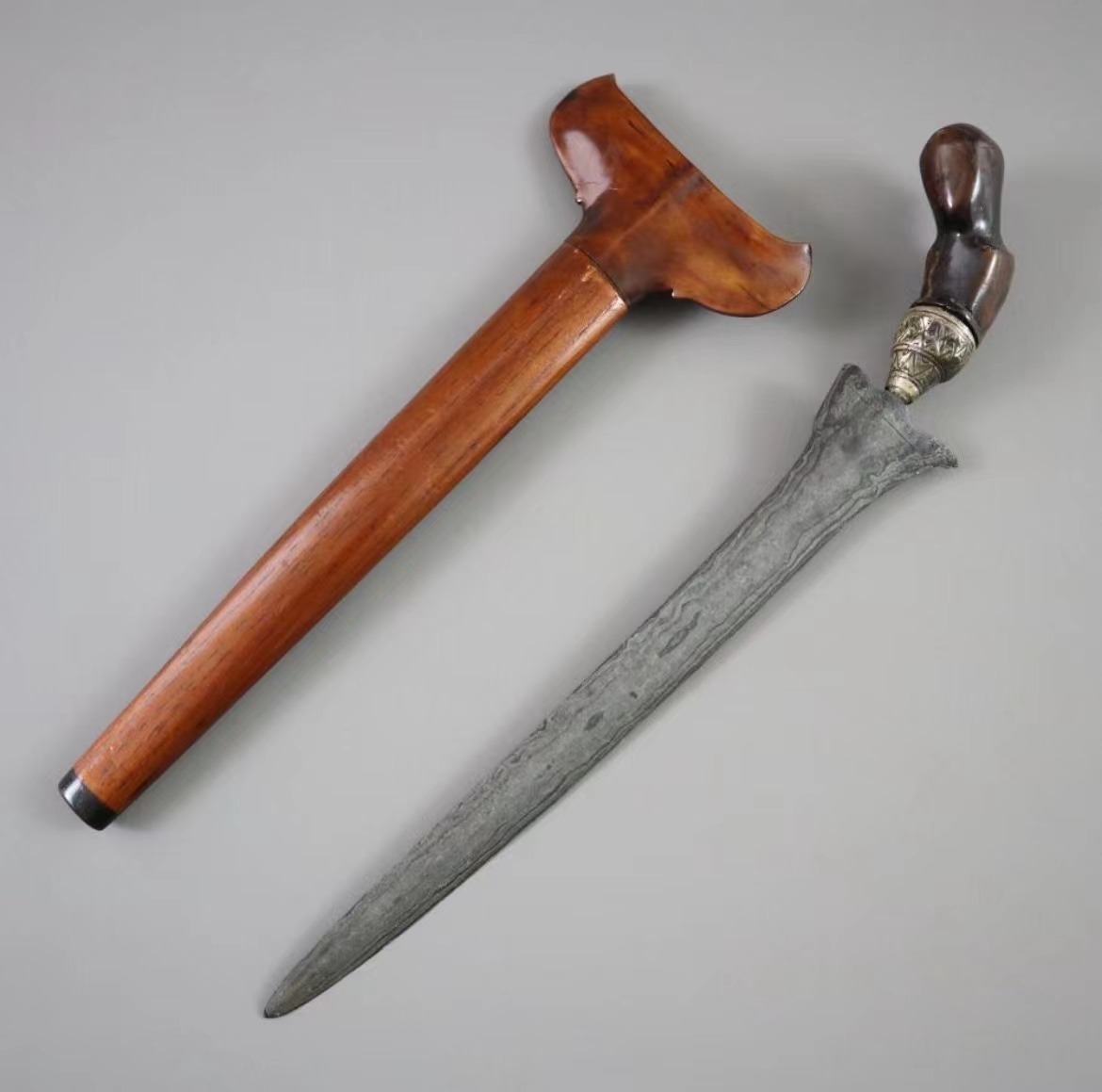

Hello, my learned friends, is this one of the same type?

In my opinion, though not as experienced as others, the kris you show is South Sumatran Kris .
I have never seen that particular dhapur featured here (but others with more experience may be familiar with them)
The " ganja" appears to be not really separated from the blade with a " symbolic" separation

To answer your question Hugh, i would say no, this last keris you show is not Cengkrong. It clearly has a gandik (Cengkrong do not) and the keris is gonjo iras, meaning that the blade is all one piece without a separate gonjo, though it does have an incised line to mark out a gonjo area.

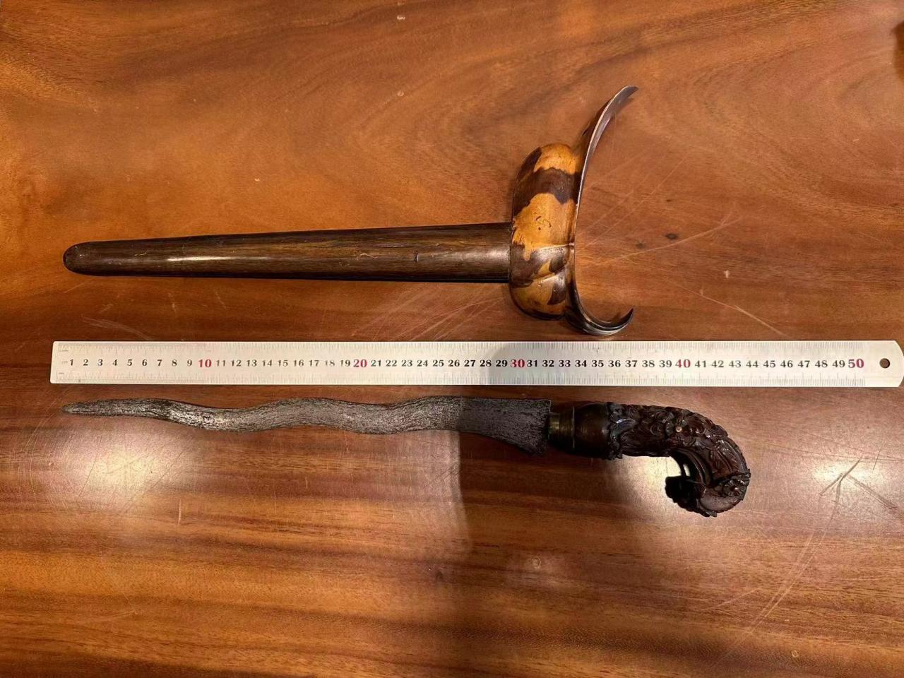

Hello, Alan ,can you illustrate to us what is Cengkrong luk lima?
Old 28th September 2024, 04:33 AM   #14
Posts: 7,230
The waves in the blade of a keris are called "luk".
"Lima" is the number 5.
"Luk Lima" is "five wave".
The present method of wave count is to begin on the first wave above the gandhik and the first wave on the other side of the blade is wave 2.
We continue towards the point and finish the count on the same side of the blade that we began on, often there is no wave at that point, it is often a nominal wave only.
