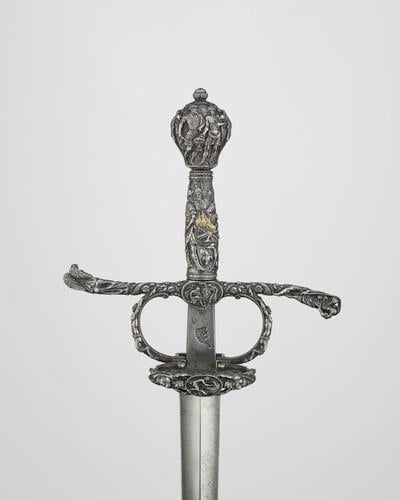

Hello all,
I am wondering if anyone knows anything about the a sword in the Royal Collection (Queen's Guard Chamber, Windsor Castle), listed as RCIN 62994. (see listing here: https://www.rct.uk/collection/62994/rapier)
Per the above linked site, this sword is claimed to have "belonged to John Hampden (1594-1643), one of the leaders of the parliamentary opposition to Charles I".
The hilt is attributed to being designed by sculptor Benvenuto Cellini.
This sword is also depicted in Fig 37 of Gardner's "Armour in England From the Earliest Times to the Reign of James the First"
I am curious if anyone knows anything about this sword, the sculptor, and the accuracy of attributing this to a date in the first half of the 1600s. A few months ago, I posted a sword in my collection with a hilt that has some similarities in decorative technique (although not the same motif) and it was generally thought that such chiseling of steel would not have been seen on something from the 16th or 17th centuries.
I know museums and armories can get dates wrong, so I figured I'd come to the actual experts here
As always, thank you for your expertise,
-Rob

The swords description says "This sword, with its superbly sculptural hilt, was once thought to be the work of the Florentine goldsmith and sculptor Benvenuto Cellini. As with the 'Cellini Shield', the tradition was refuted when historic arms and armour came under more serious scrutiny in the last quarter of the nineteenth century. " They also say that John Hampton's ownership is "tradition". This seems to cast some doubt on its providence before the late 18th century.
Cellini was an amazingly talented renaissance man. Artist, warrior, engineer. Caught up in the politics of his time. His Autobiography is a fascinating work, although I am sure he put himself in a very flattering light. He produced a salt cellar that I thought was amazing as well as his escape from prison. To me I can see why it was said to be his work stylistically.
It is a pity that one can't quite make out the makers mark or that there isn't a picture of the whole sword.

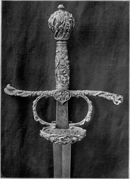

Here are some blades that Norman references in regard to the Hampden hilt. First are a couple of hilts in the Wallace Collection that are stylistically related in components.
https://wallacelive.wallacecollectio...ype=detailView
This is the one we have been looking for! Norman claims (P. 189) this is from the same workshop as the "so-called Hampden sword".
https://collections.vam.ac.uk/item/O...apier-unknown/
Sadly, the Victoria and Albert Museum also has this hilt being from an unknown workshop. Though they do say France as its place of manufacture. The blade appears to have pierced work. It is amazing how such artists can fade into the mists of time so quickly. I wonder if they felt unappreciated by their patron during their lifetimes?

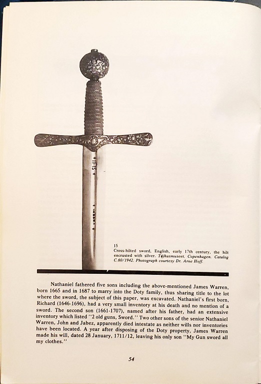

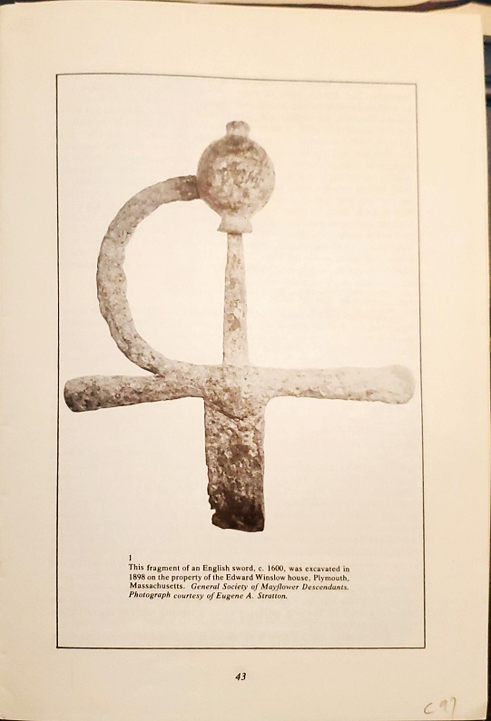

From: "A Rare English Sword from Plymouth Colony", Anthony D. Darling, Arms Collecting, Vol.20, #2:
from a sword excavated at the Edward Winslow house property, 1898.
It is noted in Norman (1980) that in its earliest form this hilt style is found in Europe from c.1490 to mid 16th c. It reappeared for a time in England briefly in the 17thc.
"...the fashion of a simple cross guard occurred as a result of a large number of Knights of the Bath created by James I at his coronation in 1603. It was usual for a sword of antique type to be used in the Bath ceremony. The finest of this group was made for Henry, Price of Wales, and bears his crest. This sword can be dated prior to his death in 1612. At least one undecorated example of this type is known. It is shown in the portrait of the First Earl of Doune, in the rones of the Order of the Bath.c.1605. the example illustrated in this paper from the Tojhusmuseet has a cross guard about identical from the Plymouth sword hilt".
I would note here that South was bound to Thomas Cheshire in 1603, who was officially cutler to Prince Henry, Prince of Wales, and son of King James I.
The sword for Henry was once thought to be a gift to him from Louis the Dauphine in 1607 , but as noted by Mann (Wallace Coll. 1962.. p.263) this seems unlikely.
It does seem this hilt style is of vintage form as noted, and distinctly English as shown in the Plymouth sword example relating to these spherical pommel forms.
