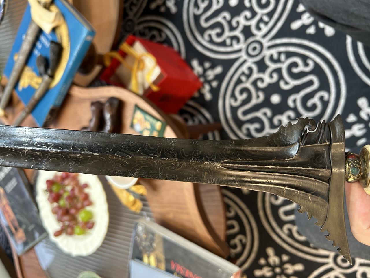

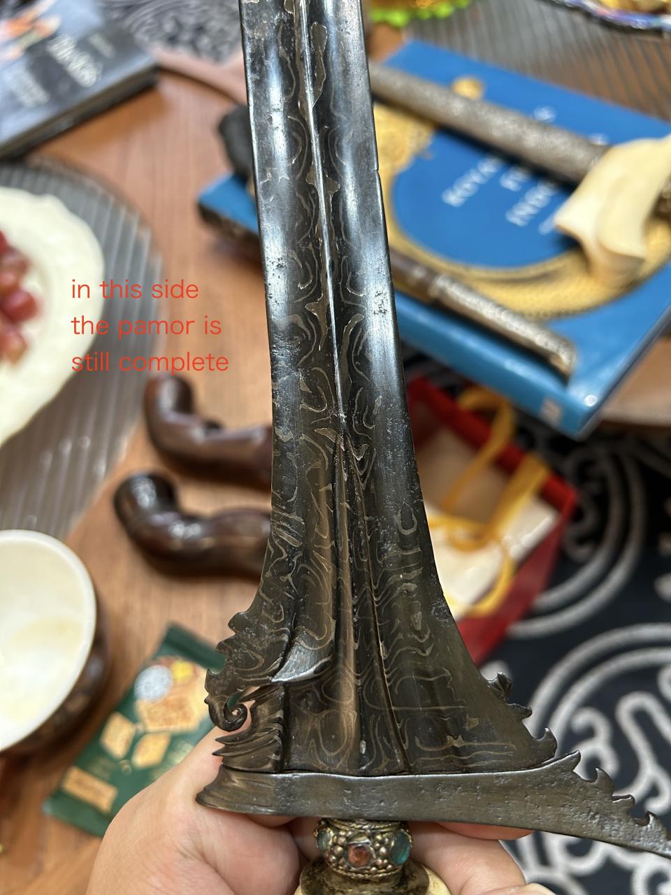

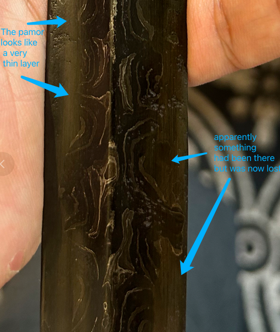

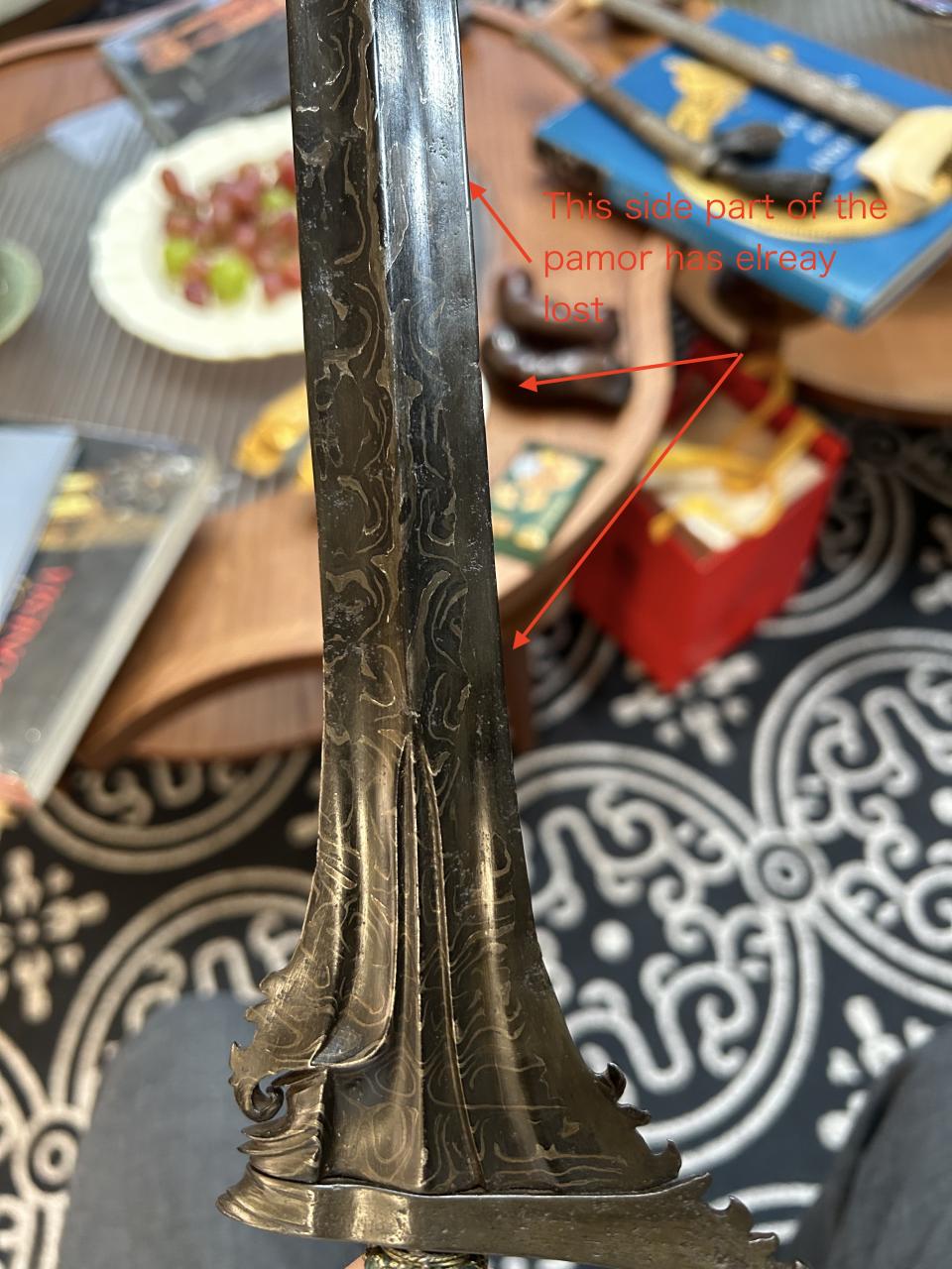

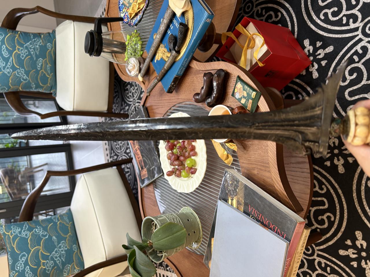

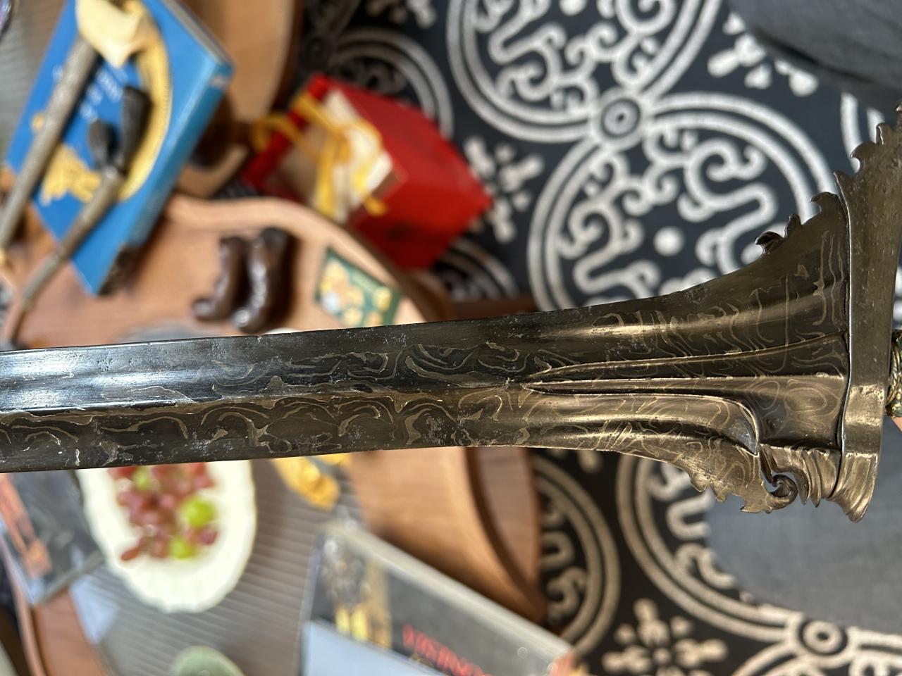

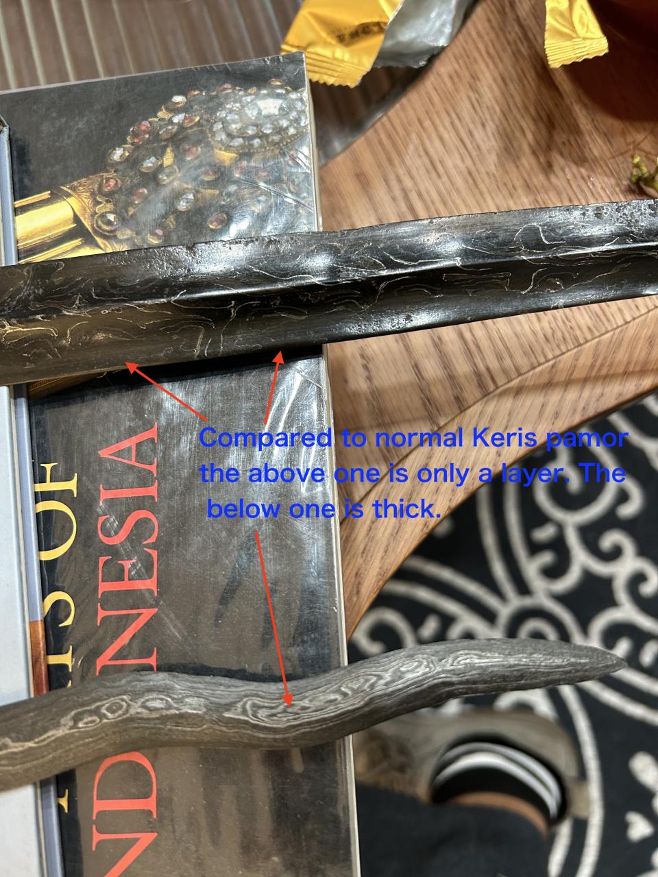

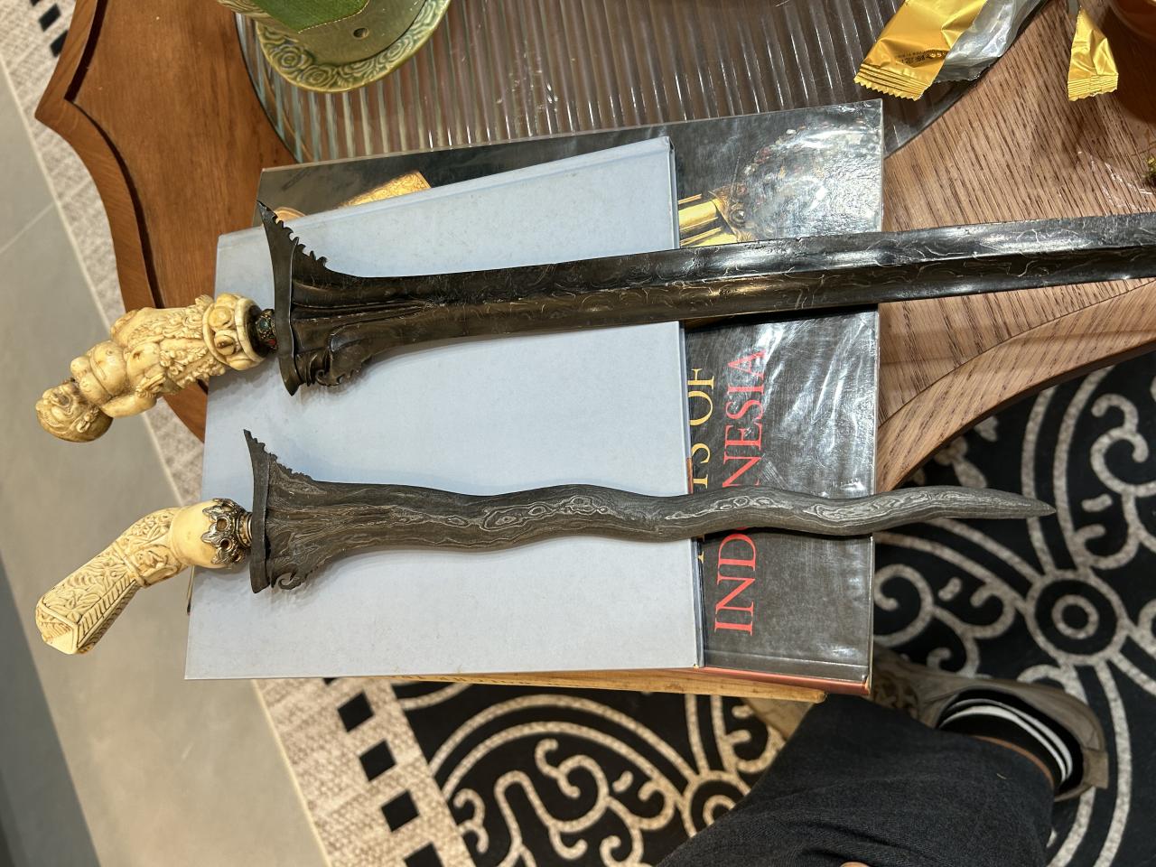

I have learned that Keris was forged in such a procedure that 2 layers of billet are folded & welded and in the end a core of the blade will be inserted into the middle of the 2 layers from our forum, thanks to Maisey.
Today I discuss with a friend, he told me that this Keris was forged quiet differently. There are only two very thin outside layers of billet which has Pamor are pasted in the thick core.
That explain why some of the pamor was lost. it's becasue the outside layers are very thin.
My friend believes that this is an even older craft for dealing with precious meteorites. He told me that due to the high value of meteoric iron, it was not used in the form of large steel ingots in ancient times, but rather in small pieces.That's why we think this blade is at lest 200 years old.
Do you agree with the former opinion? Wish your valuable opinions, Thanks!

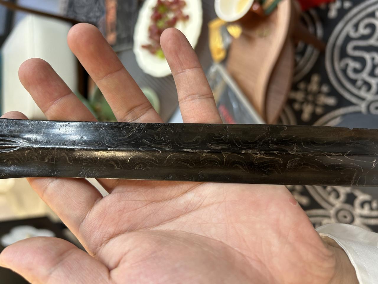

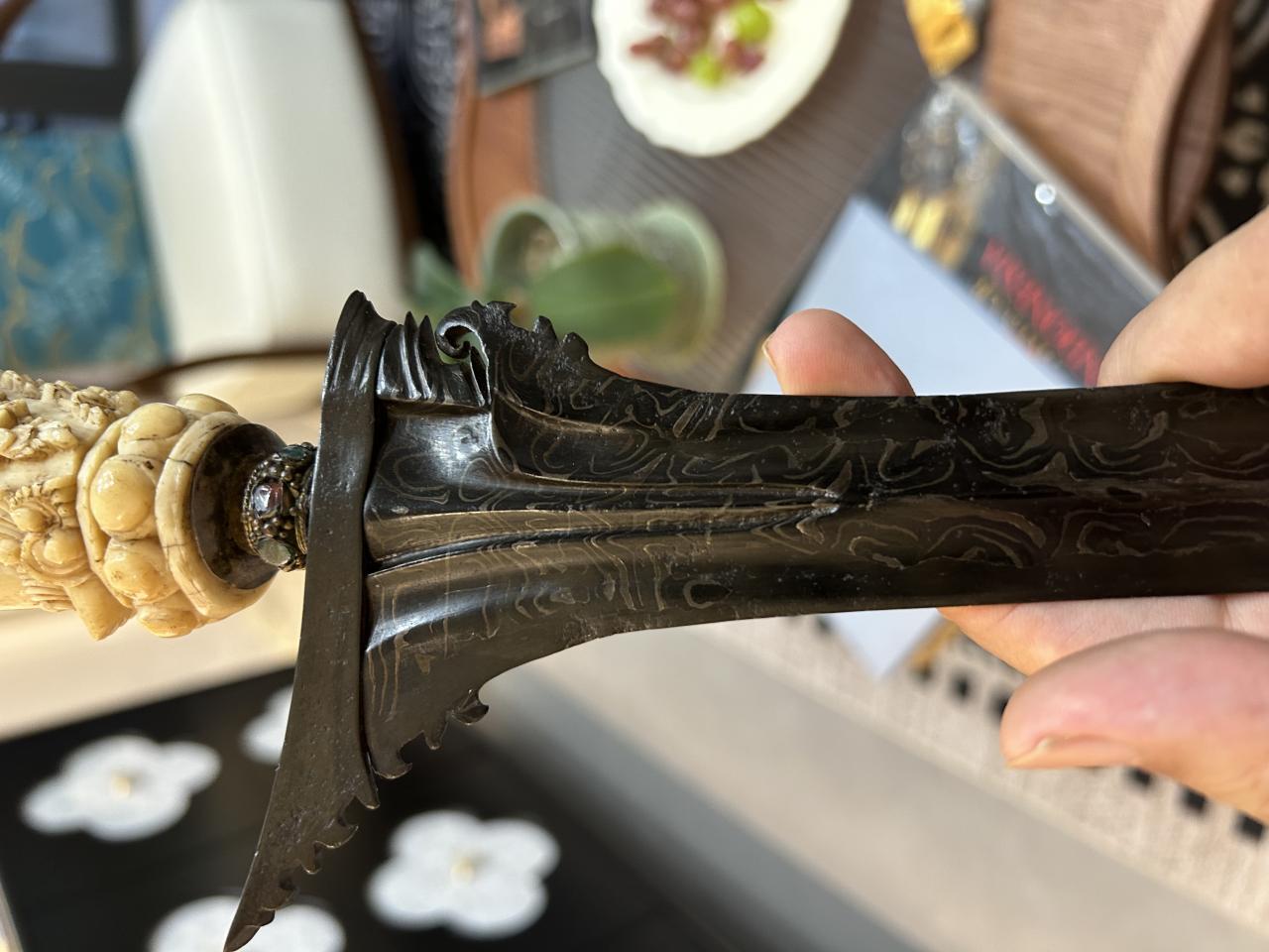

More pics

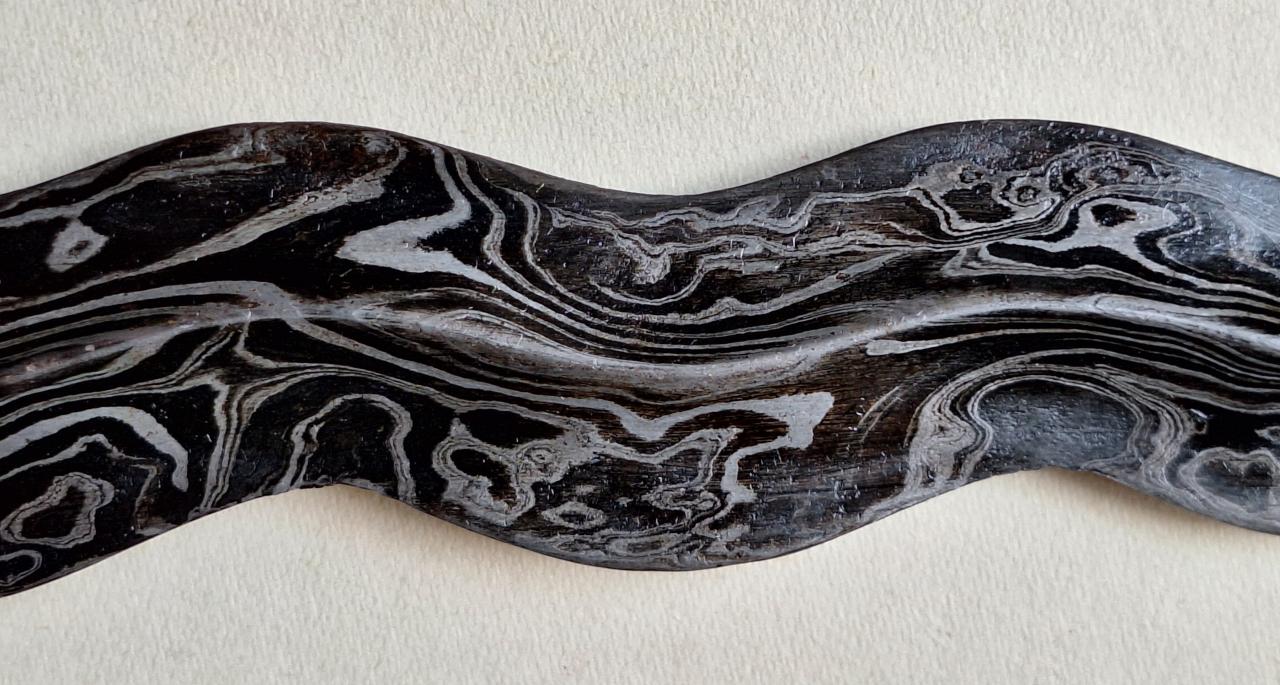

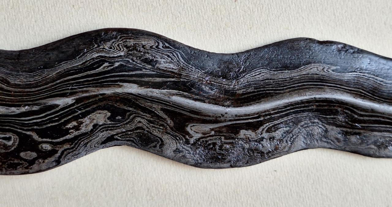

These two keris have the same type of pamor, that is, "mlumah", or "laying down pamor" this type of pamor is made as I have already described and is placed on either side of the core as I have described, with the layers of material parallel to the core.
The reason that they look so different is because the Bugis(?) style blade has been subjected to minimal carving & the pamor material has not been surface manipulated prior to being carved. The Bali style blade has had the pamor material manipulated by punch work or grinding & has been heavily carved to produce the odo-odo.
Exposure of core in the Bugis blade is minimal, exposure of core in the Bali blade is greater.
The Bali blade looks as if it started with fewer layers of pamor than did the Bugis blade.
The blades were both made using the same basic process, but were subjected to different treatment during that process & came from the forge with different number of pamor layers.
Each blade is a common representative of its type, nothing special, nothing different, same process of manufacture but subjected to different treatment during that manufacture.
As for meteoritic pamor, that subject has been addressed multiple times in this forum, & I really don't feel like ploughing the same field again. Somebody else might like to lay the story out, or even a while spent with the search function might help. Here might be a good place to start:-
https://www.vikingsword.com/vb/showthread.php?p=207340
I have made a number of blades using meteor as the contrasting material, no keris using meteor, but I did prepare some meteoritic material for another craftsman to produce a couple of keris, the blades I made that included meteoritic material were damascus blades with meteor included to add contrast. Once the meteoritic material is clean there is no difference in welding it than in welding nickel as an inclusion.
In fact, although we talk about the number of layers of pamor material in a keris, these are really nominal layers, we might have done X number of folds & welds, but with each weld we lose some of the material, then when we begin to carve the blade we lose more, so we might have produced a forging that has a nominal 128 layers of pamor, but if we cut it and etch the cut we might find many less than 128 layers, and the number of remaining layers will vary from place to place throughout the length of the billet.
200 years is not particularly old for a keris blade. In fact, very early keris, say, keris that pre-date 1500 usually have quite simple pamor, and the earliest type of keris, the Keris Buda has no pamor at all.

I completely endorse everything Alan wrote, except for the fact, that Bali/Lombok Keris in question more likely has a Pamor, which is created by twisting a rod, consisting of layers of different metals. In this case on both sides of core there is one such twisted Pamor material rod. In this case it woudn't be Pamor Mlumah, but Pamor Miring or Pamor Puntiran, depending of perspective.
The Odo-Odo quite disturbs the usual impression of this Pamor effect.
Not so often seen in Lombok, quite rare in Bali (in time period from this Keris could come).

I can understand why you, & perhaps other people as well, might think that this Bali blade has been made with pamor miring, I'll tell you why I believe it to be pamor mlumah.

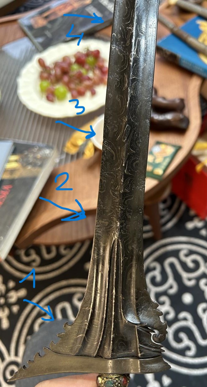

1) if we look carefully at the white lines of contrasting pamor material what we can see is that those lines flow lengthwise along the blade, where a line of white pamor curves, that curve has been caused by the contour of the blade that was created by carving and by hot work manipulation, it has not been caused by twisting.
When a layered bar is twisted, the lines of pamor form angles across the blade, they do not form straight layers of pamor that flow along the blade. You can see this yourself if you select one of the short, straight lines of white pamor, and then move to the other side of the odo-odo and see where that same layer of pamor emerges from the black iron. We can often follow the same line of white pamor along the length of the blade, periodically interrupted where it is covered by black iron.
2) in some places in the body of the blade we can see a continuous exposure of white pamor material, this is pretty obvious on top of, & along, the odo-odo. This feature will not be found in a pamor that has been created by twisting.
3) this particular variation of wos wutah (beras wutah, wosing wutah) is pamor wusing wutah gedhegan, it is only one of the many known variations of wos wutah used in Balinese keris.
4) I have seen this pamor being made, not once, but several times, the contorted lines of pamor are created by surface manipulation, ie, punching and/or filing, this surface manipulation is further altered when the blade is carved.

Alan, thank you for giving me the honour of a detailed response, which I much appreciate.
I don't think the matter here is as simple as manipulated Wos Wutah.

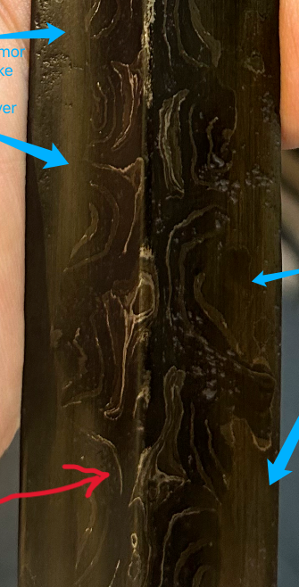

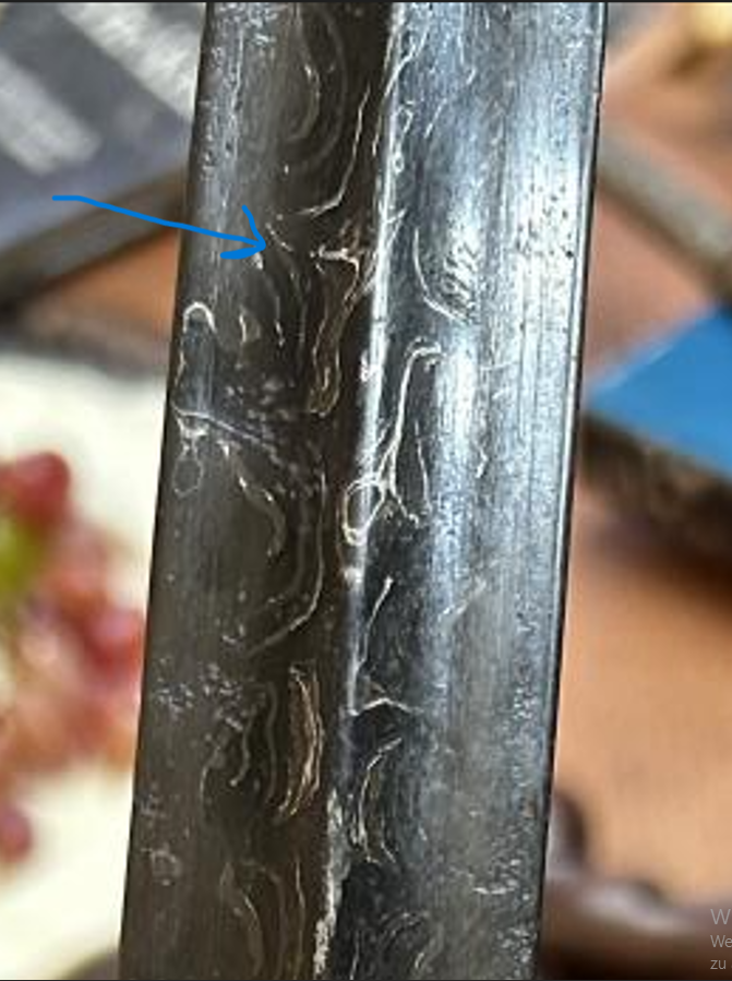

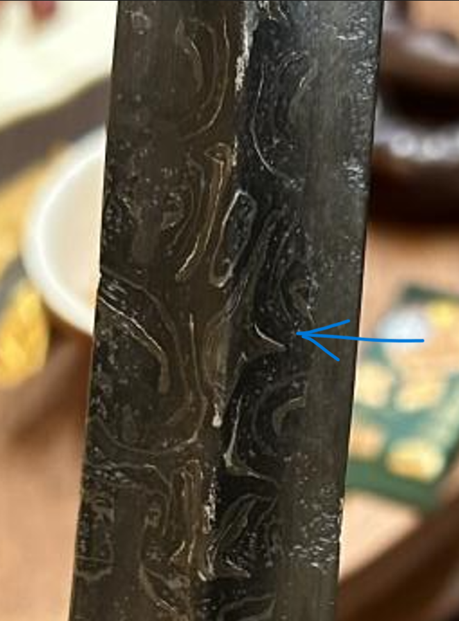

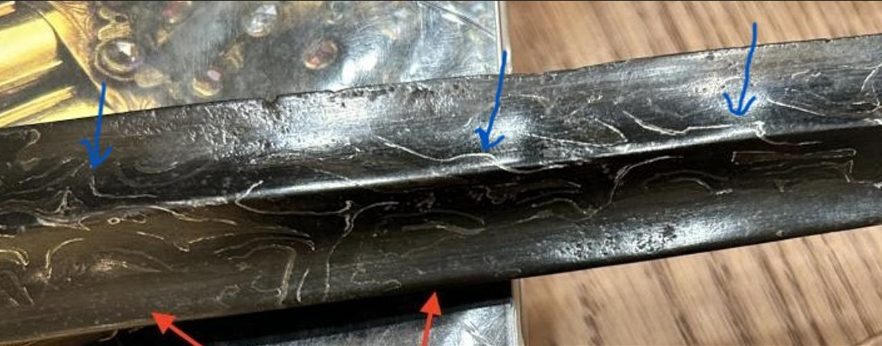

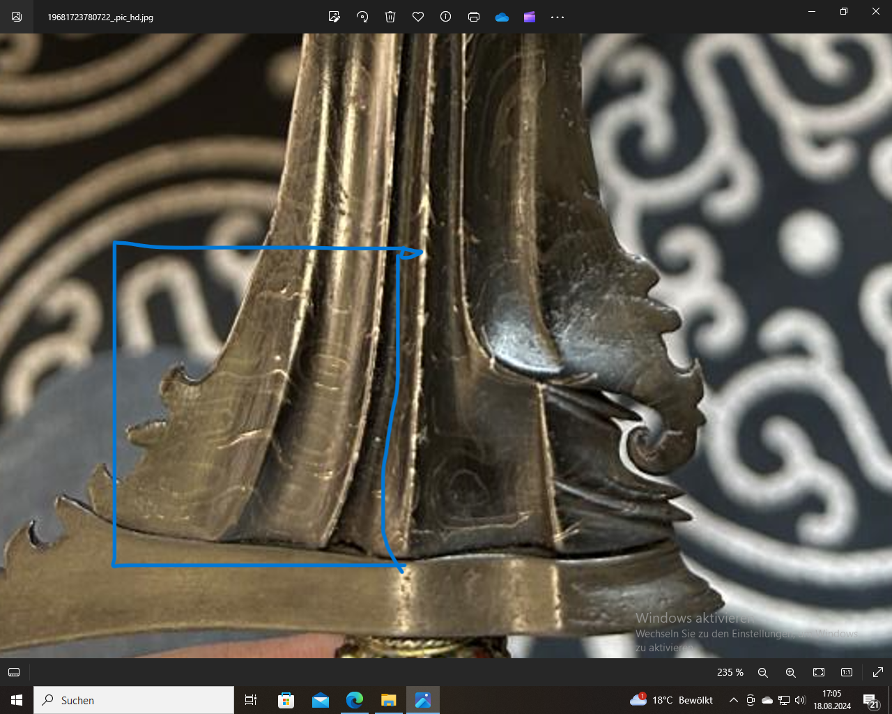

In the picture with three blue arrows we see a feature, which is one of characteristic patterns for a twisted bar, under the left arrow; under this and both other arrows we see the white Pamor lines crossing the Odo-Odo to the other half of blade, an indication for a twisted bar.

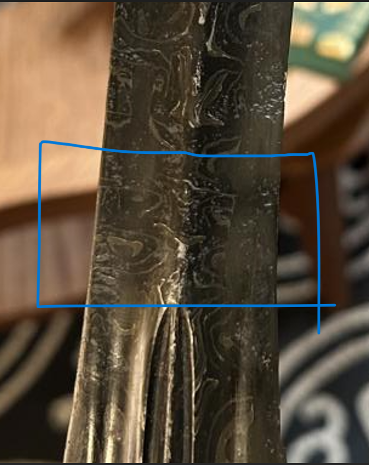

Another such feature we see in the second picture with a single red arrow, which is marking it. At this place too the feature runs over Odo-Odo.
I have not worked with metal, but I have played a lot with two colored plasticine, and so I know as well as you, that besides other quite differently looking phases of a twisted bar (depending how much we take off of it), there is one phase, where a straight line runs through in the middle between the semicircles. In this phase it is possible to have a straight white line running on top of Odo-Odo.
The features we are used to see on blades with twisted bar Pamor will be very difficult to see on a Bali/Lombok blade with Odo-Odo; and it also seems to me, that the approach doing such pattern is different from, let's say, Java. Almost none effort is made to keep the pattern technically recognizeable. It somehow is enough, if "it's there". On the blade Hugh presented, which is an antique blade, the Pamor surely has been further disturbed through Sangling, traces of which we see in the horizontal picture by Hugh.
I happen to be a custodian of an antique Lombok blade with a twisted bar Pamor. The Pamor is a mess, it is clearly recogniseable at the base, in the middle it still displays some phases of a twisted bar appearance, and gets almost completely lost in a Wos Wutah like appearance above the middle (partly, because the bar surely wasn't twisted until the end, partly because of forging out the bar). Added three pictures of it around the middle and abowe it.
I did read Ida Bagus Dibia's book about ten years ago, and haven't had a wish to read it again since then.

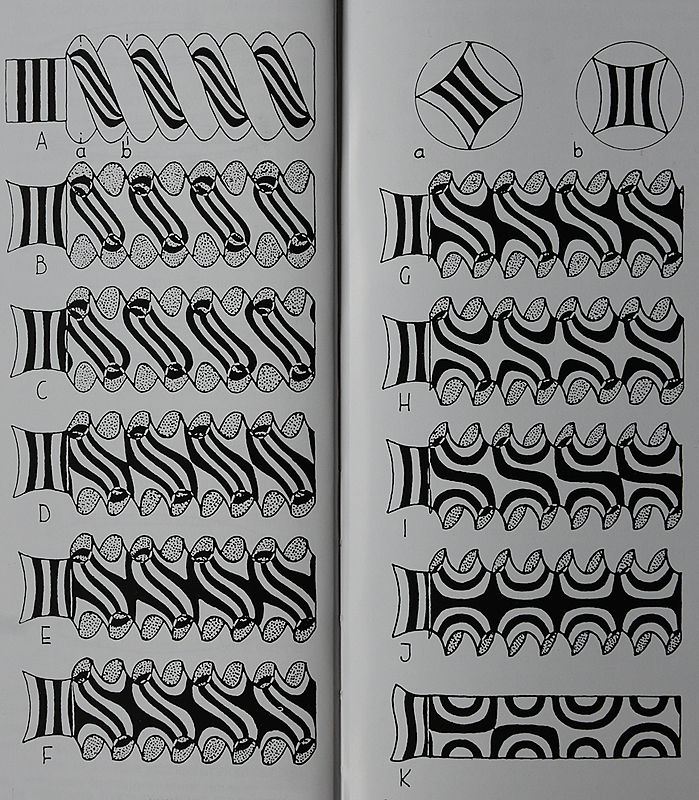

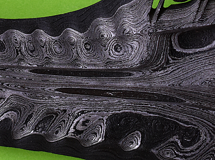

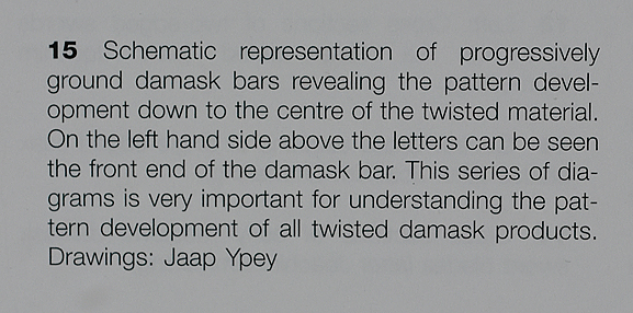

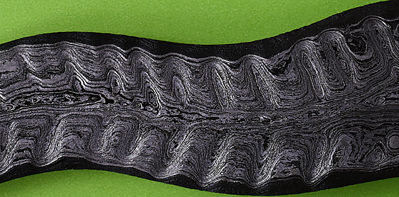

The drawings of a twisted bar at various stages of its reduction to its center, & the caption that goes with the drawings, are from Sache's book "Damascus steel", you would be familiar with this, but many other keris people would not be.
I started doing forge work in about 1978-1980, by 1982 I had found a teacher, I first made a dagger with pamor construction in about 1983, & immediately after the dagger I made a pretty funny looking little keris. By 1988-1990 I was doing the sort of pattern welding that is demonstrated in the Sache drawings, it was all damascus work. I did try several times to apply twisted bar as pamor, but I was never very successful, however, my twisted bar damascus blades were more than acceptable. I sold most of my damascus work to other makers to be turned into knives & daggers.
The teacher I found in 1982 was Gordon Blackwell, he taught me to forge weld, but I taught myself to forge weld high carbon steel & nickel & to combine these materials into a single billet.
I found another couple of teachers in Solo, my principle teacher was Empu Suparman Supowijoyo, my long-time friend Empu Pauzan Pusposukadgo also taught me, but only by observation & his explanations, I never worked under Pak Pauzan's instruction. In addition to this I have observed the work of four or five other pande keris in Central Jawa, and four or five pande keris in Bali.
All of this Javanese/Balinese teaching & observation was between 1980 & 2023. I stopped doing forge work in about 1995 when I moved to a new house and got so busy with other things that I never got back to serious forging. I currently have only a small hand blown farrier's forge, & the only forge work I have done in recent years is heat treatment of blades I made in the past, and teaching of a few people who wanted to learn basic forge procedures.
The big difference in working with damascus & working with pamor blades that have a laminated steel core, is that with the pamor blade you have only a comparatively thin layer of contrasting material and you need to forge out the entire blade to its intended length without deforming the pamor pattern, then when you are doing the cold work, you need to be extremely careful not to cut all the way through the pamor and expose the solid black of the core. If we use the construction method of an inserted edge, rather than an enclosed core we can avoid that core exposure problem, but I don't think Javanese makers have used the inserted edge since about 1700, & not all makers used it then.
If we look at the Sache drawings we can see that only a very few layers of contrasting material have been used, & enclosed by thicker layers of homogeneous material. By the time that we have reduced the fully twisted bar to somewhere near its center we have removed all the closely spaced outer layers, & come down to the more widely spaced inner layers, as can be seen in illustrations J & K of the Sache drawings. In these J & K illustrations we can see an almost straight line of homogeneous material running through the center of the bar, in damascus with few layers in the original material, it is possible to achieve something more or less like this, but in pamor where we begin with only a tiny amount of contrasting material it is virtually impossible to produce a continuous line of the white contrasting nickelous material.
These illustrations are related to European working capabilities, they do not reflect the capabilities & technology of Javanese and Balinese smiths. Nor do they reflect my own capabilities. All the forge work I did in Australia was done without a striker & without a machine hammer, and on a relatively small forge. In Jawa & Bali the forges are even smaller & more limited than what I used.
In reality this beautifully crafted twisted bar in the illustrations is not representative of what can be produced by the vast bulk of smiths in Jawa & Bali. In addition, working with pamor we use very thin pieces of contrasting material ie, nickel or meteoritic material, a piece of the contrasting material used in most keris would be no thicker than a piece of newspaper, I used to forge out the nickel or cleaned meteor until holes appeared in it. The traditional method of welding meteorite used in Jawa is to enclose tiny pieces of meteorite in an iron envelope & then run that envelope through anything up to 7 or 8 folds, the number depending upon the number of welds needed to clean the material, this envelope process results in extremely thin layers of contrasting material.
So with the Sache illustrations we have an example that is entirely different to what we work with in pamor production for a keris, with pamor we have a greater number of layers, and those layers are much thinner.

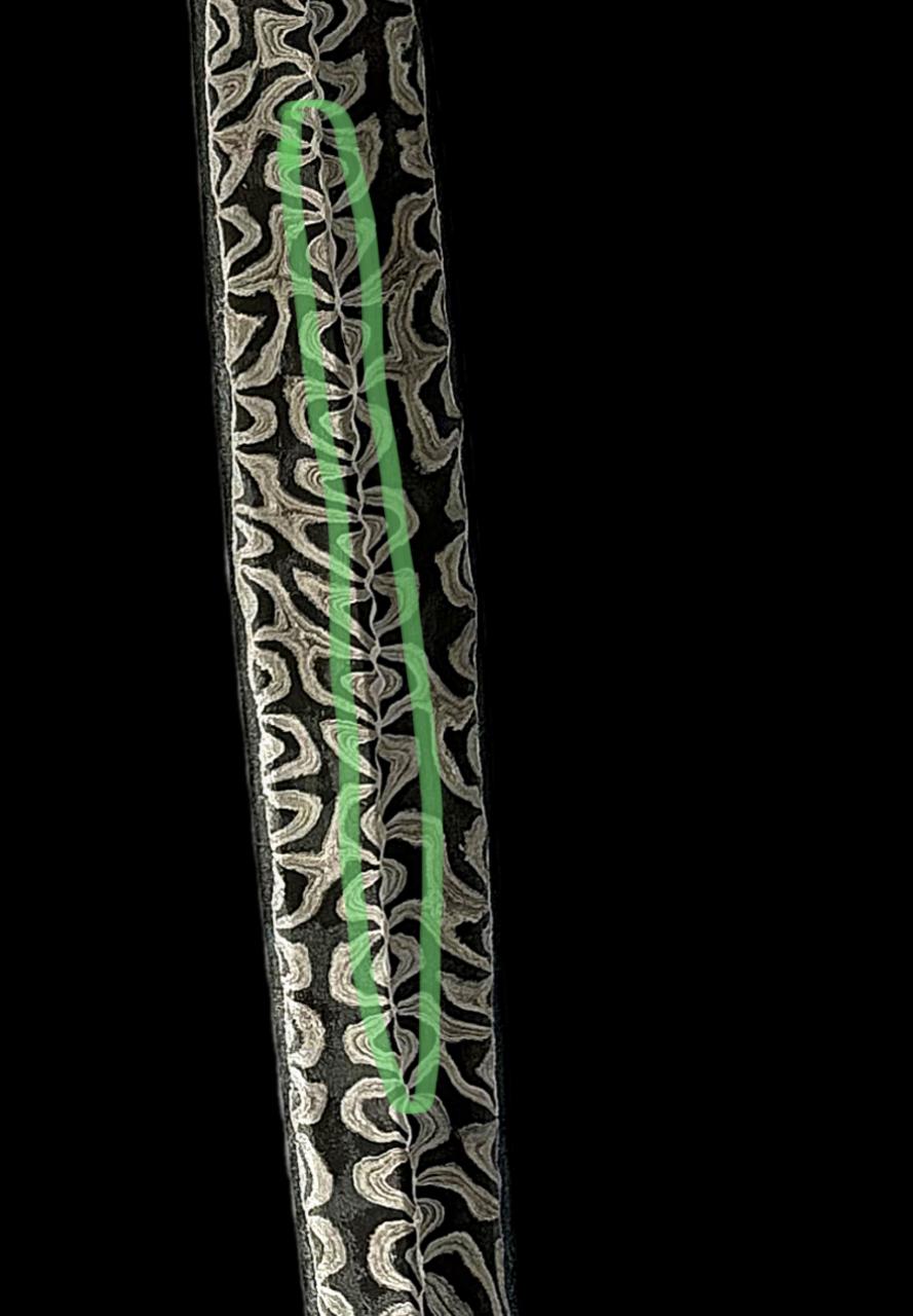

Now have a look at the photos of keris blade section. The blade I have used for an example is one that was made by Pande Keris Yohannes Yantono, I prepared the meteoritic material for use in this blade and it was given to Yantono as a very small billet, he forged it to paper thinness before combining with iron and producing a pamor billet that contained a nominal 128 layers of contrasting material. The pamor motif is Wiji Timun, & this was produced by surface manipulation.
If we look at indentations that form the motif we can see the same flow pattern in the pamor that can also be observed in the Sache illustrations J & K, but the flow pattern in the keris pamor is comprised of very many more layers than in the J & K illustrations.
In the keris blade we can also see in the image of the sorsoran where the pamor has been totally cut through during the carving & the black core has been exposed. If we look at the other image of blade section we can see a small section of blade where the top of the odo-odo has come very close to exposure but still retains a few specks of contrasting meteoritic material. Looking closely at the continuity of contrasting material in this keris blade it is not difficult to see where the layers continue from one side of the odo-odo to the other. These layers are much finer than in the illustrations, or in the keris shown in post #2, but the flow is quite easy to see.
The major indicator of a blade that has been made using a twisted bar is that close examination will almost invariably reveal some weld joints where the twists have united during production. I have run the photos of the keris under discussion through Photoshop examination & I cannot find any of these weld joints, however, weld joints might be present and only detectable under microscopic examination, if this were proven to be so, then my opinion that this blade under discussion is a mlumah pamor would be wrong.

HughChen is offline   Reply With Quote
Old 18th August 2024, 03:18 AM   #18
HughChen
Join Date: Aug 2024
Location: China
Posts: 175
Hello,Alan. I think maybe that's what we mean. My friend hold the belief that this keris's pamor represent some old craftsmanship which should be from 17th-18th century.

Thank you Alan and Gustav for your ongoing discussion, very appreciate it.
Hi Alan,
I apologize in advance for my simplistic (probably ignorant) question:
Is this an example of the evidence of weld joints.
If yes does this mean that the pamor of this keris has been made using a twisted bar?
Thank you.
JustYS is offline   Reply With Quote
Old 18th August 2024, 03:48 PM   #20
Gustav
Join Date: Jun 2009
Posts: 1,346
This is not a joint between two twists, this is a joint line between two twisted bars.

Just a few observations using one picture.

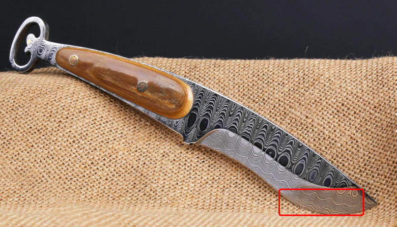

In the overall view picture of the blade I have marked 4 places, where we see, how the frequencies of segments (defined by gedhegan work or by twists, or by whatewer) are becoming wider towards the middle (and afterwards even more wider toward the tip, outside this picture).
This is not a picture we would expect to have of a Gedhegan work, which is done on a cold blade already forged out, and where the frequency between places, where surface is manupulated, is kept more even,- or would be even reversed - with bigger spacings on Sorsoran, becoming narrower up the blade.
On a blade made with a Pamor of twisted bar(s) we would normally have that, what is the case here - narrow frequency on Sorsoran, which becomes bigger and bigger up the blade - because the Pamor is forged out together with the hot blade. Of course an experienced smith, or let's say, smith, who cares about an "as eaven as possible" appearance of a twisted bar Pamor, works against this occurence - to have a pattern with more eaven frequencies.
I also don't see classic twist joint features on this blade, but there are at least two places in this one picture, where it comes quite close to these (marked by blue arrows in the cutout pictures; the pictures with blue marked areas show the borders between possible twists, in this case the narrow frequencies close the base of blade). As I have said, Odo-Odo can disturb the appearance of a twisted bar heavily, as does Sangling here and there - the thinness of Pamor layers in this case goes into a small part of a millimeter at some places.

Gustav before I try to understand how to respond to your most recent post I need to know what you mean by "gedhegan work". The root is "gedheg", or "gedeg", or "gedek". In Bahasa Indonesia this is a panel of woven bambu, in Javanese it also means this, but it also means to shake your head when you disagree with something, and it means to collaborate. The meanings are of course contextual.
I have looked at Haryoguritno and he gives "gedhagen" a meaning that agrees with what JustYS has said some salesmen use to refer to "nginden" work. However, this is not a usage I have encountered in Solo.
So could you please confirm that by "gedhagen" you mean what I know as "nginden" and what I refer to in English as "chatoyant", that is that a basic but dense wos wutah pamor is indented or cut in a series of straight lines and then forged flat, the result being to create a series of lines in the pamor that are shadow-like?

JustYS, it is as Gustav has said, two twisted bars welded together.

HughChen, in your post #17 the pattern in the blade shown was made in the same way that the pattern in my example of the Yantono blade was made, and how the pattern in the blade under discussion was made --- although Gustav disagrees with this.
The difference is in the number of contrasting layers, the blade geometry, the craftsman. In all blade work there can be very many variables, and each variable can affect the finished result, things that have been created in essentially the same way can finish with a totally different appearance.
In most cases the craftsmen who work in the field understand the variables & the results, but in the absence of lengthy specialised training the untrained observer will almost invariably be confused. I guess the same is true in many fields.
In respect of your post #18, do you mean that your friend thought that the Bali blade could have has an inserted edge? I don't believe this blade does have an inserted edge, & I have not yet encountered a Balinese blade that has used this method of construction. The only blades i have found this inserted edge in have been Javanese, mostly from Mataram.
In post #17 you have proposed an impossible method of manufacture, absolutely, totally impossible. The layers in pamor & in damascus are always there, but they vary in number, style, placement, thickness, execution, style, material. Very many variations, & really, I doubt that it is even possible for an untrained person to understand the variations. It is difficult enough for a trained person to understand them sometimes.

Alan,
with "Gedhegan work" I mean the process for creating Pamor Wusing Wutah Gedhegan.
Sorry, the Pamor on this blade cannot be Wusing Wutah Gedhegan, and one of the indicators are the Pamor lines running diagonally over the central ridge of the blade. The other reason I tried describe in my previous post.

Which blade Gustav, the original Bali blade in post #1?
Actually, the meaning that Haryoguritno gives "gedhagen" (not gedheghan", this is a different word, not a variant spelling) is quite different to the meaning given by Basuki Yuwono and by my Solo informant.
Standard Javanese terminology for the Solo reflective pamor is "nginden".
In a Bali wosing wutah gedhegen we are talking about a wos wutah variation that has upright strips , uncontrolled and something like adeg in appearence, but not in construction.
However, if you mean that the pamor in the Bali blade in post #1 cannot have been created from a random pattern pamor with surface manipulation, this assumption is very wrong. The carving of a blade with unevenly distributed layers of pamor will of course create the effect we see in this blade, of a continuation of the same line of pamor across the top of the odo-odo, those layers of pamor run side to side and the layers do not maintain even thickness during forging.
Gustav, it is pretty much as I said to HughChen in my post #24, there are far too many variables to get accurate answers from a finished blade, especially so if we have not had the requisite training in pattern welding. We can guess, but even to guess & with the right training & experience it is not easy in all cases.
Alan, I think we got stuck again. In my #12 I attached a picture of this blade (of course I am speaking about the blade of Hugh), where pamor lines run diagonally across the odo-odo, a feature, which would be compatible with pamor made of twisted bar. In #21 there is a picture, where pamor lines cross the odo-odo just above the poyuhan, and are those of a twisted bar. Those lines are not compatible with pamor mlumah, even manipulated.
Old 19th August 2024, 09:45 AM   #28
Posts: 7,228
Yes Gustav, I did misunderstand the part of the blade and the characteristic you were referring to.
Those diagonal lines shown in the post #12 pic can easily be created by surface manipulation, or even by irregular striking on a native style anvil, or where stones were used instead of an anvil & hammer, or by use of an old & abused European anvil. We are not dealing with European standards.
As recently as the early 1990's, I saw a pande besi who was working on the outskirts of Karangpandan --- slopes of Mt. Lawu --- who was using stones as both hammer & anvil, his wife & daughter were his strikers.
The technology that existed & still exists in some parts of Jawa & Bali, & certainly in other parts of Indonesia, can be pretty primitive, & very often the results are not predictable. When I visited Pande Made Wija ( Pande Ketut Mudra's father) in 1982 his forge was just a shallow depression in the ground, & side blown from an ububan, his fire bed was no more than 5 or 6 inches deep.
In your post #21, the pic of the sorsoran that has a square enclosing some circles and some wavy lines that run across the blade. The lines across the blade can be created by upsetting & also by addition of extra material during the forging process, if for example we add that extra material at about fold 2 or 3 or 4, there will be no weld joint seen in the finished job.
The circles can be created by punch work.
The blade section enclosed by the square & directly above the poyuhan displays characteristics that can most definitely be created in a m'lumah base by manipulation.
These things that I have mentioned, I myself have done, not working in pamor, but working in damascus.
We can hypothesise as much as we like, but Gustav, I've done this sort of work, & I've seen it done, and based upon what I can see, and ignoring what I cannot see, there is nothing in this pamor motif that cannot be done by manipulation & addition. But still, I have no problem with you continuing to hold your own opinion.
I said some time back, that I do understand why you or somebody else might think that the motif is the result of miring work, but when I see something that has the characteristics of work that I've done myself, its a bit difficult for me to accept that it was not done in a similar way. Having said that, I do acknowledge that there could be a number of different approaches to creating the same finished job from a m'lumah billet, without going to the expense of miring work --- & the creation of pamor miring is very expensive.
With a lot of the pamor work & keris work that still comes out of Jawa & Madura --- I am not mentioning Bali & this is intentional --- it is not really possible to understand how something has been done unless we have observed it being done.
