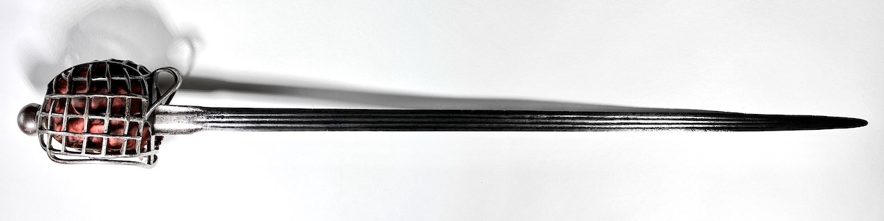

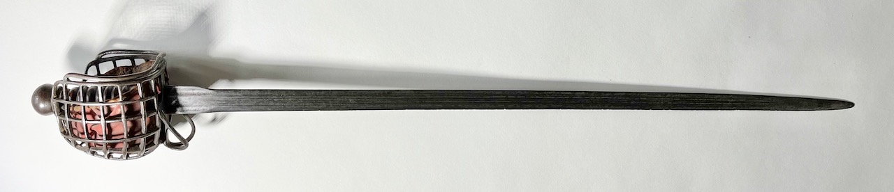

A Basket-Hilted sword with a 'Cage-hilt'.
Probably English dragoon c.1740.
Hilt:

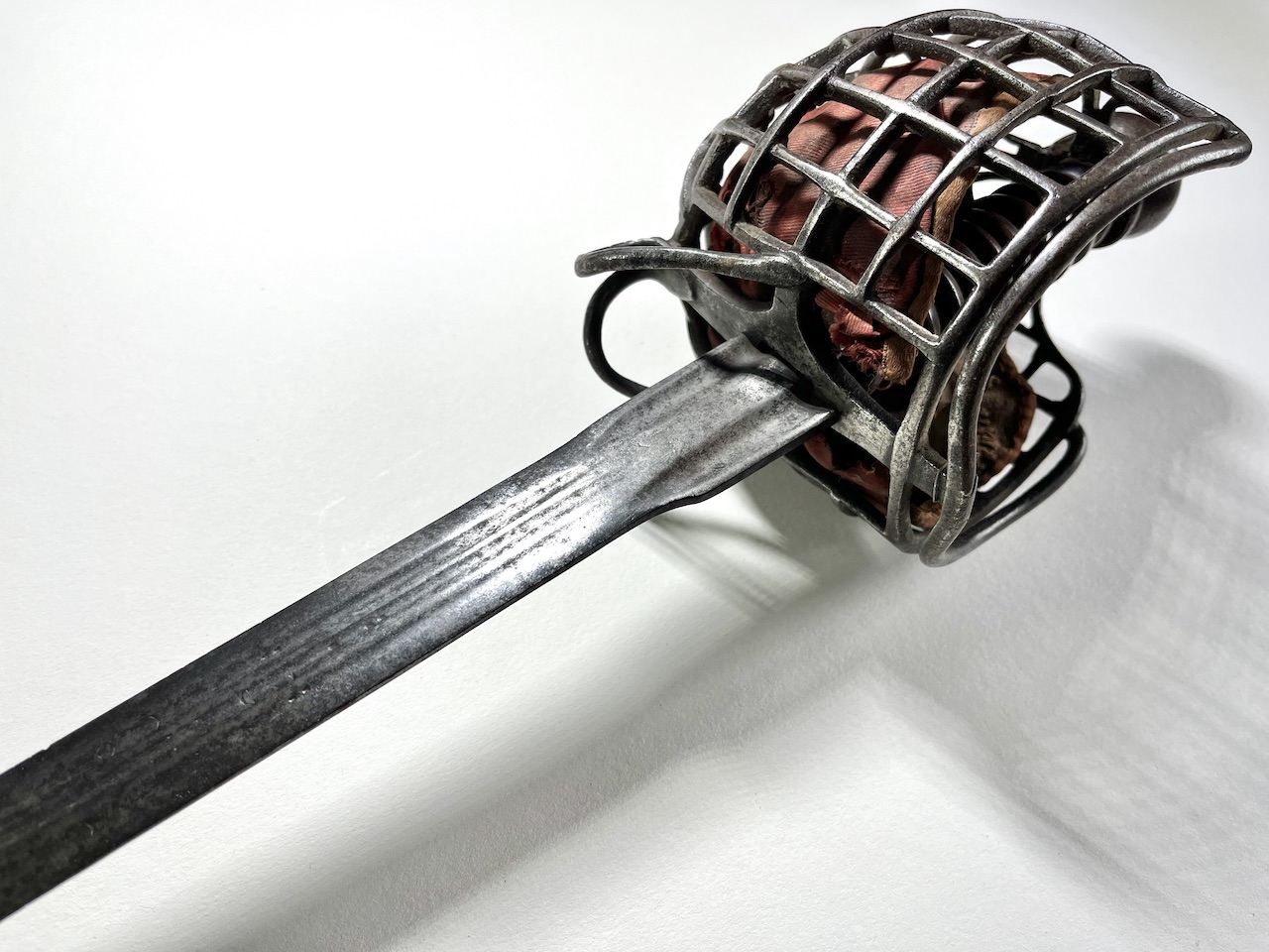

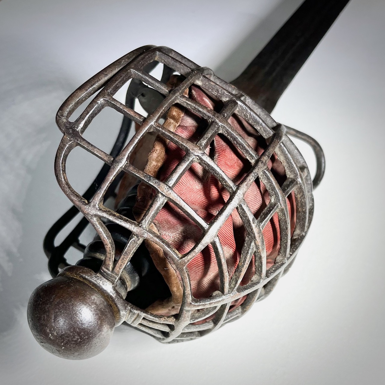

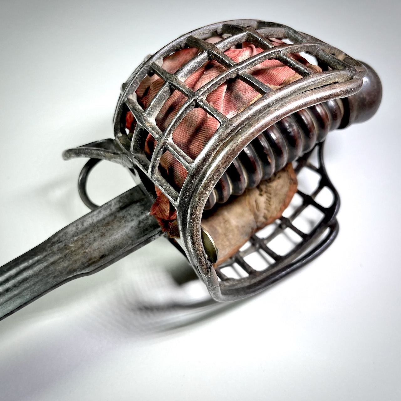

Hilt of iron cage work formed of a vertical and horizontal arrangement of entwined narrow bars joined at the top to an integral ring under a globular pommel, fore-guards, no wrist-guard, replacement ribbed wooden grip, and buff-leather liner faced in red silk.
An unusual hilt, the closest example I can find is in the National Army Museum (6408-77-8) and depicted in Leslie Southwick Price Guide to Antique Edged Weapons 1982 (389 p143). Southwick dates this hilt as circa 1740.
Blade:
Slender profile tapering blade (84cm) with three narrow fullers along most of its length on both sides to the double-edged point, the forte on both sides indistinctly incised 'ANDREA FARARA' and 'SOLIDEO GLORIO' between small marks. At first sight this looks a broadsword blade but is in fact a backsword but with a very narrow spine.
The blade is very similar in style to several depicted in 'Culloden: The Sword and the Sorrows' 1996, (eg 1:13 p30) and described as German, 17th century type.
Comments welcome, particularly from those with much greater experience with basket-hilted swords than I have.

Thank you for posting this beautiful example Jerry!!! and especially for sharing the professionally presented data from your own research....much appreciated as it establishes a benchmark for continued discussion.
As noted, this type of basket hilt was used by English dragoons from about mid 18th c into the third quarter. It must be remembered of course that these hilts with crossed bar 'cages' were produced in garrison towns in Scotland and likely by various 'slippers' (those mounting blades and fashioning hilts).
As these were independently ordered by the commanding officers of various regiments, it would be expected that while the general style or pattern was followed, there were obvious variations.
In British cavalry of the 18th century, the basket hilt became favored but the backsword (single edged) blade took precedence over the double edged, and by 1740s the double edged broadsword blade was all but phased out.
While I cannot explain pragmatically the reason for this, it seems clear the blade on this example has been altered accordingly.
The blade with flutes at the forte seems aligned with the German broadsword types furnished to Scottish armorers in the 17th century. I am compelled to think this is likely a heirloom blade from an early Scottish basket hilt, likely of the ribbon (beak nose) type now believed as early as 1640s.
As shown in attached illustrations, dragoon basket hilts of this caged form appear to have been associated with 2nd troop Horse Guards (c.1750) and with Gen.Sir Charles Howard (1748-1765) in uniform of 3rd Horse Guards c. 1760.
As always, while these references suggest the period by dates of the art, it must be presumed these type hilts were in use for indefinite time before the art.

Hi Jim
Many thanks for your kind remarks and interesting observations.
That this hilt would have been made by a local 'slipper' fits nicely of my impression of the hilt. It is clearly produced by hammering iron and has a 'hand finished' perhaps cruder look rather than a more 'manufactured' appearance. Personally I love this hand-made artisan appearance.
The blade looks to have started life as a two-edge broadsword blade. If you look carefully you can see a small asymmetry in the short fullers at the ricasso, I thnk caused by the grinding off of a mm or so to create the thin spine. This looks to have been done professionally to turn it into a backsword. Maybe in that transitional period when backswords blades were becoming favoured. The blade is of lovely quality. Not hard to see why so many were imported from Germany and why blades were reused in later hilts.
