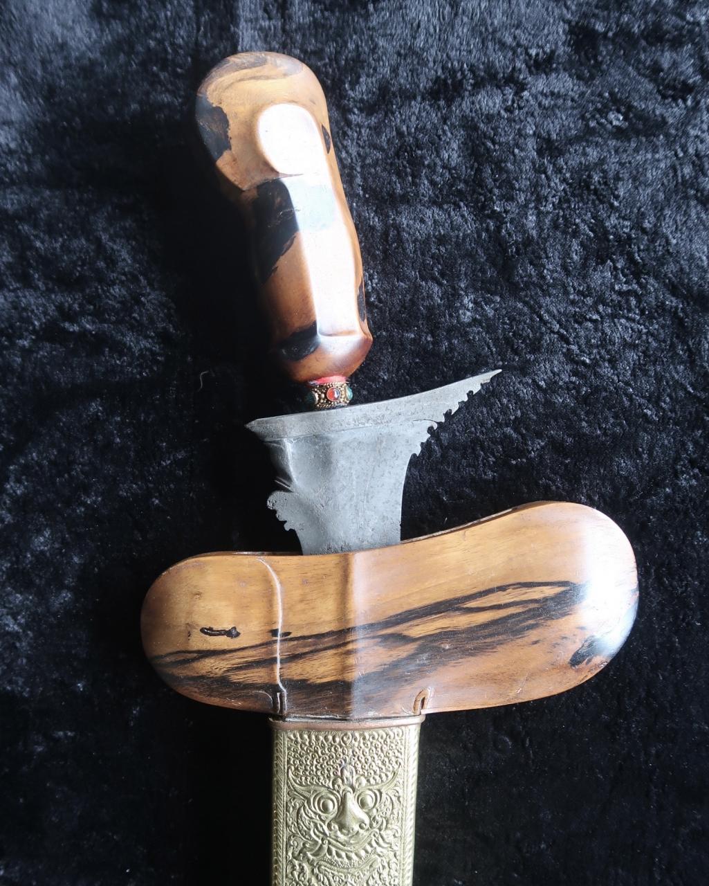

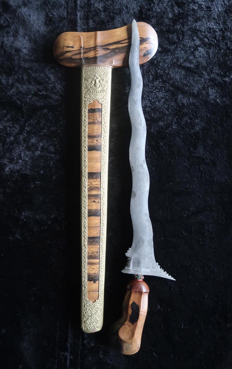

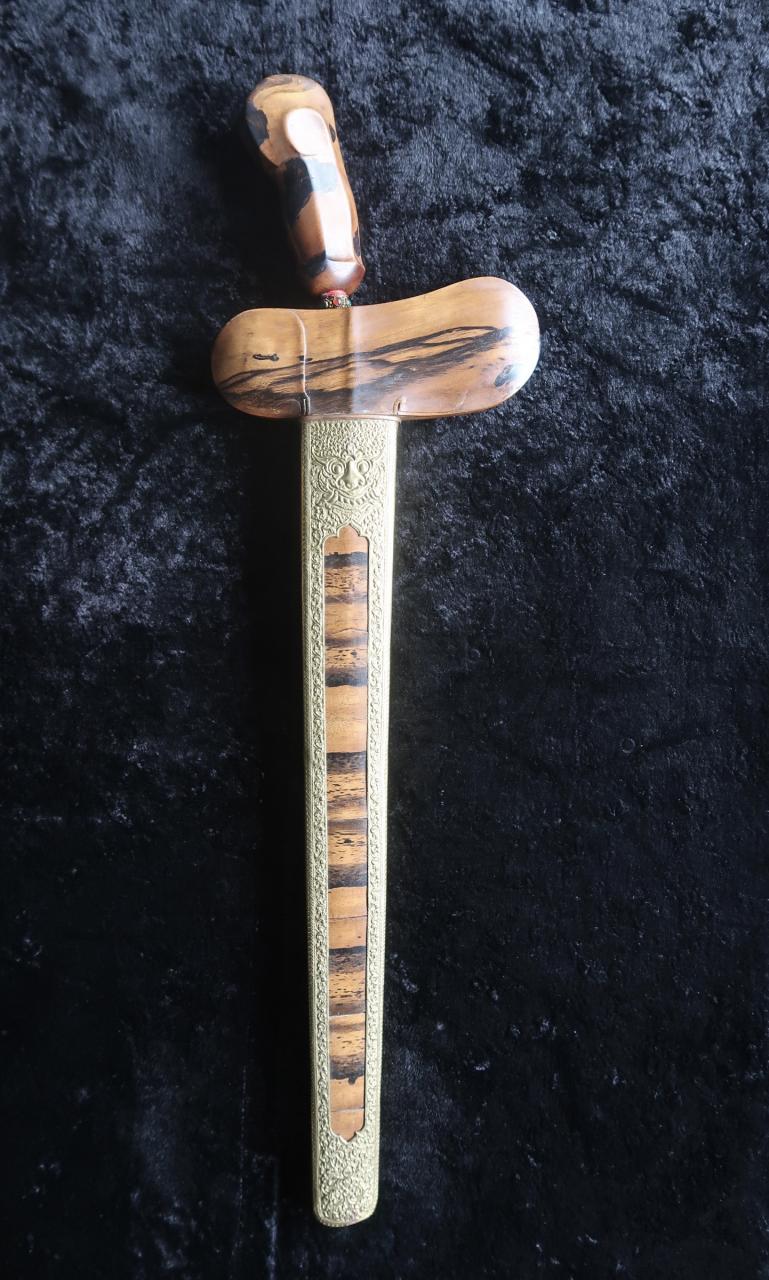

last week i acquired this Keris with 9 luk, and would like to know more about this one as it has features that i didn't see before.
Like the part above the tjedar (lajar bébék kembar) can it be that the
kembang kacang is forged to pogog model? I could not find it in any of my books about Keris.
Further the blade is very dark and with the right light i can see pamor, but i don't know if a cleaning and washing will reveal it on the photo it appears a bit of light grey.
I would like to know a date for this Keris, is it 19th century or later. I hope Mr. Maisey is able to shed some light on this Keris.

I cannot recall having seen anything quite the same as this keris.
The blade seems to have pamor.
The kembang kacang does seem intended to be pogok.
The trifolate jenggot is rather crudely fashioned.
The uwer is probably second half 20th century, test with hot needle might indicate that the "stones" are plastic.
The pendok tends to an East Jawa form.
I cannot give it a precise geographic origin with confidence, but my best guess would be either side of the Bali strait, Banyuwangi /Gilimanuk.
I suspect it might look pretty nice if given a polish & stain.

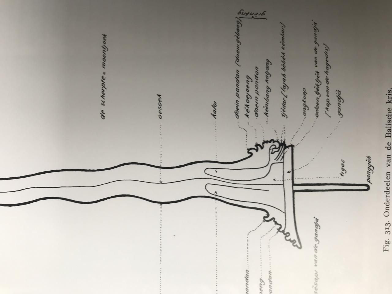

thank you for your reply, i will enclose a picture out of the book:
'De Inlandsche Kunstnijverheid in Nederlandsch Indie"
written by J.E. Jasper and Mas Pirngadie part V from 1930 de bewerking van niet edele metalen (the processing of non - precious metals)
I have to check the wewer, and yes i could see it was not a real old one but they are often changed.
And may i ask you how you would clean this blade? Is it the same as when cleaning it from rust with household vinegar? Or the traditional way with cocoswater and lemon.
I will enclose a picture from Jasper and Pirngadie.
regards, Martin

Thank you Pendita.
That explains a lot, old Balinese terminology, & perhaps not quite as we know it now.

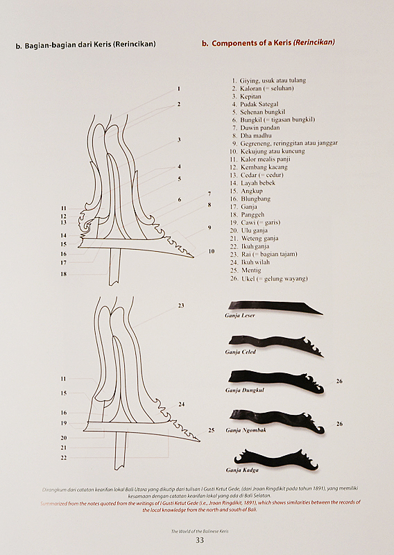

I've posted a pic that I've copied from "World of the Balinese Keris", this shows how the terms for keris characteristics in Bali had some variation from Javanese terms.
At the present time I don't know anybody who regularly uses these terms. I do know a few pandes & tukang wrongko in Bali, & in conversation they use Javanese terms, the same as I use. Maybe this is because we speak in Bahasa Indonesia, not Balinese. Between themselves they could well use these old Bali terms. I'll see if I can find that out.
