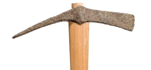

This was represented as a trade axe used during colonial times in the US.
Length overall is 8.5".
Thoughts?

Looks more like a replica roman legionary dolabra pick axe.

I think you will find that it's a slate roofing hammer.
The blade for cropping them to length when needed and the point for making the clout holes.

As I recall, I got this from Bill Guthman when I lived in Westport Ct. Bill and I got friendly and I bought a number of things from him.
https://www.antiquesandthearts.com/n...-guthman-dies/
Good guy. Wrote an interesting article on fakes that I am still trying to locate.

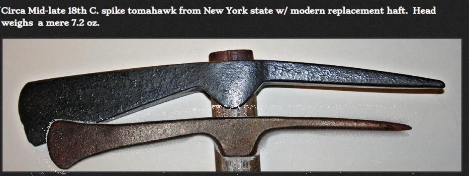

Found the illustration below (thanks for the reference). Looks like they are pretty darn close. Mine weighs 6.5 oz.

I am, unfortunately, suspicious of the manner in which this axe head was made, as it appears to be a product of a more modern casting process rather than hand forging. Axes, like spears, can be so difficult because the same forms reoccur in many times and places.
I bought what was supposed to be a frontiersman's belt axe (for disassembling game, etc.) at a country auction at a genuinely old house in upstate New York. I sent images to Mr. Miller, whose fur trade tomahawk site is linked above, and he suggested it was instead a reworking of a small claw hammer. XRF was very consistent with that interpretation. The estate was that of a former re-enactor who dabbled in blacksmithing.
