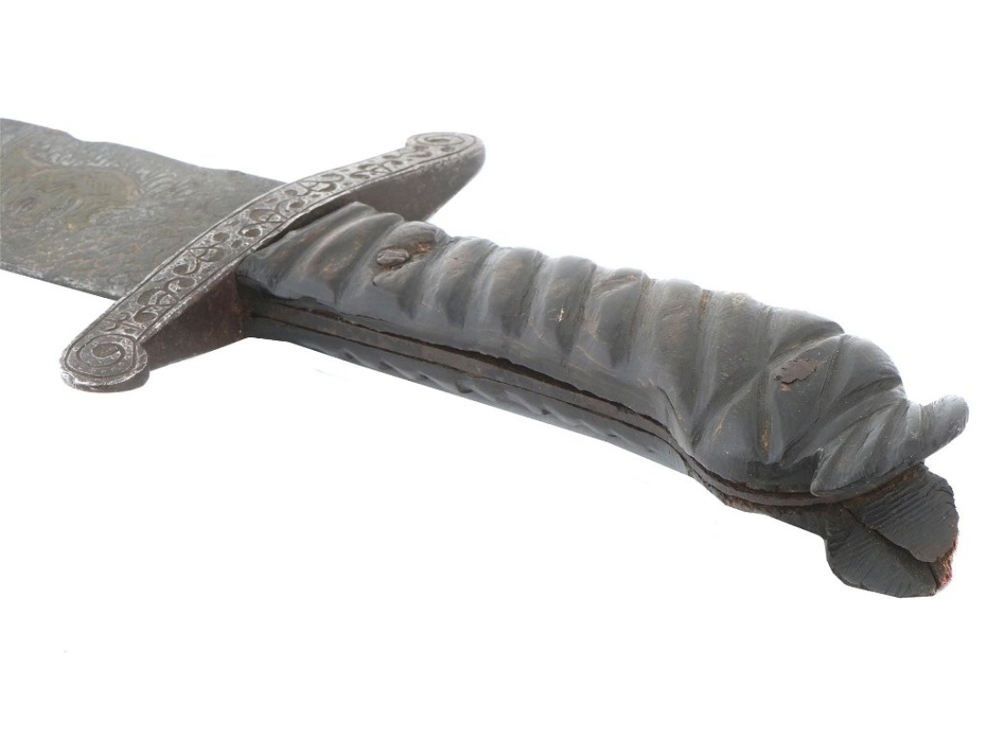

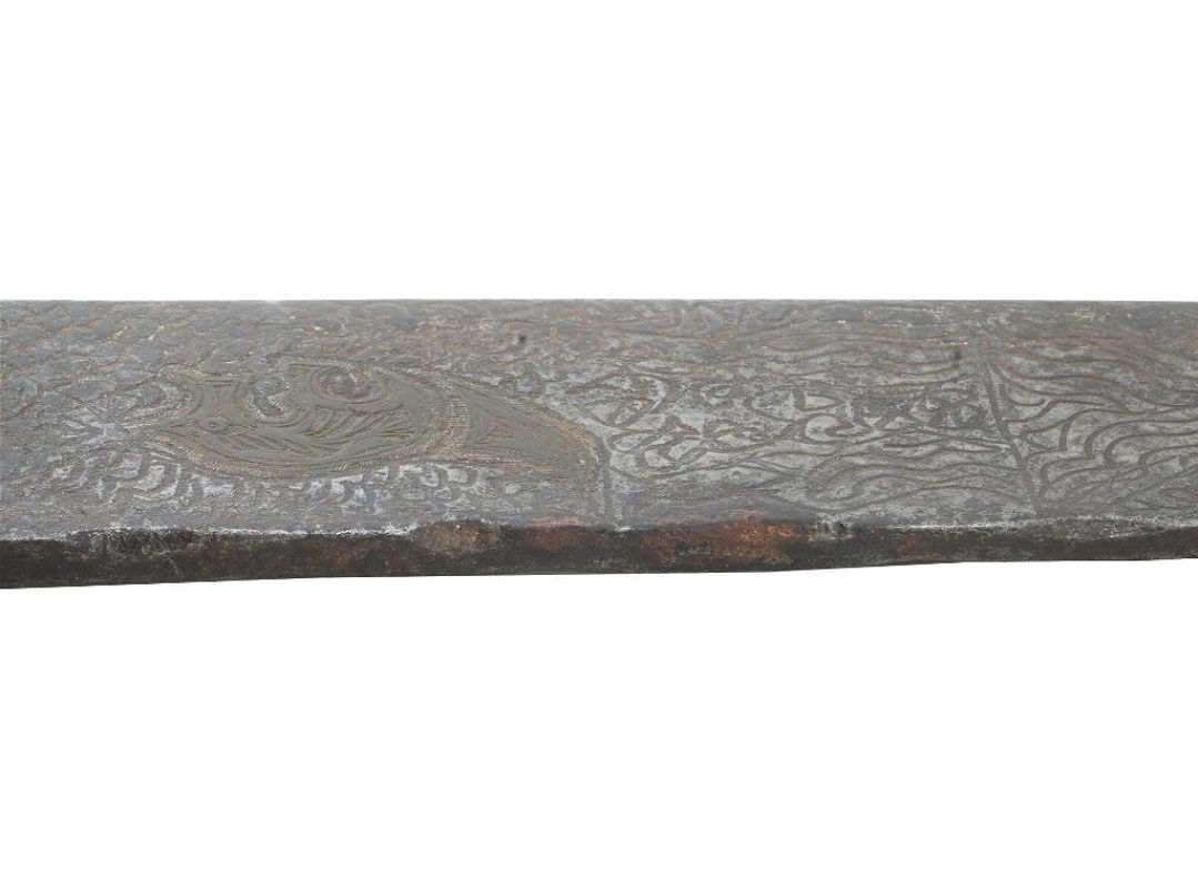

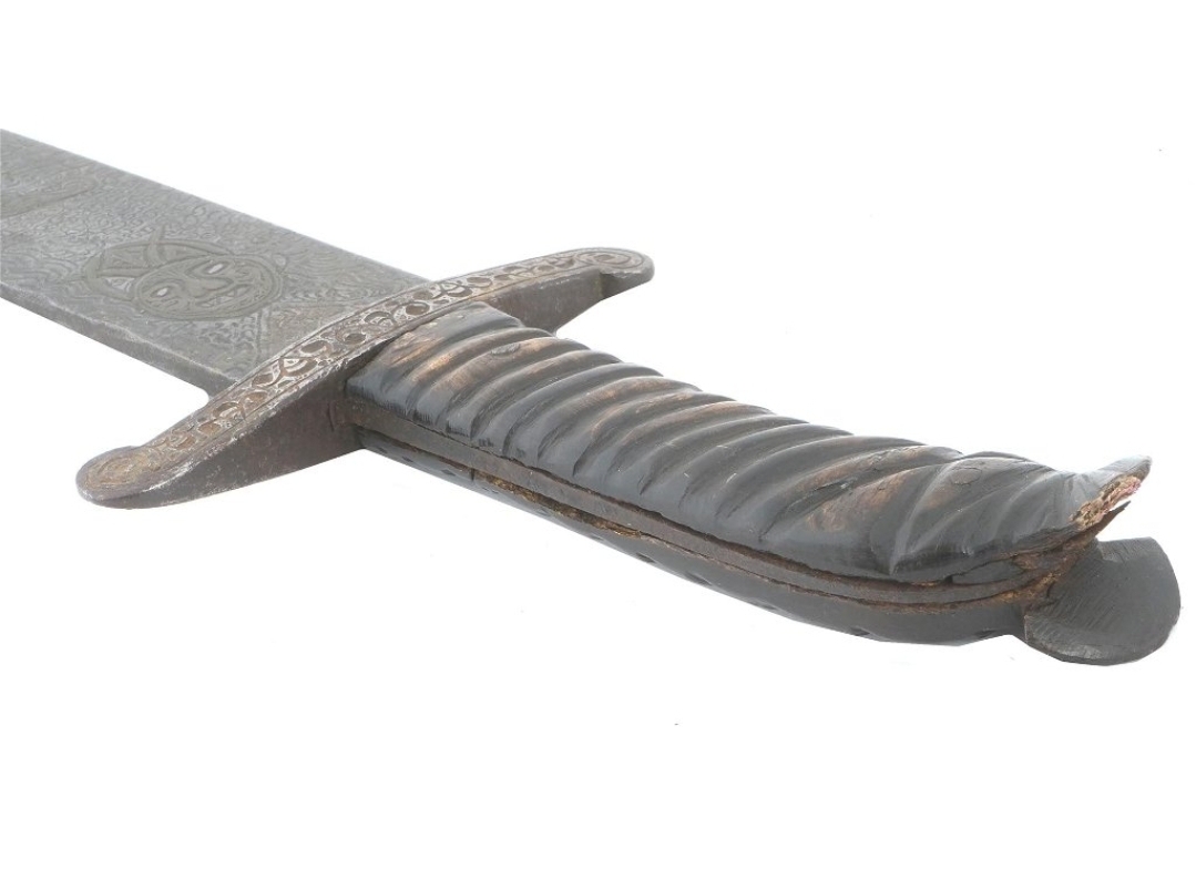

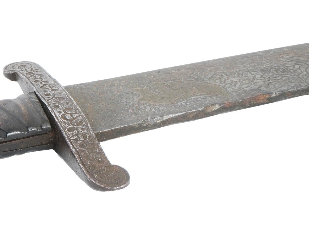

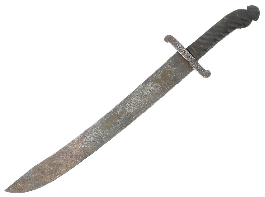

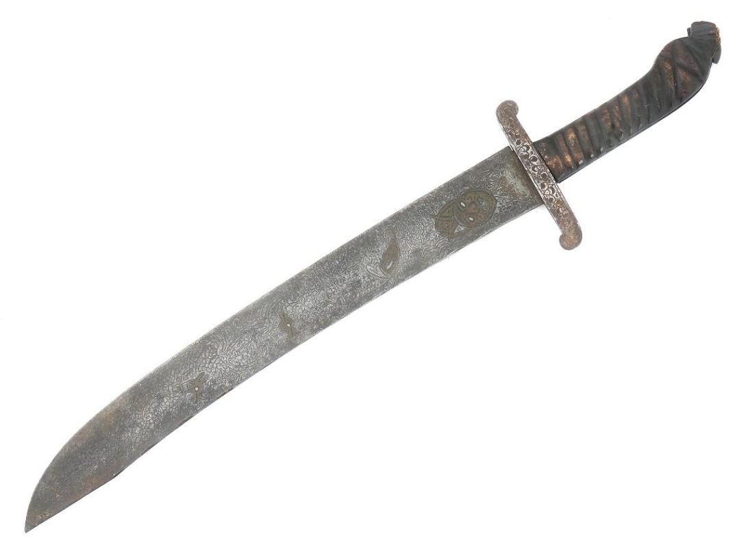

I won this sword in an online auction recently and want to see if my suspicions are true. It was listed as a "North African ceremonial dagger" which I am 99% certain is not correct. From what I have seen on the forum recently this sword bears some resemblance to Armenian style swords but made in a more simple fashion.
The blade is almost cutlass/messer-like rather than the khopesh/laz bichaq style blade more commonly seen on examples of Armenian swords. The diagonally ribbed horn scales seem to be consistent with known examples of Armenian swords. The ears on the hilt seem pretty thin and flimsy, I'm surprised they aren't broken. The sword hasn't been shipped yet so there is still a chance for that to happen.

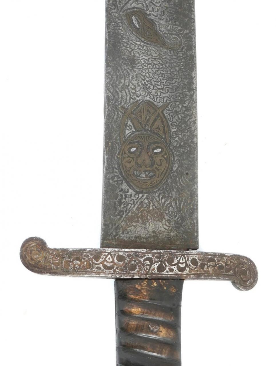

The engraving covering the entirety of the blade is simple but still looks attractive with inlayed faces of what looks like brass, with the side profile face giving a sinister looking grin.
The (approximate) dimensions provided by the auction house are an overall length of 26 3/4 inches with a blade length of 19 1/2 inches.
All comments are appreciated as always, I'm hoping that those with more knowledge on these weapons give their input on this sword.

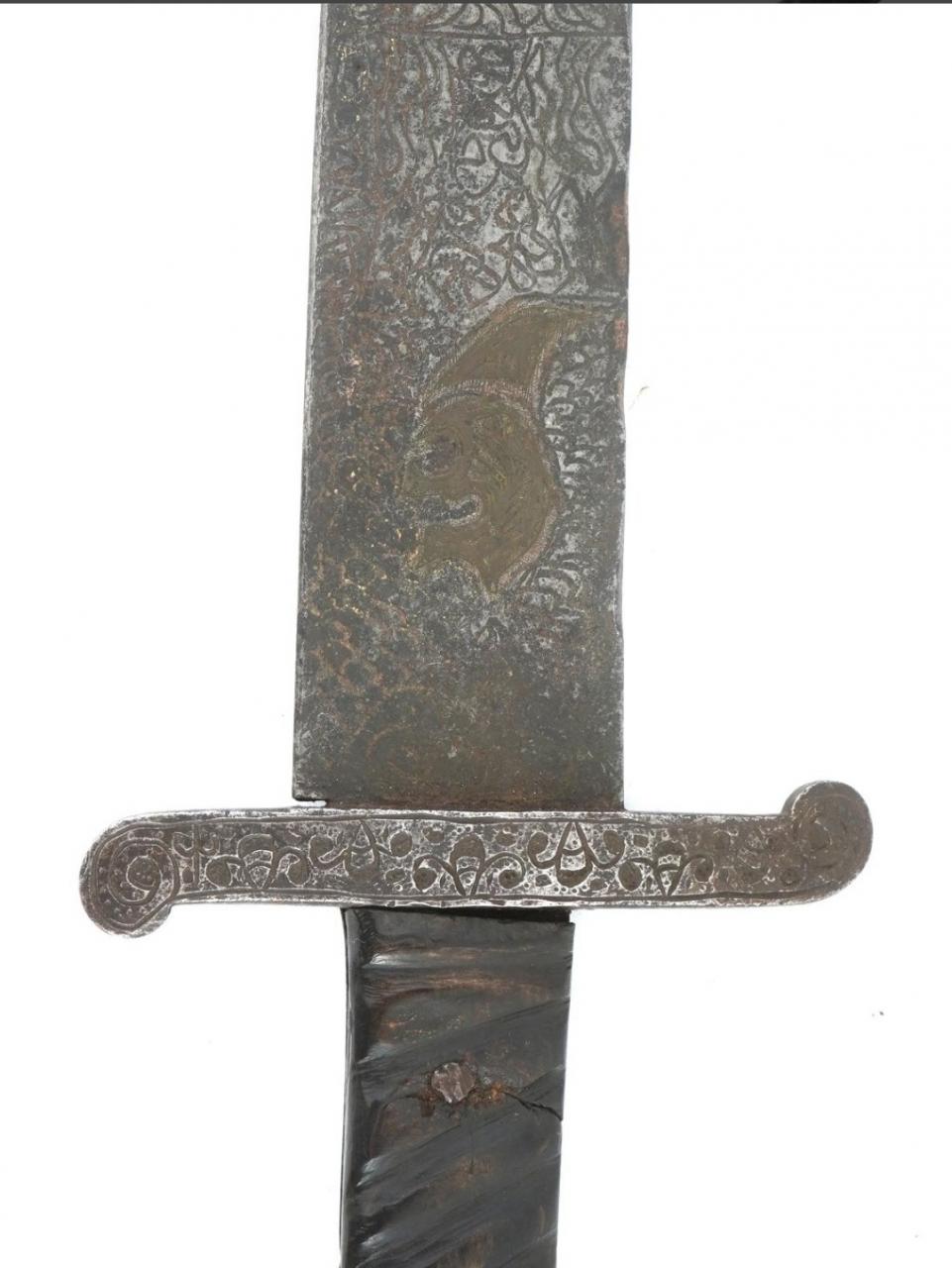

So I received the sword the other day and I have found some interesting things. The hilt is very large for my hands, I can put two hands on the grip with my pinkys hanging off of the ears (thankfully not broken in transit).
The edge bevel is very steep, so steep that at first I thought it was completely blunt. I also can clearly see the designs on the blade which I could not make out from the auction house photos.

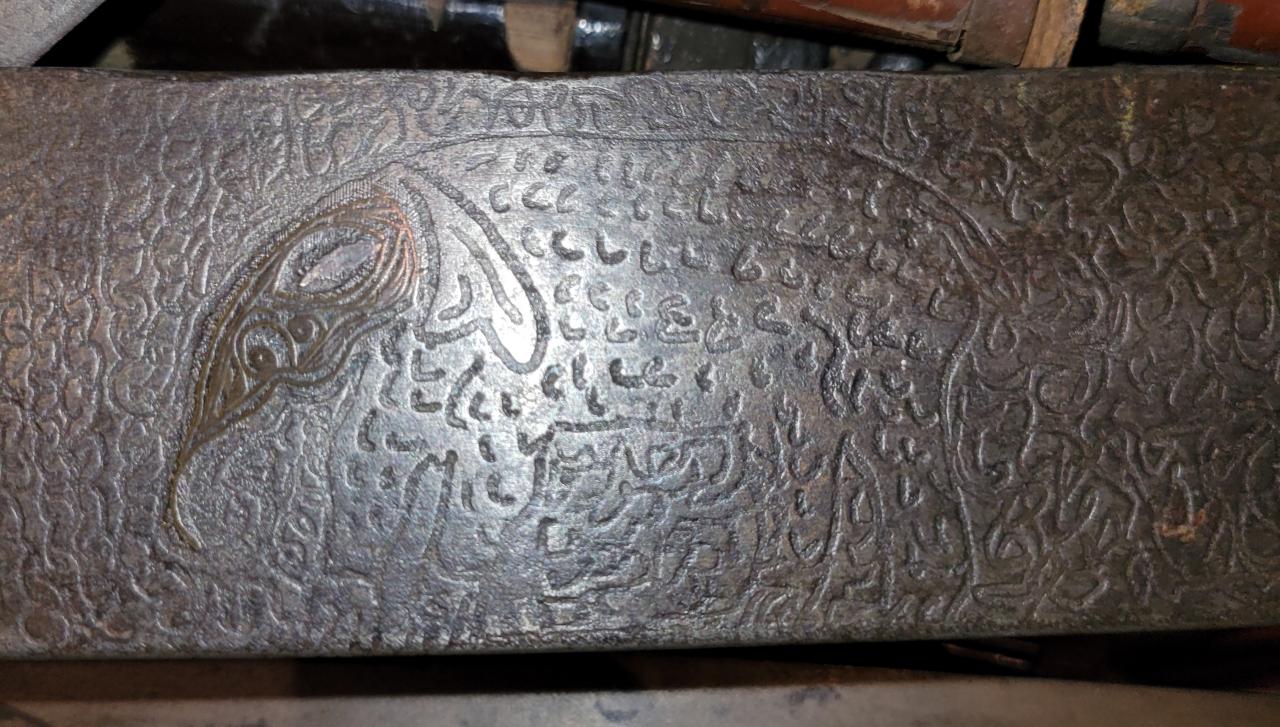

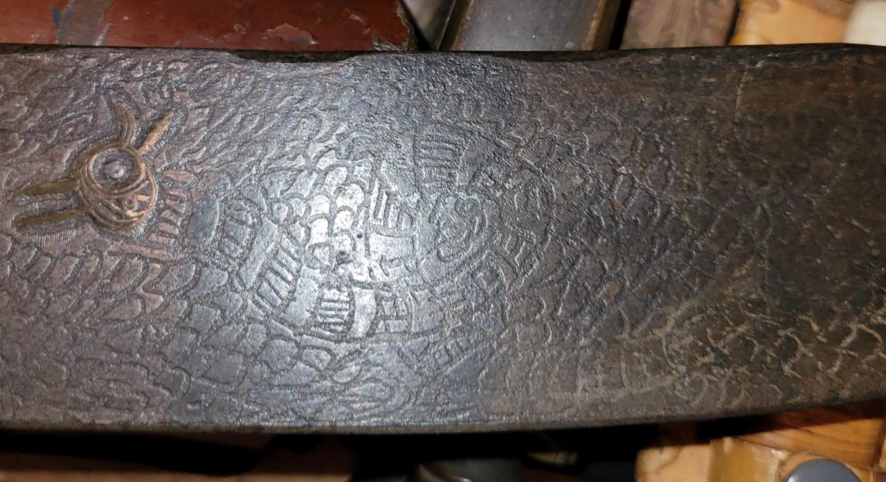

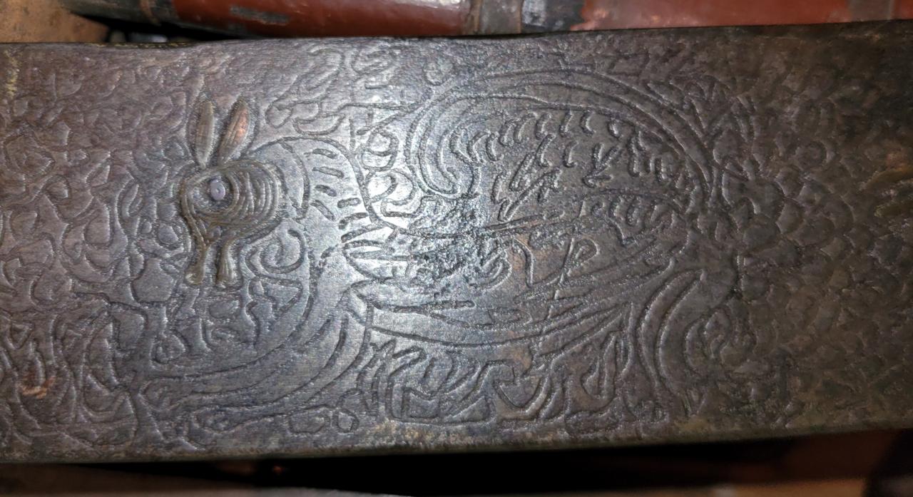

Some of the shapes on the blade that I thought were just abstract blobs are actually animal heads. One is easily recognizable as an elephant, the second one could be a large cat or maybe a wolf and the last one is a serpentine animal with the head of the previous large cat or wolf.

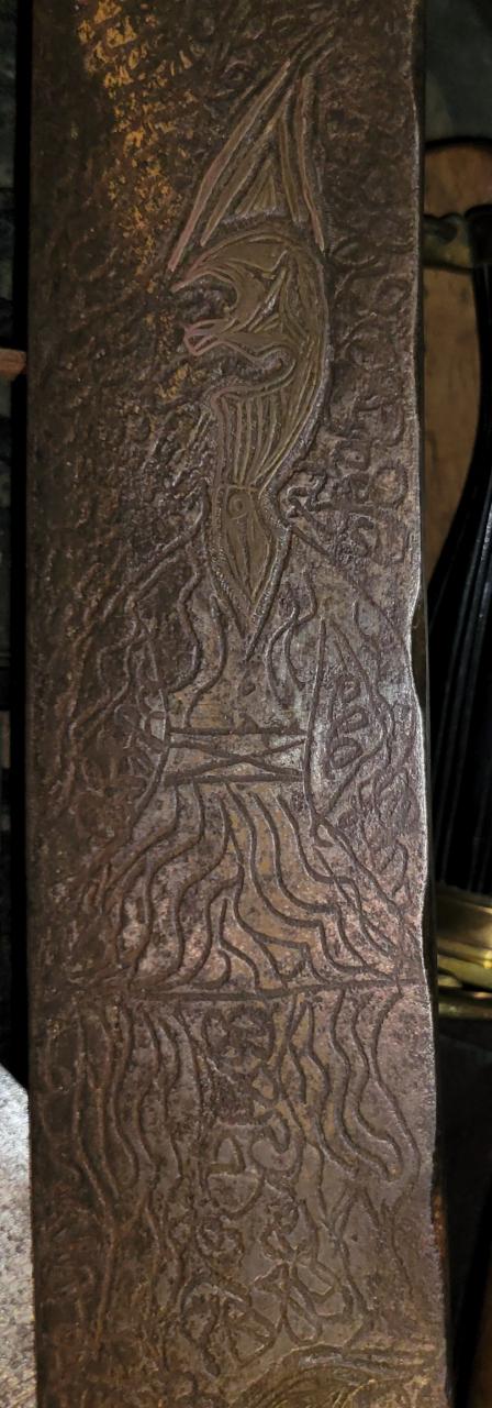

The opposite side of the blade with the side profile face giving the nasty grin has a full humanoid figure above it. I hope someone can recognize this figure's attire in spite of my terrible pictures.
Pitt1999 is offline   Reply With Quote
Old 20th May 2024, 06:11 AM   #8
Posts: 5,999
Very interesting, I like it. However I don't think the "elephant" motif is an elephant. I would suggest it is a
Caucasian badger.
Old 20th May 2024, 06:42 AM   #9
Posts: 5,999
Better and more likely the "elephant" motif is probably an Aralez. What seem like elephant ears are wings and the animal is depicted in the act of licking so to heal wounds.
The other motifs also relate to Armenian mythology.
