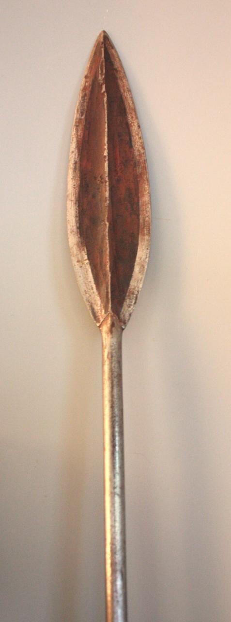

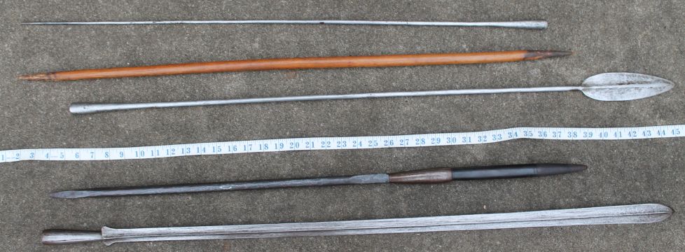

Default African Spear
Perhaps African. It is just shy of 7 feet overall. It is in three parts, much like a Maasai spear: the butt end is pointed and is 37". The wood center piece is 18". The Pointy piece is 27" with the spear head itself about 8".
Any thoughts as to origin?

Maasai, Samburu, Karamojong, Turkana, etc. come to mind as possible sources. This spear type is common in East Africa.

It "feels good" to me if you know what I mean.

I don't know much about spears, especially not about African ones but the one in question shows a very different quality as the other shown ones.
I had some antique Maasai spears, the description of the three segments point to a origin like suggested, but the tip looks different.
Ed, can you show more from the spear? Haft and butt?

Here are some more pictures. The two sides of the head are virtually the same. Please ask if you need more description.

Ed, I may upset you. This spear is made in Kenya or Tanzania for tourists.

It's indeed typical for the Maasai and surrounding ethnos but it seems very recently to my eyes. I don't think it's manufactured.

It seems rather ungainly for a tourist piece.

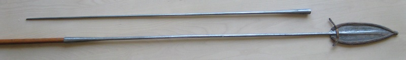

Hello Ed,
can we see a larger photo of the blade and shaft connection?
Can you tell if it is welded or forged?
To me this doesn't necessarily look like a tourist piece, especially because of the length, which is inconvenient for tourists.

most of the spears from Kenia that I have owned and seen would have no problem to be used as a functional spear, their metal is forged not welded but the reality is that , aside from the millions of spears produced in the past for local consumption the same artisans work every day and pretty much in the same way to produce spears for the tourists.

When disassembled, the spear is disassembled into 3 parts. Each part is 35-40 cm, fits well in a suitcase. I brought swords, knives and spears from Tanzania and Kenya. The last time my suitcase weighed 24 kg.

I was talking about the spear from the first post by Ed.
The longest part is 37" and, if I'm not wrong, this is nearly one meter.
Ok, I have also brought back weapons of this lenght, but it's not designed for the common tourist.
And by the way, the blade looks like a fine work, not like the usual poor quality tourist blades. (And also the recent Massai Blades from the same lower quality)
Best regards

37"=94cm
244cm overall
Dunno. The butt end is more than twice your example in length. You could certainly carry it, it just seems very awkward.

It looks forged to me. Note that the margins of the head are not deformed. If welding level heat were applied the margins, being very thin, would have melted or been deformed.
Thoughts?

It looks as if the two parts were made individually until the end and then forged together.
The filing marks don't look like power tools either.
A slightly older age can therefore not be ruled out.
Are there any metalworking experts here?
By the way, based on the shape of the blade, I would suspect that it is of Turkana origin rather than Maasai or Samburu.
