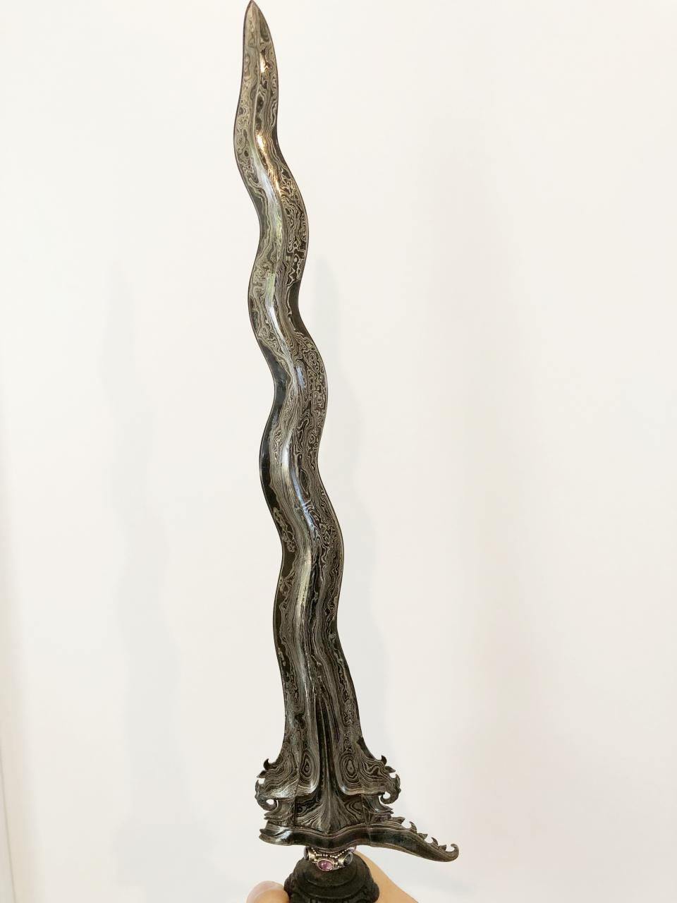

Kamardikan Balinese Keris from the same maker as my previous Balinese Keris for your comments.
When the pamor touch the edge of the blade as you can see here, is that a sign of a not so well controlled pamor?

I must admit that i have never been particularly attracted to this dhapur, and i can't recall seeing too many old Balinese keris that use it. But it appears to be a nicely dressed and well made kamardikan blade.

Yes YS, the edge of the blade should always be free of pamor, it should show a black "frame" all the way around the blade.
However, this blade does appear to be nicely welded & well sculpted. Both blade faces should be mirror images, one of the other.

Yes, i believe it may well be a Javanese dhapur and only recently do we see Balinese style keris that employ it.
It is not the fact that your keris has luk with this design that i don't care for. I just don't personally enjoy the double Sekar Kacang on keris. It almost always has an awkward appearance for me, even with keris lurus.
