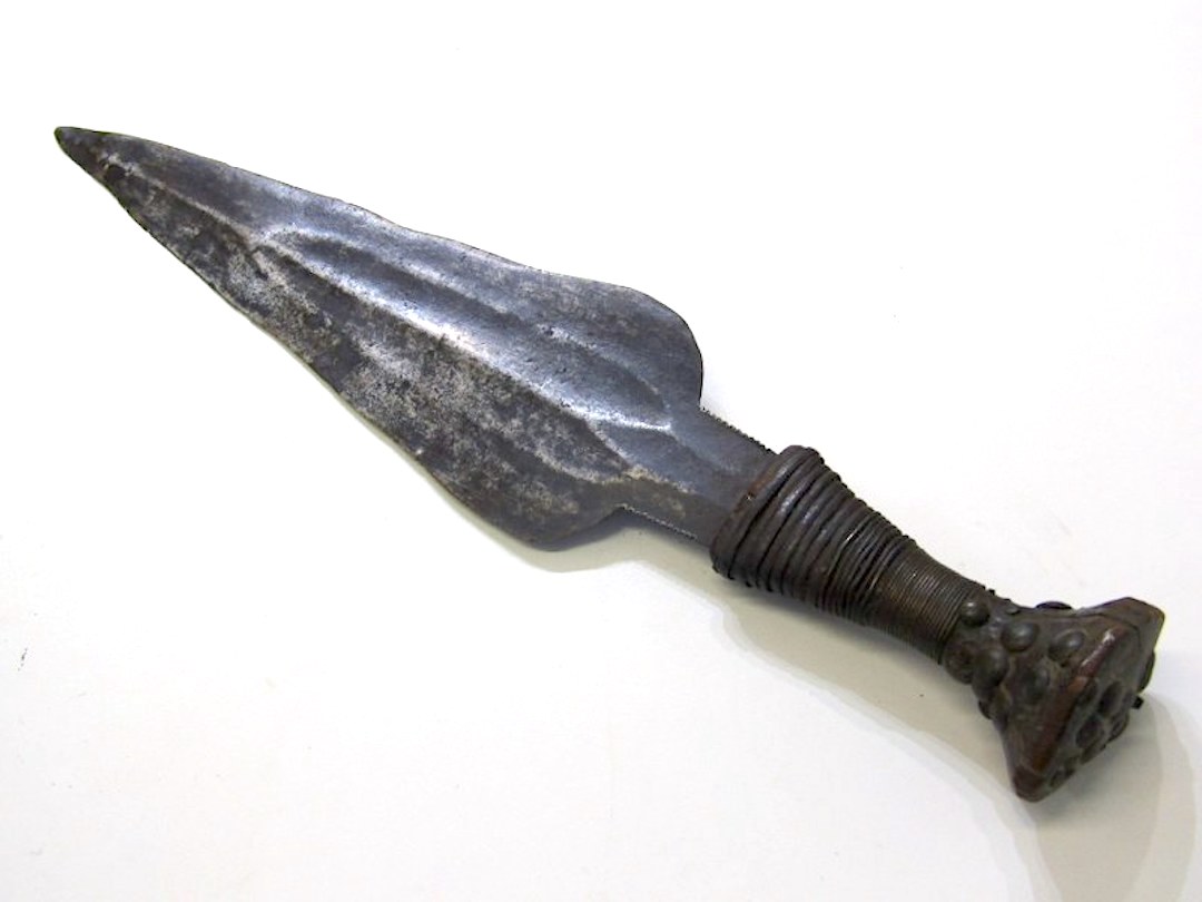

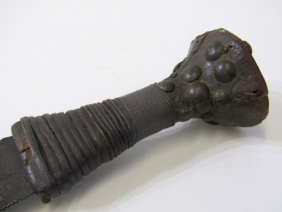

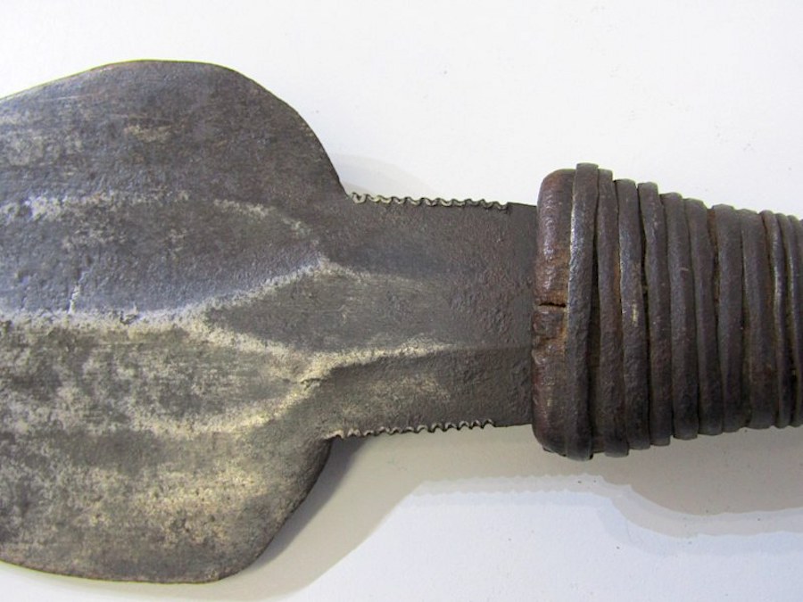

This knife was brought back to England in the late 1880s and has been in the family since that time. I don't know the name of the man or the family. The knife is heavily patinated but appears to have survived well. Given the timing of the individual's return to England, shortly after the period of the Anglo-Zulu Wars, the knife is probably from that general era. Whether it came from the conflict is lost to time.
It is uncommon in my experience to find old African knives with a reasonably well defined date. OAL = 42 cm (~16.5 in.)

It's not Zulu but from the Congo, I would need to search for it but the blade shape and the bullen nails are the give-away!
Detlef is correct, Mongo, Saka and ngandu in Central Kongo.

Thanks guys. I appreciate the correction. The Congo is an odd place for an Englishman to be in the late 19th C. Like so many "family stories," they are often erroneous. The age, however, seems reliable.

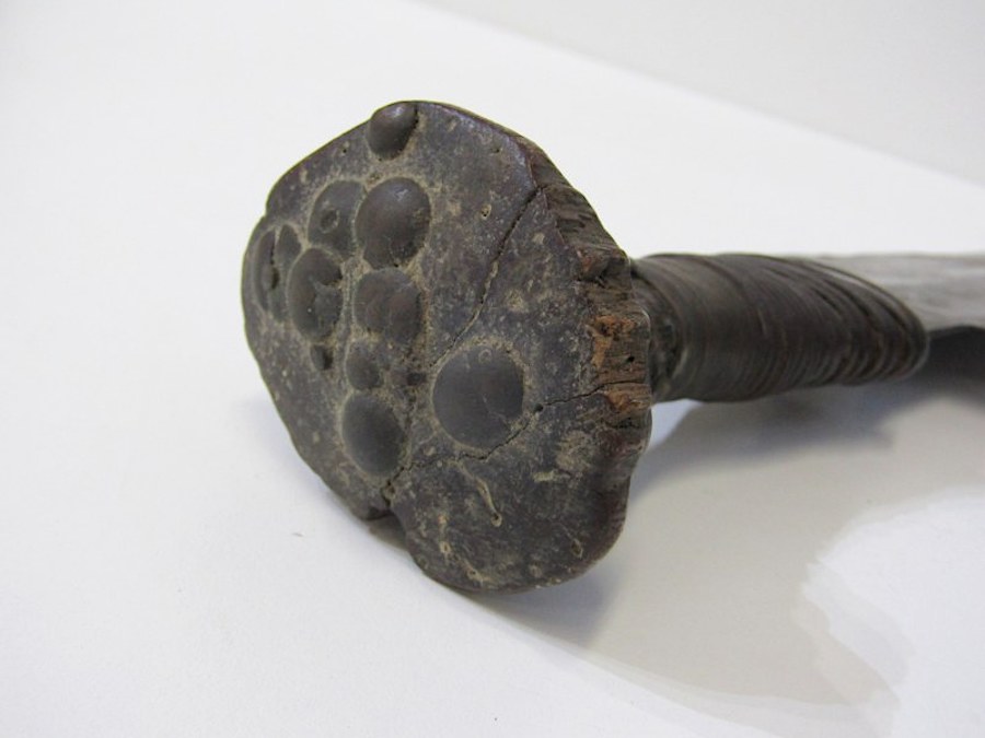

Thanks Ken. Yes, it is a lovely knife. I will clean some of the dirt and grime off it--just a runover with a damp cloth--and oil the blade. The hilt may need some help if it has dried out a lot.

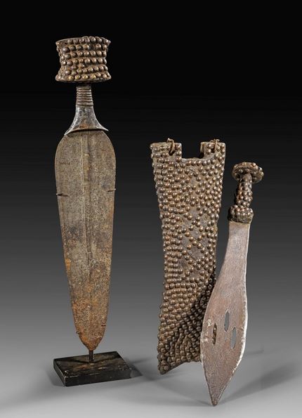

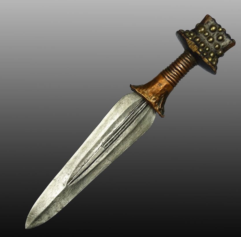

I think it might be a Tetela knife, both the shape of the knife as also the use of nails in the wooden grip is often seen with the Tetela people (AKA Batetela),
although the nails decoration is also present with other tribes

adddition: it could also be from the neighbouring Konda's..

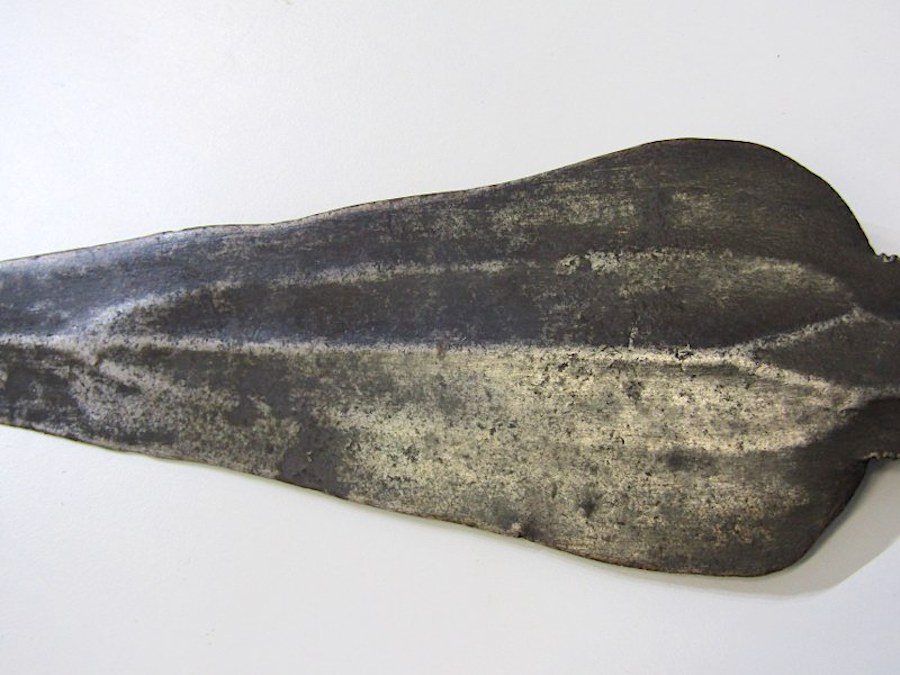

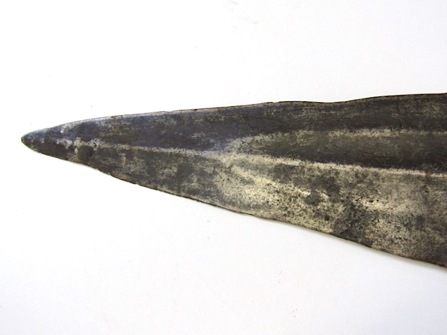

The blade shows encrusted rust at the base as the iron binding on the handle as well, to preserve such a nice knife for future generations this should get removed. The wood looks extremely dry, Ian stated this as well, so it needs to get oiled, for the same reason, to preserve it before it falls apart piece after piece.
The surface from the pommel looks very dirty on the pic, when you display antiques you will know that insects leave their residues everywhere, dust covers wood after one week already, many collectors don't care enough (in museums sometimes also) for their items. Cleaning the wood with oil rubbing helps to preserve the wood.
The bullen nails will be from brass as well the finer binding in up from the handle, to polish it up a little bit will show why they were attached originally.
The blade can receive an oil rubbing with 000 steel wool, with this you don't remove the partly black surface but flash rust the blade has received in the last decades.
You don't destroy the patination but highlight them IMVHO.
