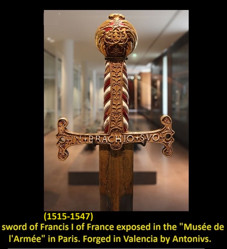

"sword of Francis I of France exposed in the "Musée de l'Armée" in Paris. Forged in Valencia by Antonivs ".

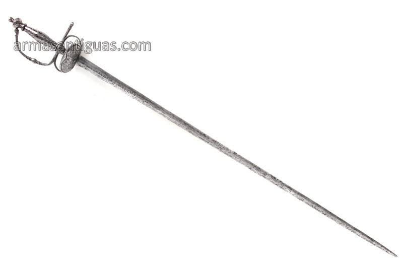

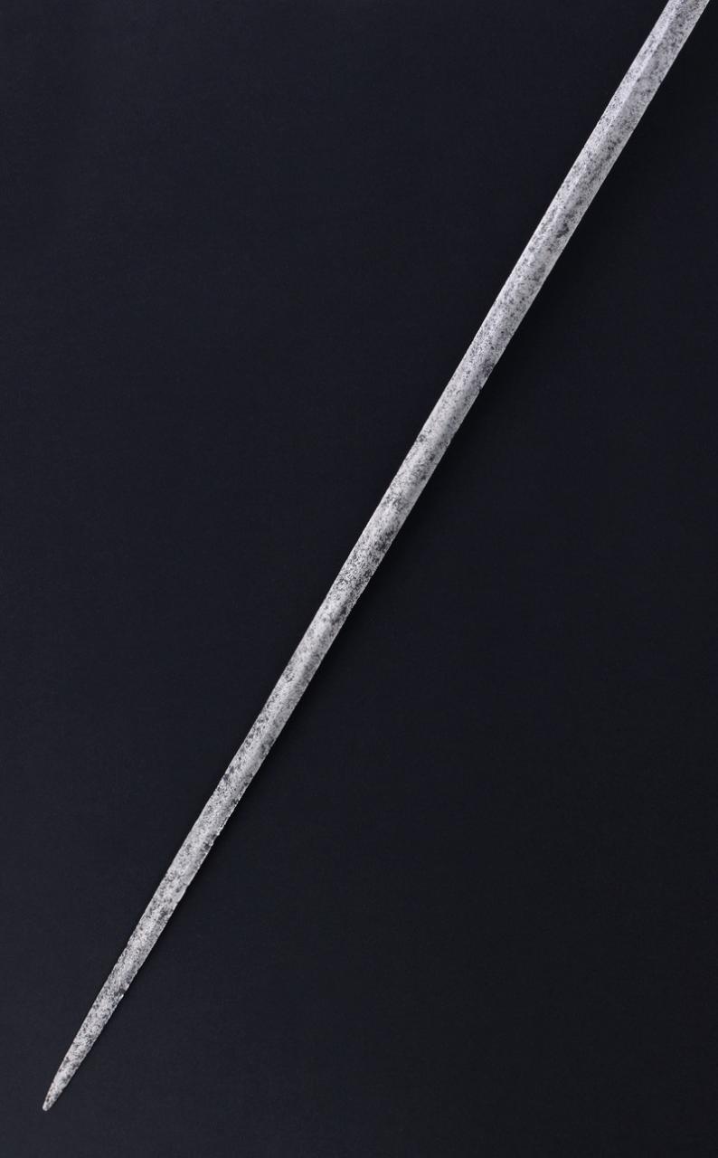

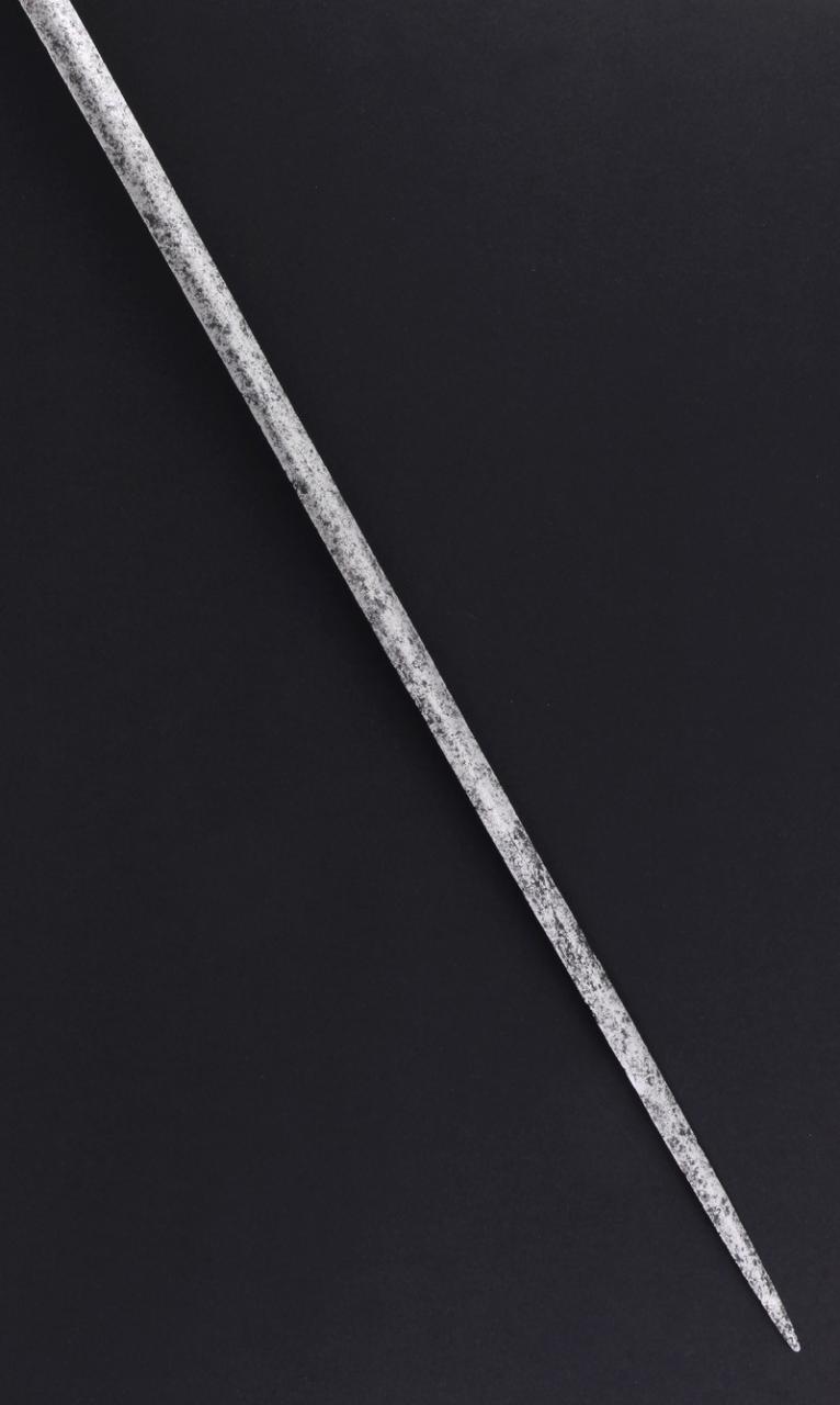

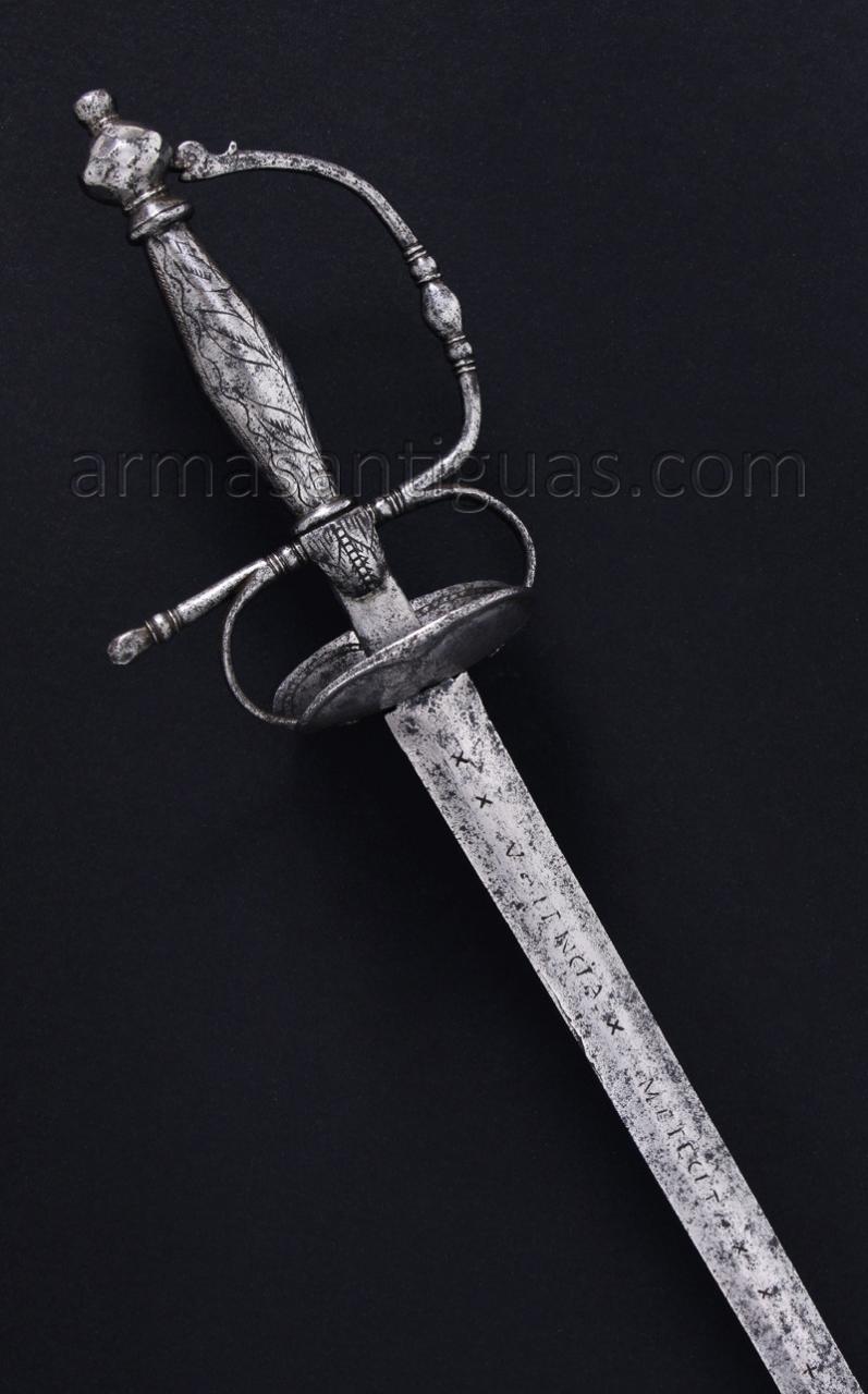

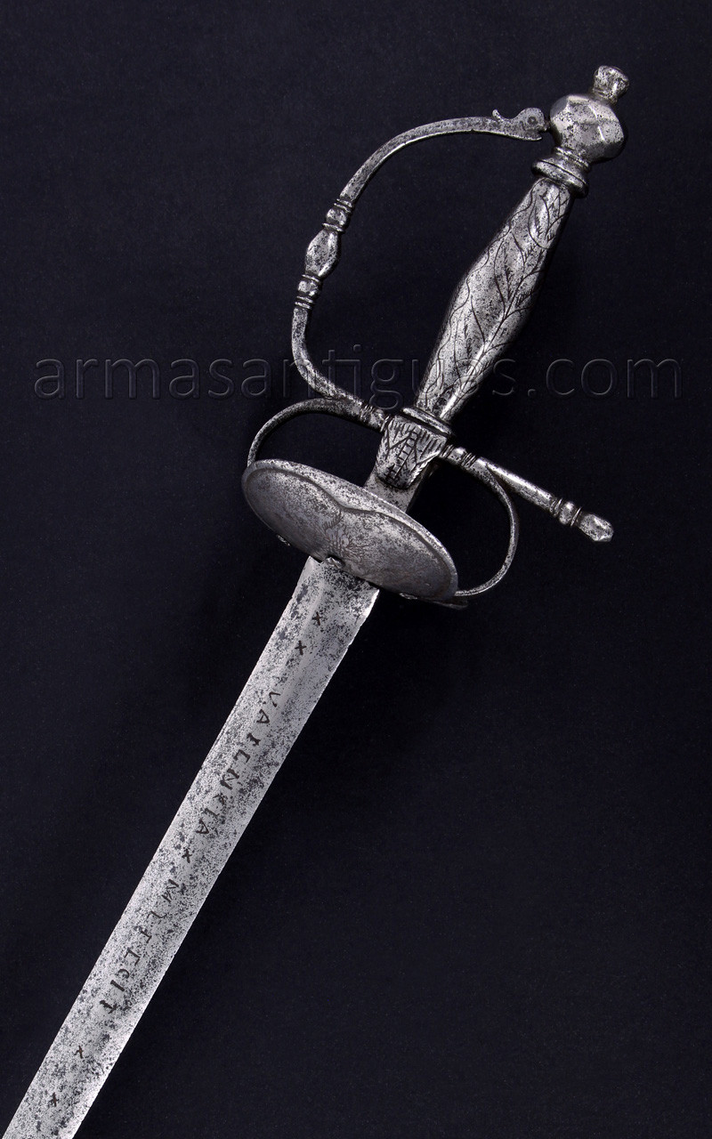

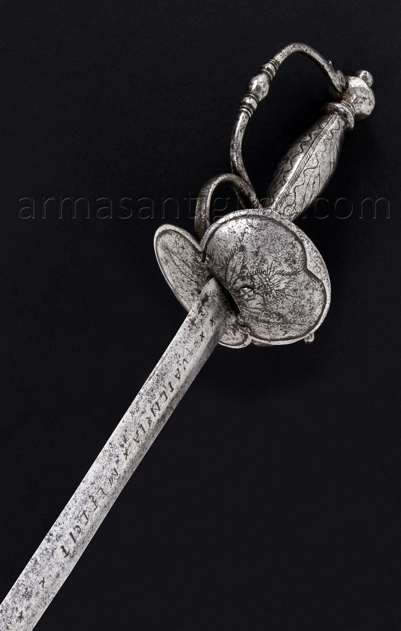

This is a smallsword from Valencia.
Dish attachment through 4 screws in a lozenge, as some 1728 cavalry swords.
