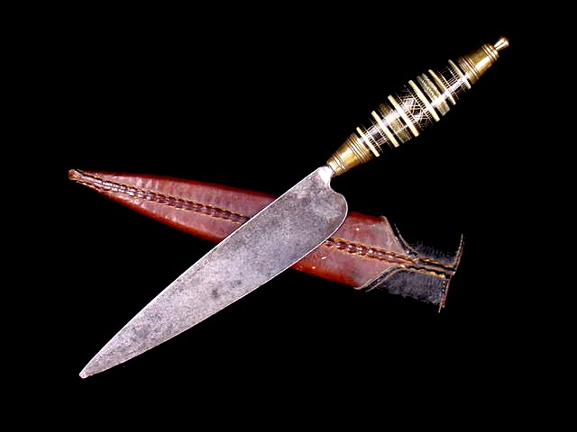

This is a tale of two nearly identical daggers that went to auction within a few weeks of each other. They are the only two examples of this knife that I have seen. The first went to auction on November 23, 2023 and was passed in. The second was sold by a different auction house on January 7, 2024.
1. Described as "19th C Canary Islands Dagger"
The brass guard and pommel clearly have some oxidation suggesting a certain amount of age, as does the presumably brass scabbard. The blade shows some signs of lamination, although it is hard to identify due to some oxidation and grime. The stacked hilt seems to include rings of horn and shell interspersed with iron and brass. The pommel has a depression that would fit the thumb when using an ice-pick grip.

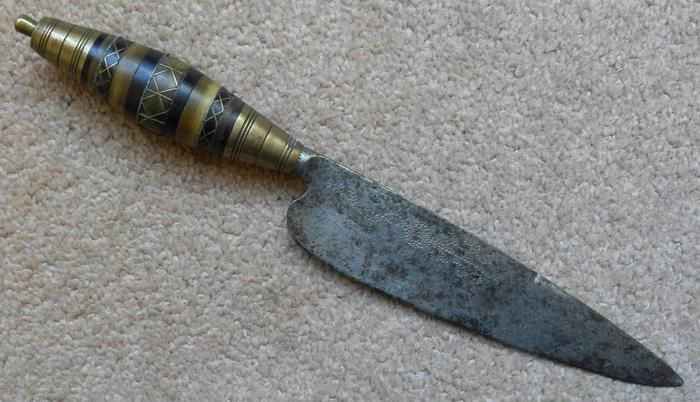

2. Described as "18th–19th C Spanish or Philippines Naval Dirk"
This one has been thoroughly cleaned and looks much newer, but I think they are the same age judging from the stacked hilts. The stacked hilt has the same composition as the first example, and there is a very similar scabbard. There are subtle differences in the toe and throat of the scabbard, the curvature of the brass guards, and in the details of the stacked hilts.
Both knives are said to measure 11.5 inches in their sheaths.
So, what are they? The stacked hilts don't look like those on the traditional Canary Islands naif. The hilts have some resemblance to those seen on Chilean corvo, but the rings seem looser and less varied in composition. I've not seen many stacked hilts from the Philippines, and none that looked like these. The close fitting scabbards might suggest a French origin and the thumb groove on the pommel would also fit.
Where do they come from? If there are two, there should be more. Has anyone else seen these daggers before? I tried a Google image search and got nowhere. I have not searched through Artzi's or Gavin's copious archives, but prior inspection for other items did not turn up anything like this as far as I recall.
Mystery .... ????

Hi Ian,
It's for sure not a Canary Island knife/dagger and I also strongly doubt that it's Spanish/Philippines. French?

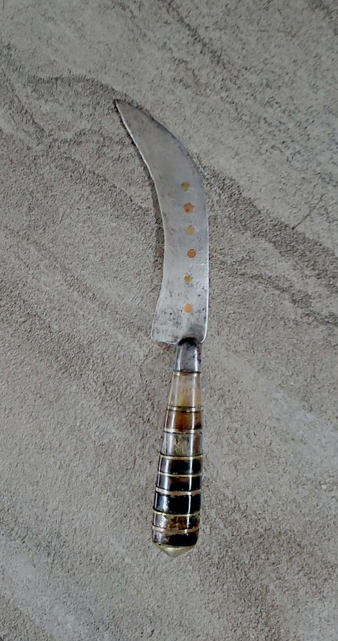

Hello Guys - here are 2 photos of my corvo. Looks similar to knives posted previously. This is a pretty well made knife overall. I often wondered if it is a tool or a weapon...
SwordLover79 is offline   Reply With Quote
Old 9th January 2024, 01:23 AM   #8
Posts: 4,749
Hi SL79,
Both a tool and a weapon. As a weapon, the corvo is a very nasty one used against soft body parts such as the abdomen and neck. It was much feared by opponents. A peasant knife, it was converted to military use and infamously used in the War of the Pacific between Chile and Peru in the mid-19th C. Two modified versions are still in military use by Chile. There is quite a lot of information about the corvo in the Ethno Forum pages.
Your example shows the typical, tightly stacked hilt on these knives. The OP of this thread shows that the various disks on the hilt are loose and mobile, unlike the tight finish on a corvo. Thanks for showing your example for comparison.

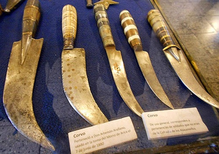

Also I have had one Corvo knife for some time and knew a little of the history of the War of the Pacific (1879-1884) in which these were used with Chile against Bolivia and Peru.
Regarding the 'stacked' type grips, which seems an affectation from the Canary Islands which apparently had become a favored style on the Chilean knives, it seems the Canaria knives had blade shapes that were unique as the Chilean.
The Corvo seems to have evolved from the 'grape hook' knives used of course in the wine industry which prevails there. These deadly knives as described were often used by bandits etc. and were colloquially known as 'cutthroat knives' in a pejorative sense. The dramatic effectiveness of them in this conflict was well noted and they became produced for military use in larger size.

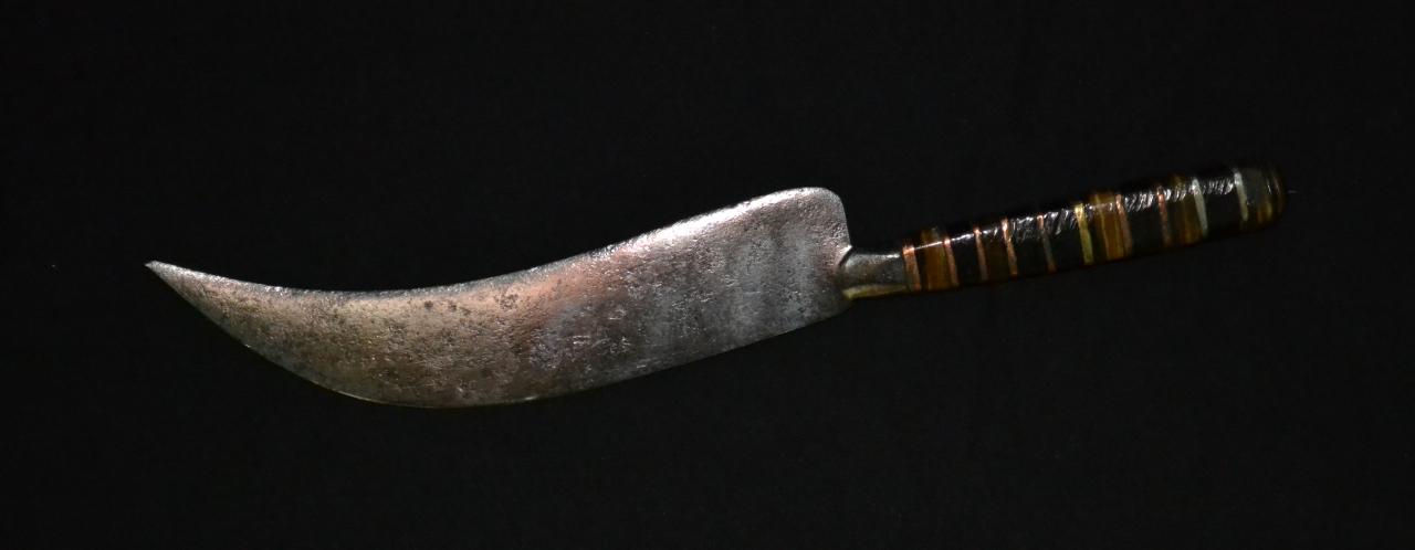

The images are my example, which has the gold metal inlaid dots in sequence, in which the symbolism or significance is unclear. I have been told this is an older (pre 1870s) example.
The other is of several corvo variations.
also added the canat island knife

I see what you mean on the character of your knife, which is of course an entirely different form than the knives of Chile and the Canary Islands.
In looking at the interesting blades of the Canarian knives, the curious profile of them reminds me of what seems to have been a rather ubiquitous form used by sailors on vessels traveling the trade routes. If I recall these became known as 'Meditteranean' knives, and one distinguishing feature noted was a 'notch' at the back of the blade near the hilt, a sort of choil in effect.
Not wishing to deviate further, I hope someone out there might come in with more here. The blade,size etc. does seem to have a European gestalt and imitation of hilt affinities from well traveled regions would seem expected.
Your point on the character of the execution of the 'stacking' in your example does support your suggestion of other than these regional locations known for this feature as an origin of the knife.

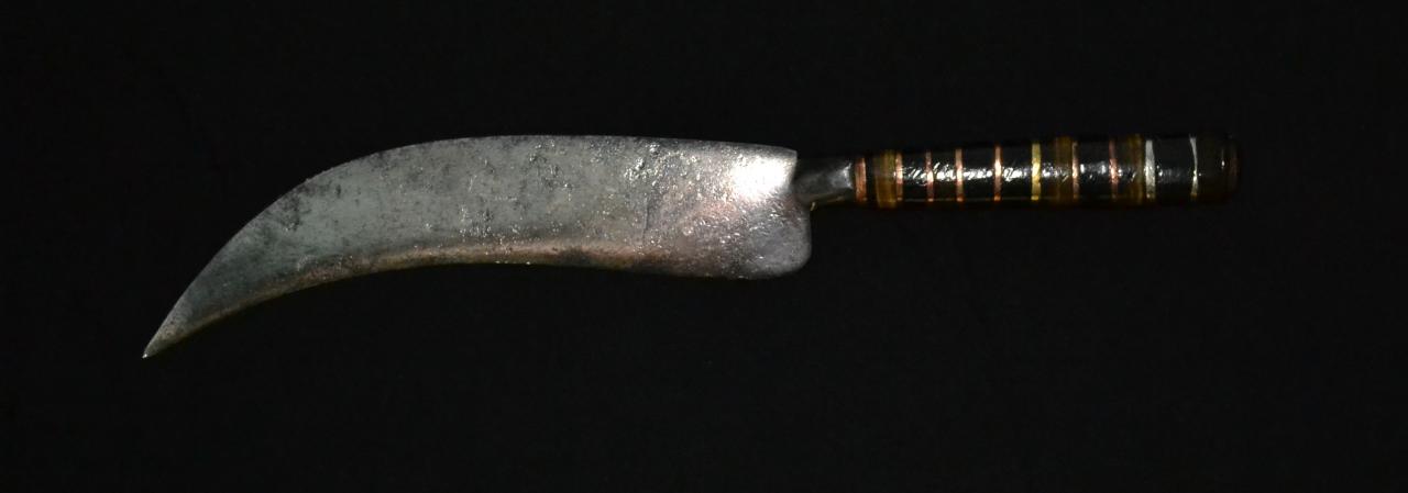

PHOTO: a very formidable looking TOOL, known as the Canary tool.

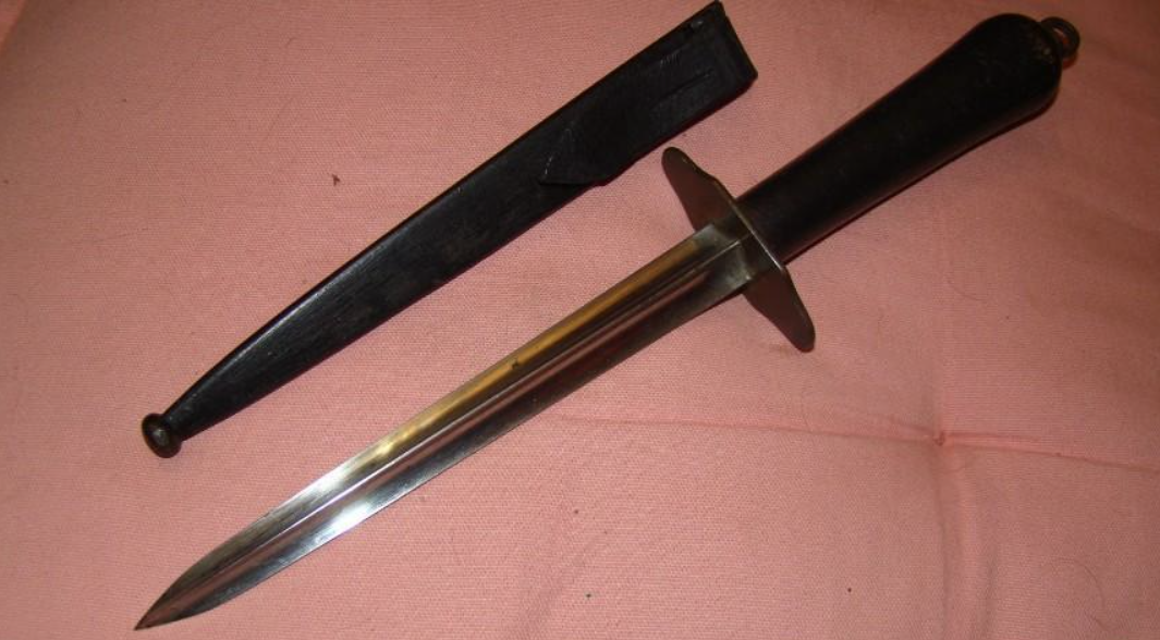

"Described as "18th–19th C Spanish or Philippines Naval Dirk""
Jumping back to Post 1.
And obviously ignoring the intricate handle, but it does have a slight resemblance to the 1833 French government issue of the Naval dagger (Poignard de Marine), although this had a triangular section blade.
This may explain the above description connecting it to a 'Naval Dirk'. I have never seen reference to a Spanish or Philippine version.
It was part of the Systeme 1833 suite of weapons and came with a leather or metal triangular sheath.
