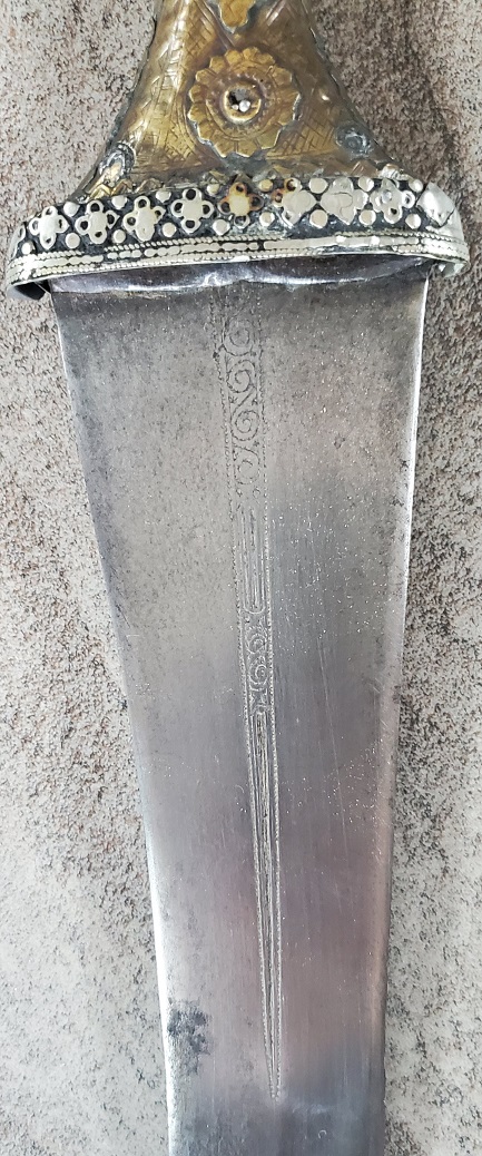

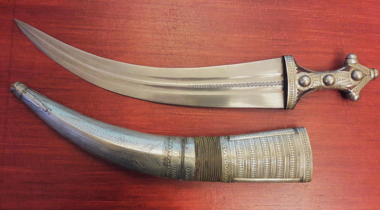

Got this one from a friend... Should really appreciate opinions about it...
I have my thoughts but should like to hear yours...

Not remotely an expert but it looks to me like a Saudi Wahabite jambiya.

I agree.

Also known as a Sabiki, and not really all that much to do with the Wahabi.

Is my blade considered as a tourist blade or...
Just curious!

Posts: 7,404
.....and possibly a little more recent - no patina in the chasing and stamping work........

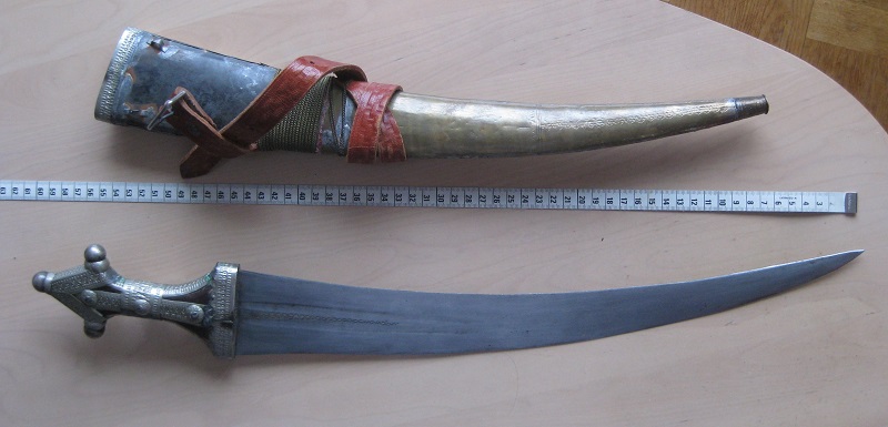

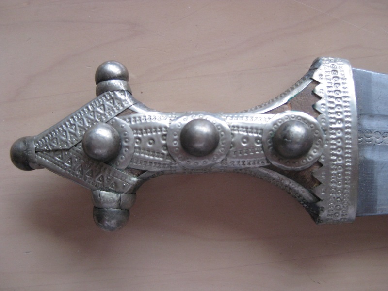

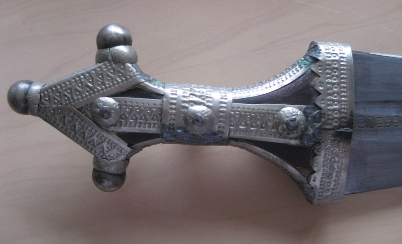

Here is mine, almost the same as yours. I agree they are fairly recent and thought they called Dharia.

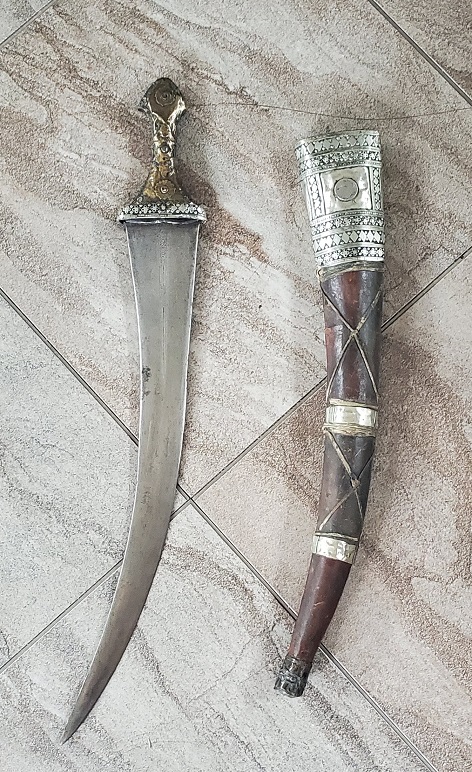

I have had one of these for years, but have had no further notes other than it is a larger than normal janbiyya form from Hejaz, known as 'sabaki' as noted.

"So Hombre, since you are asking for our thoughts, why not share yours?
Its discussion, not poker"
You are correct, Jim! My thoughts are that it is a tourist piece and that it is not very old. Still happy about it because I got it from a friend who knew I was interested in different blades. He has been working in Saudi (IBM) and bought it there... Now when they have grandchildren his wife didnīt want it any longer so...
