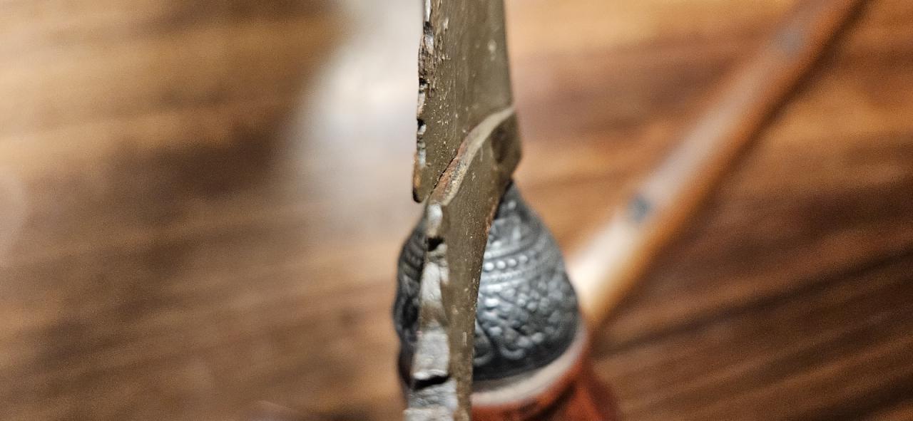

I don't see the problem with the gonjo. Is it bent sideways?
Regarding rust removal, I'd first try local treatment. For superficial rust, repeated soaking with weapon oil and rubbing may be sufficient (gentle work with very fine steel wool is usually safe). Some patches visible on this blade may likely be more stubborn - more invasive treatment will likely remove the stain locally which may be feasible fix cosmetically if needed.

The gonjo is a pressure fit, it could be held in place with a tiny wedge driven down between tang and gonjo, or it could be held in place by tightening with a punch around the tang hole, either way it is a mechanical fit.
Using alloy jaw liners in a vice to hold the blade --- or just folded news paper, the tang can be tapped back into position. I use a jeweler's hammer for this, or you can use a punch & and a larger hammer. Sometimes the gonjo might rise up a bit, but again, it can be tapped back into position. This gonjo out of a alignment thing is pretty common, it can be considered to be normal maintenance. Best to use a punch & hammer to tighten the fit again when the gonjo is back in place. When you have the blade in the vice it is best to use your left hand over the top of the gonjo tail & gripping the blade, to hold it firmly and get feedback on what is happening.

Thanks for the advice, I'll give the gonjo realignment a try. It's only a little bit, but just enough to prevent the blade to be inserted all the way.

The offset gonjo should be easy to fix, indeed. Be gentle and take your time.

Peter, you might find that finger pressure alone is sufficient to re-align that gonjo, and then just tighten the fit of gonjo to pesi (tang) with a nail punch.

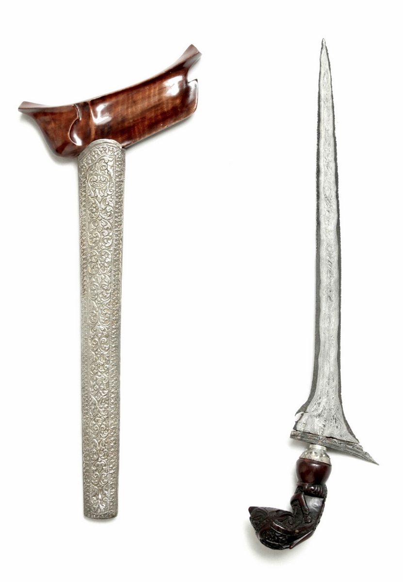

A plain suasa pendok is the norm in Palembang for high-end pieces. Obviously, these are only a fraction of all keris Palembang.
Quite a few ensembles lost such pendok later on. Thus, they are not very common; still, there are enough examples in musea and old collections to prove this local preference.

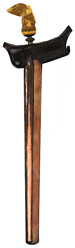

Here's an example that hasn't been repolished for quite a while:
