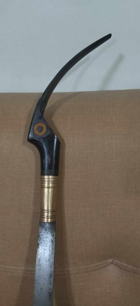

Hello Friends,
A gift from my father. Said to be one of the rarest form of the Moro pira/swords.
The horn hilt- in the shape of a cockatoo's head(pommel) with a long pommel
extension. (brass ferrule).

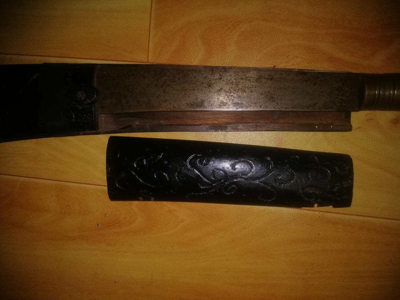

Scabbard: the upper part which forms as a lock(see pic). With some engravings and made of wood (unknown).
OAL: 37.25" (to the tip of the elongated pommel)/ Blade: 19.25"
My father said that it took him 47 years to find one in this form.
A very Merry Christmas to all!
Salud,
Yves

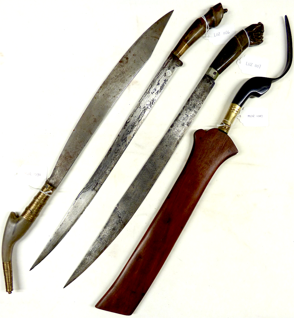

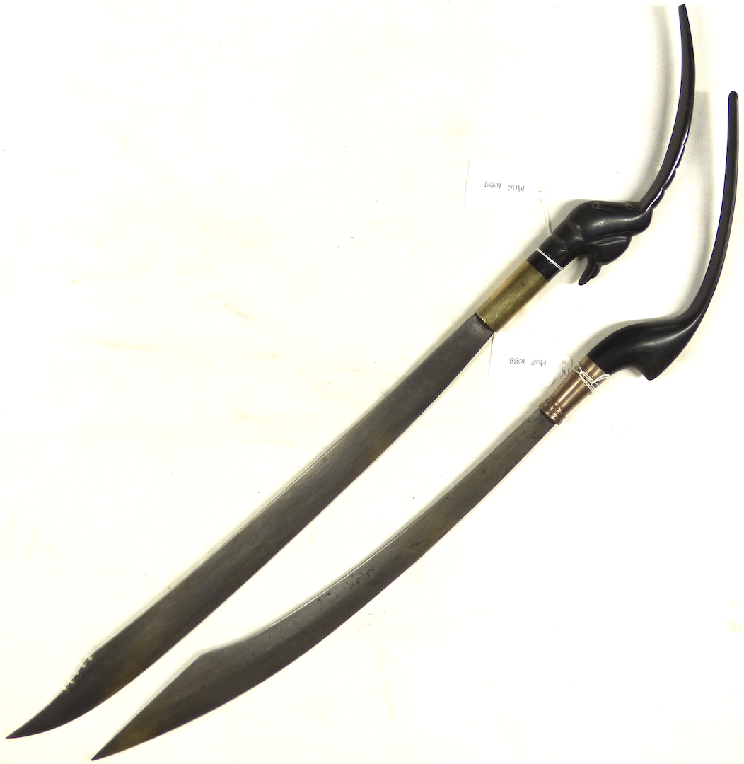

I'm not sure whether you are saying that pira are rare or the hilt style on this particular example is rare. I have a few pira and some seem to have a similar hilt style as yours. They are shown here with some other swords in my collection that are not relevant to this discussion--these are just some pictures that I had on hand.
Ian.

What you have there is a 1920s or later Maranao rendition of the Yakan pira. The hilt is Maranao-made, same with the blade. The blade doesn't have distinct signatures of the original pre-1900 Yakan version (no delineated square/rectangular ricasso before the edge curves down, among other indicators). Furthermore, the hilt extension of your sample is already positioned in a way that it can be struck without the extension getting in the way of the wielding hand (the original pira has this distinct problem/feature).
The Maranao copied the pre-1900 version, along with other Moro blades such as barung, because these were popular among American GIs.
Hope that info helps!

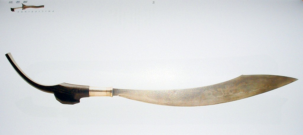

Here is a Pira that went to Macao and is in the History of Steel catalogue.

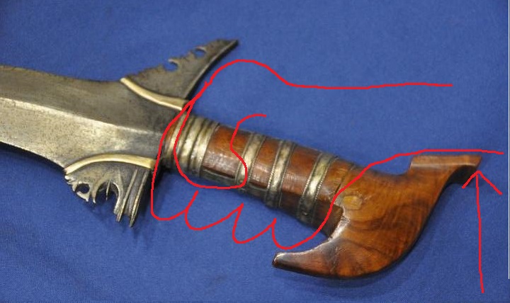

Does the pommel stalk have a function (hooking maybe?) or is it decorative?
The common story is that the extension helps to protect the wrist (i.e. lower arm). Would be great to get more info from inside the Yakan culture...
Obviously, the modern pommel versions tend to be exaggerated and non-functional.

Posts: 686
Interesting. I have noticed that with the kakatua pommel on my kalis that it prevents the wrist from overextending as I have attempted to show below using my amazing paint skills. Could that also be part of it?

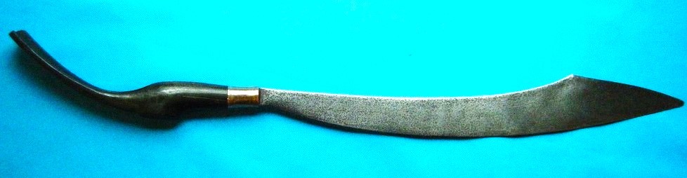

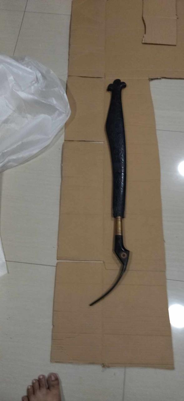

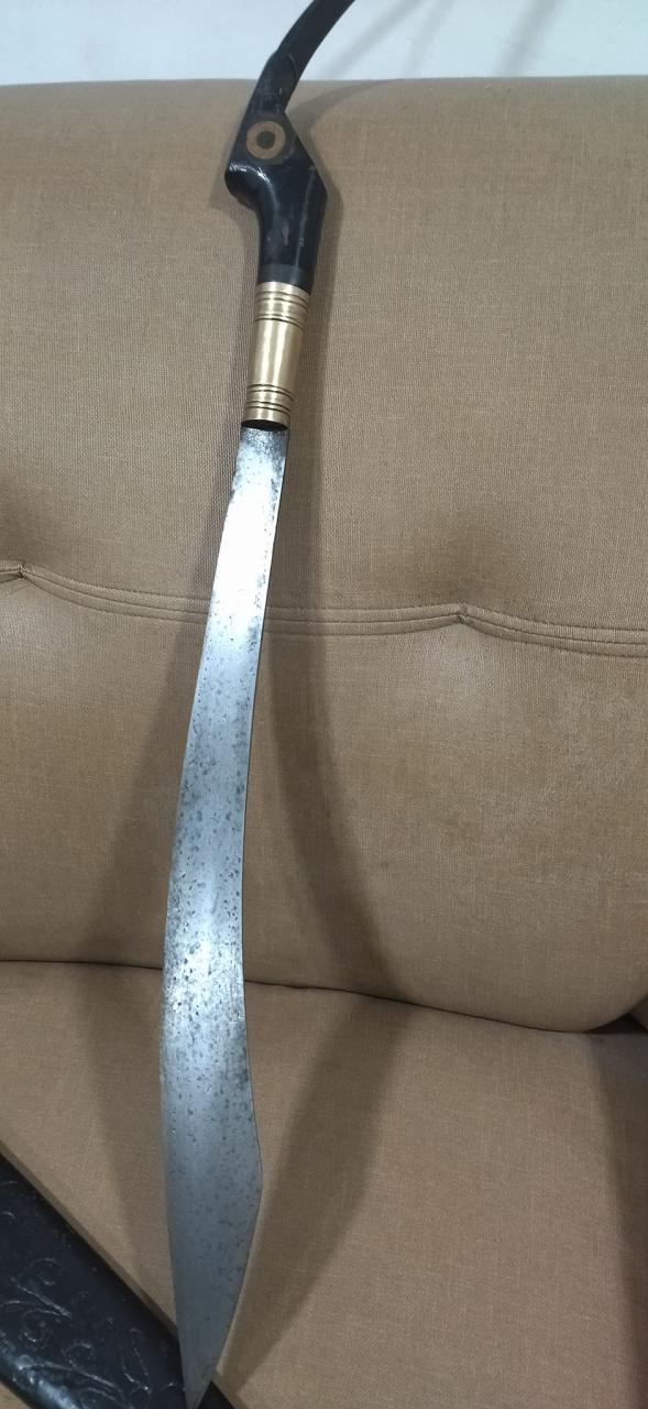

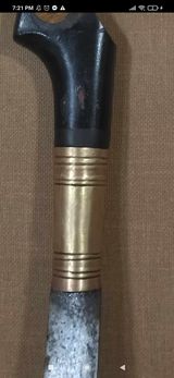

Here again my example.

Originally Posted by Interested Party View Post
I found this as collateral knowledge while researching another topic. To my eye at least one doesn't have the squared ricasso. I thought this was interesting. Are these Maranao piras as well?
Sorry if I was unclear: it doesn't strictly have to be squared. Square-ish, or at the very least distinctly delineated from the edge (sometimes a line or a 'dimple') that begins to curve after.
That's only one indicator on the blade...there are others such as the orientation of the clip and tip as compared to the hilt axis and "tail," the curve trajectory of the edge, and if viewed from top, telltale signs from the spine.
There is no such thing as a Maranao pira. Pira is a Sulu blade, among others, that was copied by Tugaya craftsmen starting 1920s until the 1990s. They also copied other blades such as Lumad, and even from Luzon and Visayan areas; sometimes they re-dressed legit Luzon and Visayan blades with fantastic dresses to make them 'exotic' to tourist eyes.
I've personally taken apart a wide range of old Tugaya tourist products and I can assure you, most of them have no heat treatment or made of inferior metal and materials. Some even have nonexistent tangs and are just glued to the hilt cleverly.

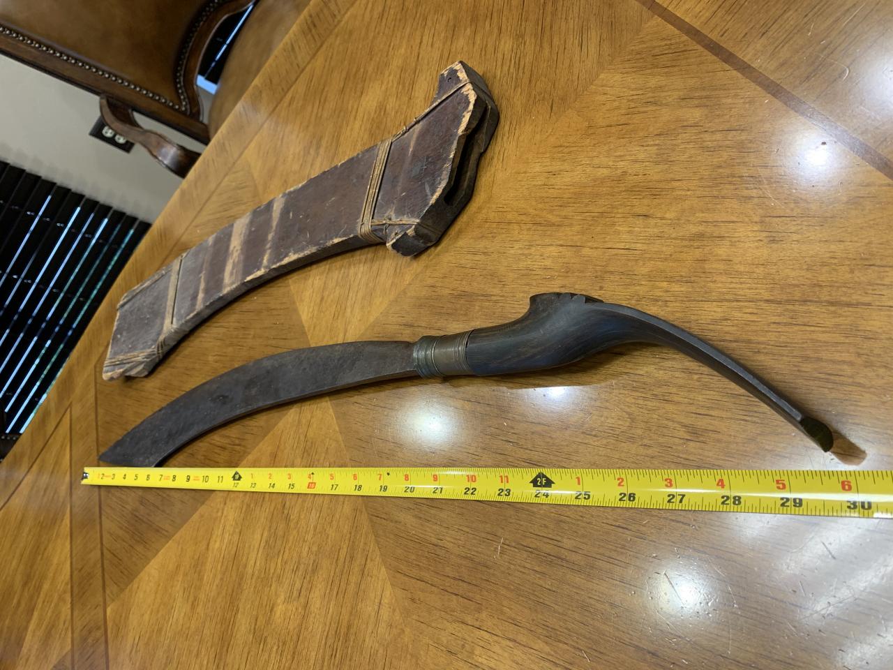

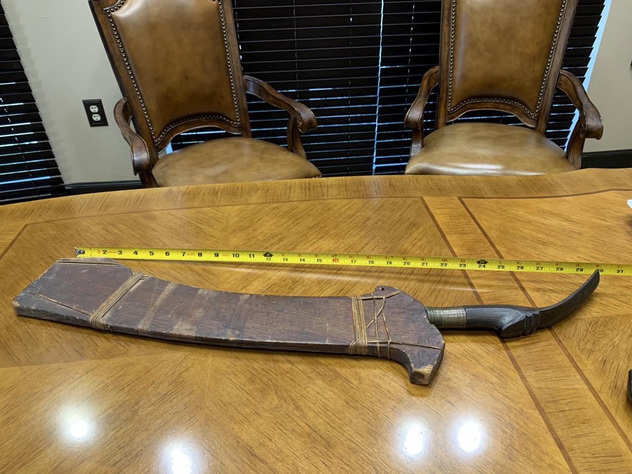

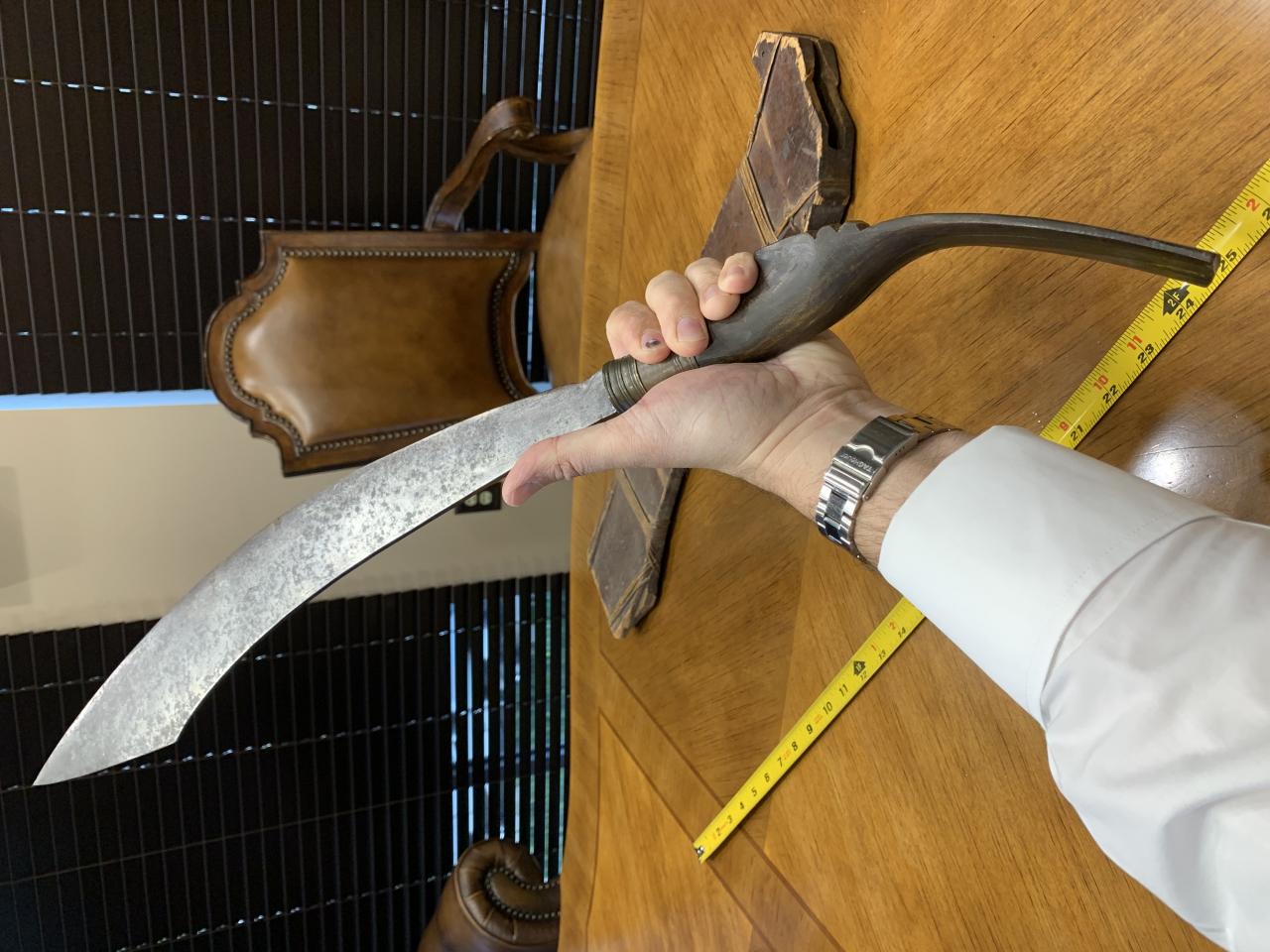

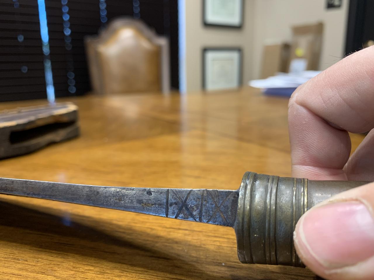

Here’s an older Pira that I got from a seller on eBay when I first started collecting.
This post actually had me think about doing a blade cleaning and etching to see what might be in the blade. Will post when I get done with the process.
