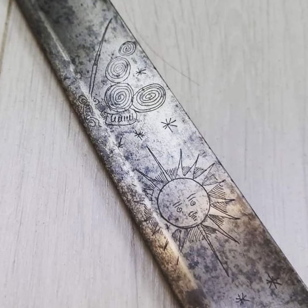

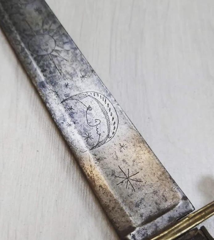

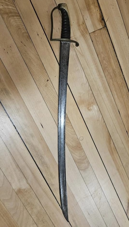

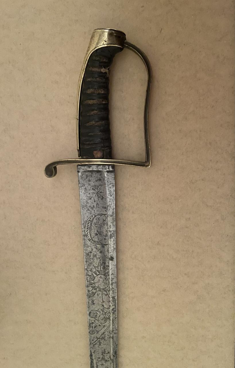

The first is a brass, stirrup hilted petit Montmorency blade with celestial markings similar to Peter Munich’s marks but from what I read here, does not indicate necessarily him from Solingen. I got that information from the older makers mark threads here. I can’t find anything close to the stirrup hilt either so that is also a mystery. The closest I have found is a French Dragoon officer

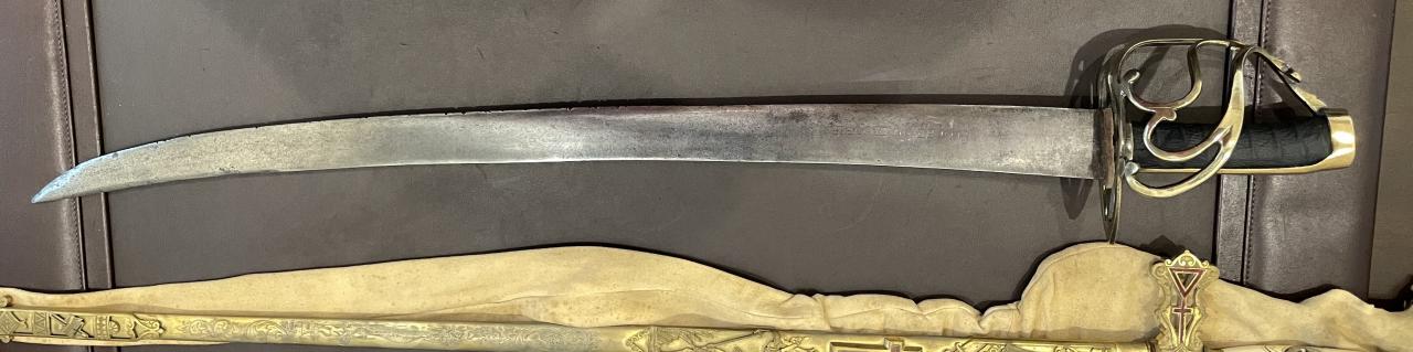

The second sword is apparently a French Revolution, petits Montmorency type blade with brass hilt with a cutlass, hacking blade instead of the true Montmorency blade. This blade has “Vaincre ou Mourir” on it. The curious thing about this one, is that it was re-peened, and as it was disassembled, there was a makers mark on the tang that I can’t attribute to anything other than most likely Solingen and an independent maker is my guess. My hope is to get a hit here. The blade has major battle damage, with probably 50 diamond shaped edge hits. This may have been one of those “dropped” swords after the owner may not have fared too well.
I am providing pictures the best I can within the guidelines, so if I need to post better ones, I certainly will. Thanks in advance. BTW the red tinge on the blade is not active rust but my red jacket Other than the battle damage and some oxidation, the blade is in beautiful shape.

Wow, almost 1000 views and no answers. These 2 must be real stumpers. From my own research, continuing here and elsewhere, the first blade could be a Cassagnard sabre with the hilt being a custom. Looks very similar to stirrup hilts for Hussar type, LC blades of that time. The grooves and smooth capstan are the mystery.
The makers mark on the other, probably an individual Solingen maker with his own mark.
Thanks for those that replied early on. It helped confirm my direction.
