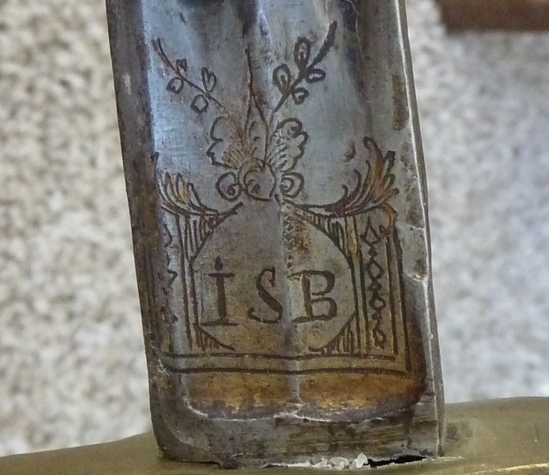

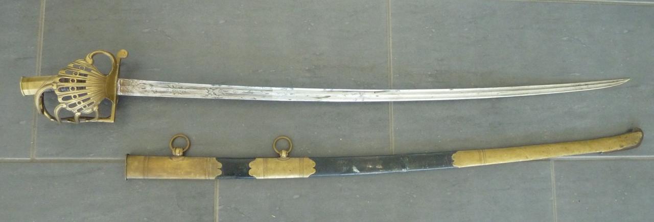

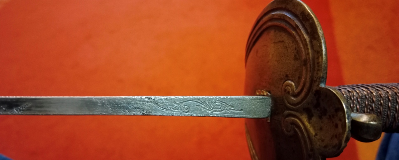

Solingen in Germany has for a very long time been a major manufacturer and exporter of sword and knife blades. These blades were exported far and wide; sold to local cutlers who would mount them on hilts in the local fashions.
While some blades were visibly marked as having come from Solingen, others were not leaving us to make educated guesses of their origins based on decorations and styles.

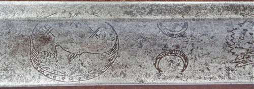

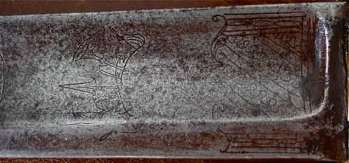

Two common clues are the 'cartouche' on the ricasso and the presence of a "Rose" on the blade spine at the base. The Rose seams to have appeared in the latter half of the 18th Century and disappeared in the 1820s when the decoration styles changed as well.
Pawel Bartela askes if this change is related to the abolishment of guilds in 1809 by Napoleon:
One of the Solingen marks on the back of the blade. Do you know sabers from the 1820s and later with such a sign? Does the end of the marking have anything to do with the dissolution of craftsmen's guilds in Solingen by Napoleon in 1809?
Decree of March 31, 1809 in Dutchy of Berg (Solingen). [https://wiki.genealogy.net/Patentensteuer_(Westfalen)
International Sword Collectors | Facebook Group
While I don't know the answer, it does appear from known examples that the Rose is missing from blades after the 1820s.
It should also be added that the makers at Solingen were very accommodating and happy to apply marks to their blades in line with their clients' needs. Examples of this are the blades imported by Runkel to the UK between 1780 and 1808. These are marked with his name prior to them being engraved and finished with blue and gilt decoration.
Below are examples of swords from my collection with Solingen made blades that pre-date the change in the 1820s:

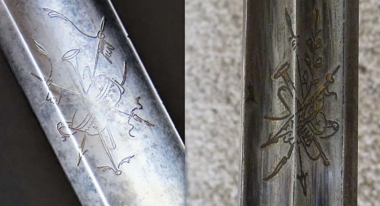

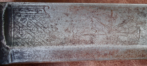

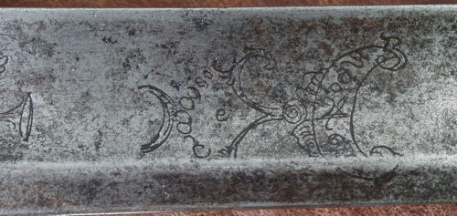

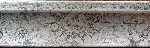

Example of the Solingen Cartouche and 'talismanic' decorations
Name:  Cote de Melon Light Cavalry Officers Sabre 13.jpg
Going by the hilt style and blade decorations, I would date this sword to the 1780s.

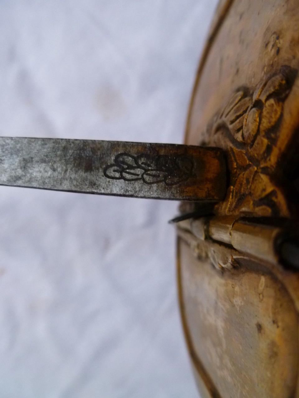

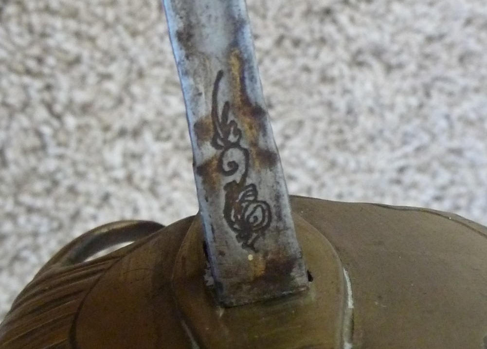

"Rose" Mark
Name:  Cote de Melon Light Cavalry Officers Sabre 16.JPG

The rest of my Solingen-made blades are from the British side of my collection (I'm excluding the smallswords as they don't have spines and one spadroon with a double-edged blade) and were imported by J J Runkel. They are interesting because they show a uniformity of iconography and variations in the signature.
1788 Pattern light cavalry troopers sword
This sword would have been imported as a complete sword by Runkel, it has an ordinance board inspection stamp, and even though the blade is engraved it would have been 'bare' of blue or gilt. These are a good example of how the craftsmen in Solingen were able turn out blades, that a trooper sword would be decorated in this manner.
Name:  1788 Pattern Light Cavalry Troopers Sabre 03.jpg
Cartouch, ordinance board stamp and talismanic decorations

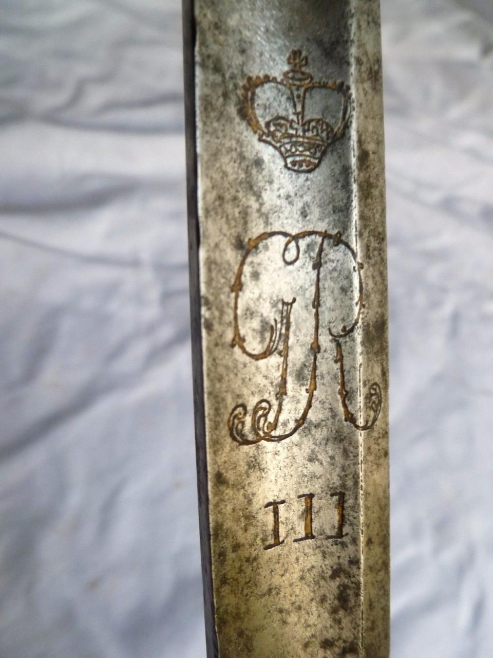

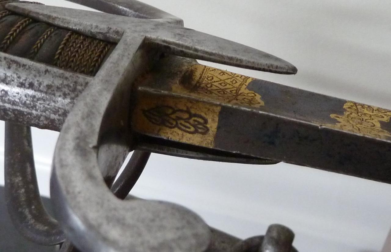

Horse Head officers sabre by Archer of Dublin
Note the straight termination of the blueing. The blade is engraved with GR on one side and the pre-1801 coat of arms. Other decorations are fairly typical of Solingen's work.
Name:  Non-Regulation Horse Head Officers Sabre 03.jpg
Cartouche

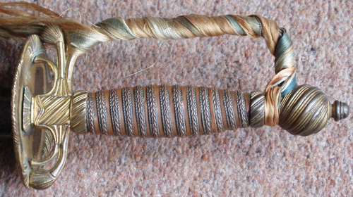

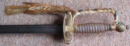

1786 Style Infantry Officers sword
This is a 1780-1790s style infantry officer sword with a Runkel-supplied blade. The blue and gilt are missing, but it has the GR and post-1801 coat of arms.
Name:  Georgian Infantry Officers Sword 01.jpg

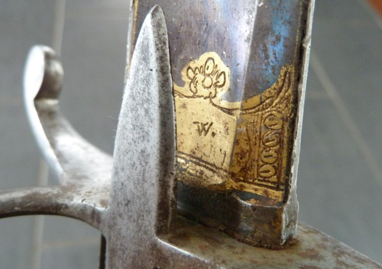

1803 Pattern Light Company Officers sabre.
Assembled by Bennett, the blueing terminates in a straight line with GR and 1801 - 1816 British Coat of Arms.
Name:  1803 Light Company Officers Sabre by Bennett 01.jpg
Blade and Cartouche
Name:  1803 Light Company Officers Sabre by Bennett 05.jpg

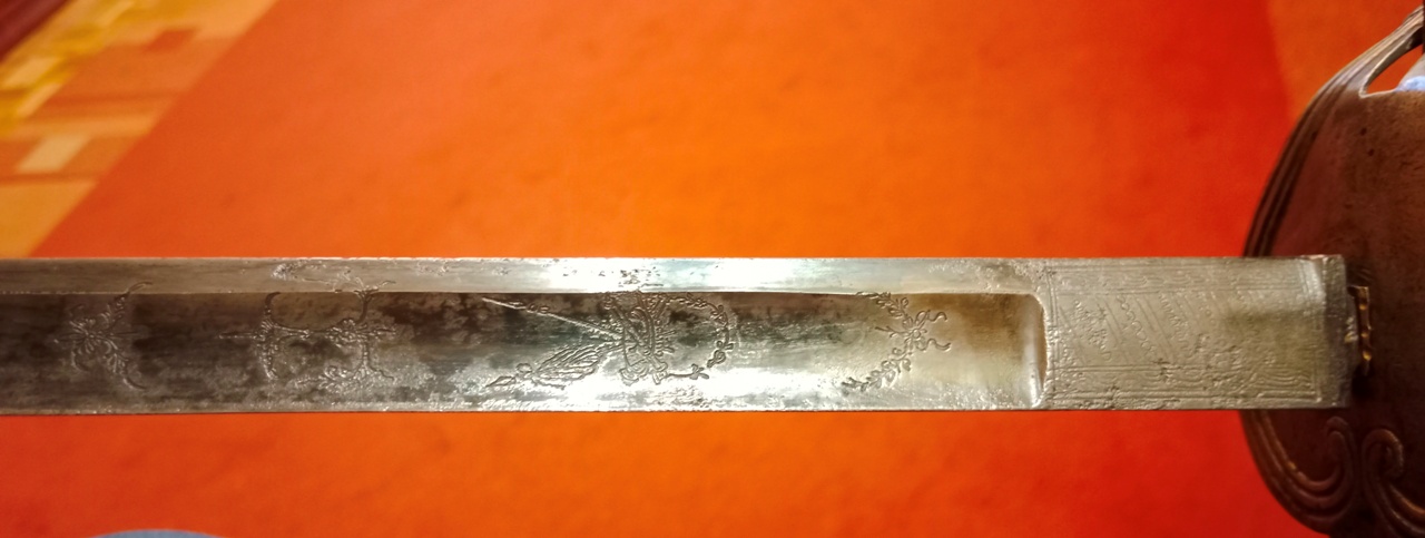

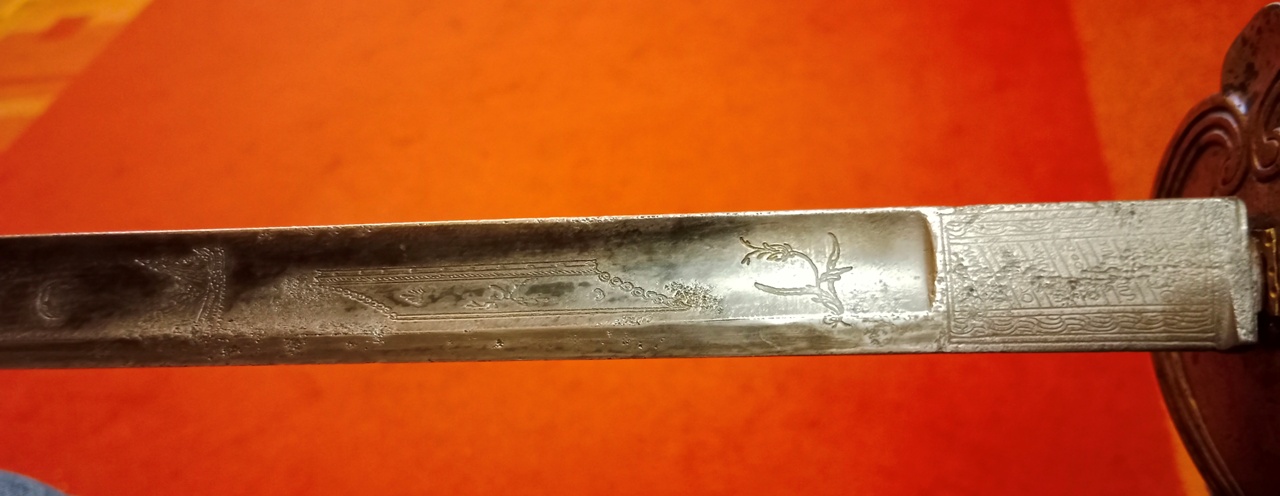

J. J. Runkel Solingen
Note how the gilding terminates at Solingen, indicating that the engraving was done at time of manufacture.
Name:  1803 Light Company Officers Sabre by Bennett 17.jpg

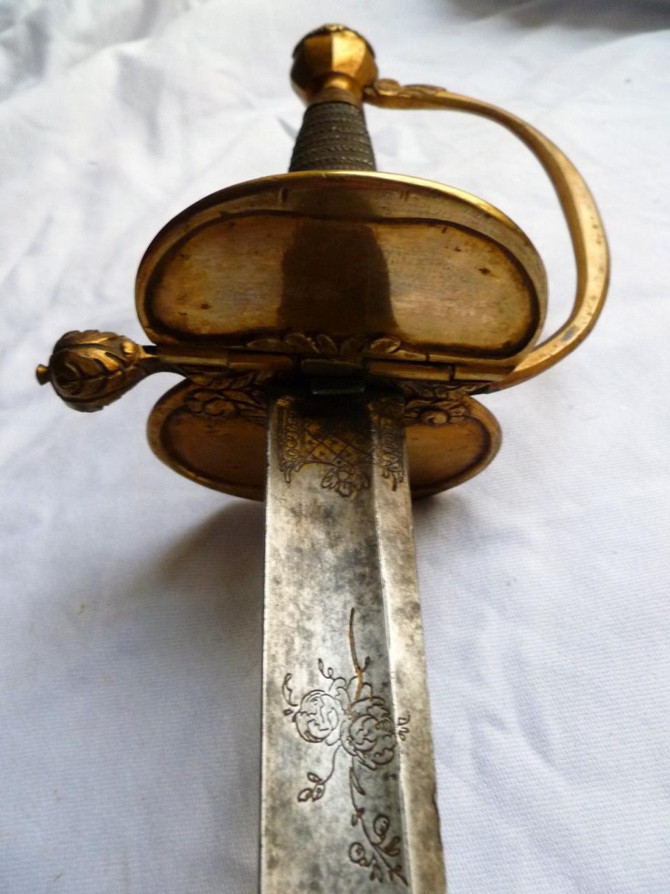

If other members have their own examples of late 18th to early 19th-century Solingen-made blades, I would love to see their markings to expand on the sample size.
Old 20th November 2023, 02:44 AM   #6
Posts: 10,867
This is a magnificent topic and thread! Thank you!
I had asked about the 'ROSE', or what appears to be a floral/vegetal device on the spine of blades near the hilt, and in some arcane fashion as shown in these examples.
Now that I see the context, I am curious on that these seem to appear on blades on French swords, or in European armies' swords during Napoleonic period.
There was mention of these devices being used on Solingen made blades.
I had thought that most blades on French swords of these times were from Klingenthal and of course so marked on the blade spines.
Is it possible that alternatively the blades with these devices on the spines had to do with Caissagnard in Nantes, who embellished blades with certain esoteric and cosmological themed motif?
It seems these blades could have come from Solingen? but would the motif including the 'rose' have been applied in Solingen? then these blades were fitted there.
I am looking forward to other examples of swords with this floral device on the blade spine, and more on these details. Thank you for this thread!

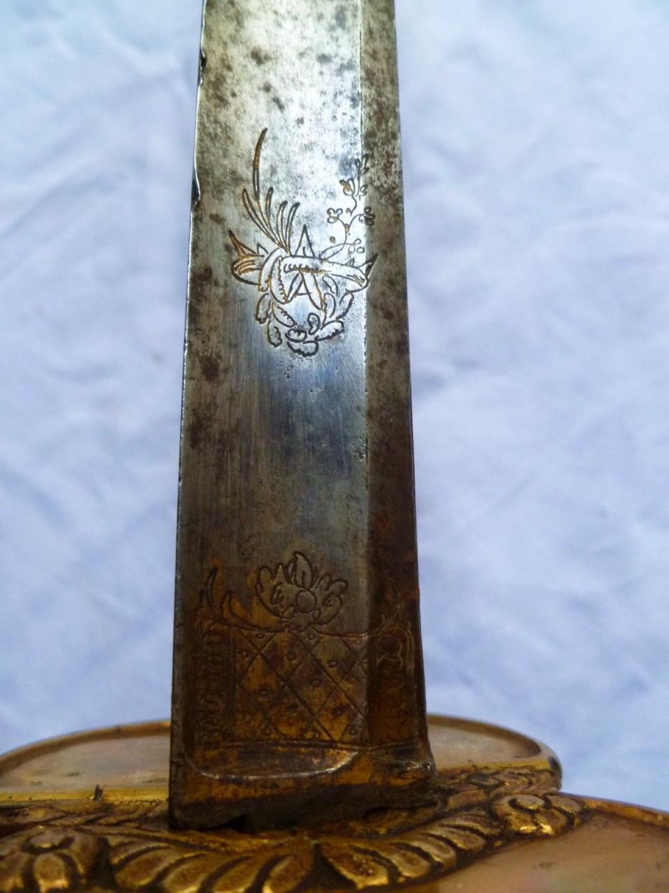

Looking through my reference photos I'm seeing a lot of early British swords with Solingen blades but not many where they provide photos of the spine. That said here are a few I did find.
Nice circa 1770 Georgian Horse Grenadiers sword:
Name:  001 - Georgian Horse Grenadier Officers Sword 01.jpg
Cartouche
Name:  001 - Georgian Horse Grenadier Officers Sword 13.jpg
Rose Mark
Name:  001 - Georgian Horse Grenadier Officers Sword 16.jpg
And another from the same era:
Georgian Cavalry Officer's sword
Name:  002 - Georgian Cavalry Officers Sword 01.jpg
Cartouche
Name:  002 - Georgian Cavalry Officers Sword 02.jpg
Rose Mark
Name:  002 - Georgian Cavalry Officers Sword 15.jpg

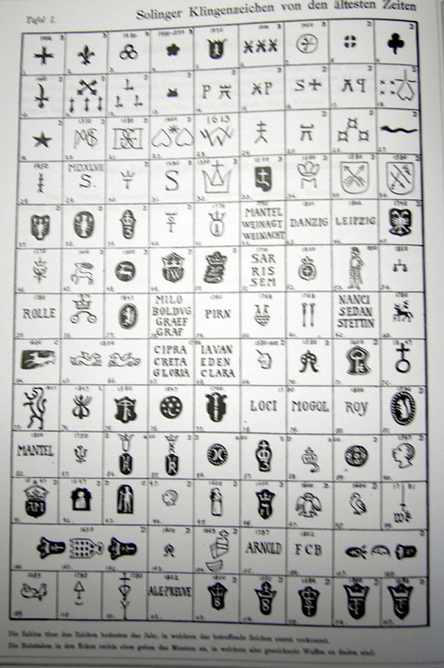

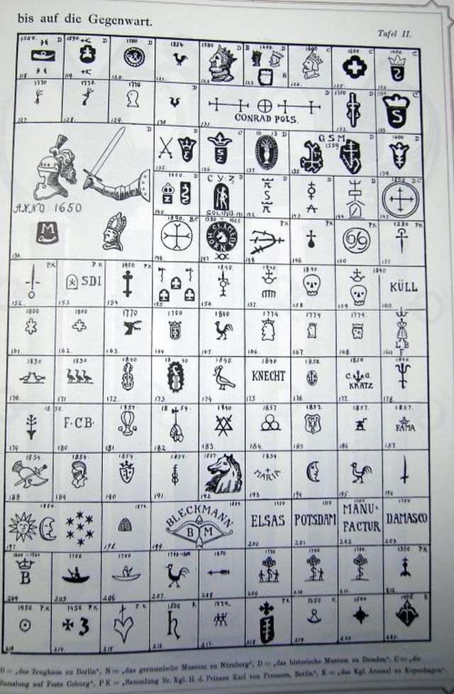

There is a book published in 1885 showing all blade sins of Solingen since the oldest times, but these "Rose" signs are not to be found. So I think it is very doubtful if these roses are typical or special Solingen signs.

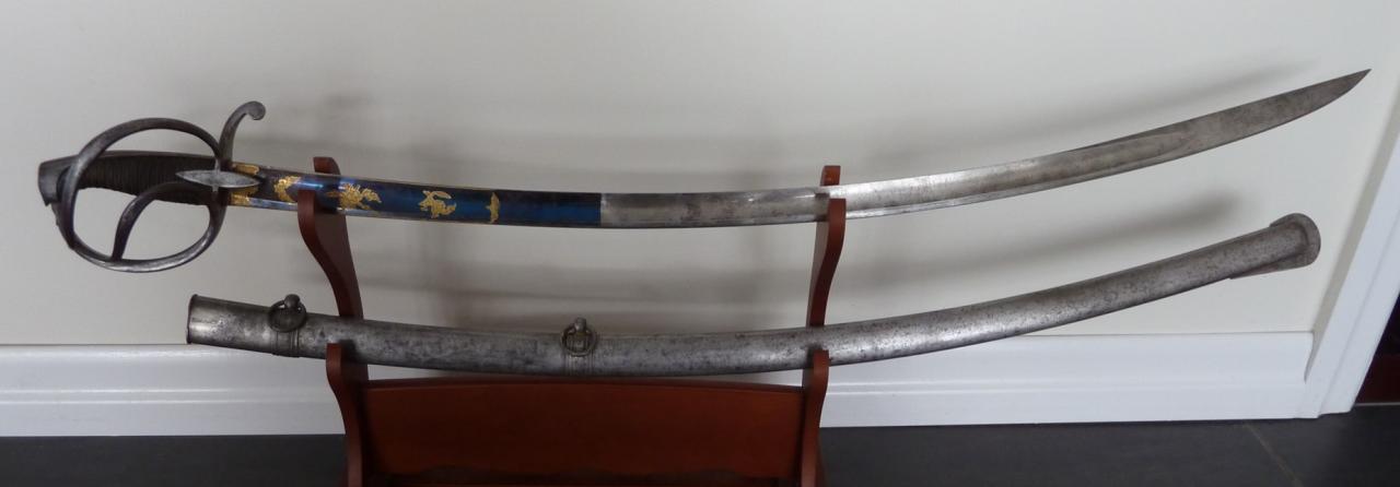

Probably South German light cavalry officers' sabre (Bavaria, Wurttemberg, Hesse)
Name:  005 - m1800 Hussar Sabre 01.jpg
Not the best photos, but you can make out the cartouche and a hint of the rose mark

Rose Mark
Source: Saxon Napoleonic era Officer's Sabre
And this sabre, I have it as German, but the style could be French as well, especially with that carp's tongue point.
Cartouche
Rose and S&K retailers mark.
This rose appears to be different from my S&K marked sabre. Different bladesmith?
Respectfully I disagree, all the blades I have shown have the cartouche on the ricasso and either Solingen on the spine or a rose. These cartouches are not found on British or French-produced blades.
In the case of the S&K marked swords, we know the Solingen-based retailer that exported the rose-marked blades. Plus there are I.C.B marked smallswords with this cartouche (but no rose because of the trefoil blades):

I have a small sword hilted spadroon type sword probably for a Dutch officer with this 'rose' detail.
Norman.

This is an amazing thread, and again Radboud, I thank you for initiating it.
Also,, I am so grateful to see all of these great examples shared here. While as many here know, I have been particularly fascinated by blade markings and motif for many years, so this discussion is especially important to me.
The 'Caissagnard' matter for me evolved from several references in French, where my limited understanding of the language prevented more detailed comprehension of what was mostly comments on the talismanic, occult and arcane motifs on French blades of 18th into early 19th c.
I had presumed the name was to a cutler, but more that it had seemed to become a colloquial term describing these motif elements.
It seems to me quite possible that the blade decoration which includes these unusual squiggles and swirls termed 'roses' at the blade spine near hilt may have been added by cutlers to blades which were essentially 'blanks' from shops in Solingen.
These appear to me to be singular renditions of a basic form in a key location on the blade which represent arcane identification or perhaps other 'magical' or occult symbolism as with sigils and such devices. The term magic should not be taken in the negative connotation often perceived, but more in this arcane sense.
The so called 'anchor' used in the names and motif from Spanish swords and readily adopted by Solingen are an example of this type of nuanced symbolism familiar in cabalistic, talismanic, magic and occult symbolism in sigils and such devices.
Years ago I noticed the 'anchors' often had varied numbers of cross bars and serifs rather than a single pattern, and thought this might be some sort of individual signature subtly placed on a common device by certain makers.
The familiar cross and orb of Germany may have been a variation on these, and various writers have tried to associate certain collectively used devices with specific makers, but this has remained unconvincing.
The features and decorative motif of blades of the 18th c. indeed did diffuse widely through Europe and Great Britain via the rage of military fashion, and these styles of motif were not necessarily applied only in Solingen, but with cutlers and outfitters using imported blades.
Makers stamps and punzones on blades are an entirely different matter than these kinds of applied motif, etching, bluing etc. which were rather custom tailored to those receiving the sword being received from such outfitters.
These are just my opinions on the processing and diffusion of swords of these times circulating with officers in armies of various nations and states. As officers of various countries were often with the armies of foreign nations, it is easy to see how styles and fashion diffused so widely.
The pageantry of military uniforms and fashion in these periods has long been a most popular subject for collectors,artists and historians for these very reasons.

Italian officers sabre
Circa 1790-1800 with Garde de Perle style hilt and horse hair pommel cap.
Name:  070 - Garde de Perle Officers Sabre 09.jpg
Cartouche
Square cartouche at the ricasso with Solingen engraved in one side and S & J or S & K on the other.

Rose Mark
Rose mark on the spine of the blade

G'day Radboud,
I will back you up that Solingen blade decoration is instantly recognizable. As an example the photo below shows similar decoration on a British 1796 heavy cavalry officers undress sword with a Runkel blade (left) and a French Heavy cavalry officer guarde de bataille sword with a blade marked ISB.
Cheers,
Bryce

Thank you for the photos Bryce, does the GdB have a Rose or Solingen written on the spine? I'd love to see more photos of that area if you have them.

Here you go.
Cheers,
Bryce

Here is another sword you may be interested in.
Cheers,
Bryce

Here is a British 1796 infantry officer's sword with a Solingen blade, that isn't marked to Runkel. This one isn't from my collection.
Cheers,

Lovely examples Bryce, that GdB sabre is unique!
