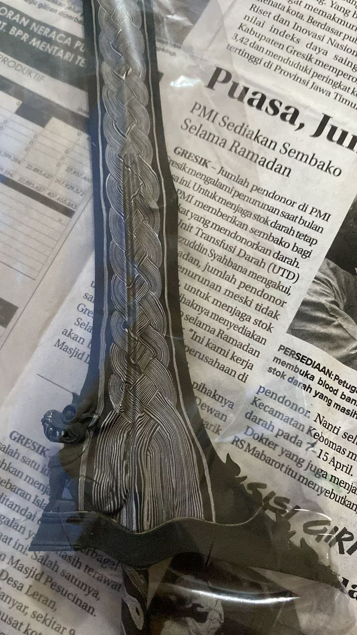

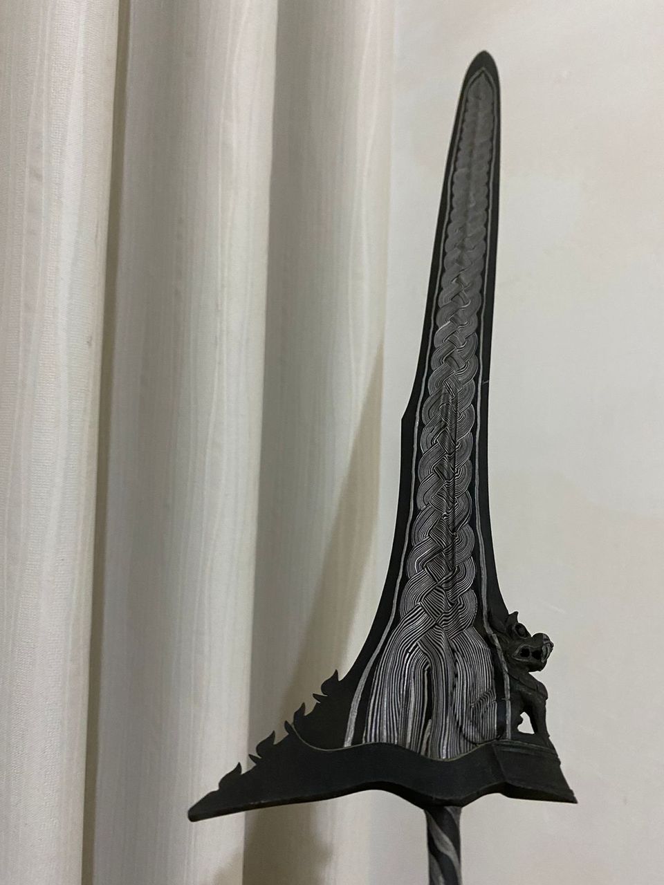

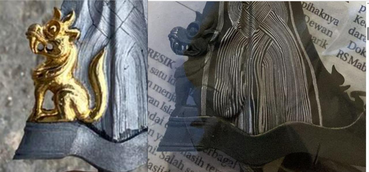

Default New forged keris for review
Hi fellow collectors
I would like to hear from you in term of quality, overall setup etc for this new keris. Personally I found it 'ugly' or unpleasant.
Old 14th August 2023, 08:23 AM   #2
Jean
Join Date: Jun 2009
Posts: 1,740

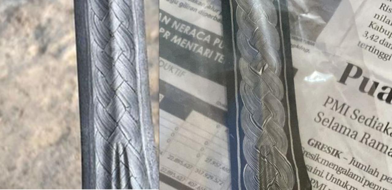

The pamor Jarot Asem Wengkon (?) is very finely made IMO.
Last edited by Jean; 14th August 2023 at 08:49 AM. Reason: Not sure about the pamor type
Old 14th August 2023, 08:52 AM   #3
Posts: 7,229
The pamor is brilliant.
The rest of this keris is out of proportion, poorly carved and just plain ugly, in a word:- kaku.

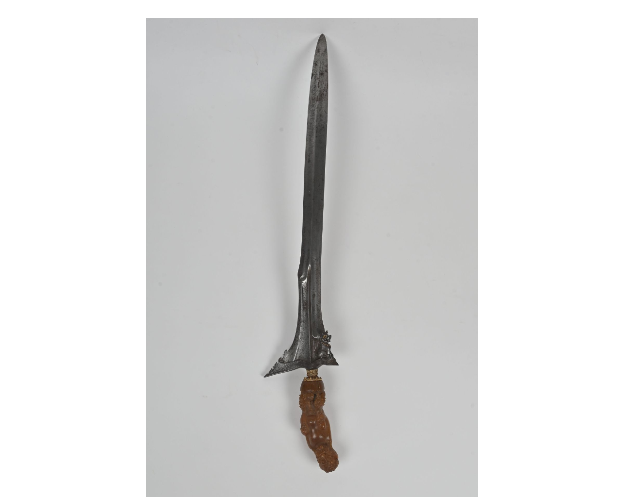

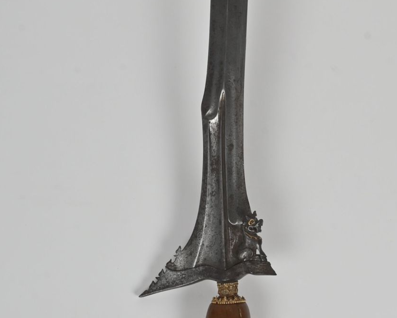

And here for comparison the original Keris, auctioned earlier this year.

This is awesome piece, majo era keris?

and what a difference we have, the original is something pretty nice, just the difference in detail & proportion destroys the copy.

very true. I supposed the base of the bilah is kind of too 'wide'.

Well, i'm jumping on the "ugly" train here as well. As stated, the pamor is pretty brilliant, but the rest of this keris is just not attractive.
Another thing that i find disturbing is the way the pamor simply runs right over the ganan figure on the gandik rather than working with the contours of the carved figure there. This figure also seems stiff and cartoonish compared to the original model. The greneng seems to not understand how ron dha should be shaped.

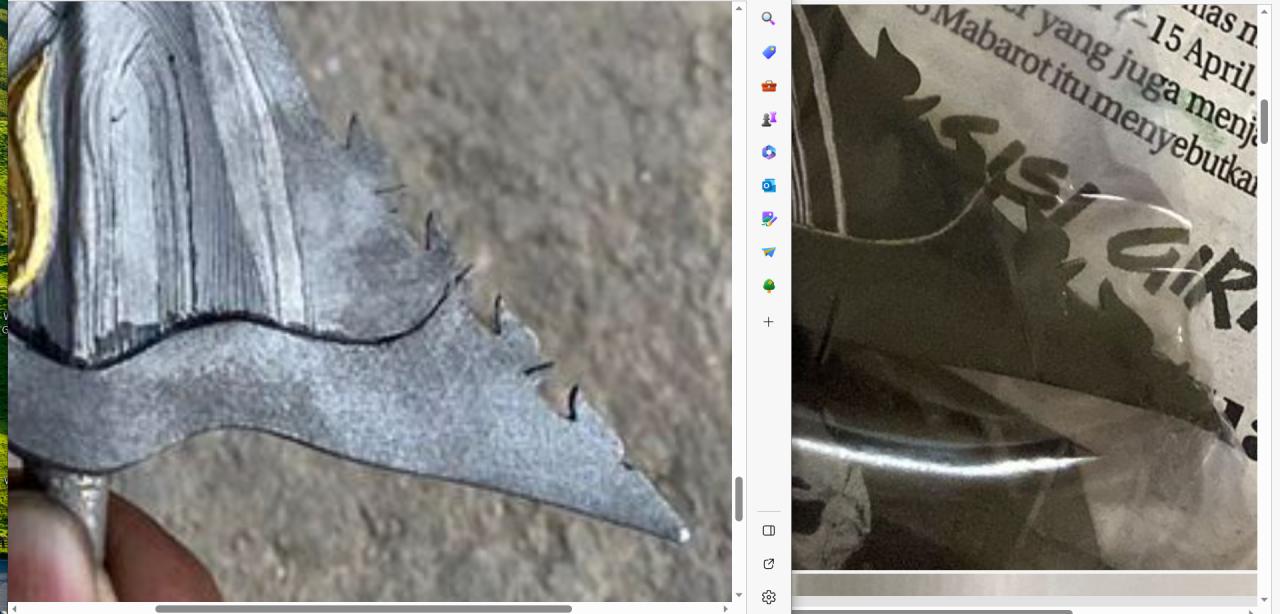

maybe the angle of the photograph has contributed a lot to this perception of ugliness, I feel that if this photo had been taken with the camera positioned 90 degrees at mid-blade, & with a small F-stop we might be seeing something different here.

What Alan remarked is true indeed and I have asked for more photo to be given.

I'm with Alan. I love the pamor but not too crazy about the dapor.
Old 17th August 2023, 10:15 AM   #12
Posts: 7,229
I'm OK with the dhapur, what turns me off is the execution, when the photo was taken from a bad angle that misrepresented proportion, and that compounded the less than good effect, but now that has been fixed the overall impression is really not so bad.

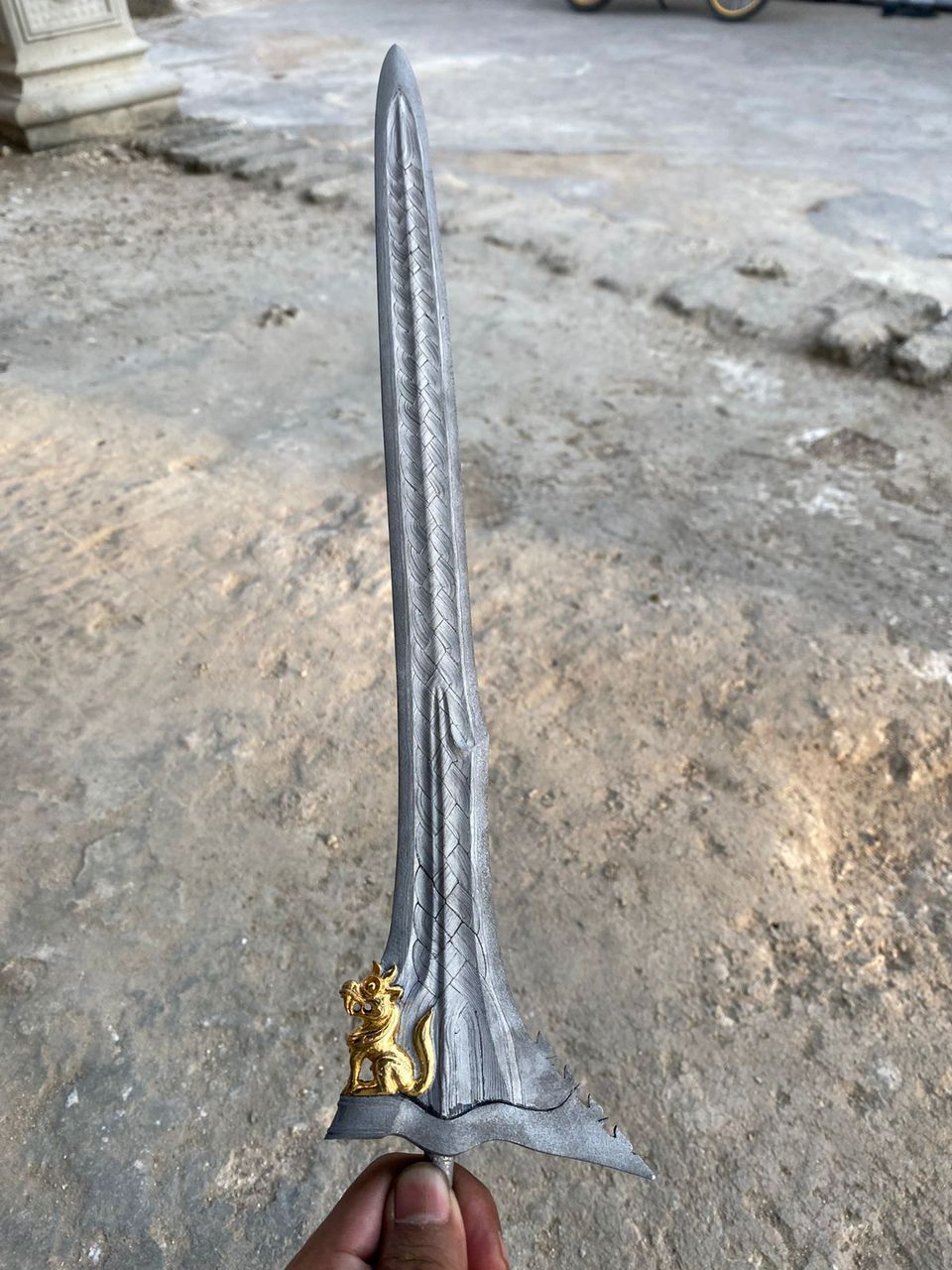

Are these the same blades? Very close.

Yes, it is the same with the brass plating motif having warangan removed.

Personally I don't like the carving & plating of the singa, and the greneng

For me the "kinatah" seems to solve part of the problem i was having with the way the pamor cut so abruptly into the Singo.
There are still executions problems from my perspective with the greneng form as well as the gonjo itself which seems to lack the gracefulness i expect to see in gonjo wilut.
I also agree with Alan that the perspective with which the original photos of this keris were shot was problematic and the overall dhapur does indeed look better in the later photos.
The craftsman who does it probably is a young lad lacks of experience :P

I've seen this woven pamor some time ago in our pages; if the dhapur is within a recognised pakem I can't really see any reason to be offended by the form.
I am not aware of any design copyright being claimed by whoever developed this particular pamor.
Why should I be offended.
Agreed and this new forged keris belonged to me made by a Madura well-known smith who are responsibile for this type of unique pamor. I asked him to forge this keris based on an ancient old keris design.

Regarding this special Keris and the original one, a part of the problem here could be that the smith was working with a couple of pictures, he never had the original in his hand. Not all people are equally talented to translate two-dimensional objects back to three -dimensional. The other thing is of course if somebody is able to understand what exactly makes out the harmony of a good blade, and not to destroy these things. Here maker's approach was too individualistic, his own character was the barrier not allowing him to make a harmonious blade. Rougly at the same time there has been made another copy of this particular Keris, by another maker, who followed the original much closer, and did have a better understanding of why exactly the old blade does work.
