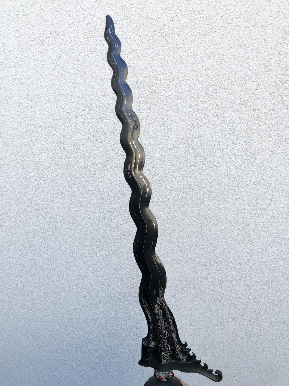

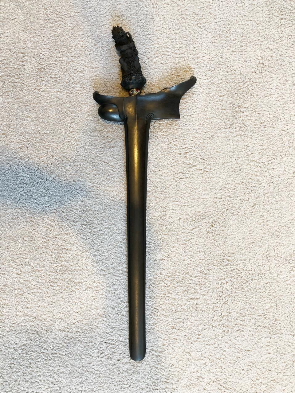

I would like to share my first Balinese Keris, nothing fancy but I quite like it.
I obtained it from a young Pande, made in 2020 according to him.

I certainly like it, and the fact that it is very new doesn't detract at all from its qualities. I like the pamor and the simplicity of its design.
I think you have done very well. Whatever the certificate says it is a sign of quality and distinction.

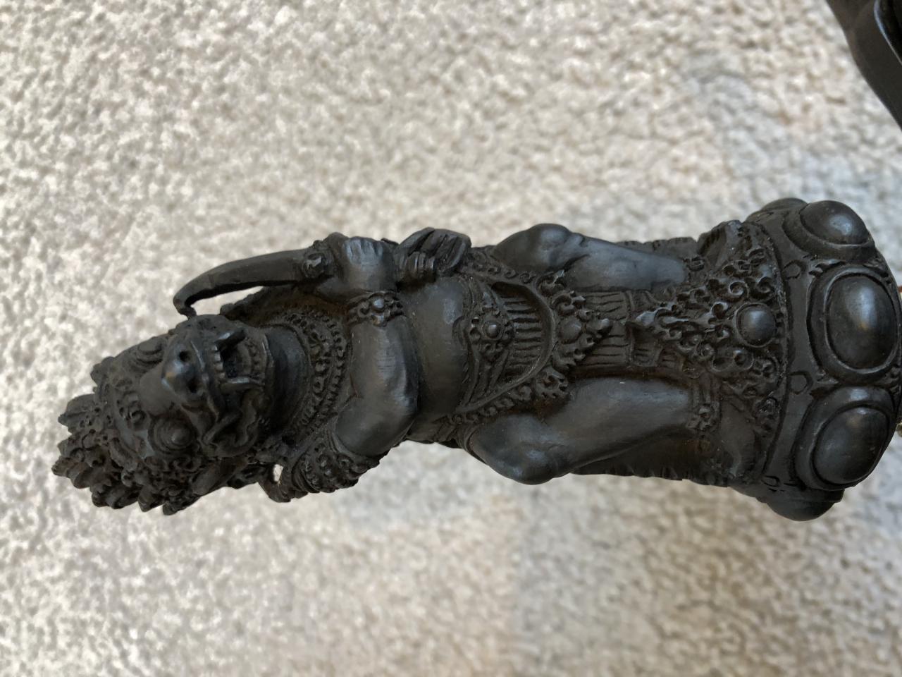

I like the hilt too, makes me think of the hilt I show here
http://www.vikingsword.com/vb/showth...651#post283651
Which I have found out it is Tualen

hmmm...while there are certainly far more elaborate Balinese keris i'm not sure my opening line would include "nothing fancy".

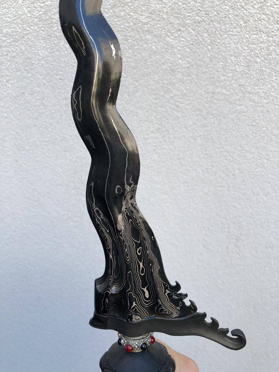

Firstly, an unusual 19 luk keris. It is believed that such keris that are outside the normal upper end luk count are generally considered suited for people outside the normal social strata such as artists or performers.
The kamardikan blade seems to be nicely sculpted and the 19 luks appear to be handled pretty well. Just because a keris doesn't have kembang kacang doesn't mean it is simplistic. And the gonjo (is it gonjo yuyu rumpung?) i would even say qualifies as "fancy'. And the dress is a recent version of the formal serengatan style sheath and a togogan (figural) hilt. While these don't appear to be the highest level of fine carving that can be found on such dress it seems fairly decent and as a formal form sort sort of negates the idea of "nothing fancy".

All in all this seems to be an attractive kamardikan keris.

I think we'd need a better close-up picture of the handle to decide whether it is Twalen or not. If I recall correctly Twalen does not have fangs and I believe I see fangs on this hilt.

I agree with David - nothing simple about it. I really like this keris and I'm quite partial to those robust gonjos. Thanks for sharing, JustYS.

Yes Rick, you are right this one has fangs.

Yes, certainly not Twalen. I would hesitate to name this character, especially since it is obviously a rather recent hilt. But he would fall into the demon category i believe, with his bulging eyes and fangs.
Yes, there are indeed high level Bali keris out there that can be quite blingy, some rightfully so if they are indeed of court origin, but many recent era keris that are dressed in that manner these days just to attract the eyes of collectors. Yours is a much more honest approach for keris in this current era category. But i would not say simple.
