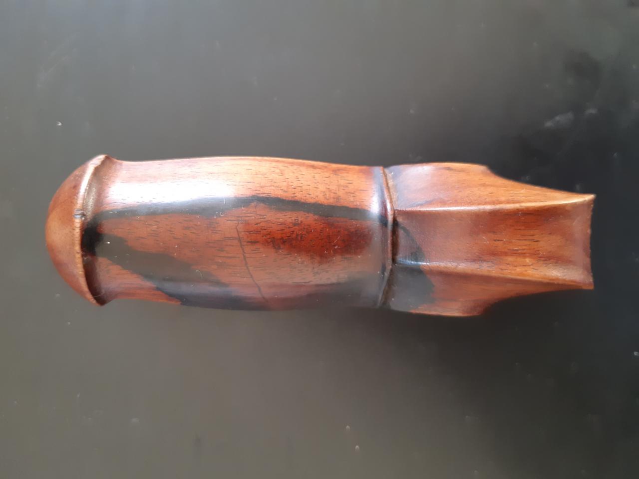

Probably common knowledge to you experts but I only recently suddenly noticed that the typical Bali kris hilts are shaped like phallus. I had never noticed this before and to be honest it shocked me a bit. I cant bring myself to hold it anymore!
SidJ is offline   Reply With Quote
Old 23rd July 2023, 04:43 PM   #5
Posts: 7,303
LOL! Do you mean Bondolan hilts. I suppose anything that is longer than it is wide can be seen as being phallic. To me the bondolan hilts simply seem to be an extension of the common Javanese planar style hilts. I suppose they can be seen as phallic as well. While we are at it, the keris blade itself can also be seen as phallic. Be careful or you may have to give up collecting keris altogether.

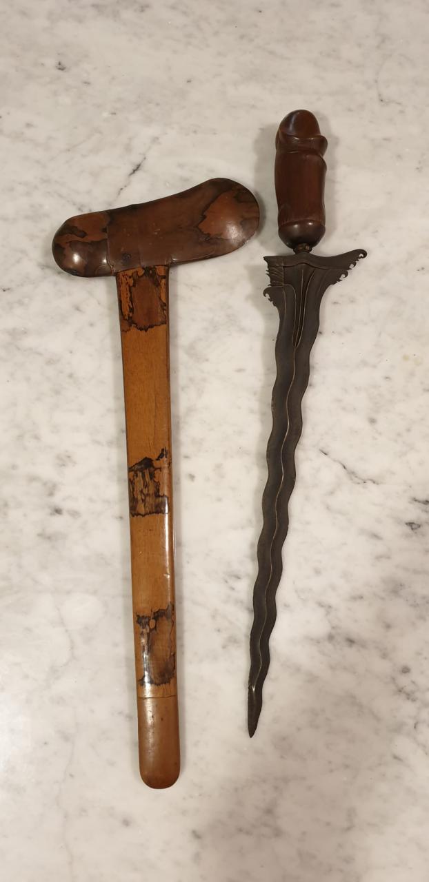

I guess the photo speaks for itself.
I bought this at auction many years ago from a grainy photo. I thought it was a man in a helmet.

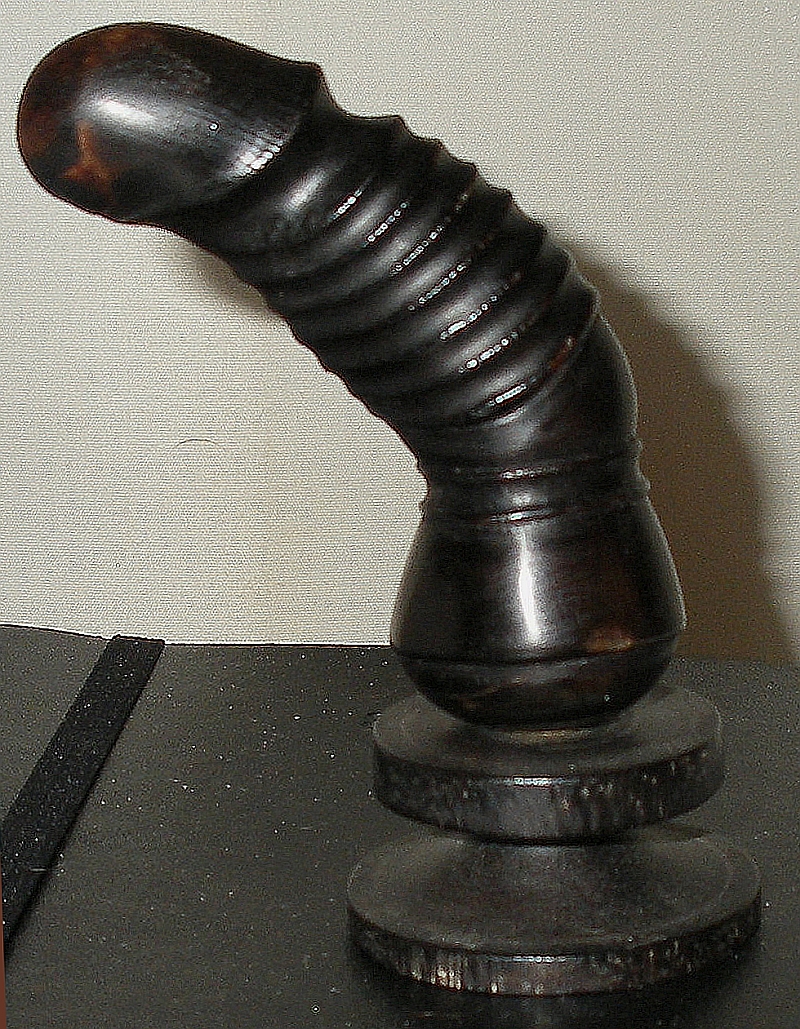

I have this example carved from horn (how appropriate!) from Adni.
I've never seen one mounted on a wilah. I do wonder where it fits into the cultural ethos of the keris or is it a gimmick for those of us who are outside of keris culture.

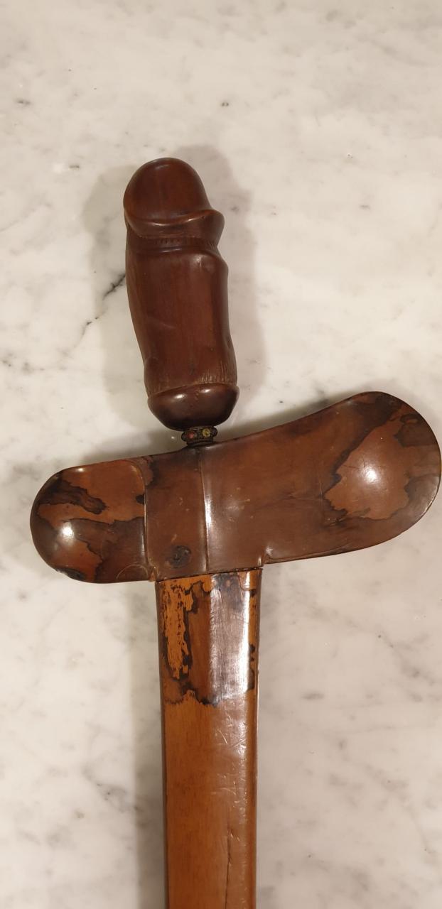

Here is what it looks like on the wilah.
It is a comfortable grip and works very well.
Just a bit awkward grasping in the hand though.

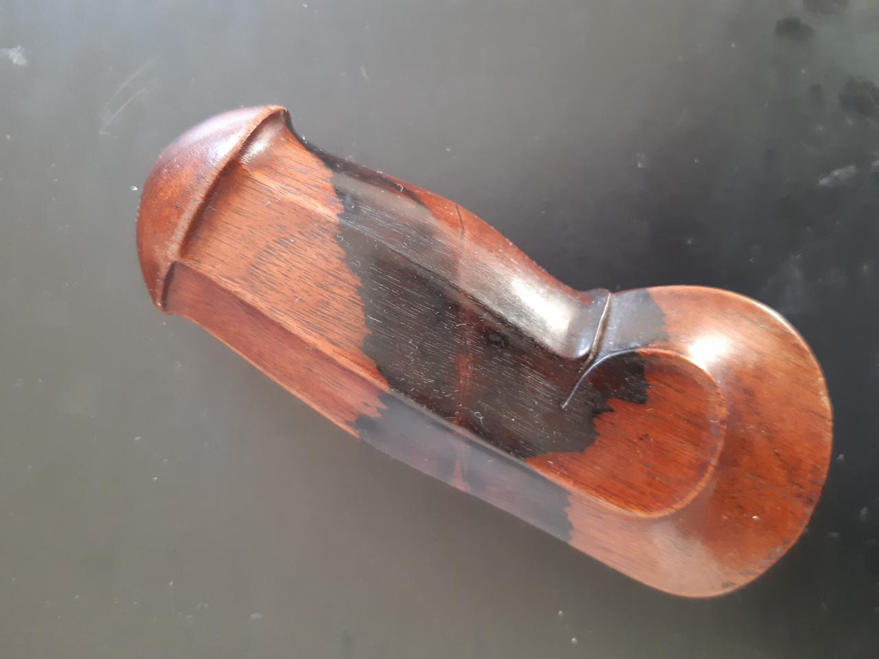

Hi David
Yes this type of hilt. The glans tip bearing the pesi and the rounded pommel forming the scrotum. Immediately apparent when the hilt is separate from blade.

Default Phallic
This one is definately a happy camper.
Old 6th August 2023, 10:08 PM   #19
Posts: 7,303
Well, there's no unseeing that now, is there?

Sorry David
That angular pic got flipped . It looks even more realistic that way. But Im glad you can see my point. I never considered this form to be phallic until one day when it suddenly dawned on me what it looked like. And now things wont be the same.
