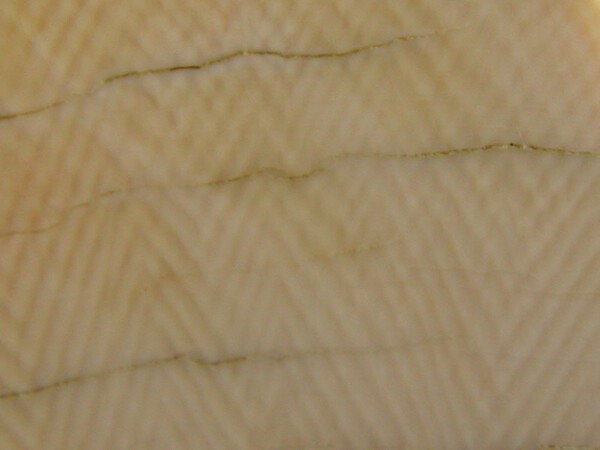

As Detlef points out, the lines running down the torso are not Schreger Lines. Schreger Lines present themselves in a cross-hatch pattern. The absence of Schreger Lines does not mean you item is not ivory, but probably that it is not elephant ivory, since that is where these lines are usually prevalent.

Rob, this is what Schreger Lines look like.
Old 2nd July 2023, 05:16 PM   #9
Posts: 4,744
Hi Rob,
David has shown a cross-sectional cut through ivory, which displays the Schreger's Line criss-crossing the cut surface. Other lines are also visible as fine concentric rings (around a small central pulp area that is not shown in that picture).
Tusks are modified teeth, and all tusks have some element of the central pulp found in teeth. What we recognize as ivory is the equivalent of tooth dentine that makes up the majority of the ivory tusk.
The straight lines on your ivory figure are caused by longitudinal sections through these concentric rings. This is definitely ivory and not bone.
