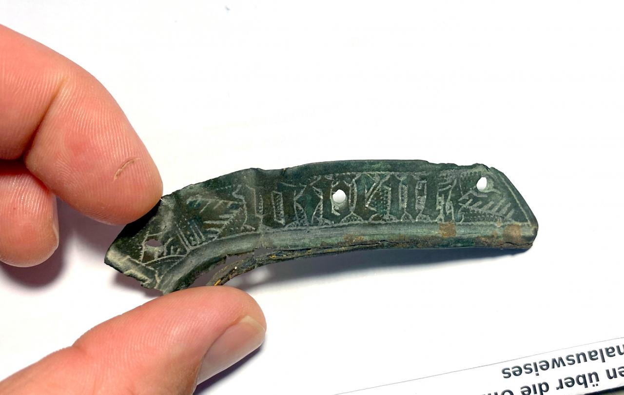

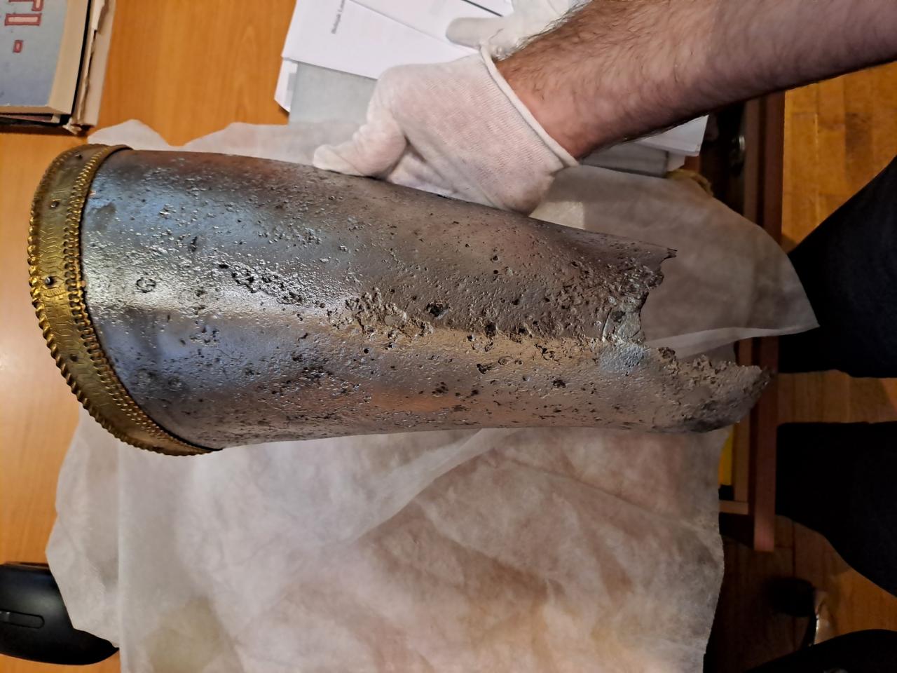

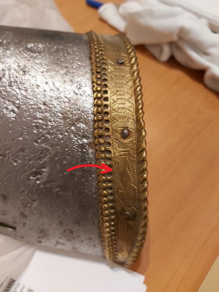

Hello, I'm a curator of the Croatian History Museum's Arms and Armour Collection and this is my first post on this forum. Hope it's not too much of a mess to understand as there's a lot to write about this and I tried to be concise.
The museum has (I believe) had an interesting item in their depot without them knowing what it was for more than a century.
Between 1909 and 1913 there was a large archaeological excavation and dredging project in and around the ancient Roman city of Siscia (today Sisak in Croatia). The aim was to discover Roman artefacts, and many were.
However, during the river dredgings, plenty of items were found belonging to other eras, but they weren't of much interest and weren't documented well.
One of these finds was this piece of armour. It was found in the Sava river near Gušća, with another piece (supposedly a defense for the shoulder) in 1911, which is now lost.

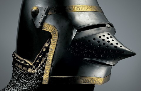

I think I have correctly determined this cuisse to 1380-1400 as there are plenty of examples of northern Italian armours with almost identical decorations as can be seen on this copper alloy application.

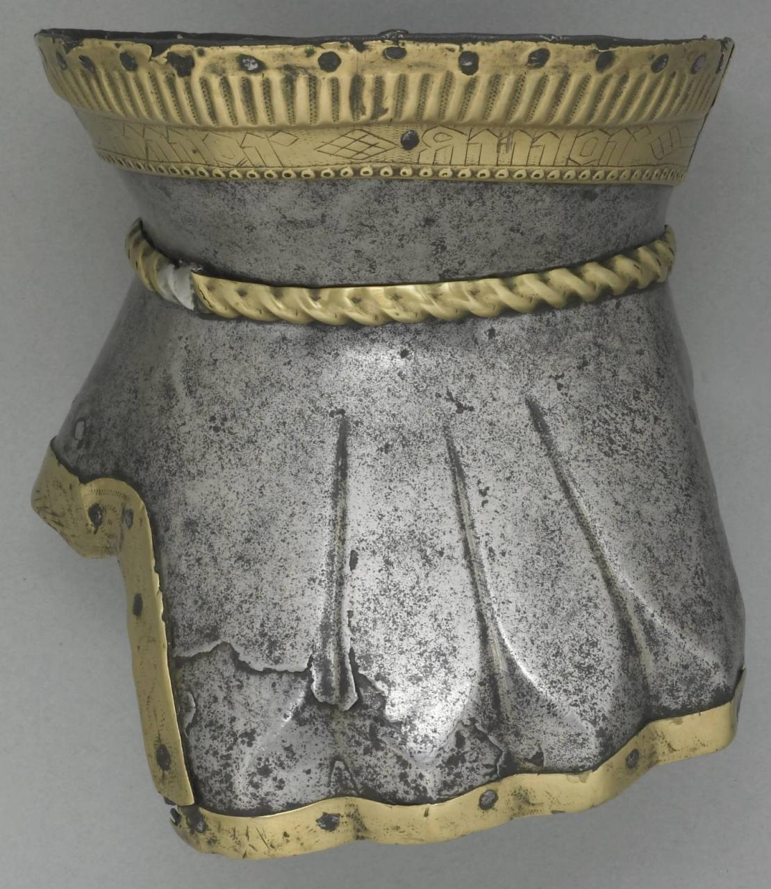

i.e. this gauntlet in theBarghello museum in Florence:

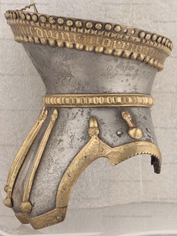

, the famous Churburg armour:

as well as this bascinet from France:
There's more examples, but it would be too many photos I think. Why am I posting this? Well I'm looking for a different set of eyes. While I believe the item is genuine, I want to dispelly my few suspicions as it's too good and rare of a find for Croatia.
However, the fact this item was found in a river supports the idea that it is a genuine medieval item. While it is possible fake items could have been planted for archaeologists to “discover”, there was no “pomp” made after finding them. After going through the “Siscia” files in the Archaeological museum, where one can follow the correspondence between people on the field and the museum, it is evident that the focus on the dredgings and excavations was on ancient Roman artifacts, being the only type of artifact that was properly documented and reported on.
Other items ranging from the 13th-19th c. were found. As this item was found in 1911, I have trouble believing a very well made Victorian copy of an armour found itself in a river like this.
The layering of iron, the hammering marks, the shape and measurements, as well as the location of rivets and holes support the idea that it's an authentic item.

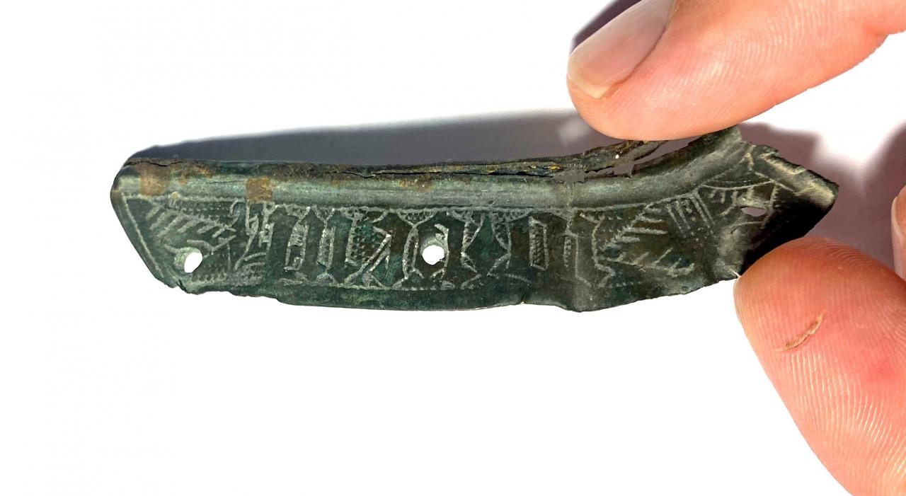

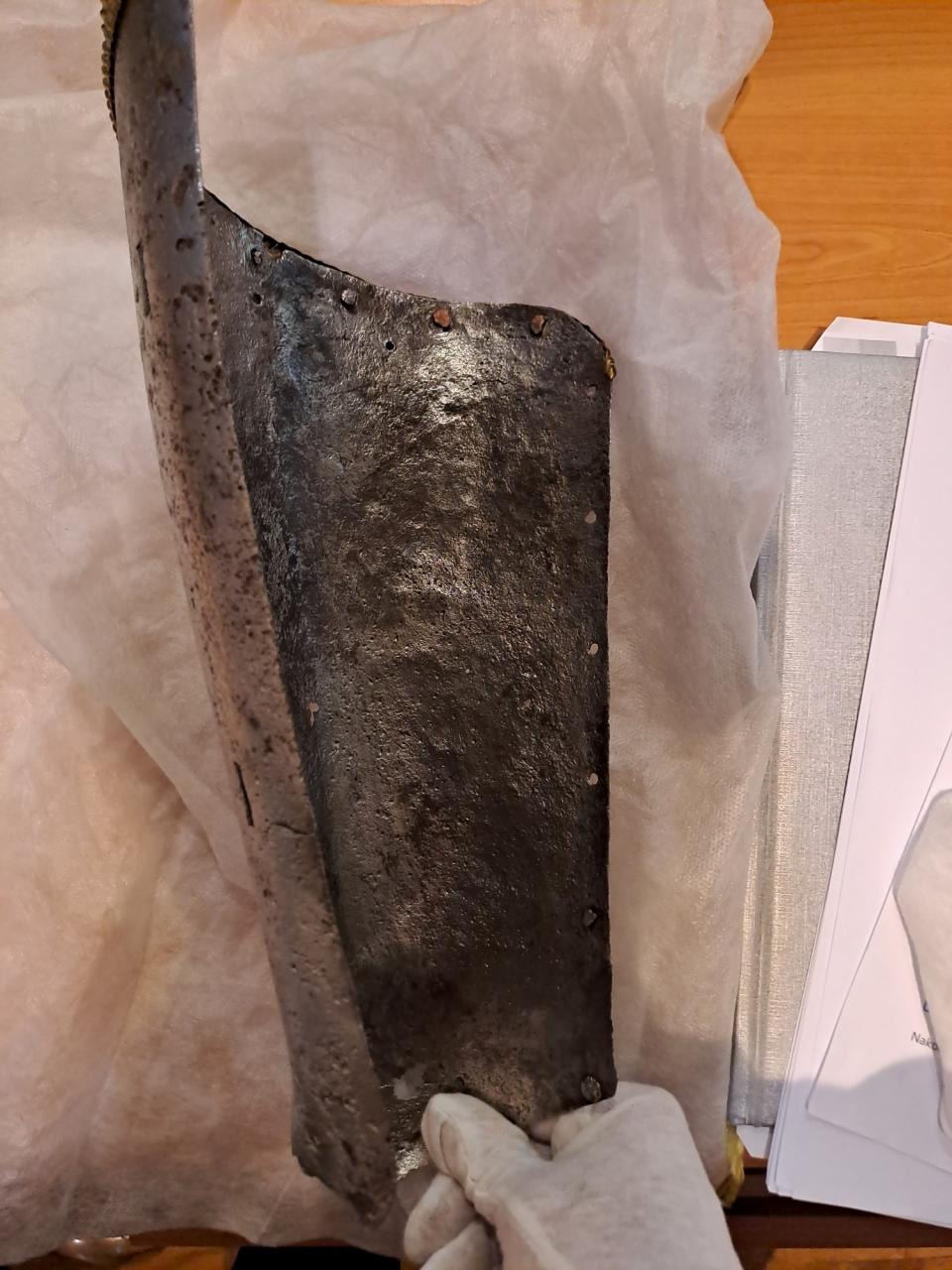

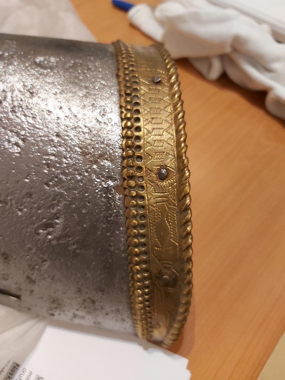

The condition of the item is unfortunate as it was overcleaned at some point in time during its 100 years in the museum which is why it looks so polished, and the "conservation work" is undocumented. This overcleaning probably resulted in a loss of information (perhaps a maker's mark). This was unfortunately common practice as the museum has plenty of bronze medieval maces which were overcleaned and polished in the same way.
The pattern and shape of the copper alloy application is very similar to some extant examples dated to the same decades:

The upper part of the application forms a rope or spiral-like edge for the entire length of the strip and slightly envelops the upper edges of the cuisse. this was all common practice. The suspicious part is that the middle part of the strip is decorated with two sets of gothic ”lettering”, which are most likely gothic minims, the building blocks of gothic letters. It is possible that the inscription is a combination of letters ‘I’, ‘M’, ‘N’ or ‘U’ but it is more likely that the illiterate craftsman wrongly copied an inscription or wrote (or rather drew) what he thought he saw. Minims used as decoration were a common thing to be found in manuscripts. This was popular because it only took one simple stroke to write, although such a reason doesn’t translate into chiselling on a metal surface.
https://en.wikipedia.org/wiki/Minim_(palaeography)
Measurements:
length: 32-38 cm from the lowest lower point to the lowest and highest point of the upper part
width: 28 cm upper part / 9,5 cm lower part
1-2 mm thickness

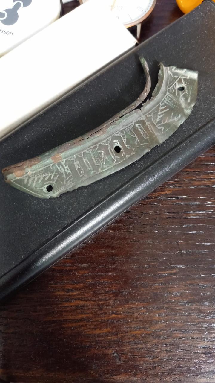

Welcome to the forum and thanks for this interesting post. To me it is of special value, as it might solve an old riddle for me. Since I was a child I own this piece of metal with gothic letters, without knowing what it was used for. Now, when I saw your post it seems to be pretty mich similar to the applications of the harness you show. May I be tight with that?

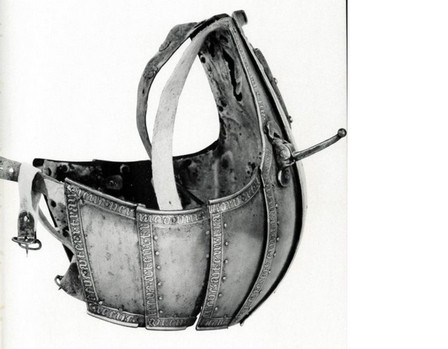

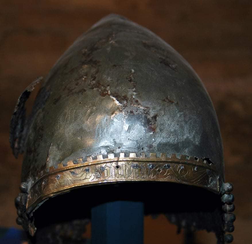

It would be interesting to know how these brass boarders were made. On lesser examples they appear to be die struck or stamped from quite thin material. Where the better examples lost wax castings as they seem very uniform and finely detailed. Attached from the Wallace collection. Perhaps LeonymusBosch could venture an opinion as to wether the boarders are stamped or cast ?

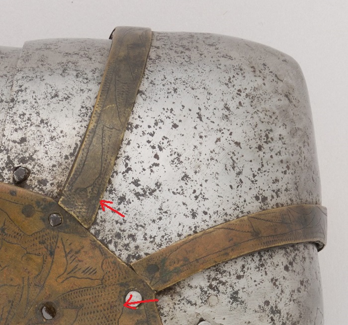

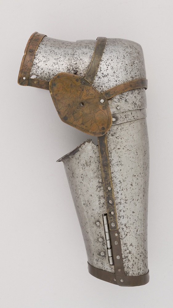

What an interesting and rare piece! Thank you for sharing it here. From what I can see I do not think there is any reason to doubt its authenticity. However rare, I don't think we need worry that finding it in Croatia is too good to be true. Actually, brass-trimmed armour in the Italian fashion can be seen in Hrvoje's Missal from the early 15th century.

I know quite a few other examples of brass-trimmed armour from this period, but all of them have intelligible inscriptions or simply decorative designs, rather than this kind of pseudo-inscription. I did notice that on one piece from the Met the stippled background is rendered in a very similar way, by filling with small zig-zags.

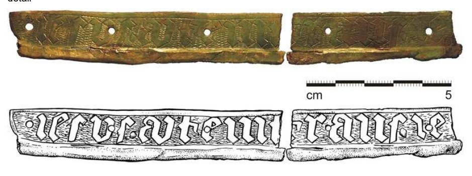

Its called wriggle work. Standard engraving technique created by rocking the engraver from side to side

Does anyone know about the meaning of those letters? Are they epigrams or so?
On mine I read "IO VEM" or so. Not sure about the direction.
Kind regards
Andreas

Maybe IO VENI? Could mean something like "Look! I am coming."

Thank you! That fits perfect. Looking at the images on a mobile / at wider distance I totally agee with your Interpretation! Are other inscriptipns documented and can be translated? I can't identify the letters ob the single strip that Leonymus posted

One common inscription is the bible verse Luke IV:30, Iesus autem transiens per medium illorum ibat ("Jesus passed through their midst and went on his way"). This can be seen on many items, including armour, weapons, and jewelry, because it was believed to be a protective charm. You can see portions of this phrase on two of the pieces Leonymus shared. The inscription on his cuisse does seem to be nonsense though, and purely decorative.

It looks as if the edge bead in Ahorsas fragment has been formed by wrapping it over a iron wire reinforcement. Looking at the arm harness posted above there is a bold edge moulding to the top of the arm which could have been formed in the same way .

Sorry for abusing this thread a bit, but it is really an interesting topic. I´ve never seen this sort of armour with inscriptions before.
To come back to the initial question on the authenticy of the river find: In my humble opinion I do not see any "red flag" on the iron part of the cuisse (I cannot judge the brass part): We have traces of hammer, we have laminated iron and we have the fact that it was found in a river, not in an historistic castle . In my eyes it is very unlikely that this is a copy.

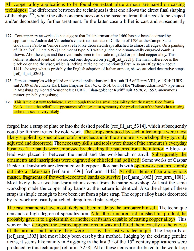

I think you're on the right track. I have been studying dr. Goll's Iron Documents PhD thesis and he does say that all these applications on extant pieces of armour were made by lost wax technique and usually by different craftsmen, and not the armourers themselves.
Here's a little screenshot of the pdf (pp 124-125.). It's available for free online and it's an amazing resource for plate armour.

Can you remember where the single strip from the picture is from? Thanks!
[Edit]
Nvm, found it...
Kind regards
Andreas
Would you mind if I use this photo in a conference presentation? Perhaps the paper as well, but not sure about that yet.
You found it in Germany, right?
LeonymusBosch is offline   Reply With Quote
Old 12th October 2023, 09:26 PM   #24
AHorsa
AHorsa's Avatar
Join Date: May 2014
Location: Rhineland
Posts: 396
It would be an honour.
Sadly I don´t know for sure where it was found - I got it from an old collector more than 25 years when I was child. It is very possible that it was found in Germany, as he had it with some German stoneware fragments as far as I remember. But he did also travel a lot, so I can´t tell for sure.
