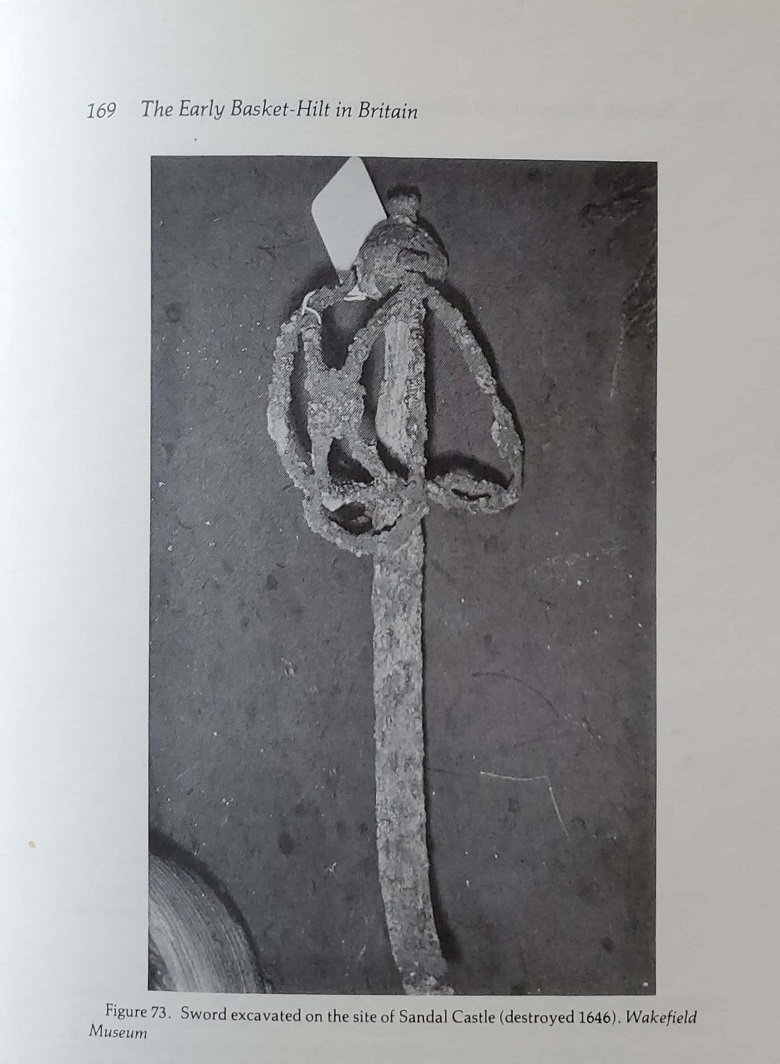

Looking further, "Scottish Weapons & Fortifications" , Ed. David H.Caldwell, 1981, has some key detail, with this image on p.169 (fig. 73) showing a basket hilt from c.1646, but these had been of course in use for some time. In these times the 'basket hilt' was referred to as 'Irish hilt' as in English the 'Gaelic' was the denominator. These types of hilts had been in use in England much earlier and did not become regarded as Scottish until well into the 17th c. as the true Scottish forms developed.

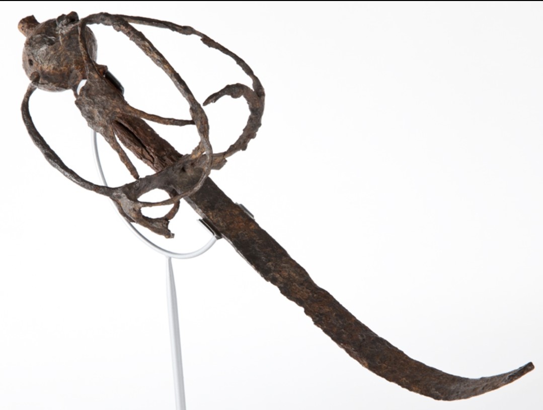

Coming back to Turkey swords and Irish hilts, I had some comms with the Wakefield Museum staff about the Sandal Castle basket hilted sword and unfortunately the curve to the blade is bend damage rather than a curved blade.
