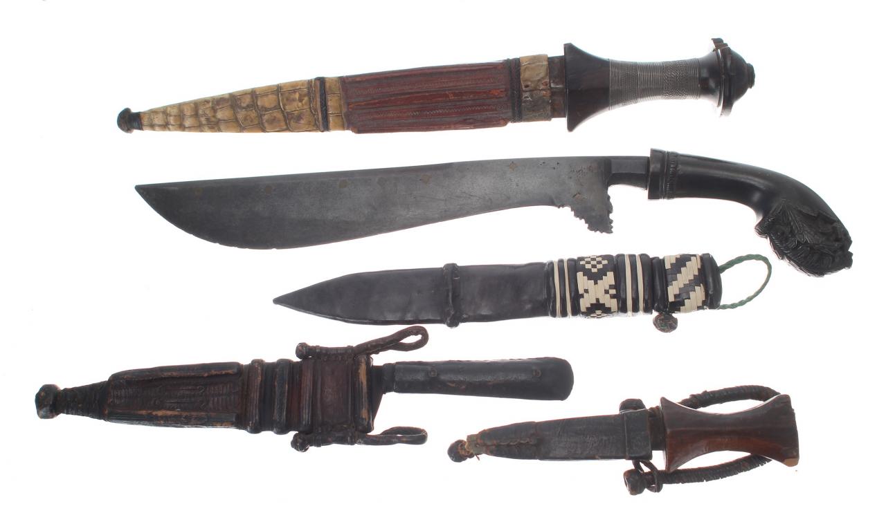

Looking to id the big Asian knife please. Is it a wedung or similar? Balinese? Sumatran? 12.5 inch thick blade with an edge oartway on top spine, brass inlays under spine. No pamor. Blade has been used as the nicks show. No more images or details available presently. Thanks

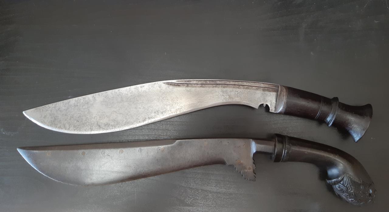

Default Pic
Pic added. Big and robust blade.

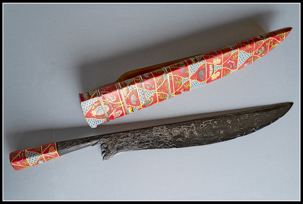

Rob, again, while i generally agree, i must point out that my own wedhung, which is a early Mataram variety, does indeed have a false edge, so that alone is not a valid reason to dismiss a blade as a wedhung. Hopefully you can see it well enough in this photograph, but i can assure you that there is definitely an intentional false edge on this blade.
I will also add that while these are for the most part ceremonial blades, that does not necessarily mean that they were never applied to practical purposes within the keraton. If your king wanted something cut in the keraton, that task could very well be accomplished with a wedhung.
