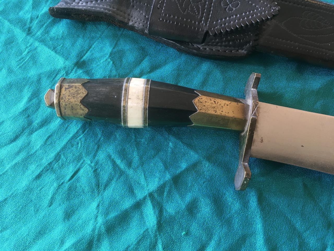

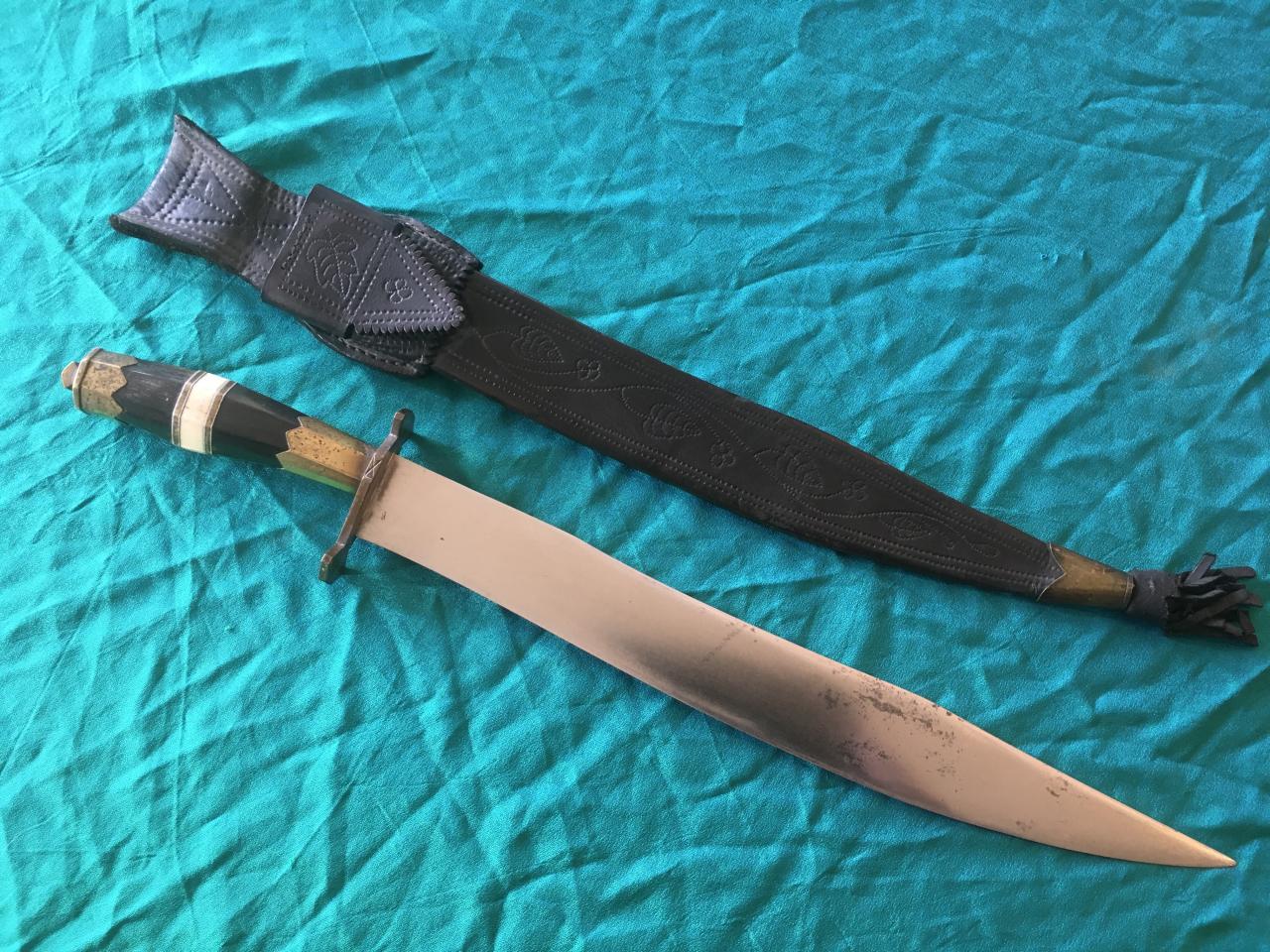

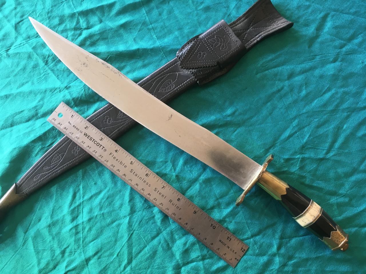

Found this at an estate sale. Everything about it, except the hilt, says Filipino, but I have never seen a hilt like this on a bolo. The Bolo is very solid and the hilt is well made and tightly fitted. Any input on origin, time period or similar hilts would be appreciated.

Hello Protector,
Very nice sword and sheath that you have. Both are in excellent condition, especially the sheath which is unusually well preserved. These were probably made in the second half of the 20th C, maybe 30-50 years old.
This is definitely a Filipino sword from northern or central Luzon. I think it is most likely Ilokano in manufacture, probably from Ilocos Sur judging from the black sheath with its belt loop. The brass guard and brass fittings to the hilt are consistent with Ilokano manufacture. The "double-clipped" blade profile (look at the spine and you will see a central "dip," and then a more pronounced clip to the distal spine) is also consistent with Ilokano work.
Similar swords with the same blade profile and with brass ferrules are made a little to the south in Pampangas, but Kapangan sheaths are different from yours.
Those are my thoughts, but a definitive answer can be provided by xasterix who has studied Luzon swords extensively, and talked with local experts and panday.

I agree with Ian totally. Xasterix informed me that some Ilokanos have moved into Pampangan territory in the past century.

Hullo, nice bolo!
May I ask if the edge is convex grind (V-shape) or assymetrical (flat or almost flat on one side, angled on the other).
