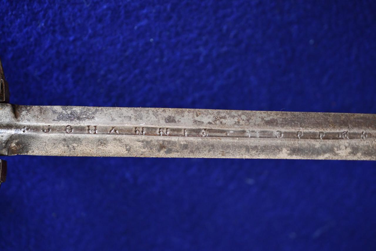

Hello: I read with interest the discussion about German swordsmiths working at Hounslow in the years before and after the English Civil War. I have a 48.5 inch rapier (and matching dagger), with the blade of the rapier marked "JOHANNES HOPPE" in the fullers on both sides. Photos attached. Is this rapier more likely to be from Germany or England? Photos attached. blade length 43 inches. I included photos of the armorer's marks on either side of the blade. Thanks!

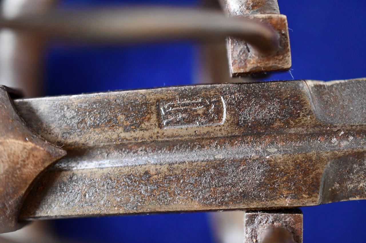

His symbol was The Wildman (see att).
His dates are 1580 - 1645; although they might also be 1570 - 1640.

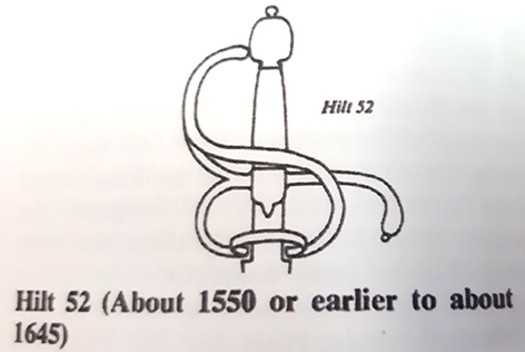

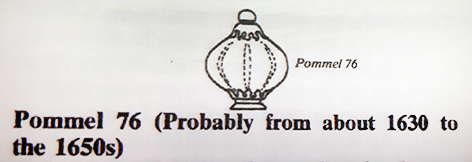

I also looked in Norman, and because of that distinctive branching guard and the pommel shape, while neither example was exact - but perhaps near enough, the date, considering Hoppe's life dates, would be ca. 1630 - 35.

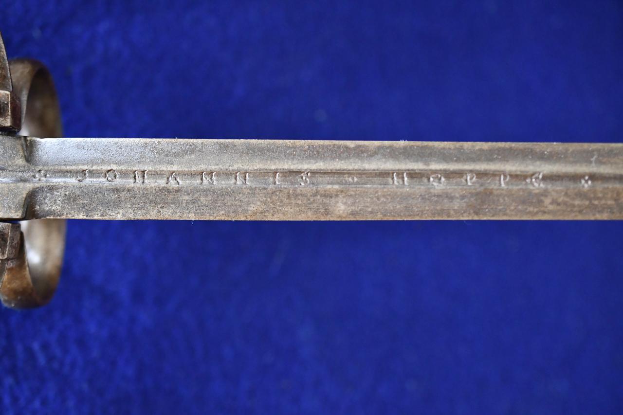

This excellent rapier and dagger ensuite in my view are by the elder Johannes Hoppe (Happe); 1570-1640 and from Solingen. His mark was the so called 'wild man' as termed, and which was later used in degree by his son Johann who was b.1600.
In 1629 the younger Hoppe moved to Greenwich England, and did not go to Hounslow until 1634.
C. Trenchard, in "German Swordsmiths in England" ('Antique Collector' Sept.1934, Vol.V, pp.245-248) states that it is unlikely of course that the elder Hoppe would have gone to England and is known to have died in Solingen in 1640.
While several blades signed by IOHANNES HOPPE are known, those from England are quite rare, with one IOANNES HOPPIE FECIT LONDON ; another form JOANNES HOPPIE ME FECIT HOUNSLOW.
Important is the one JOHANNES HOPPIE 1634 GRENEWICH IN ANGLIA which is on a 'mortuary sword'.
That seems to be the only cases on HOPPIE in England with only the Greenwich having date.
These kinds of 'sets' of rapier/dagger are more likely it seems to be European, aligning with the probability of this being the work of Johannes Hoppe the elder in Solingen.
it is often hard tracking these 'dynasties' of sword makers as they often used the same Christian names from father to son.

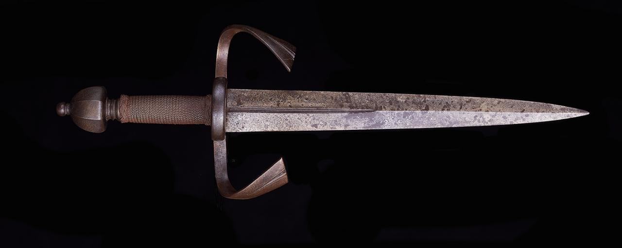

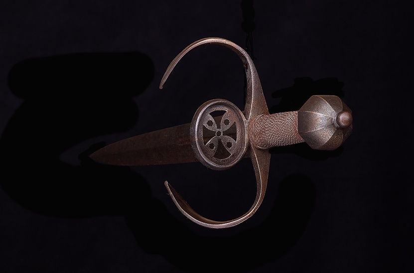

Rapier and dagger show a pair of the Saxon Body Trabant Guard. However, the quality does not speak for production at the Saxon court in Dresden. I assume a production for the guards in Altenburg, Coburg or Gotha. If you want to sell or trade them, I'm very interested.

Looks like Merenti has it right; Saxon provenance. Rather than the dagger having no signature being an issue, if the master smith had in mind to build an inseparable duo, their aspect would be completely equal, not only similar. Down below an example of this type of dagger seen selling out there. Apparently is only plausible for a collector acquiring a sword and a left hand dagger of same typology and format, even in different occasions, and mary the couple. These are hardly Spanish, who used more often the 'sail' type. Most possibly this couple went from Germany to California with no detour by the Spaniards.
Yet everything is possible in this small world. I have a swept hilt rapier made by a famous Toledo Master which, been picked somewhere in the (Southern) States by a guy who brought back to the Peninsula (Portugal for he case), had it in exibition in the handle bars of his motorcicle, in a traditional bike meeting. If i didn't know its history i would swear that it just traveled a few hundred miles from my neighbor country.
And yes, these things had scabbards; however they were highly perishable ... only a few must have survived.

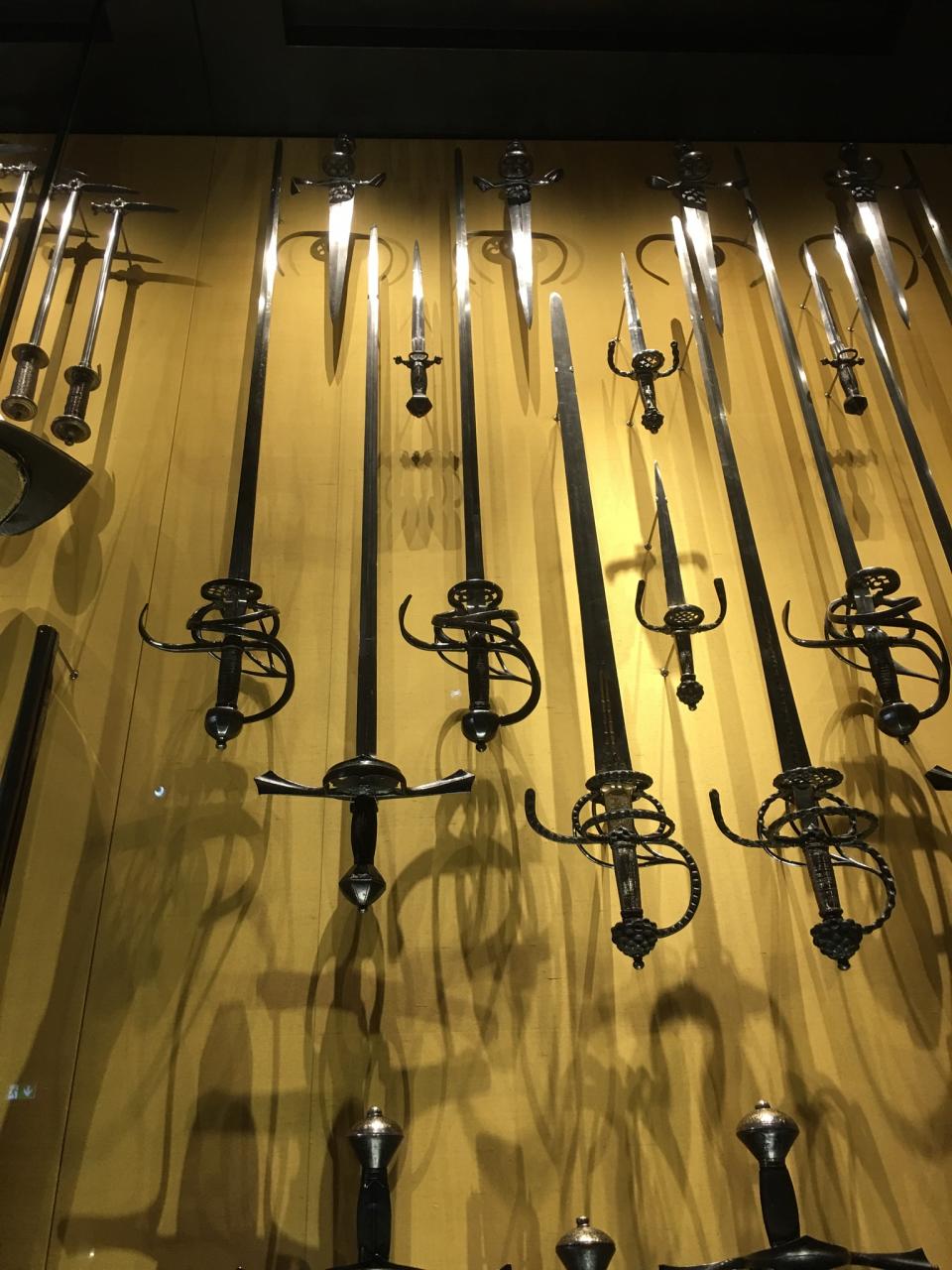

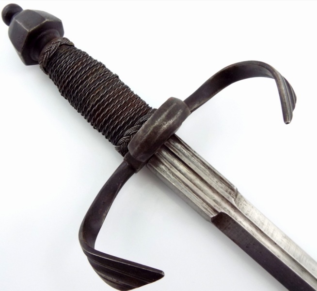

The daggers of the Saxon Trabant Guard were never marked. Based on the new pictures, I am of the opinion that the dagger and rapier are historicism pieces, the blade may be original.
here pictures from the Dresden armory
Merenti is offline   Reply With Quote
https://www.hermann-historica.de/de/.../lot/id/455923
Your shown dagger is a well-known production from the historicism period

Oh ... i don't doubt that Merenti, even though the image i posted is from somewhere else; but probably from the same origin. However correct me if i am wrong; didn't you say the SwordLover's guards are historicism but the blades are authentic ? But i see that you were referring only to the dagger blade, right ?
It is my personal opinion that the dagger of Swordlover blade and guard are historicism. The rapier I consider to be assembled. The guard is historism and the blade could be original. I have often heard that original blades were used. Similarly as the forger Konrad has done
