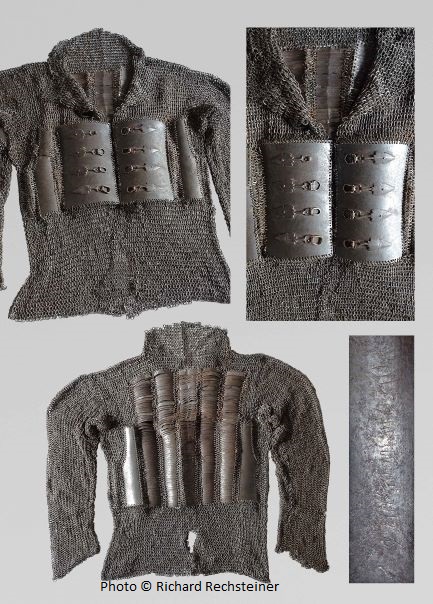

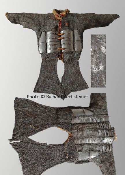

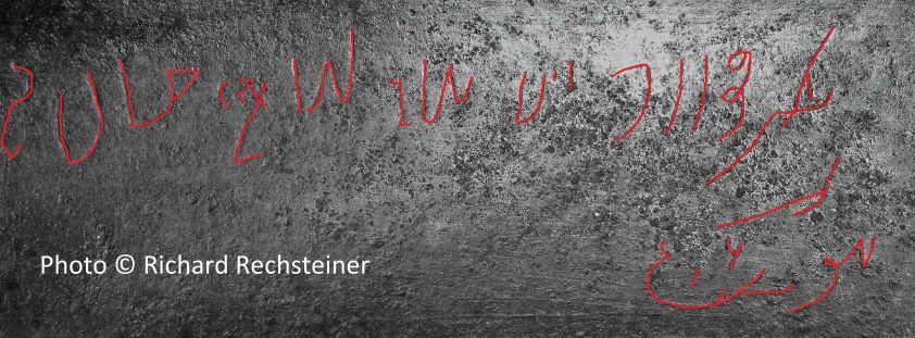

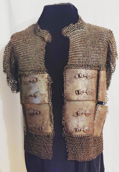

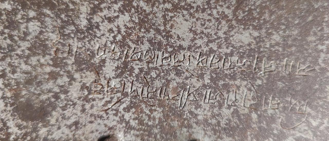

Concerning the cataloguing, description and verification of old incomplete data of some oriental blades and armours, I would like to ask for your help. I would be grateful for any inputs such as possible dating, origin, translation and interpretation of the inscriptions and markings, etc.
The first chainmail-plate shirt (Nr. 1) has a two-line inscription on the inside of the rear kidney plate. The second line seems to be in a different script than the upper one. Unfortunately, the inscriptions are very blurred and difficult to identify. When trying to photograph the inscription, depending on the incidence of light, a different result or other possible guessed signs emerge. I have tried to digitally trace the writing with red to make it clearer, but have probably reproduced some characters incorrectly. I would be very grateful for any information’s, suggestions for translations or possible additions to the blurred letters.

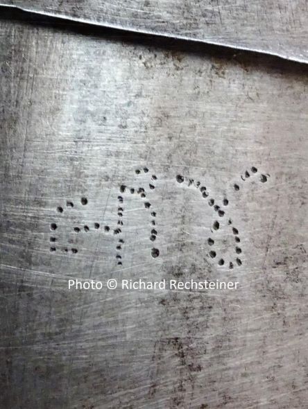

The second chainmail-plate shirt (Nr. 2) bears punch dot markings on the front of the lower right main plate and a second inscription inside the right lower mainplate in the front.
Thanks

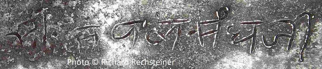

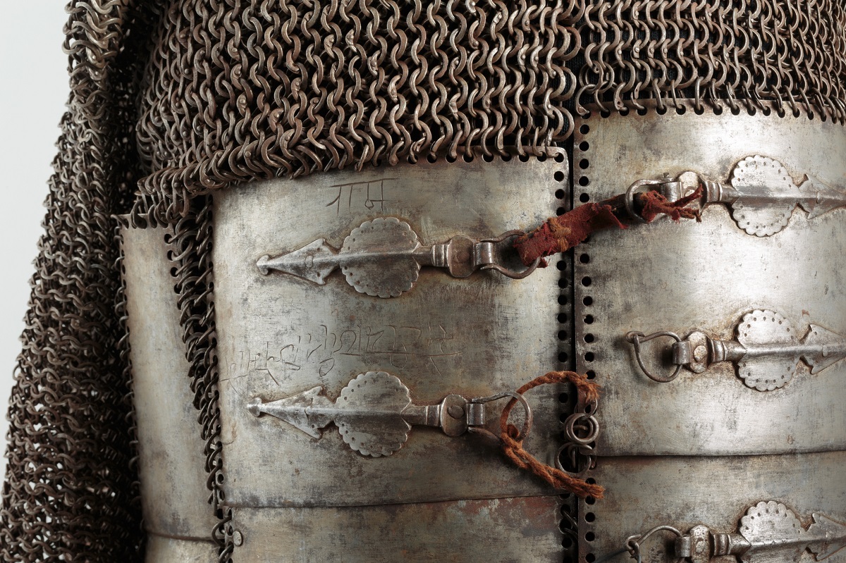

Hi Richard. So, I can provide some help in discerning the scripts of your inscriptions, but I'm afraid I can only fully translate one of the three.
Going top-to-bottom, the first inscription you show is written in an arabic-based script. Something like Farsi, Urdu, Mughal Persian, or some variety thereof. As I am not literate in this script, I can not provide any translation, but hopefully someone on here or swordforum will be able to provide you more information.
The second inscription is a classic Bikaner armory mark. It reads "Bi 4", which doesn't provide much information other than that it was the fourth item (or perhaps piece of armor more specifically) to be catalogued in a given period. Given that most items in the Bikaner armory have multiple inventory markings on them, the fact that yours only has one suggests that it was only in the armory for a short period of time.
The third inscription is written in a Devanagari-based script, however due to the fact that such scripts varied quite a bit regionally until they were standardized in the modern day, I can't tell much of what it is saying, or what language/dialect it represents. However I can read the last two characters, one of which is simply the letter "dh" (ध), while the other is "Ji" (जी), an honorific similar to "sir". Given that ji is usually included at the end of names, it's safe to assume that this inscription gives the name of someone who owned this armor, however again given that I cannot read the rest of the inscription I can't tell you who exactly this person was (other than that their name ended in dh). There are no numbers present anywhere in this inscription, so it likely is just a person's name, perhaps accompanied by some type of devotional saying or the place/circumstance in which this armor was acquired.

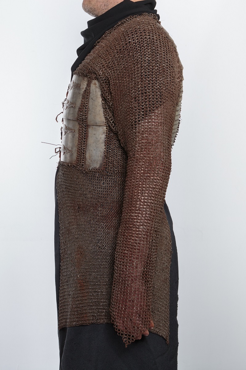

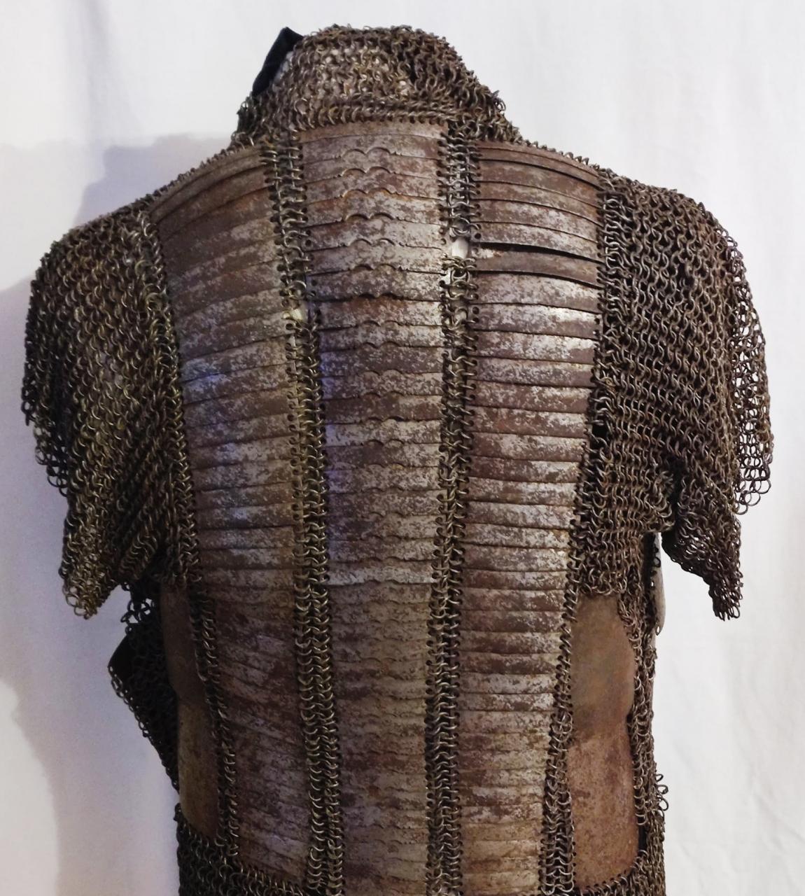

Hi, Richard

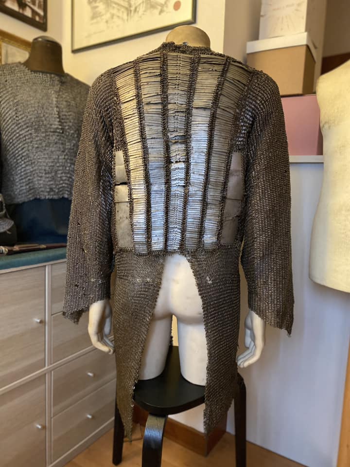

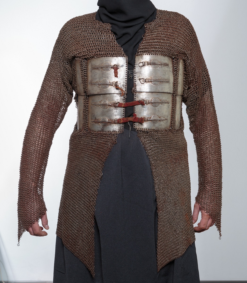

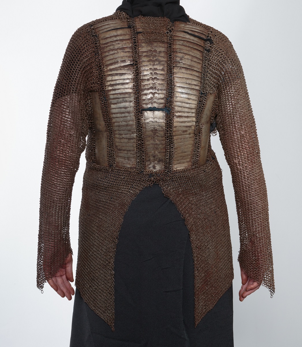

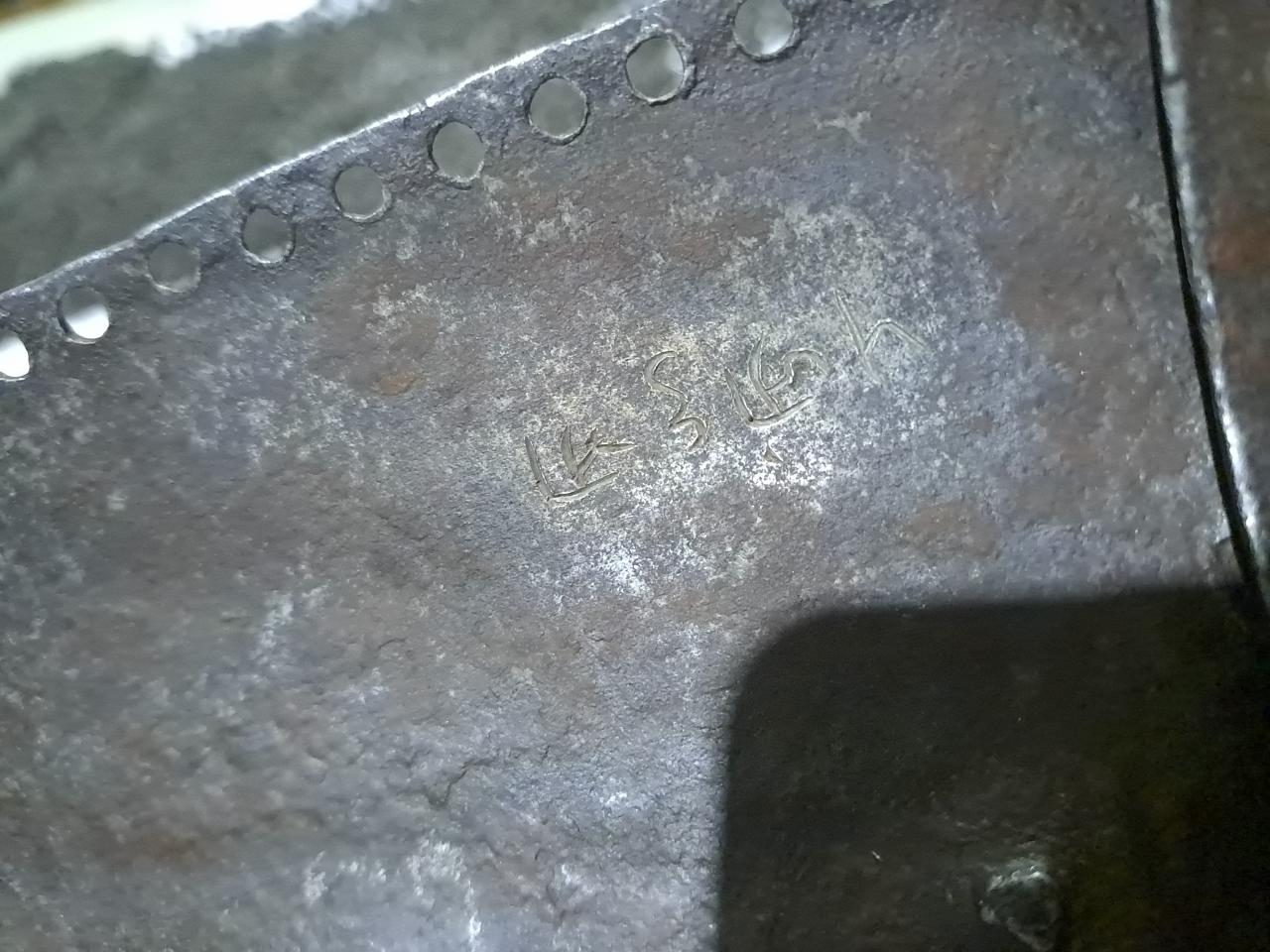

Here are pictures of my chain mail shirt. Unfortunately, I do not have an exact translation of the inscription. The inscription was watched, including by the Indians. But everyone was at a loss with the translation.
Best Regards,
Dmitriy (mahratt)
नाम
सेटीयारठा परा जेमाणे

Thank you for the nice pictures of your mail-plate armour.
Apparently there are chainmail-plate shirts with two main front plates and those with two pairs of overlapping main front plates, as well as those with three or of five rows of small plates in the back.
I wonder if these differences have something to do with a time period, geographic area or the size of the wearer?
Richard

Hello, Richard.
My opinion is that these chain mails were produced at about the same time in the same geographical region (Deccan). And the difference in the number of rows of small plates in the back is related to the size of the chain mail.
Dmitry

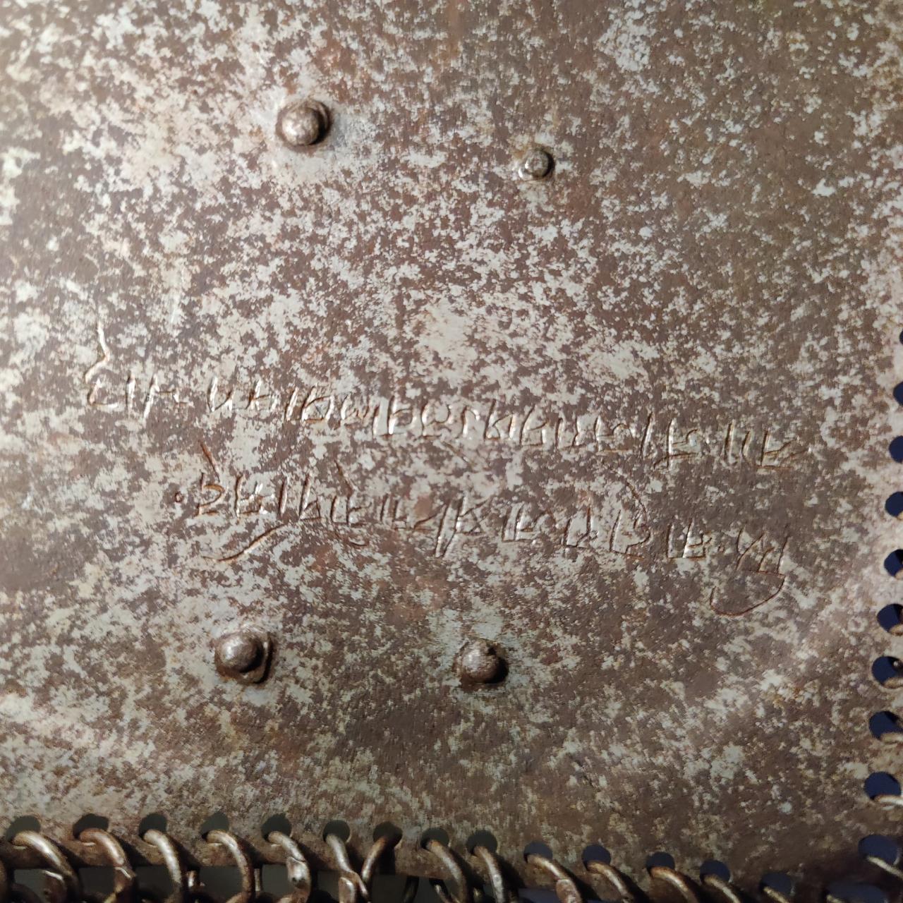

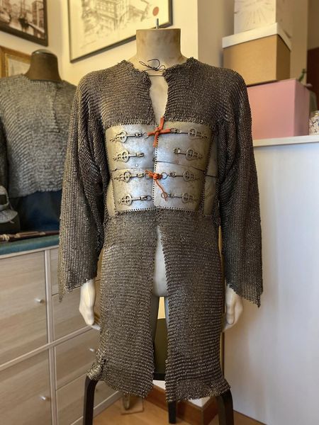

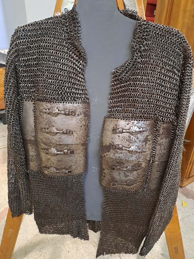

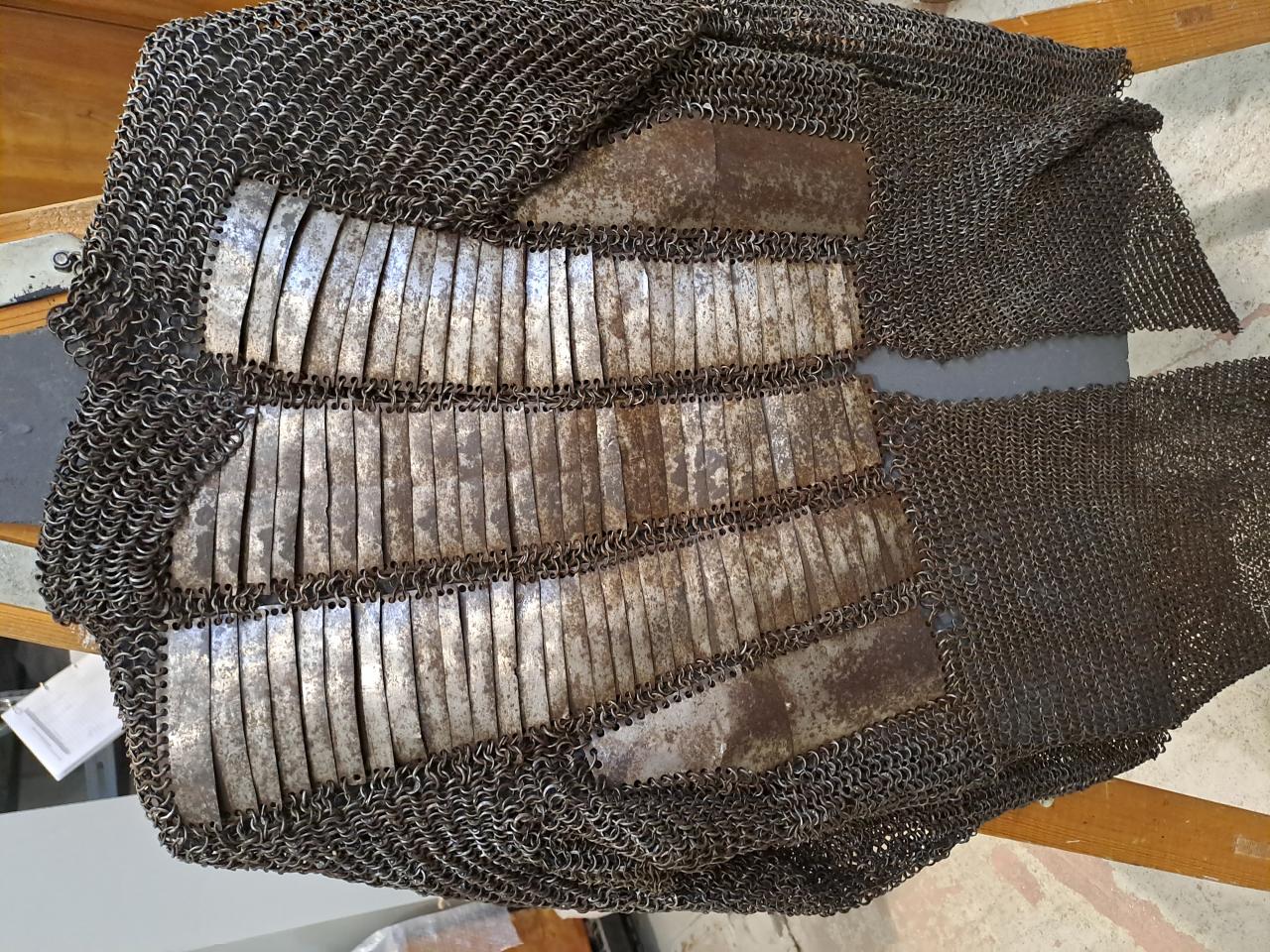

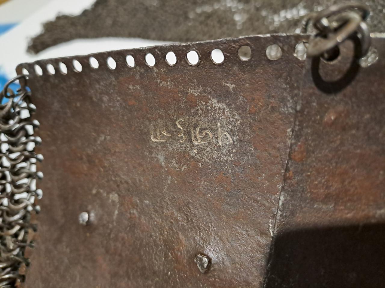

Hello everyone, would anyone be able to decipher this one? The inscription is found on the inner side of one of the front plates.
What's the type of script used here?
LeonymusBosch is offline   Reply With Quote
