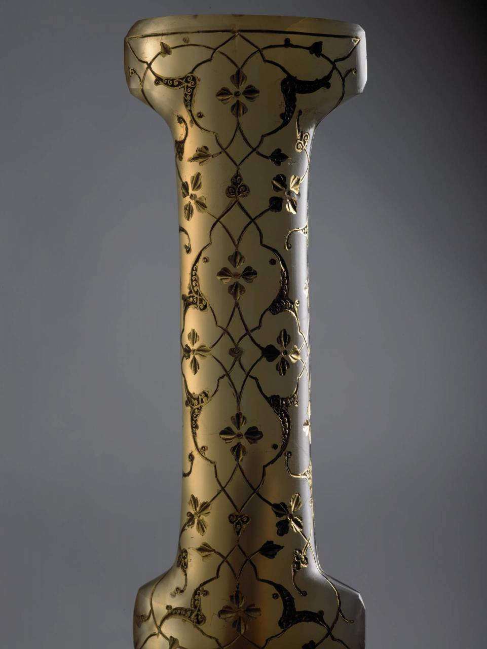

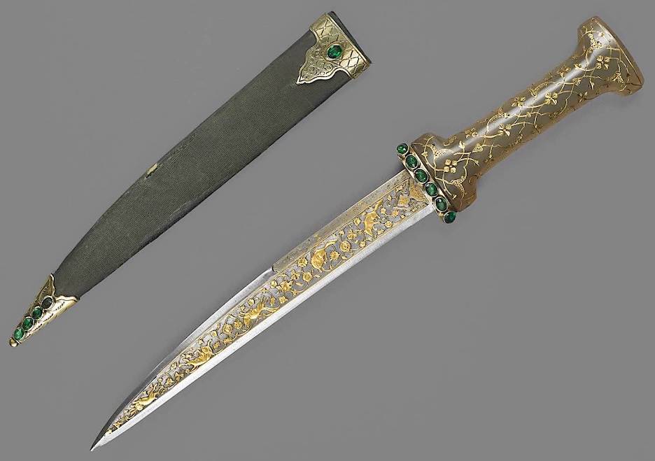

2 things: 1. please post pictures and not links, 2. use the search option and you will find lots of museums posted on this site as well as collectors examples.
Here are pictures of the piece you mentioned for our archives.

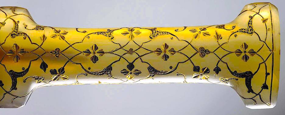

José, i'm not sure why you flipped the photo to a mirror image of the photo from the Wallace Collection page, but for accuracy's sake i am uploading it in the orientation it was originally photographed in.
You also seem to have changed the colour quite drastically on the detail of the hilt so i am uploading that image again as well.
While i do agree that it is always best to upload images directly to our page for archiving purposes i don't suspect that the website for the Wallace Collection will be going away anytime soon.
Images ©The Wallace Collection

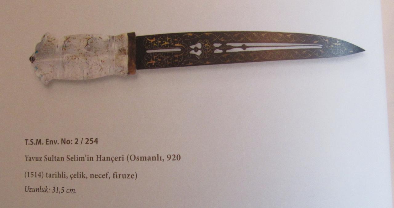

The 15th century Ottoman/Mameluke dagger questions is a good one, as there are not that many known and published examples, unlike swords from the same period. Top Kapi has no online catalogue, but there is a paper publication which shows some of the arms and armor, called Sultanlarin Silahlari (Turkish only). It shows a ton of swords, but only a couple of daggers, one of which belonged to Selim I dated 1514 AD. Early 16th century, but at least close to the 15th century to show what late 15th century daggers may have looked like.

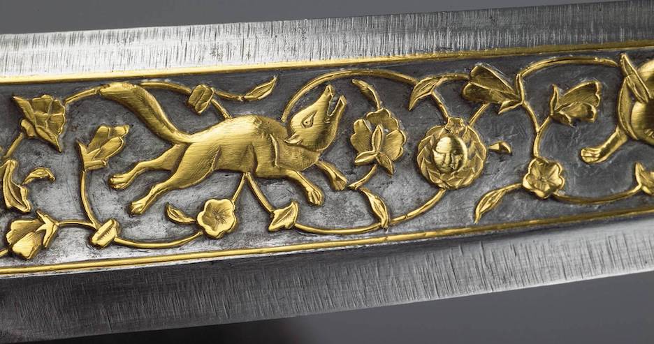

I did do a search and couldn't find very much. I guess that's confirmed by TVV! But I really do appreciate the dagger you posted! The blade looks like some others I have seen from the 16th century (including one in the Wallace collection) that has been posted in other threads (I know because I did a search!):
It is notable that the scabbard is not contemporary to the dagger (it is much later). If anybody also wants the link to the item itself in the online collection, here it is: https://wallacelive.wallacecollectio...lBlockKey&sp=0
