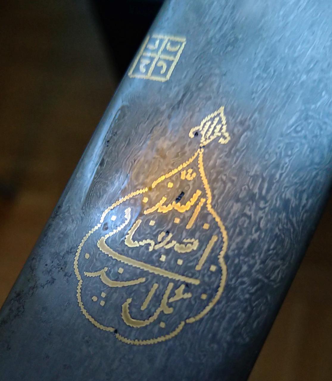

I got this Indian shamshir not to long a ago. Its heavy (over 900grams) and 93cm long. I would guess it is ca 1800 and that the fittings are the original ones.

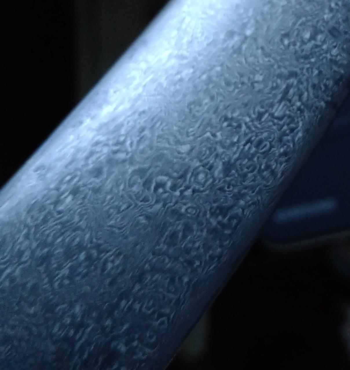

The blade appears to be persian and is made of good high contrast wootz. It is has a magic square and is signed assadullah isifani i think, I would rather it was signed something else since its the most used and least informative signare there can be on a blade.

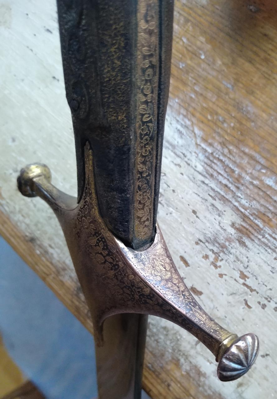

Grip is leather on wood with gold applied over it, the end piece is missing on both sides so either it had a metal end piece or the wood extended all the way and has come lose. This seem to be a less common type of grip in India and I would not say it was an Indian sword based just on the grip.
But the crossguard is clearly made in India, it is gold over copper with flowers punched into the material. Almost all the gold is gone, I imagine the gold layer was very thin so that the flower would still show through. I would think its made in north India, Kutch has a lot of gold on copper with flowers attributed to it.
Its to bad that the condition is not so good and that the grip is damage and the scabbard is missing. I would have love to see it in its pride.
Any additional informations and or/and corrections of my assumptions would be greatly appreciated.

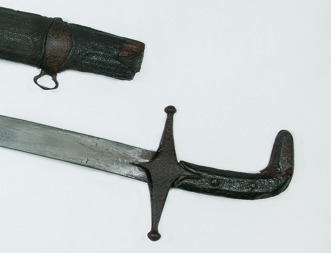

Photos to understand the issue of leather (suede) covers for the handles of shamshirs in the khanates of Central Asia:

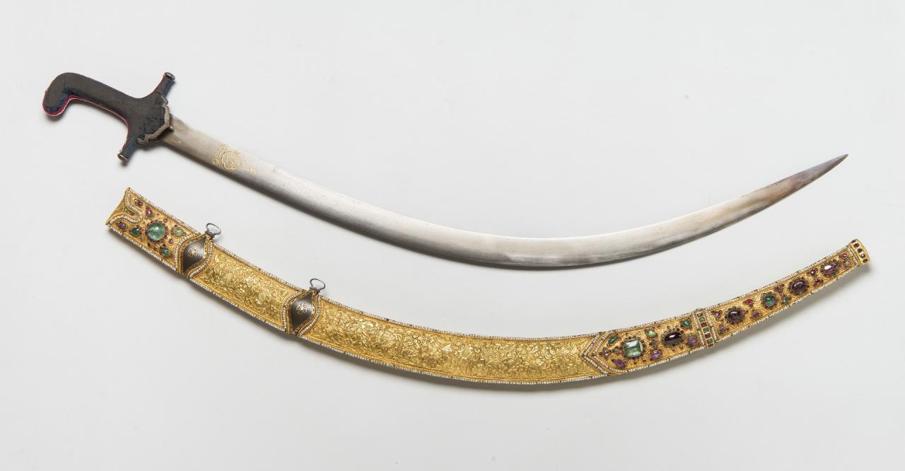

Persian shamshir with a handle covered with leather from the Metropolitan Museum of Art:
https://www.metmuseum.org/art/collection/search/30903

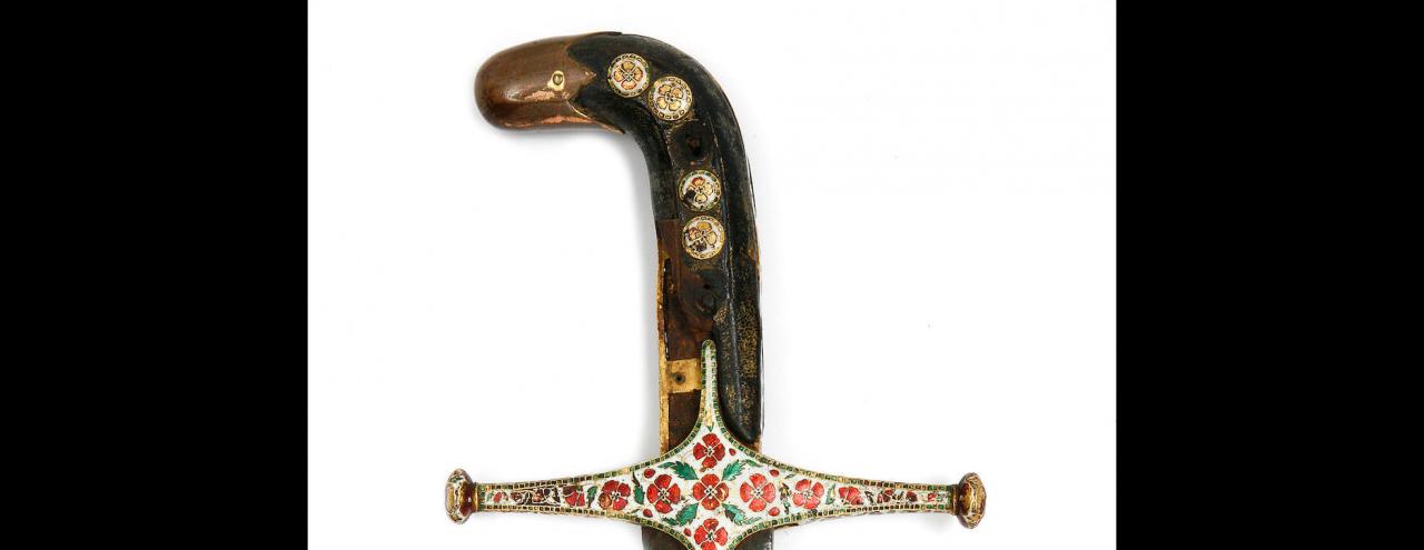

Many thanks all for your kind words. While browsing sold auctions at bonhams i found this sword with leather on wood and with gold applied in a similar manner as the subject sword. https://www.bonhams.com/auctions/18814/lot/46/
Great example, Drabant. Congratulations! In my opinion, you have found undeniable confirmation of the Indian origin of your shamshir.
The only pity is that Ariel will not please us with images of leather handles of shamshirs from Central Asia. I was so hoping to close the gaps in my knowledge on this subject.

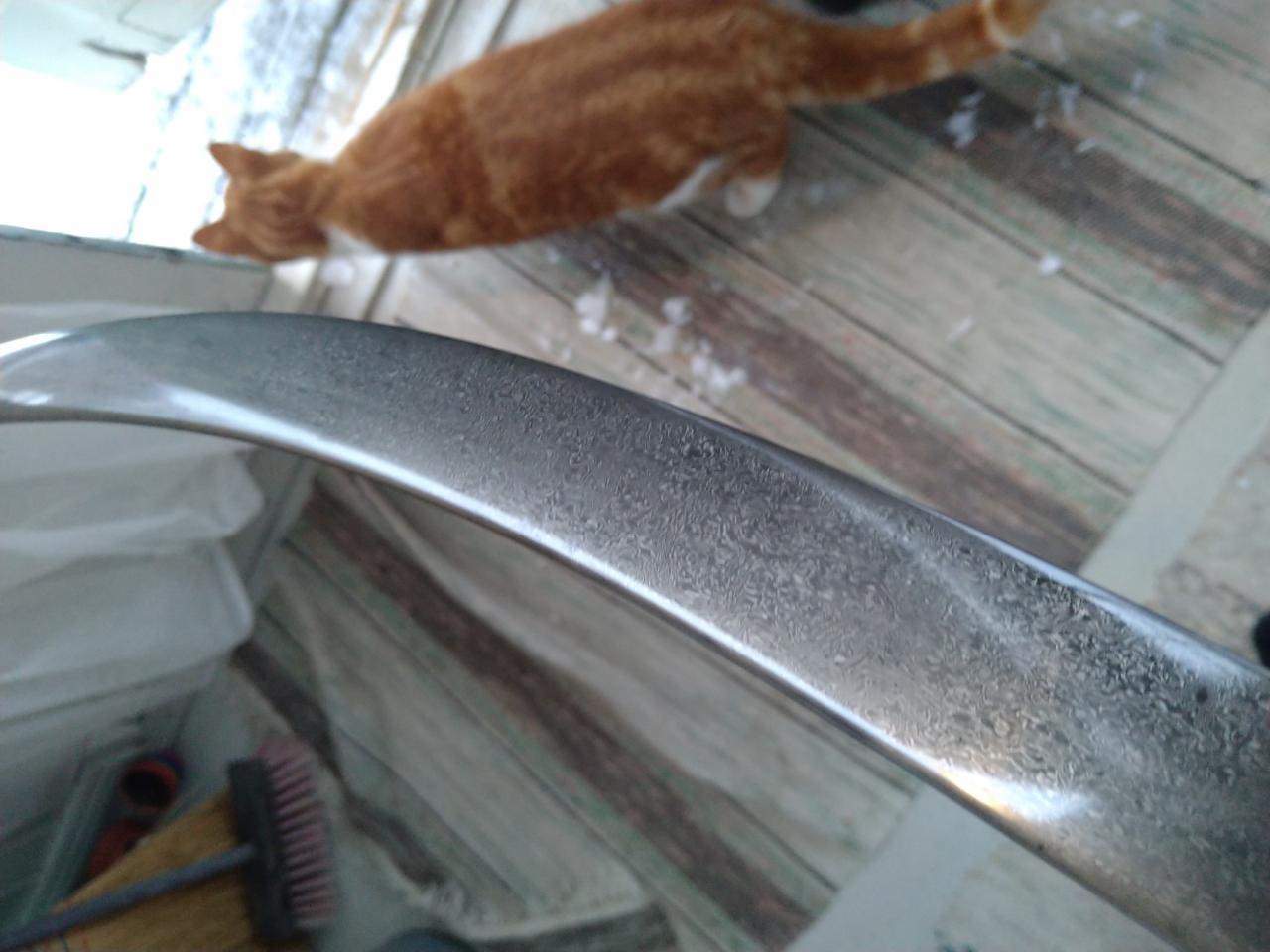

There is a line all the way from the crossguard down to the tip along the back of the sword, it is filled with a silver like metal.

Question
Sounds like a quality blade!
Can someone comment on the quite rough inlay done for the cartouche?
Old 8th December 2022, 08:15 PM   #17
Hello kai
You write that the inlay is rough. Why do you think so? Can you show an example of "graceful inlay"? For example, is this cartouche inlay elegant?
A “crack” on the spine is the remainder of the upper junky layer of a wootz ingot. Sometimes it remains empty, but sometimes it is filled with a silver wire. The trick of forging the ingot into the blade is to bring this part of ingot to the middle of the spine. Usually this “crack” is no more than ~10 cm long. I have never seen it going all the way to the tip. This would be a sign of a superb bladesmith. Can you show it?
The “crack is very helpful if the blade was oxydized and the wootz pattern is no longer visible. Then one can be sure that polishing and etching will bring the pattern back.
On the contrary: this is a very high quality inlay. Usually, the channels are just carved as straight lines. That’s why we often see inlays with lost wire segments.
This one is “zigzag-y” and its labor-intensive creation assures much stronger contact with the inserted wire. Yet another sign of a very high quality of work of the bladesmith.
Assadullah was regarded as THE best Persian badesmith, but the criteria were never defined. This blade, IMHO, would belong to the magical “Assadullah” class.

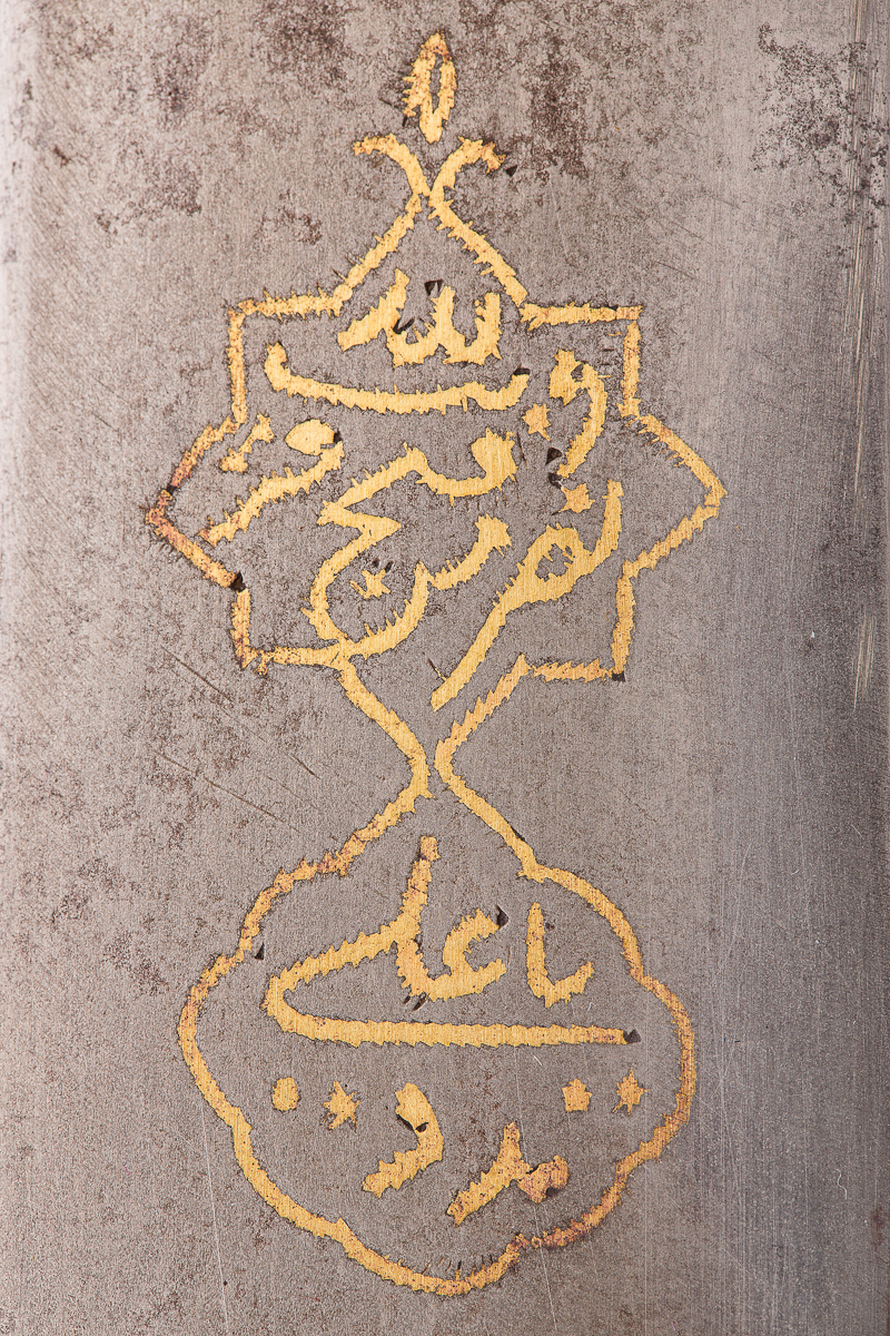

I really can't tell since your pic only shows pixels when blown up to a comparable size, sorry.
Old 9th December 2022, 12:54 AM   #22
Question
Thanks again, both!
I know this style of inlay. This specific version seems rendered more coarse than others in this general style (not necessarily implying bad quality - just wondering whether this might start to affect the reading comprehension); I may not have looked in detail at enough Persian cartouches though.
I understand that the highest quality inlay utilizes undercut channels (i.e. widening below the surface level) which helps long-time retention of gold hammered into it.
Was such inlay work actually done by the bladesmith himself or another artisan? Any differences between Persian workshops and other regions?

Posts: 1,042
Thanks for responding, both!
Old 9th December 2022, 04:19 AM   #24

Location: Russia
Posts: 1,042
I think it's quite difficult to answer your question. The fact is that, in my opinion, Persian craftsmen did not necessarily work in Persia and did not necessarily apply cartouches to "classic" Persian blades.
I dont really see the roughness, the picture is an extreme closeup if you hold the sword and look at it the cartouche appers to be made of solid lines. The style with the cartouche being made of smaller cut rather then solid lines seem rather common on persian blades from this time period.
I looked through Arms and Armor from iran looking at similar cartouches, and i my opinion this one is very well excecuted with the cuts being the same size and the with good symetry.

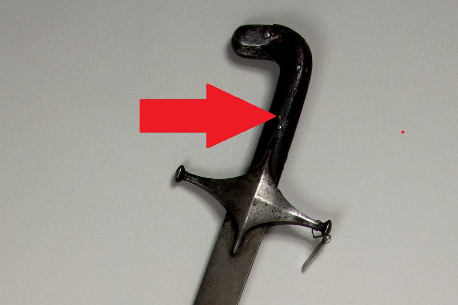

The inclusion running down the spine is can be seen on better blades filled with silver or gold, gold being used in the best blades. Going down the entire spine would be unusual.
As others have said, it is not "rough", the gold was originally thicker and was higher than the blade, it would have covered where the horizontal cuts are. It has worn off with time and scabbard wear to the wootz surface level. The style of the craftsman was most likely a Persian technique of inlay.
