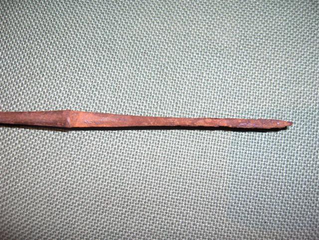

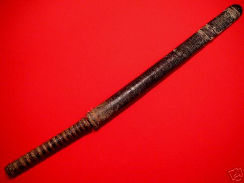

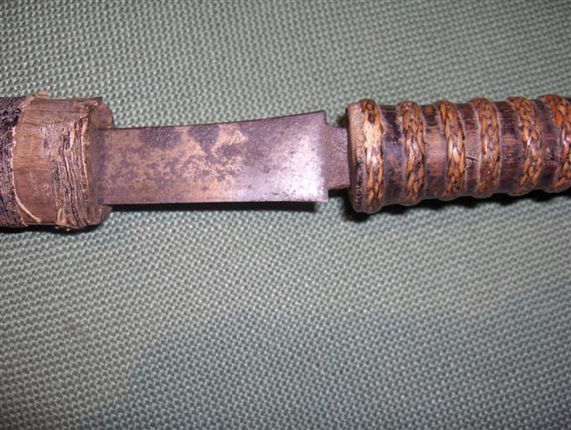

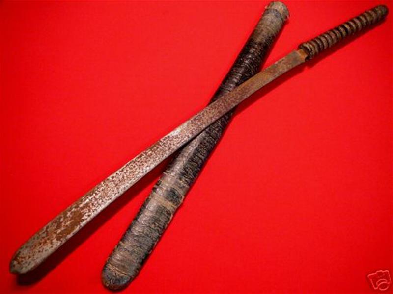

Hi all
my dha collection grows daily. I would be interested in the experts' thoughts on the origins of this one. I am not sure about the Burmese attribution but what do I know. http://cgi.ebay.com.au/ws/eBayISAPI....d=1&sspagename
DrD
Old 26th July 2006, 06:38 AM   #2
Posts: 4,736
Hi DrD:
I think this one may be Thai rather than Burmese, just on the shape of the blade tip which is a recognized Thai style.
The hilt and scabbard seem to have been covered with black pitch or a similar material which has worn off partly with time and use, suggesting that this one may have some age -- 19th C seems about right.
Ian.

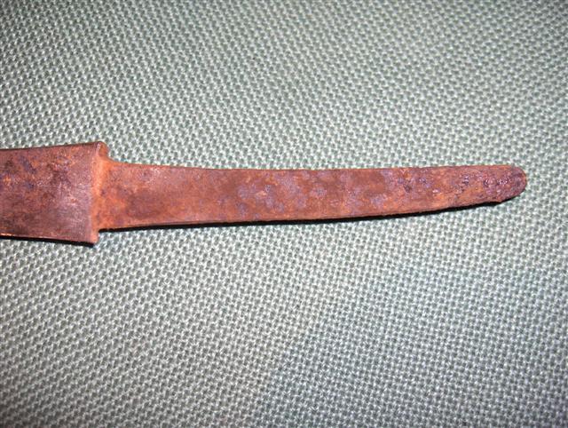

Me too, have a feeling of Thai rather than Burmese origin. There 's no photo for tip detail. But "Hua Bua" (lotus tip) or "Hua LukKai" (chicken tip) tip profile usually associated with central Thailand origin. The handle/blade ratio also fit average value of Thai's. The handle seems to be made of giant rattan. Some parts were missing. If you can take the handle off and take some pictures of the tang, tang thickness might help for its age ID.

Hi Puff and RhysMichael
I am getting a confused. Puff you say the tip may be Hua Bau or Hua LukKai, and Rhys you say Hua Bau or Hua Pla Lod. The pics on the link you give Rhys look like Hua Bau or Hua Pla Lod would be correct , the Dha research site calls similar tips spatulate or spear tip (also translated as Hua Bau). To me spatulate looks too rounded and spear tip possibly too pointed. So could someone clear up Hua Bau, Hua LukKai and Hau Pla Lod for me (just a little)
cheers
DrD
Old 27th July 2006, 01:26 PM   #6
Mark
Mark's Avatar
Posts: 987
Hua bua actually is not synonymous with "spatulate" as I use the latter term. Hua bua has a very small upturned blip at the tip. You need to look closely at the photo on my glossary page & looking at the shadows helps spot it.
"Spatulate," as I use the term, refers to a tip that is completely rounded. The problem is that a hua bua tip can lose the blip trhough wear and/or sharpening. It could well be that what I distinguish as spatulate is actually a worn-down hua bua.
Hua lu guy (lukkai) refers to the tip which has a down-turned back edge, giving the effect of an up-side-down blade (the downward sweep of the back edge is greater than the upward sweep of the keen edge).
And now I'm forgetting what hua pla lod is. From the context its spatulate.
cheers
DrD
Puff is the "man on the ground" so to speak. Anything I add in is filtered by language differences ( if you take away a couple of dha terms I know zero Thai ) and thousands of miles. One of the frustrating yet fascinating things about these swords is how little is printed in english on them . Also we find there are often many terms used by different groups that to us seem conflicting. So I would defer to Puff to know better which is correct.
Old 27th July 2006, 04:13 PM   #8
PUFF
Join Date: Feb 2006
Location: 30 miles north of Bangkok, 20 miles south of Ayuthaya, Thailand
Posts: 224
PlaLod is a kind of fish, Mastacembelus sp.
These are example of Dahb Hua PlaLod...
The upper one is older, Ayuthaya period. And the lower one is Rattanakosin, evolved in some degree. Hua PlaLod described a spatulate tip with the point 's not exactly at the middle (asymetrical tip curvature). And in most case, the point 's not very pointy.
This one is an example of Dahb Hua LukKai, Rattanakosin period.
It 's basicaly spatulate, big round tip with a little triangular beak, looks similar to Hua LukKai (chicken 's head). The little triangular tip could be slightly to the top, to the bottom or exactly at the middle.
We named this one as Hua Toh, just different from CoZun 's page.
And this is Bua (lotus). Dahb Hua Bua means lotus tip, which means spatulate tip with a big triangular pointy tip at the very middle of the tip curve.
PUFF is offline   Reply With Quote

Hi all, herewith as suggested by Puff pictures and dimensions of tang on this piece. Hopefully you might be able to suggest an age. Also Puff you suggested that it was missing some pieces, what would you suggest is missing.
The tang is 115mm long, and 18mm wide and 8 mm thick at the junction with the blade. From the excellent advice provided earlier in the thread I can say up close the tip seems to be Hua LukKai
cheers
Drd

I asked Khun Bancha about drdavid's blade tang. His suggestion is tang's style 's not old Ayuthaya. Could be 80-150 yo northern Thailand (Lumpang Utaradit or near by cities). The round/spatulated tang tip 's related to some nothern Thailand samples.
Khun Dang 's blade 's difinitly Hua LukKai while Ian 's blade 's something between Hua LukKai and Hua PlaLod. I would like to put this one in Hua LukKai since its little beak might be used in the same way with that of Dahb Hua LukKai, which, I heard from MA, used for jabbing (into opponent 's wrist or arm) and disable one's combat ability.

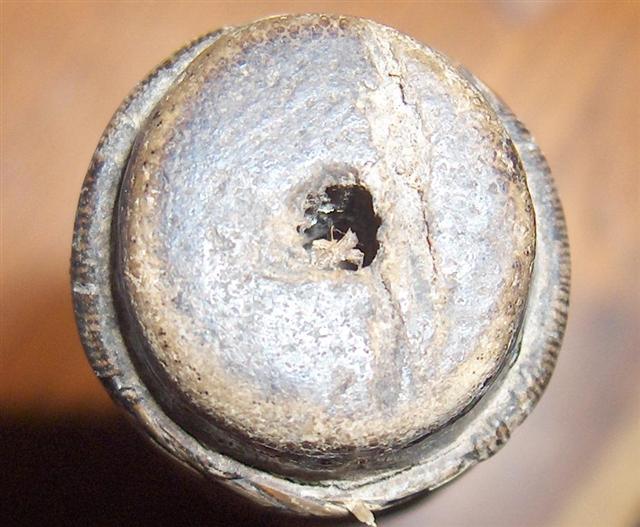

thanks for that. With my piece do you think it would have had a coin on the butt end (I have another which does and it looks like the same size hole to take a little nail in the centre of a coin)? Also is it likely to have had a spacer or metal collar near the hilt as the tang does not quite fit all the way into the hilt (I am pretty sure it is not just a blocked hole). Thanks again.
