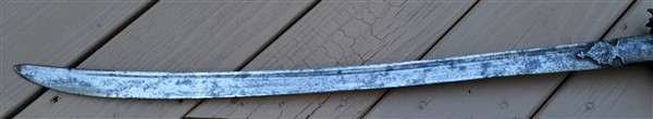

Generally when I think about a Firangi, what comes to my mind is a straight foreign European-made blade, however, this one has a sweeping curve and almost seems to resemble a Chinese Dao. The blade is 31" long.
Old 21st September 2022, 08:21 PM   #2
mahratt
mahratt's Avatar
Join Date: Nov 2009
Location: Russia
Posts: 1,042
I think it is correct to call such a saber not firangi (a firanga has a straight blade), but "alemani", on behalf of the German mercenaries.

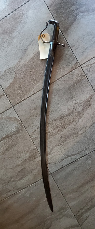

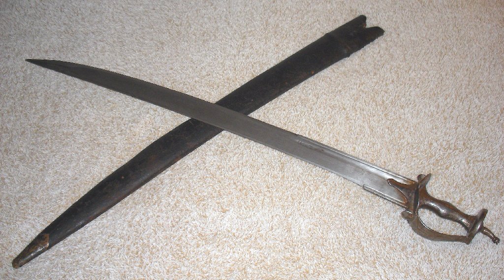

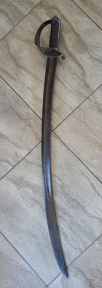

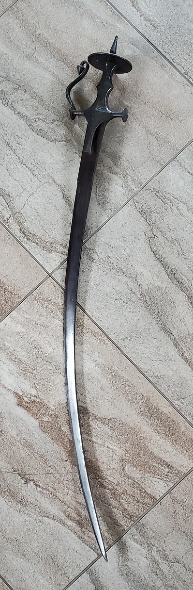

Three tulwars:
First, the familiar Indo-Persian hilt, Rajasthan
second, Persian type grip, Deccan, M1788 British Lt. Cav. blade
third, Native cavalry, 21st cavalry Frontier Force, by Mole.
In Indian parlance all termed tulwar, as far as I have known the firangi term is not applied with tulwars.
These are my interpretations, and I would be glad for any corrections or additions.

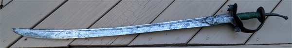

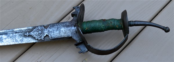

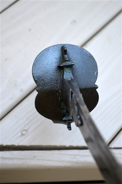

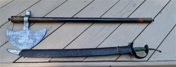

That looks like a fun sword, Rick. Is that a T-section at the forte?
It looks mean. Almost like it's meant to slice bite-sized bits off of and maybe, uhm, "peel" the opponent. *shiver*
Old 24th September 2022, 02:28 AM   #9
Posts: 6,420
It's a great thrusting sword.
No T spine, but it is sharpened about 2/3 of that length, and the point is thickened.
Would this blade be considered a firangi?
