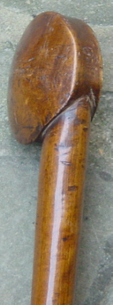

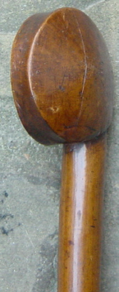

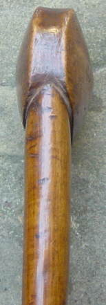

As Southern African is at the top again I just have to add this. I got it today at one of those military junk fairs, I really should not have spent any money at all!!! especially as it was not much of a bargain. So I post it to get good mileage.
Douglas does that book with all the spear info mention anything about sticks and staffs?

Nice stick Tim is it a real club or some form of status ?

I'll start another topic with Zulu sticks and the descriptions from Krige. Then we can keep this topic assegais and have a separate for knobkerries. Got a couple of new ones to show you.
The Double D is offline   Reply With Quote
Old 17th December 2006, 03:39 PM   #20
Posts: 6,023
Thank you ggoudie, It must be a prestige item as it is far too light to be a weapon of war. It may also be more of an East African item. This picture from Men-at-Arms series "Warrior Peoples of East Africa 1840-1900" shows an early Turkana warrior in 1888. The stick here has strong similarities and searching knobkerries, I have found nothing as distinct as this but many beautiful Southern clubs of varied form. So I think it safe to assume Turkana, which I like all the more for the money I should have kept safe from the demon inside.
