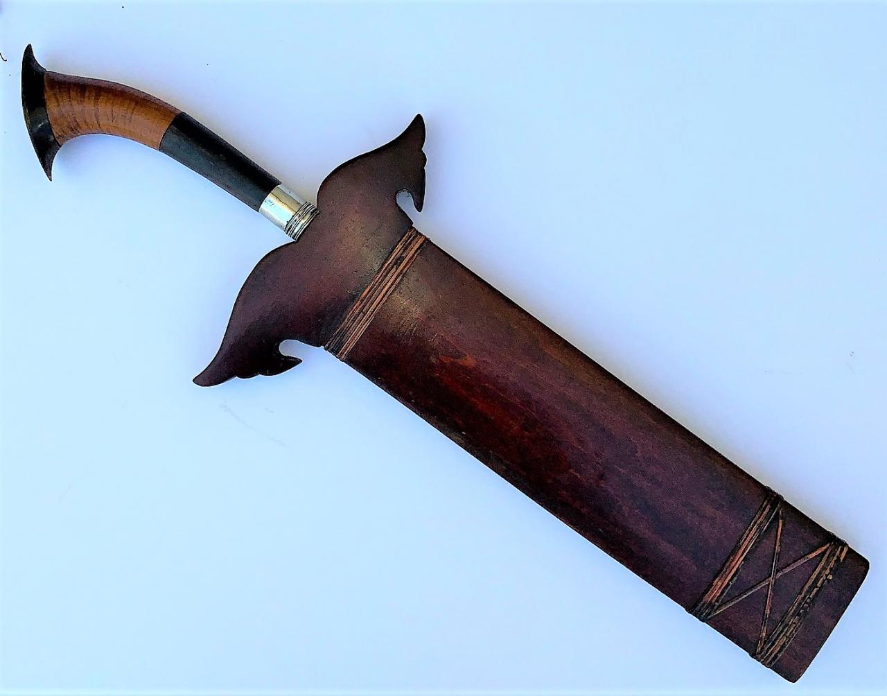

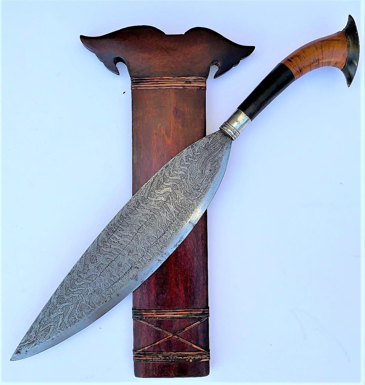

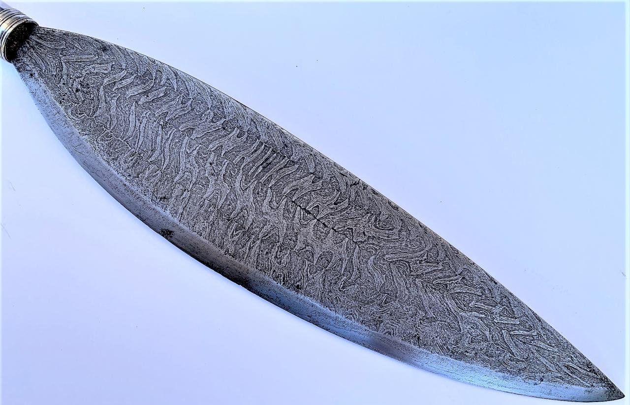

This elegant Yakan Moro barong exhibits a lovely blade forged from panels of twistcore steel that essentially make up the entire blade. It creates an amazing effect and is one of the finest examples of twistcore...on anything...I have seen. As has been pointed out before, I believe we should especially respect the craftsmanship of this blade remembering the conditions under which it was forged.

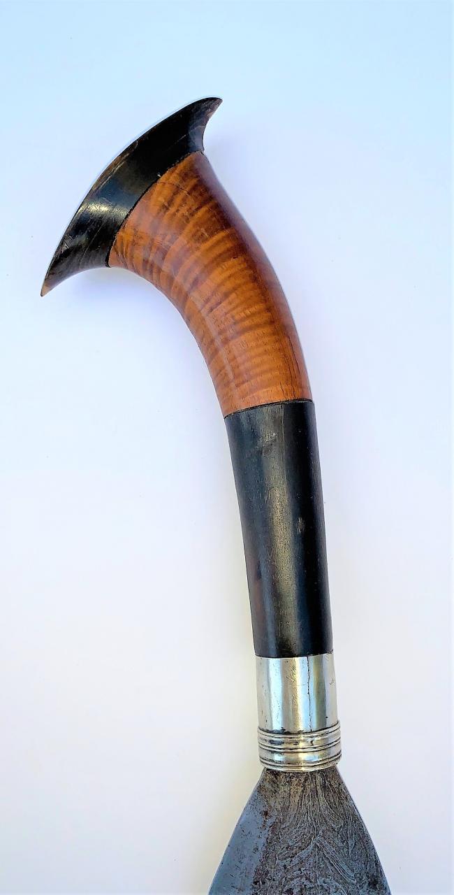

The hilt is from wood with a small silver ferrule and an accompanying horn ferrule typical to Yakan Moro work. The pommel is carved horn.

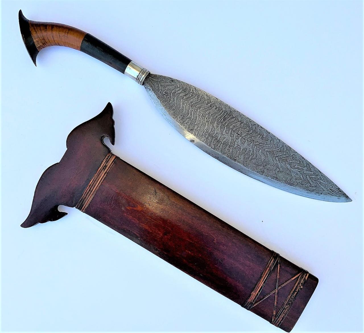

The new scabbard was created by Philip Tom based on three historical examples, and painstaking attention to detail. I finished it with the rattan.

Fantastic indeed! Remarcably well controlled twisted bars while twisting and forging, nearly impeccable pattern as final product.
Congratulations!

On the one hand I see Charles' point of the horn punto sleeve being Yakan, and yet on the other hand the pommel is shorter than the usual Yakan barung pommel.
