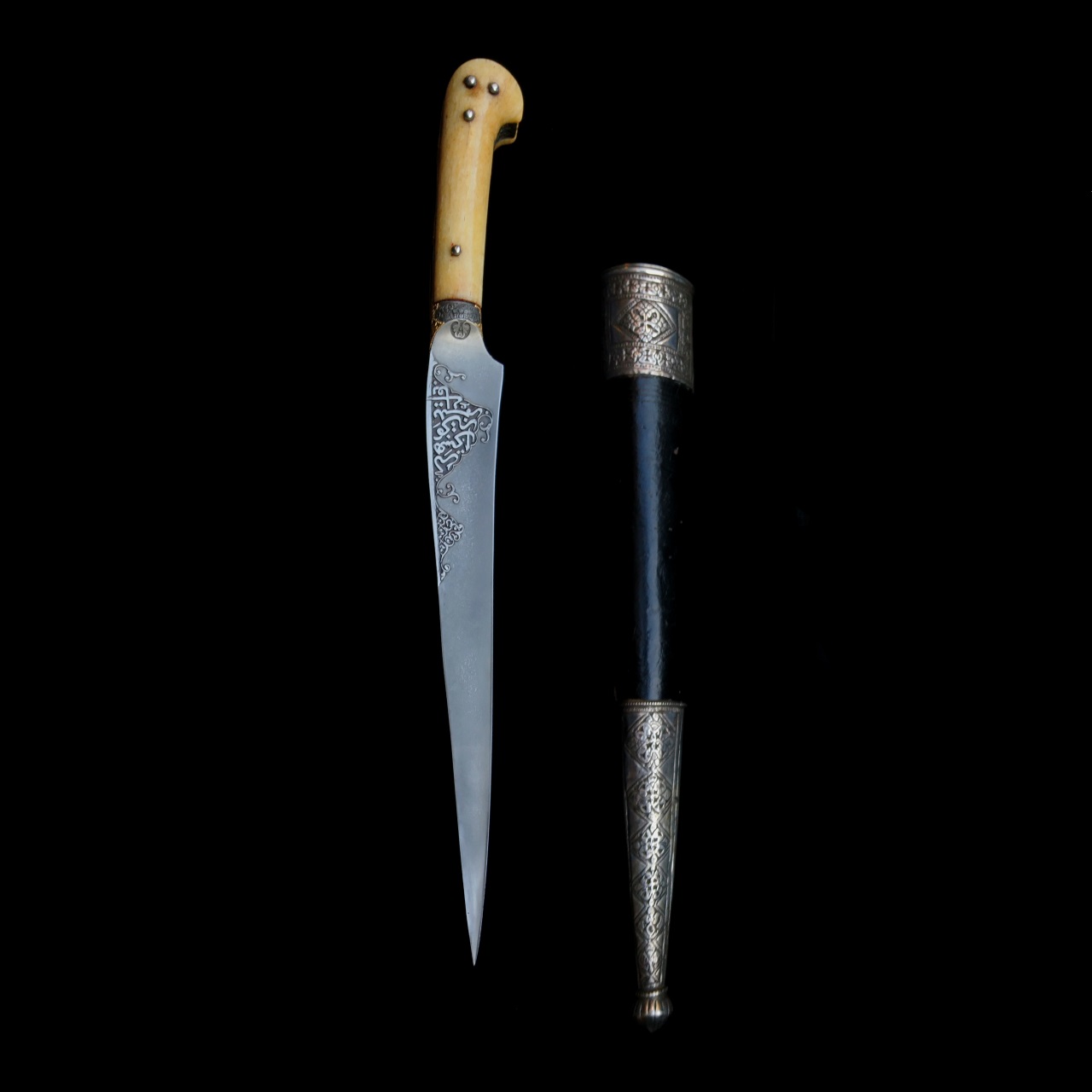

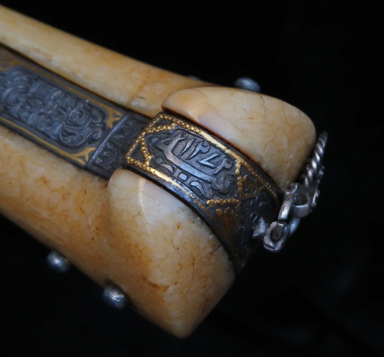

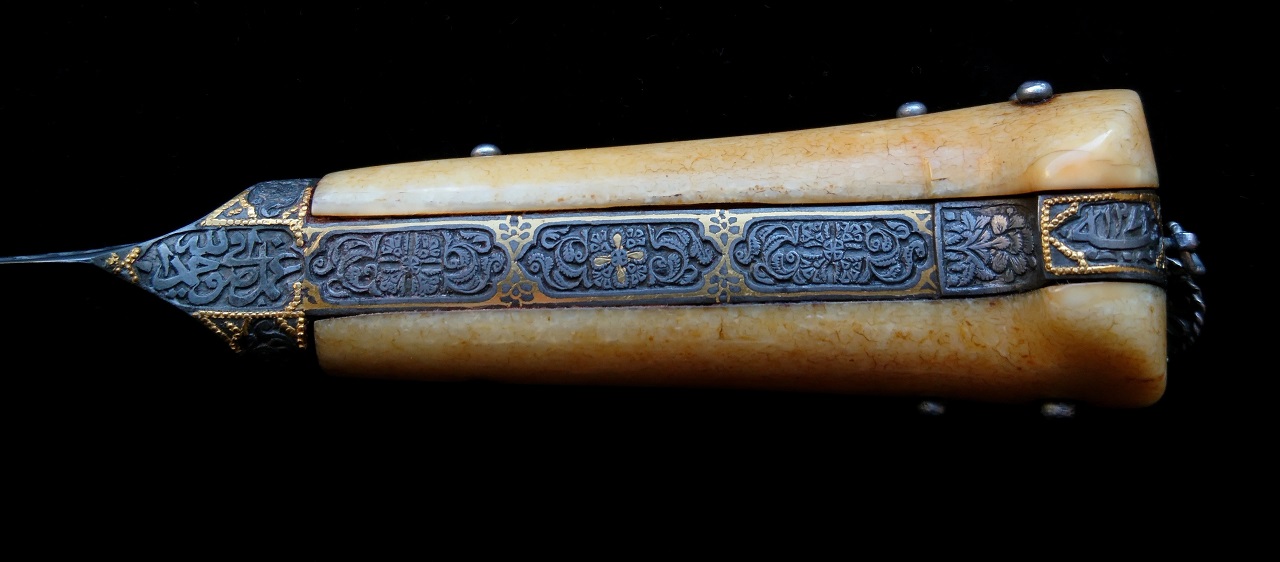

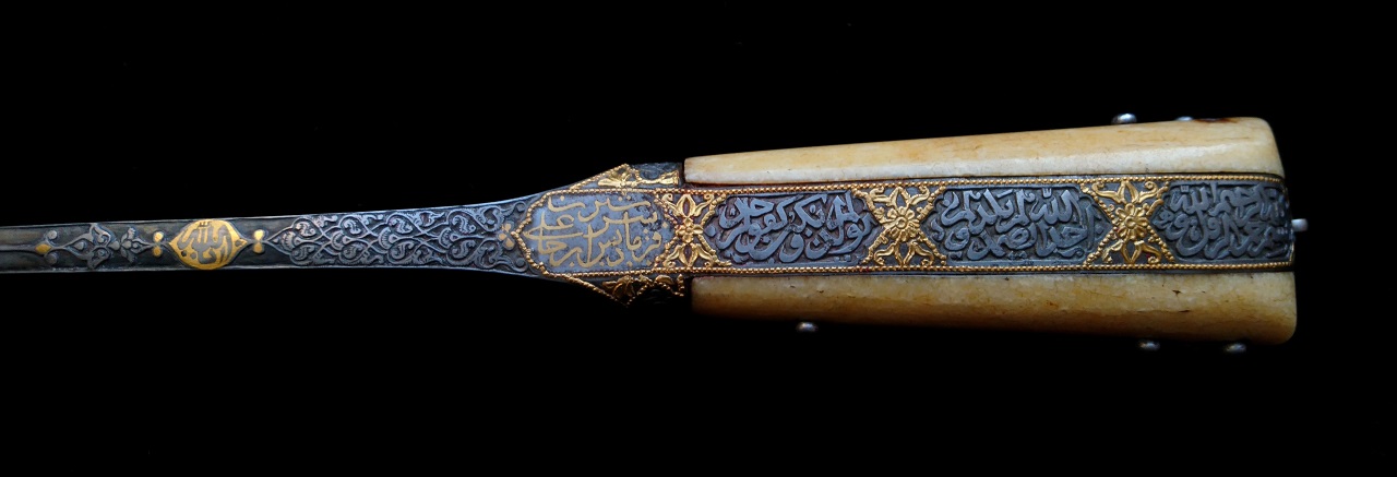

I would like to present a very elaborately decorated Kard I acquired last year and on which I finally finished the last bit of restoration work. It is extensively decorated with chiselling and gold inlay in a Persian manner, but due to several features (recurved blade, 'beaked' pommel, raised rivet heads, scabbard style) I am certain it comes from Afghanistan.

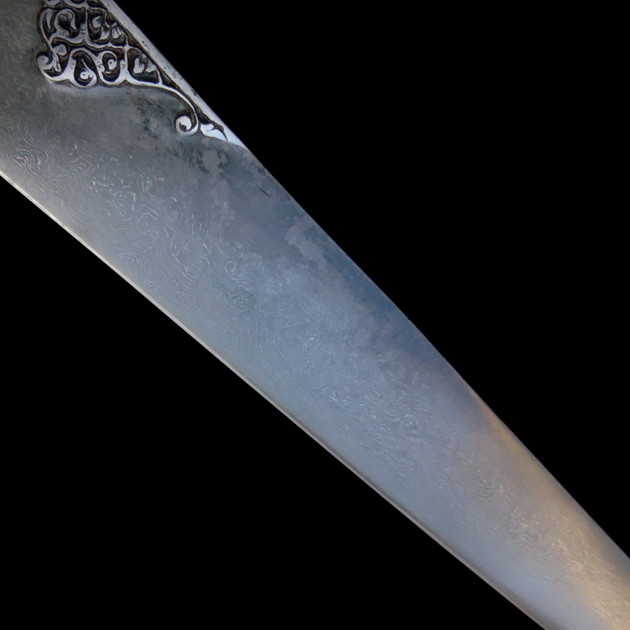

Is is dated to 1272 AH - 1855/1856 AD. The wootz pattern is quite nice in general, but it has quite a few flaws with areas where it complety disappears, which to me fits both to the late date of manufacuture and an origin outside of the major production centers in Iran.

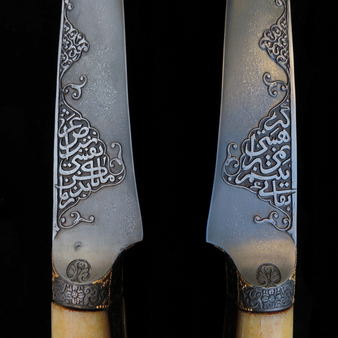

For the maker's name I would suggest احمد صوفی الله - Ahmad Sufi Allah, and for the small aftabi inlay on the spine of the blade يا الله - Oh Allah.
The inscriptions on the backstrap and on the flats of the blade are way too complicated to read for me, although I can certainly spot several Allahs and Alis, so I would assume they are of a religious nature. If Kwiatek or someone else would be able to decipher those I would be very grateful.

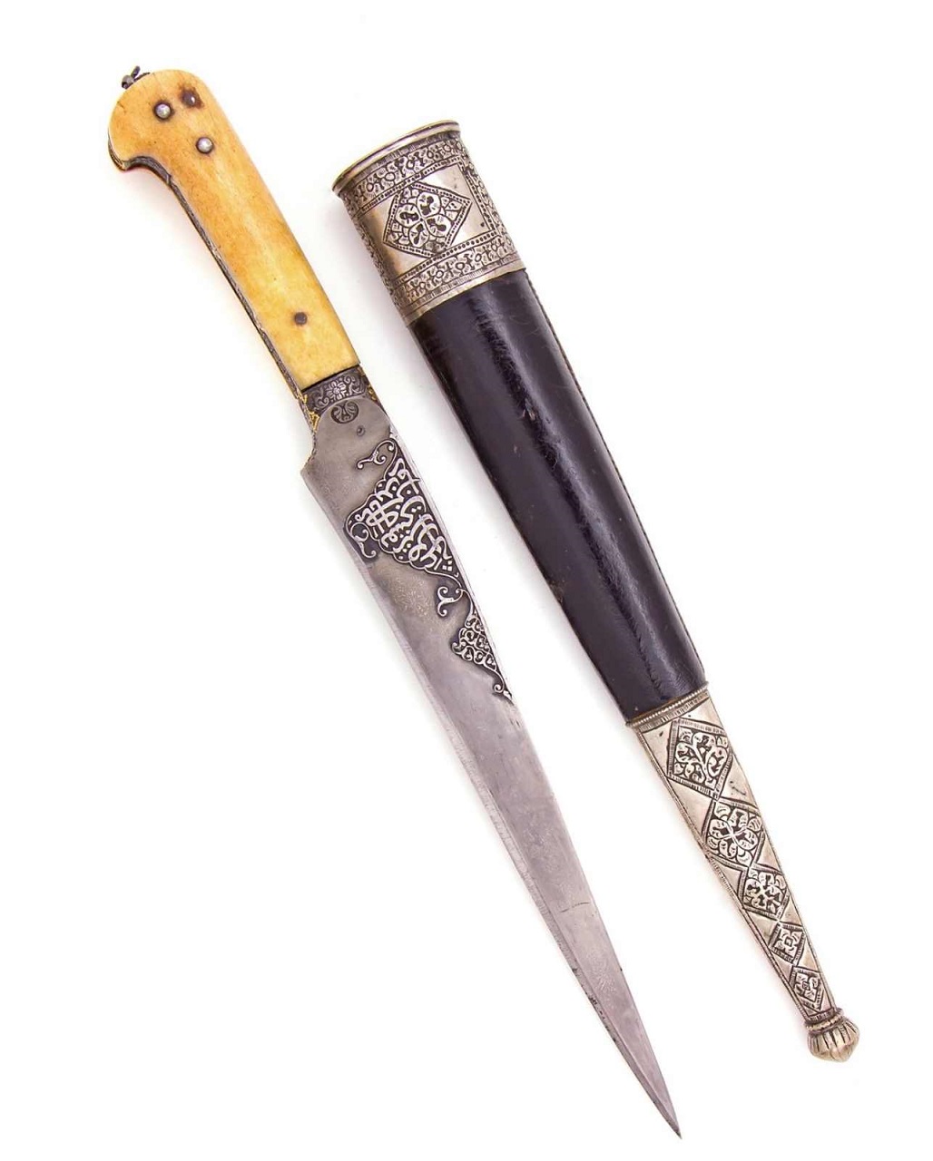

Thanks all, it certainly is a step up in quality for my collection.

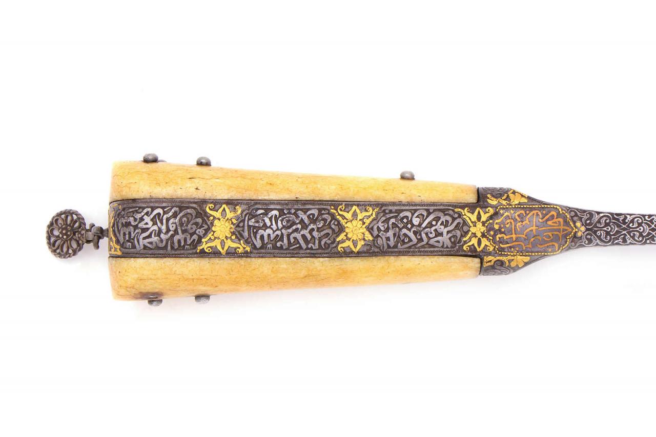

I unfortunately did not take any photos pre-restoration myself, so I can only show the auctioneer's pictures.
It seems the knife was 'restored' before and someone took a rough grinding wheel to the edge and went way overboard with it. It really bothered me and I did the best I could to correct it to a more appropiate shape as far as possible. There was also some of the goldwire missing which I have had restored by a specialist because that is beyond my paygrade.

This is an exceptionally beautiful knife and a wonderful restoration.
How did you manage to bring the cutting edge back to its current state?

Nothing fancy, just grinding the flats of the blade down and polishing everything up again for the etch. It was a bit of a challenge, especially where the chiselled cartouches came very near to the edge, but I am pretty happy with how it turned out.
I use diamond coated knife sharpening stones for the rough grind. An odd choice perhaps, but they are small and handy and I never got the hang of properly moving a blade over a large whetstone. Fine polish with sandpaper with a hard backing.

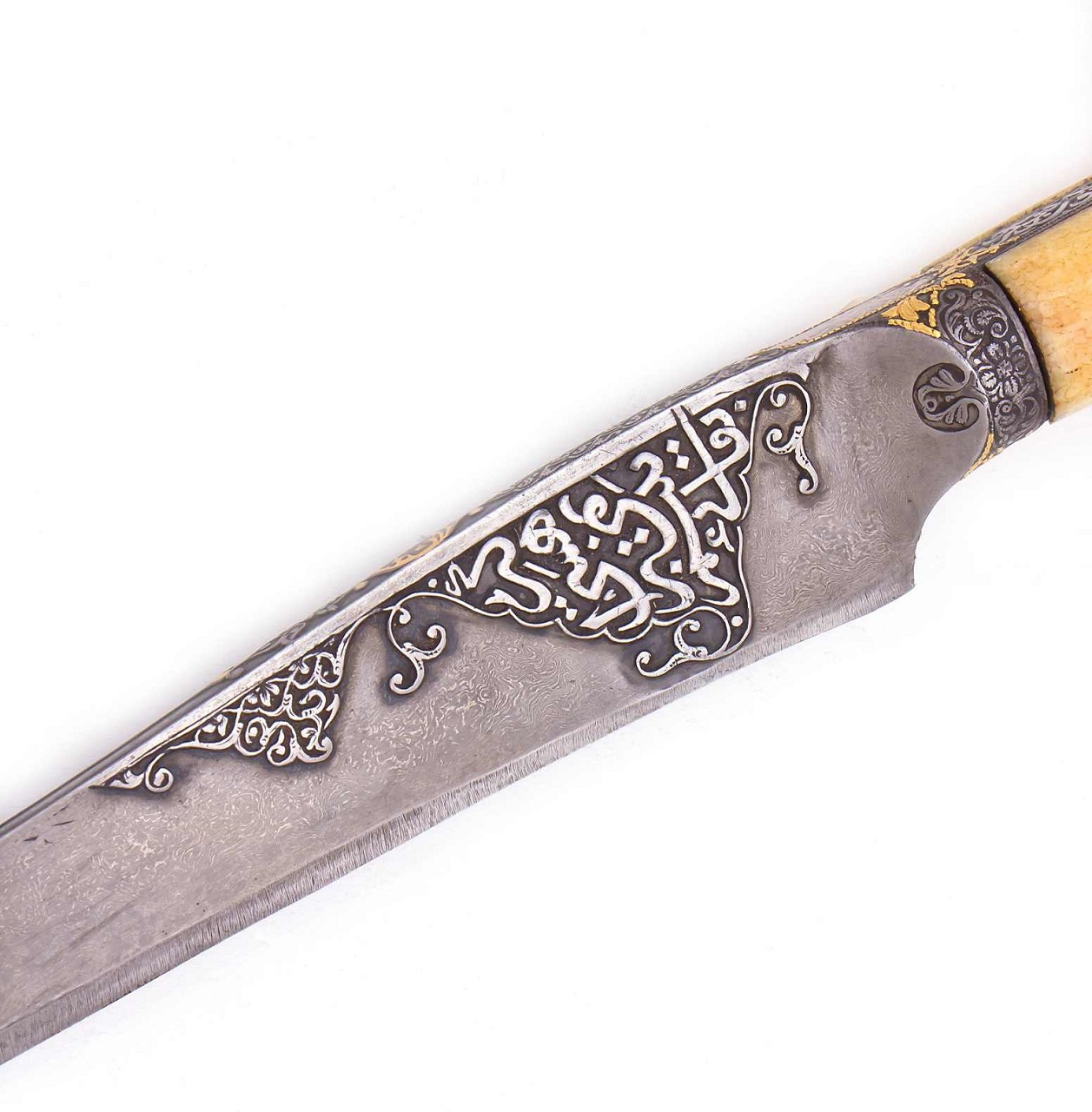

On the blade is a famous couplet from the Gulistan of Sa'di:
غرض نقشیست کز ما باز ماند
که هستی را نمی بینم بقایی
"The aim of this design is that it should outlive us,
For I see no permanence in this existence"

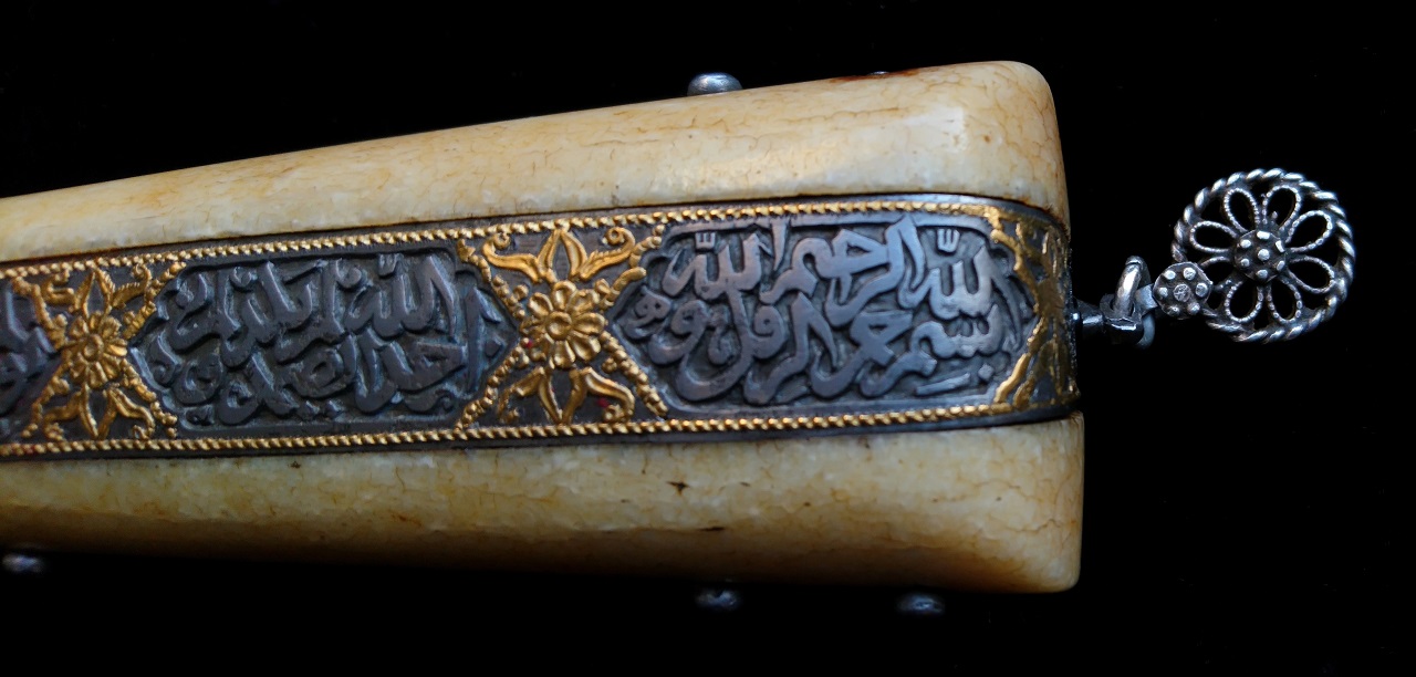

Down the back of the grip is Surat al-Ikhlas (112)
In the cartouche at the back of the base of the blade I would suggest the following
فرمایش سردار شیر علی خان
"Commission of Sardar Sher 'Ali Khan"
The date and name of the maker I read as you have done
سنه ۱۲۷۲
"Year 1272 (1854-5)"
عمل احمد الله صوفی
"Work of Ahmadullah Sufi"
The names strongly suggest the owner and maker were from Afghanistan. There was a member of the Barakzai dynasty called Sardar Sher 'Ali Khan who was vizier to the governor in Herat and later governor himself of Kandahar. His dates fit too
https://www.royalark.net/Afghanistan/barak5.htm
