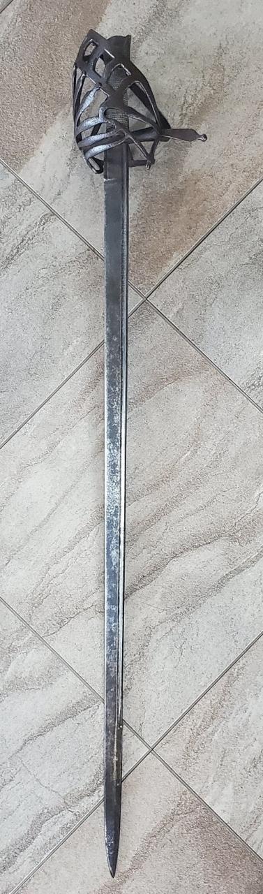

My biggest regret was this schiavona that I was bidding on last September. It was sold with a haudegen or walloon sword, but my focus was the schiavona. This isn't the fanciest example I've ever come across or the most well-preserved, but something about this sword in particular appeals to me and I am still sad I didn't manage to get it. The basket looks like it wants to cradle my hand and I like the chiseled highlights. The broad blade looks like it has a high degree of distal taper and the broad, deep looking fuller gives it a kind of brutal-yet-elegant look. I am very curious as to how it feels in the hand. There are some modest engravings on the blade that give it just a bit extra. The pommel has some nice little details and the brass gives the whole thing a fun little highlight.
I have only a modest budget and I decided to bid far more than I usually do, for my 40th birthday. Sadly, not enough, as I was only the second highest bidder even after going a fair bit outside my comfort zone - though I bought two other swords for the money I set aside that I'm now quite fond of (one of them from here!).
I will forever be chasing schiavonas (schiavonae?) that have this kind of broad fullered blade, cat's head pommel and hilt.

Hi there,
The plural is schiavone.
The one in the image you attached is a nice one. These swords don't have to be fancy to be appealing, they were workaday weapons made for mercenary soldiers. Condition is not all that bad, I've seen worse. Sorry you missed it! Fortunately these aren't all that rare, perhaps next time your luck will land you one with its period scabbard!
The hilt basket on this one is an early version of what is classified as Oakeshott Type 2 in the reference literature, appearing at the opening of the 17th cent. and remaining popular for some decades thereafter. The broad blade, with single deep fuller and negligible taper in its width, is of a form reminiscent of an early style classified by most modern scholars as Oakeshott Type XIIIb which is much-depicted in later medieval art .
These swords have a nice balance, the basket incorporates a thumb ring which ensures a firm grasp in the hand.

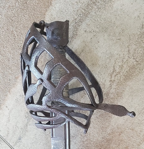

The rings have always struck me as slightly odd and a bit anomalous somehow but maybe that's because I don't have a good handle yet on how Walloon hilts and Schiavone* developed. Did thumb rings develop from the nagel on Messers, by any chance?
Thumb rings are found on quite a number of different European sword types. For example, they are found on Styrian / Bellunese riding-sword hilts ca 1560-70, and also on Polish sabers from the 16th through 18th cent. I don't know if there is any connection between this feature on the Messer and the schiavona.
Attached here is a dorsal view of a schiavona hilt, just below the axis of the grip you can see the thumb ring incorporated into the basket. These, like Polish sabers, are not unduly heavy swords but having the right thumb hooked on the ring contributes a lot to control and the ability to secure the weapon during use, without resorting to a wrist-lanyard.

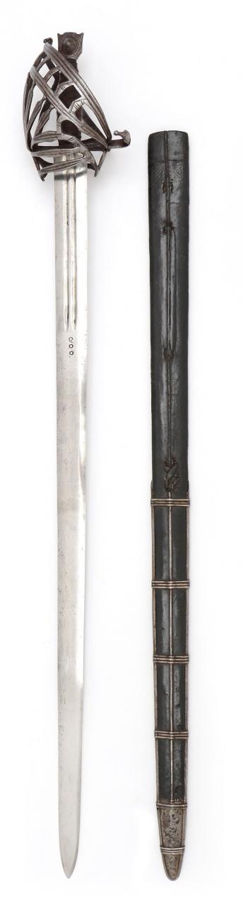

Here are additional pics of the same schiavona. Note that the diagonal border of the basket, on the obverse side, is composed of two parallel bars, with "ladder rungs" in between them. This is the mark of a Type 2 hilt. The later and more ornate variants, Types 2a and 2b, have two and three rows of these rungs or steps, respectively, forming the outer border of the basket.
The well-preserved scabbard on this example has the iconic sailor's knot braided into the seam of the leather, representing the Republic of Venice's symbolic marriage to the sea.

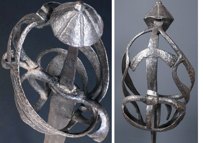

Default Pommels. spheres and cats ...
Originally Posted by Victrix View Post
... Does anyone know the meaning of the circular spheres on the pommel in the specimen posted above by werecow?
I wouldn't know the meaning but, i (think i) discern the same detail in a high end example (gold embeded) in the 'Spanish style' of the XVII century (Collection Rainer Daehnhardt).
Note that, although the general assumption that the figure often seen in pommels is a cat's (or wolf's) head, there are those who take it as more probable that it is a more or less stylised lion, with the relation of Venice with its symbol of power, the lion of Saint Marcus.
(Sorry for the poor pictures )

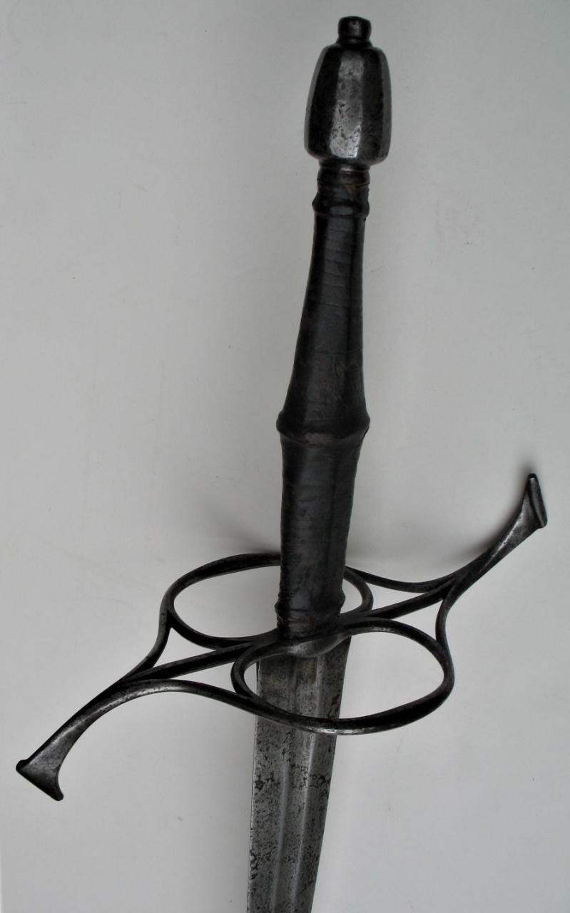

Now that you guys mention it I've also seen them on some Sinclair hilts / dussacks, e.g.:
I guess they are less anomalous than I thought.
Good point, Nando. Yes, even the Italian arms literature refers to "testa di gatto". Some see a stylized pussycat profile, others envision the Lion of St Mark. There is a certain zoological consistency, at least.

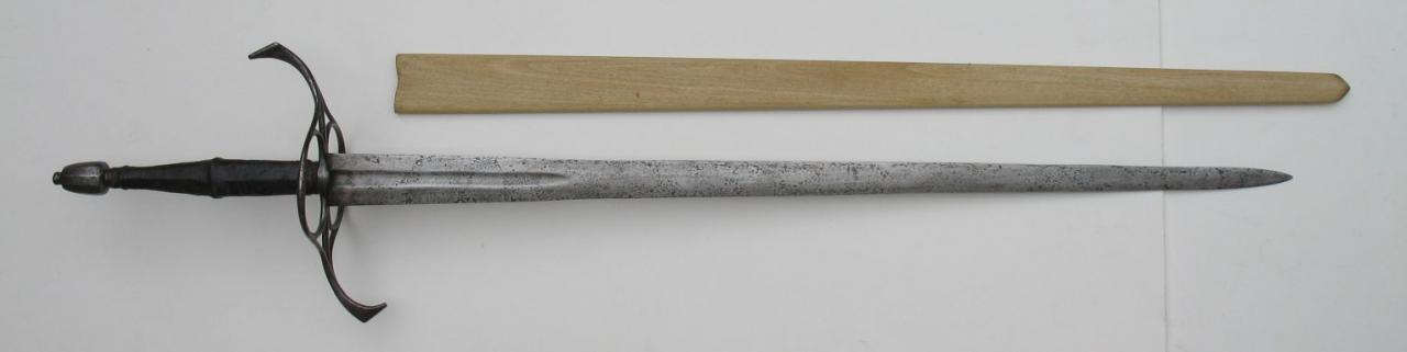

Here are 3 swords that have a strong resemblance.
Top is a typical medieval Hungarian sword, 15th cent., this example in the Hungarian National Museum, Budapest, published in Vas, Ezüst és Arany by Temesváry Ferenc, 1989, plate 67.
Middle is a sword identified as a schiavonesca and according to a posting on another venue, was found near Slankamen, Serbia and is in the collection of the Historical Museum of Serbia. At this point it may be worthwhile to cite Ewart Oakeshott's comments about place of origin versus place of discovery, in the intro chapter of his book Records of the Medieval Sword.
Bottom is a schiavonesca in my collection. Blade has the typical Venetian cockleburr stamps. Note the blade profile, broad with slight taper and an angular tip as contrasted with the two examples above. There are numerous examples of schiavonesche in the Armory of the Palazzo Ducale which do not vary appreciably from this one.

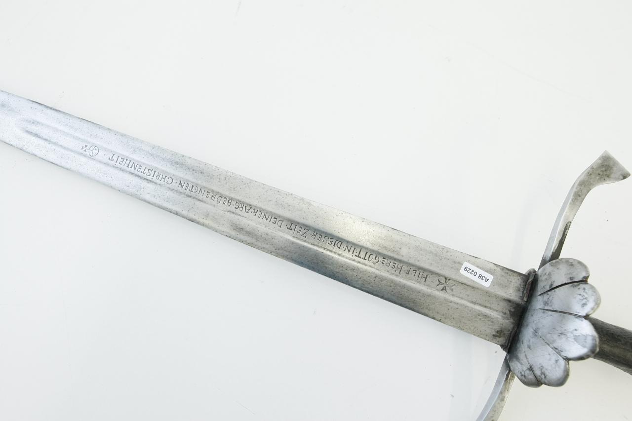

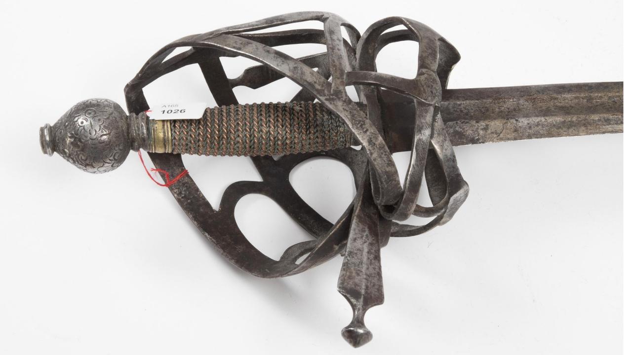

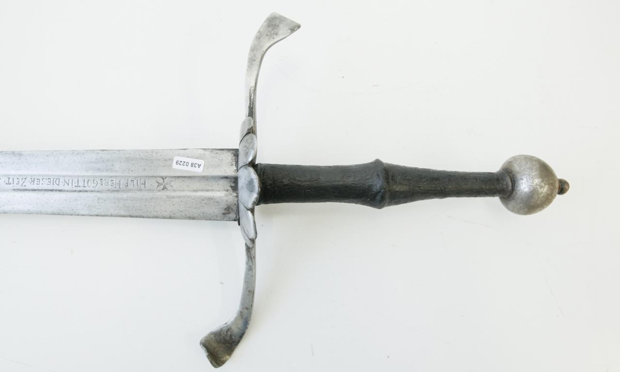

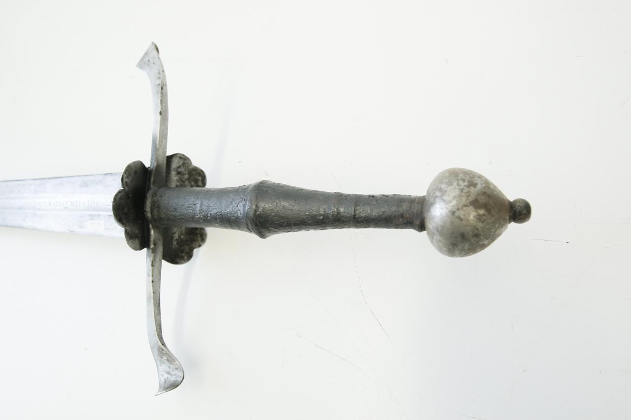

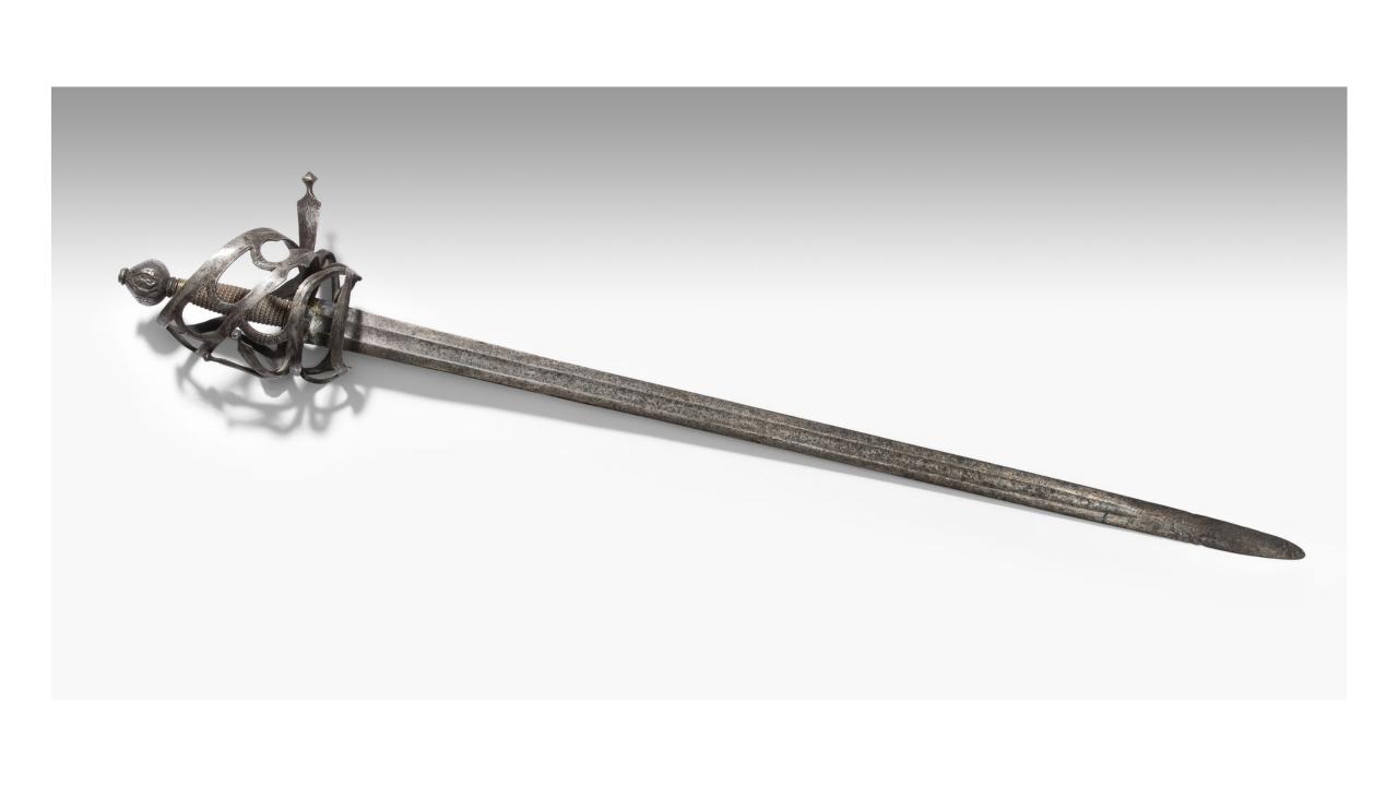

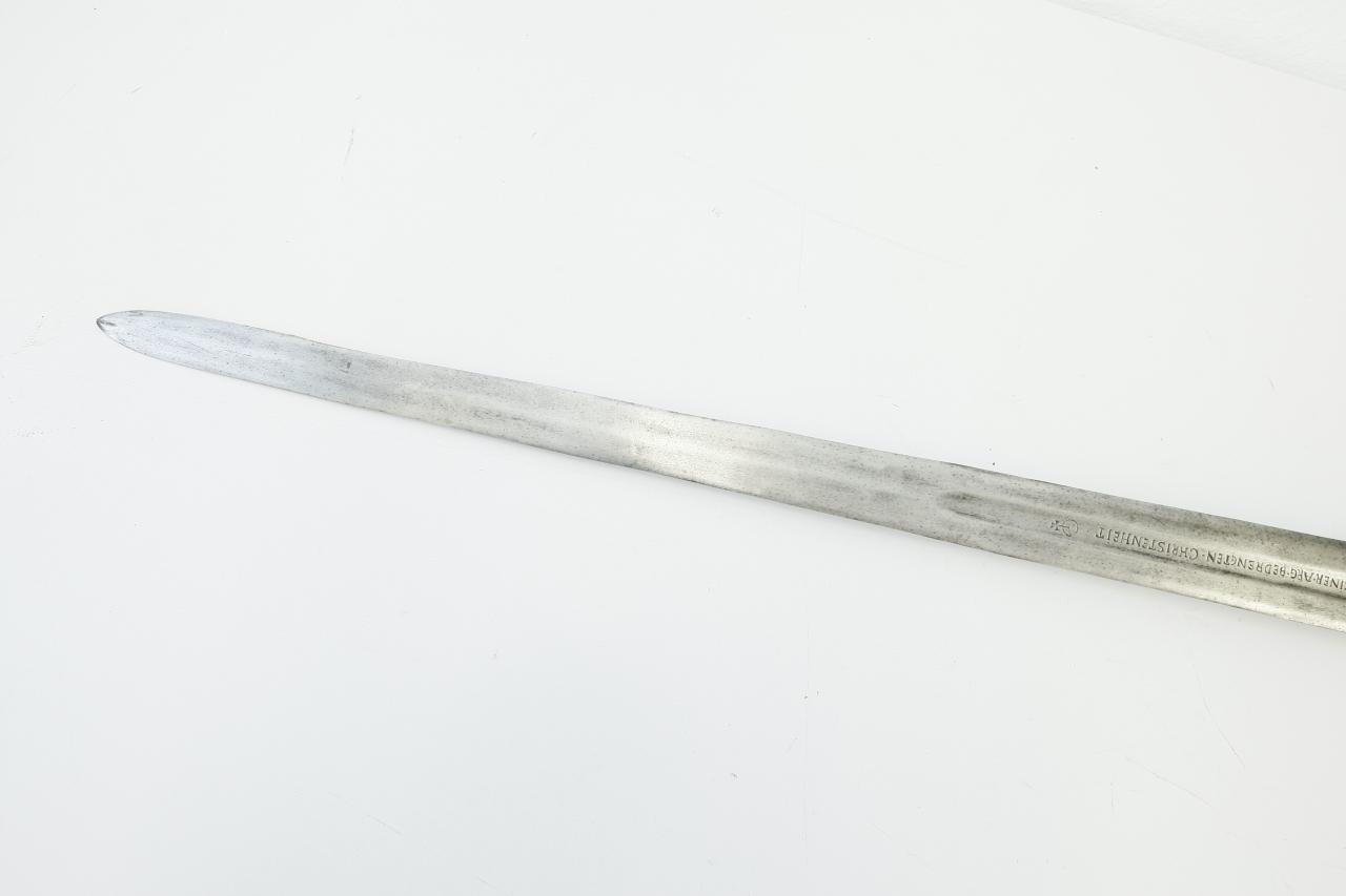

Here are a couple of items that I bid for in auctions in the past, but got away from me. Sometimes (rarely) I still think of them, but more interested in finding future interesting objects to bid for. Happy week-end everyone!
Old 22nd April 2022, 07:28 PM   #24
Philip
Philip's Avatar
Location: California
Posts: 1,036
Hey, Victrix, I really dig that broadsword! Especially with the inscription on the blade! Do you have a pic of the entire thing? (I know this kind of sword is wandering from the topic of this thread, but I can't resist...

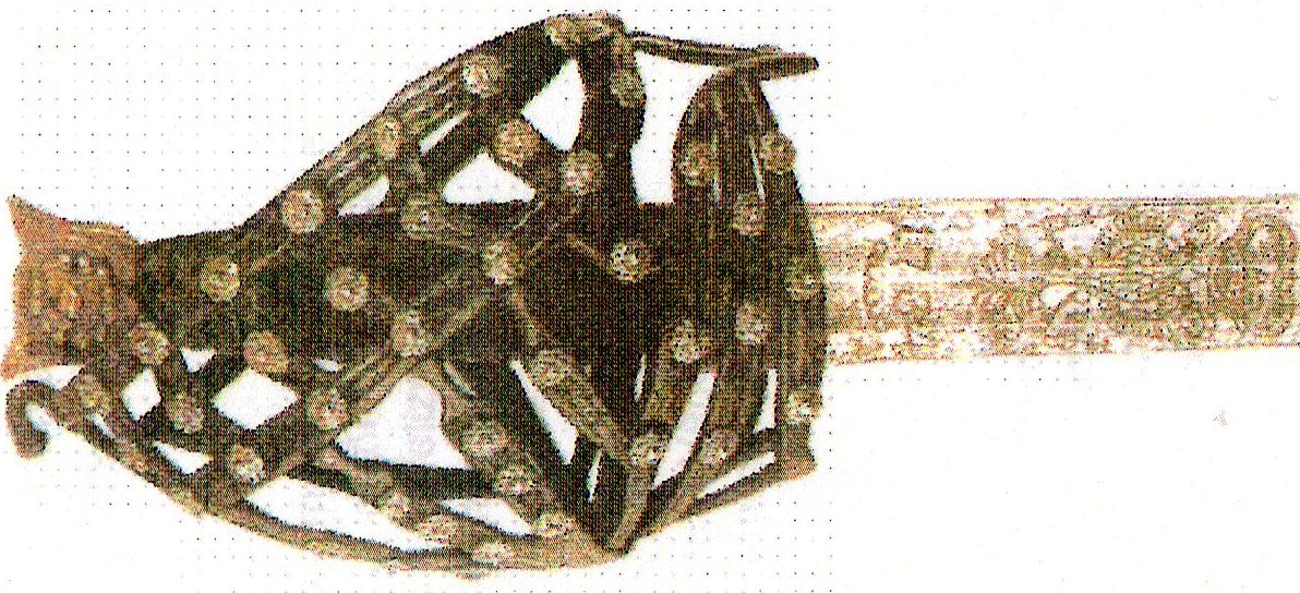

Philip,
Thank you for alerting me to I Grandi Spadai Feltrini e Bellunesi by Michele Vello and Fabrizio Tonin which I will try to acquire. I have tried to source something on Northern Italian arms production in English for some time so it was welcome!
Croatia was in a double monarchy with Hungary which was in a double monarchy with Austria, so it was complicated.
I don’t find huge differences between the Hungarian broad sword and the spada schiavonesca. Could it be that the latter is simply the Italian name for the former from the Italian point of view? I suppose what’s characteristic for the spada schiavonesca is the S-shaped cross guard whereas the typical Hungarian broad sword often has a straight cross guard (frequently tapering towards the hilt) and a square pommel.
I recall finding my copy of Vello / Tonin via the worldwide bookfinder.com search engine, and was directed to Amazon (don't all roads lead to Rome, haha). Apparently it's a self-published, print-on-demand production.
Eastern Europe is fascinating for the prevalence of double and multi monarchies. Poland especially -- Wladzislaw II Jagiello (King of Poland, Grand Duke of Lithuania), Wladzislaw III Warnieczyk ( King of Poland and Hungary, died fighting Turks at Varna), Stefan Bathóry (King of Poland and Hungary, Prince of Transylvania, Duke of Prussia), Zygmunt III Waza (you are no doubt very familar with that case). And so forth.
Regarding Hungarian style broadswords, you have a point. One would think that the Hungarians, at the time they were using these things, had an entirely different name for the type, the earliest surviving examples are out of the Hungarian sphere and that nation is not Slavic. As to the differences, they are indeed small, more stylistic than substantive. Personally, I would call one of these swords schiavonesca if the blade had markings recognizable as north Italian, and if the blade profile was somewhat broad with the distinct angular tip. This blade shape seems to be a common denominator to the large number of swords of this configuration that I saw on display in the Palazzo Ducale.

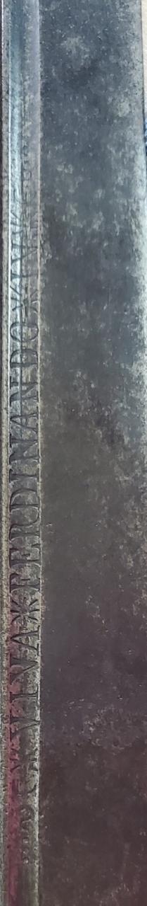

Some eyecandy for you .

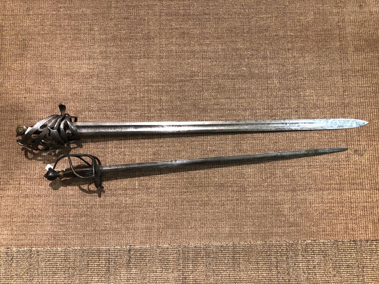

Thank you! As a return favor, here are a couple of images of a hand-and-half sword I used to own (all too briefly). Had to sell it to finance another purchase which was too tempting to pass up. Despite its size, the balance was excellent, you could control it very well with just one hand.

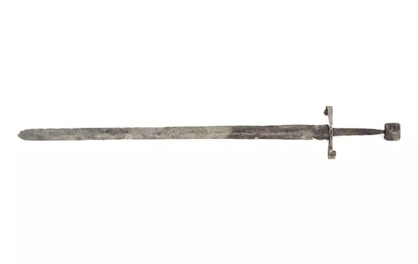

Old 22nd April 2022, 08:07 PM   #28

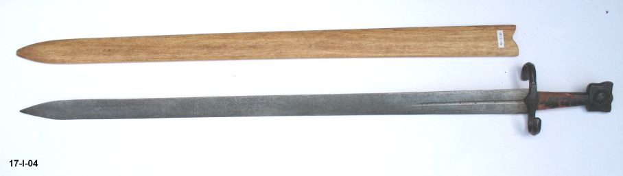

I am not an auction bidder. The sword i am showing here is not one that got away but one i had and did let go.
Someone called this example a proto schiavona.
Old 22nd April 2022, 09:34 PM   #29
Philip
Philip's Avatar
Posts: 1,036

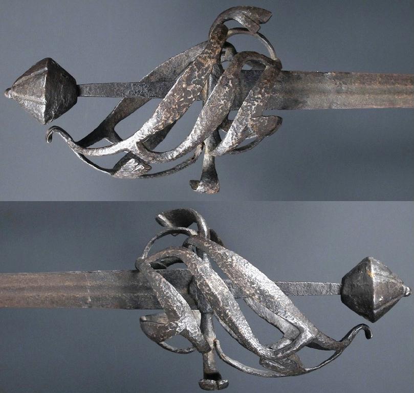

Fernando, this is quite an interesting sword. A friend in Canada has one with the same style of guard, and he calls it a "proto-schiavona" too since its construction is even simpler than the earliest recognizable schiavona hilt, the Oakeshott Type 1. His sword has a cat's head pommel but from its material (bronze) and workmanship (domed center with well-worked beaded deco, contrasting with a very plain hilt), we think it's a later replacement on an older sword.
What I find intriguing about your (former) example is that the pommel is not the Venetian feline at all. It's rather Scottish-looking, more precisely the biconical Type V as shown in Cyril Mazansky's excellent book, British Basket-Hilted Swords (2005) pp 22- 23, 78. Do you recall if there was a small groove on the lower, inverted "cone" of your pommel? Typically, that retained the edge of the basket hilt on those Scottish swords.
Old 23rd April 2022, 10:47 AM   #30
... Do you recall if there was a small groove on the lower, inverted "cone" of your pommel? Typically, that retained the edge of the basket hilt on those Scottish swords.
No Filipe, i don't recall such detail, neither i have pictures taken in that angle; this took place back in 2012.
But i wouldn't discard the possibility that this pommel was a replacement. I tried to recuperate the post (?) where i had the opinion about the 'proto', to check on further possible details but ... no results.
