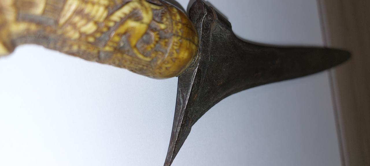

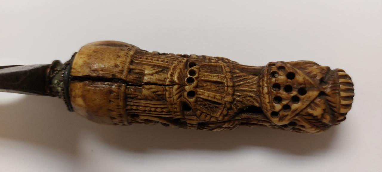

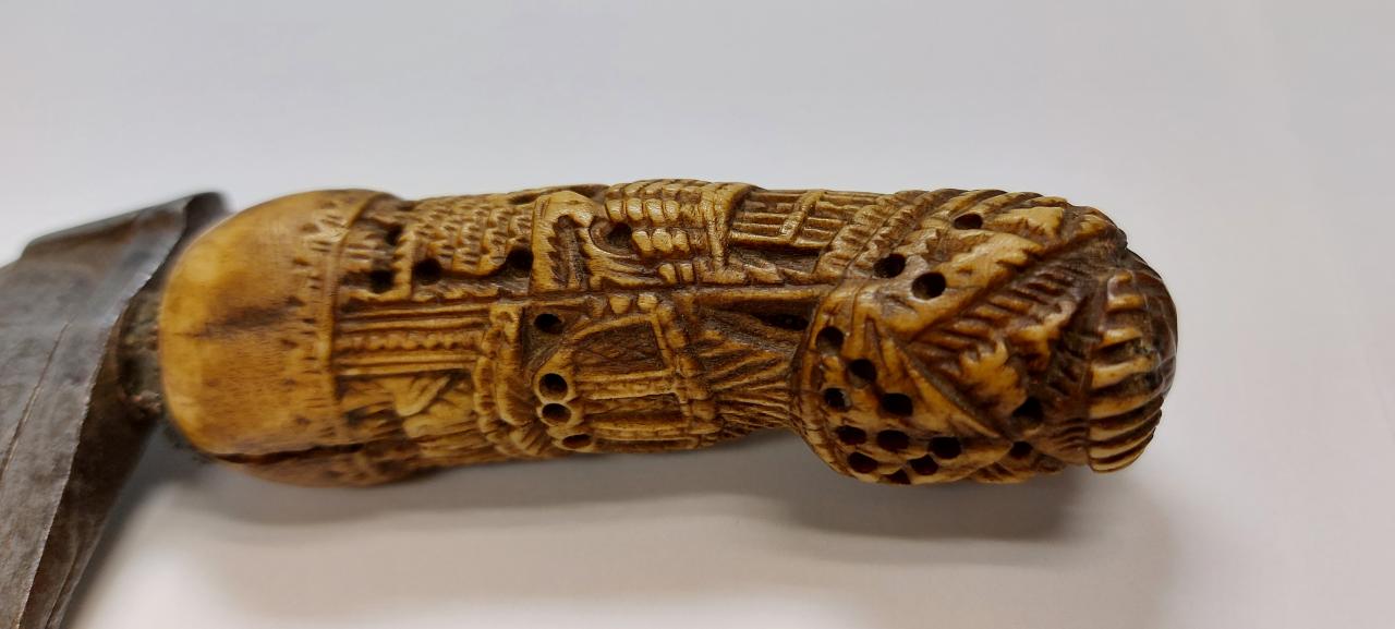

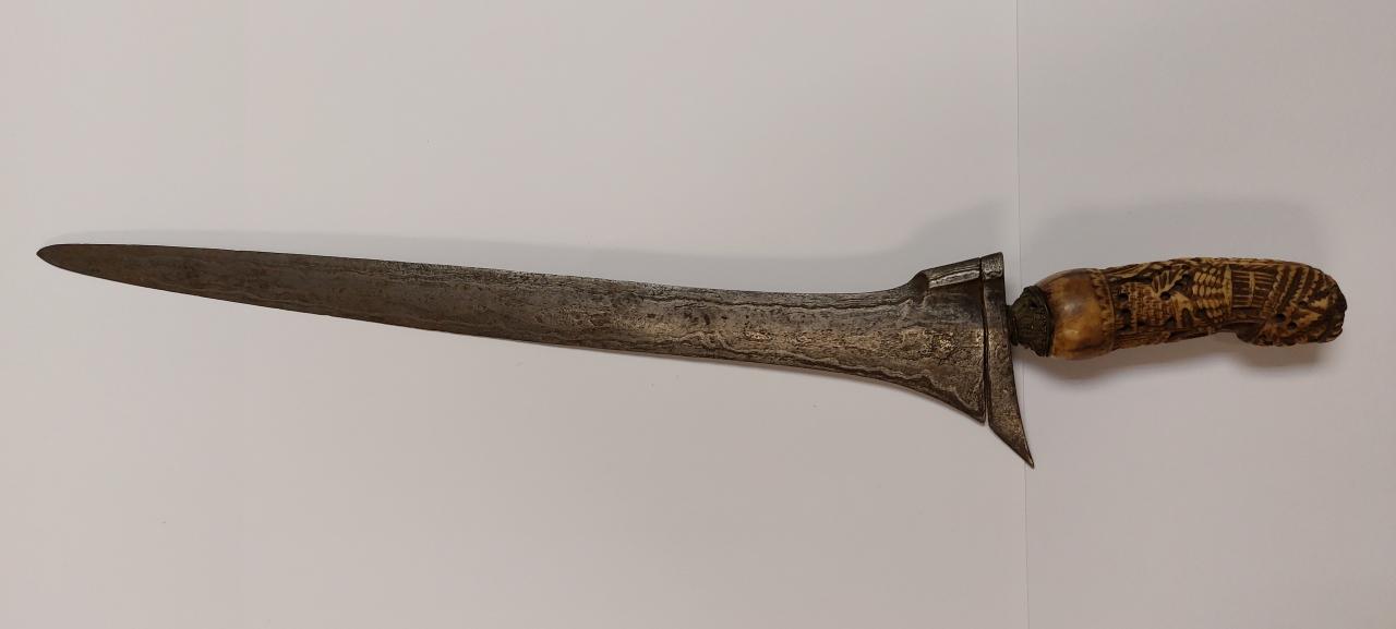

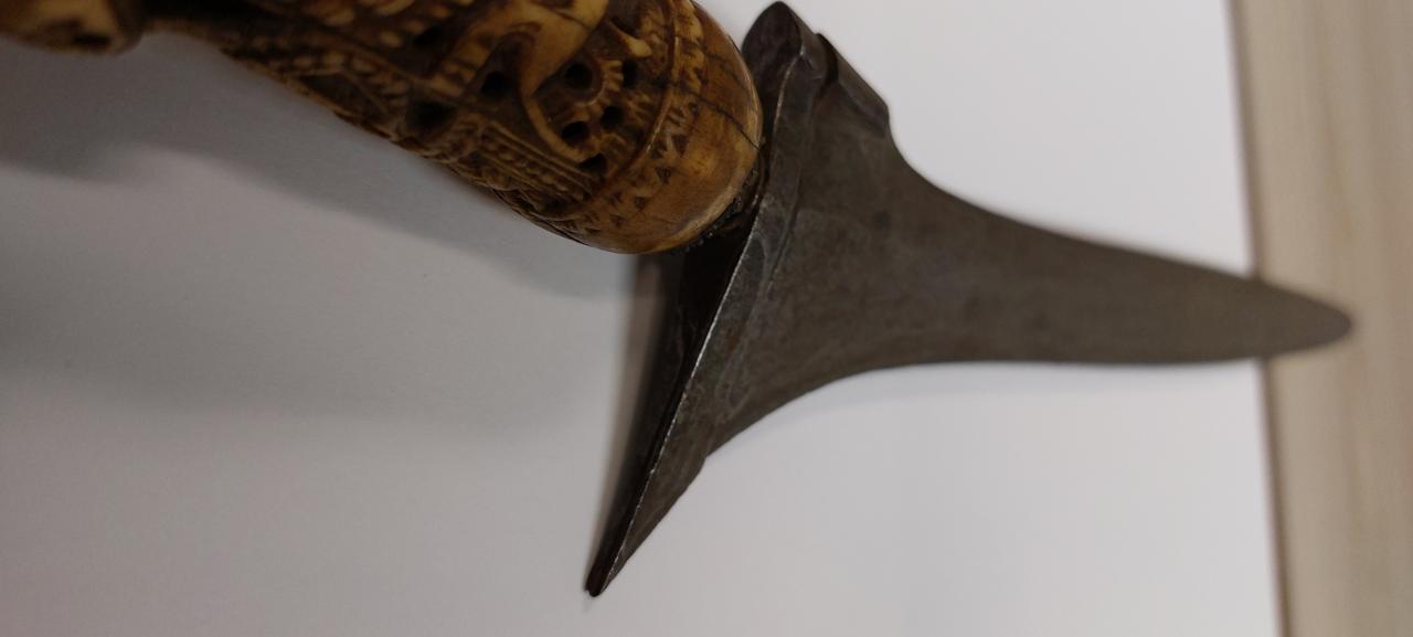

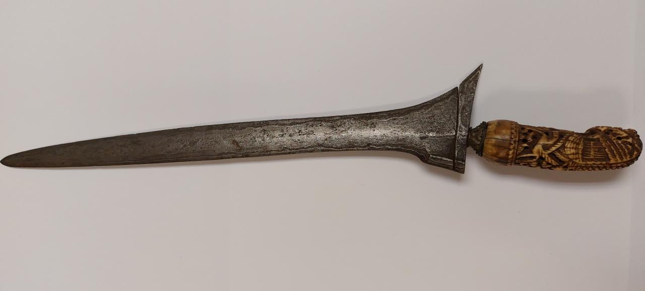

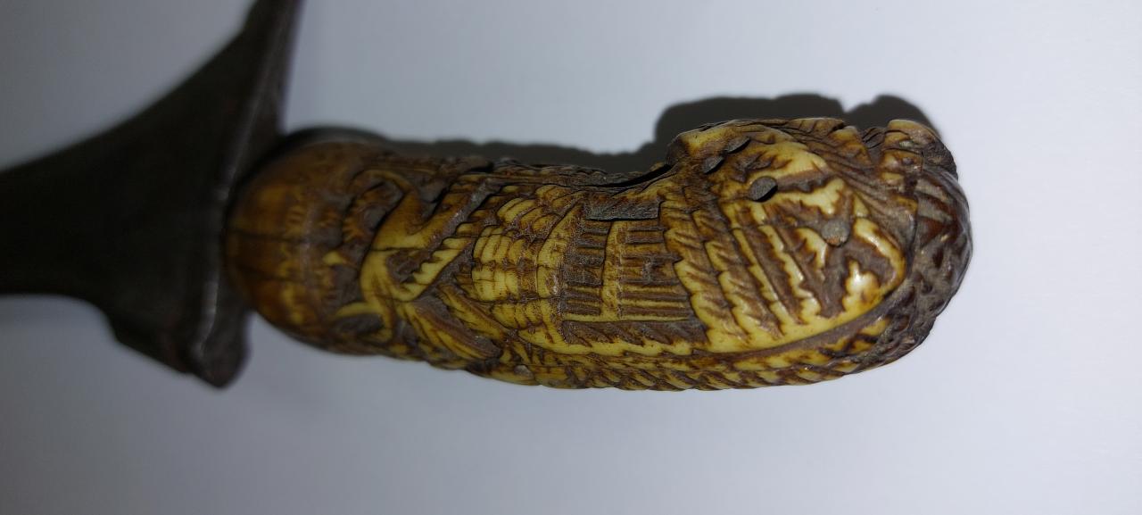

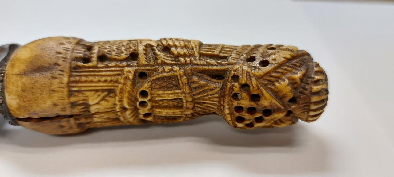

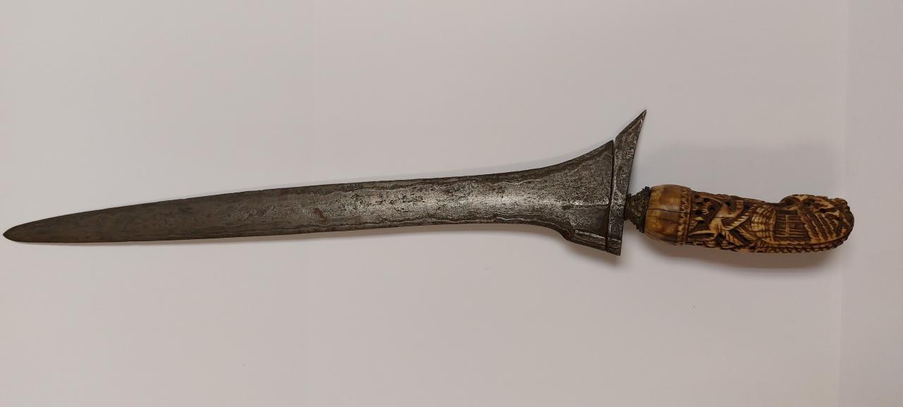

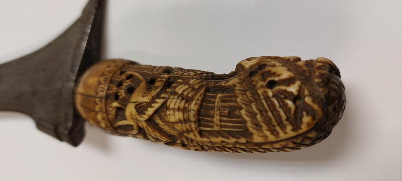

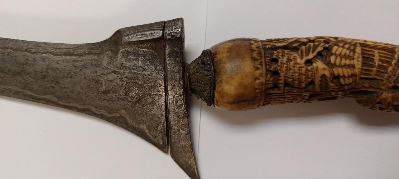

It has been a while since I last had something to share with you, but I would appreciate your opinions. I very recently acquired this keris, and I am curious if the holes drilled into the Hulu indicate places where glass or stones would have been mounted?
As always, any additional feedback is greatly appreciated. These pictures were taken immediately after receiving. I have not changed anything, removed the hulu, or messed around with it at all. One thing I will note is the ganja is a little loose.
Thank you greatly for any insights you can share.

Apologies - the orientation of these photos seems to have changed when I uploaded. They are all meant to have the tip of the blade pointing upwards. I'm not sure how to fix since the original photos on my end are oriented correctly but got turner 90° when uploaded.

There were no gems IMO, but just decorative holes. This is an old Madurese hilt in kojuk mrenges style and made from ivory?
Old 16th April 2022, 01:57 PM   #4
Posts: 7,303
I agree with Jean about the holes. But there are aspects of this material that make me wonder if it isn't bone rather than ivory.
Yes David, you are probably correct as there seems to be a repair (cap) on the top part.

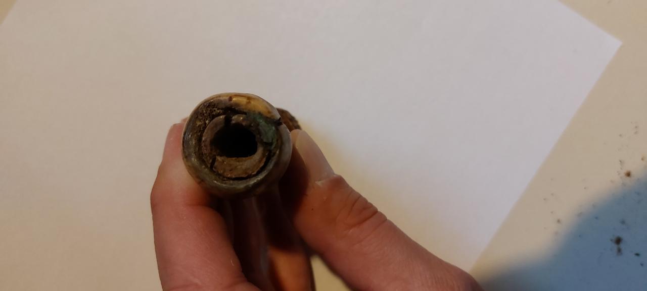

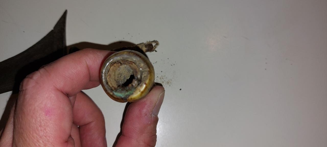

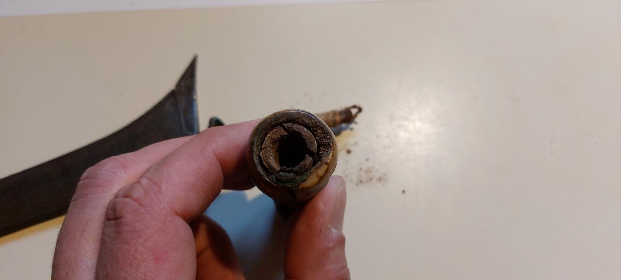

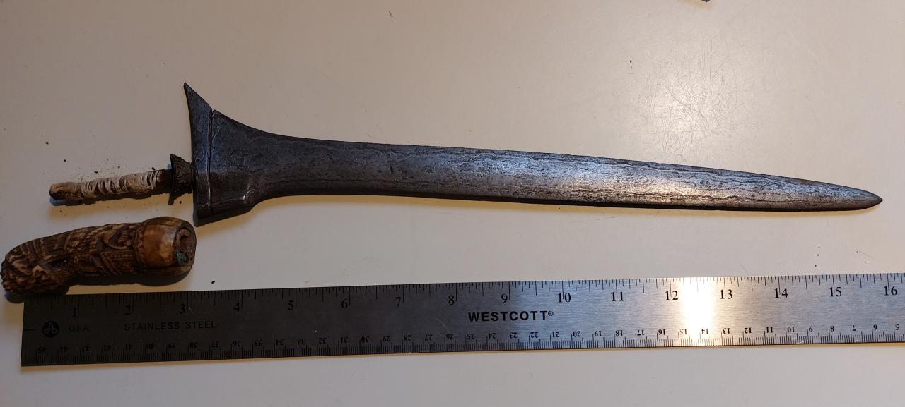

Shayde, if you can free the hilt, please show us the pesi hole for checking its condition (pitting or not).

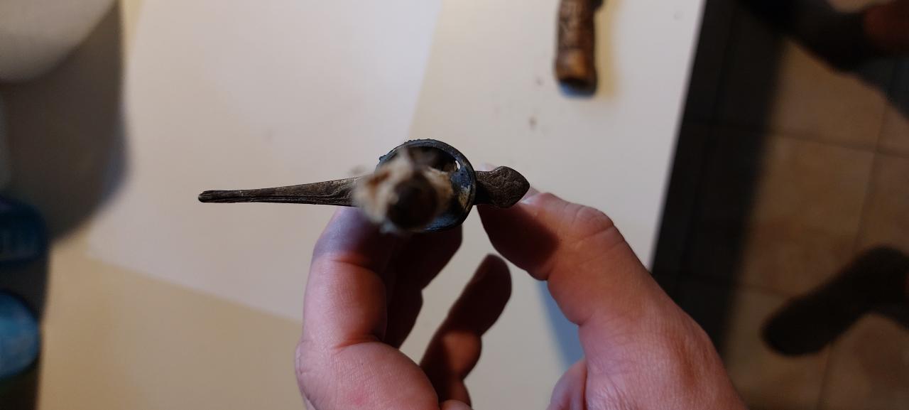

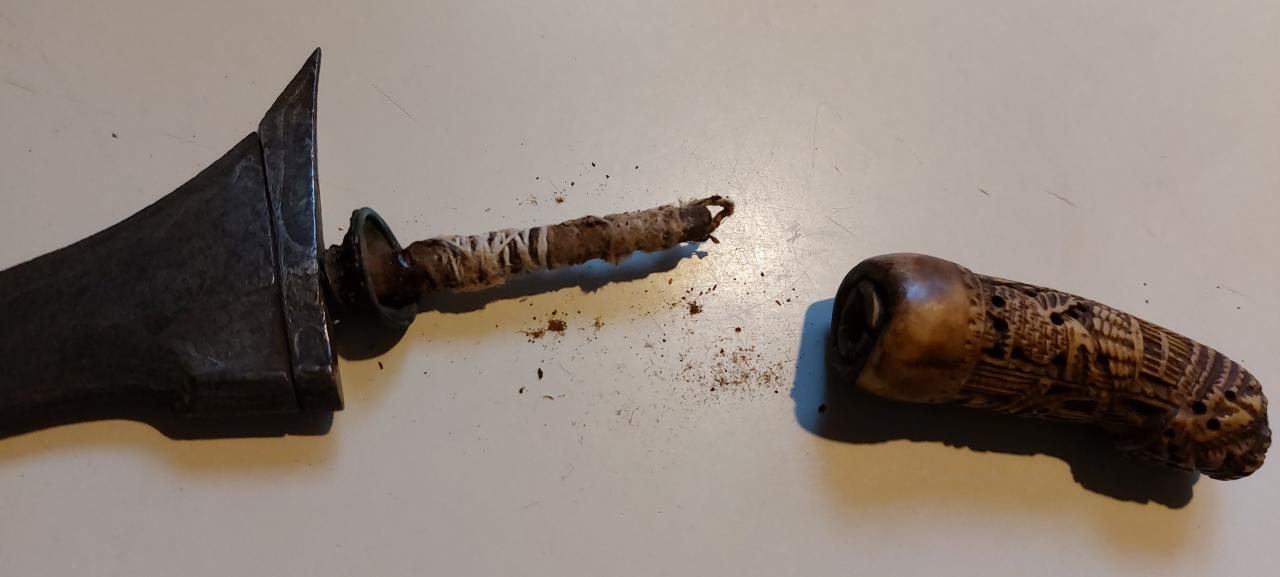

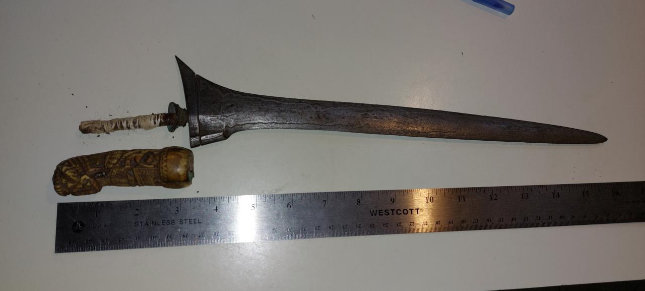

Thank you, Jean and David,
Below are the additional photos.
Additional details, the hulu is 1.5 ounces in weight
The blade with mendak is 8.5 ounces
In total, the entire assemblage is 16 inches (41cm).
It certainly has a hefty feel in the hand.
There appears to be an insert in the pesi hole. Wood, perhaps? I suspect you both would have a better idea what materials would be employed in such a construction.
I am always conservative in determining if something is bone or ivory. I assume bone, unless there is some definitive feature to suggest otherwise.
Thanks again!
-Rob
Old 17th April 2022, 08:55 AM   #7
Jean
Join Date: Jun 2009
Posts: 1,740
Thank you Rob. From the pics the hilt seems to be made from bone and the insert from wood indeed.

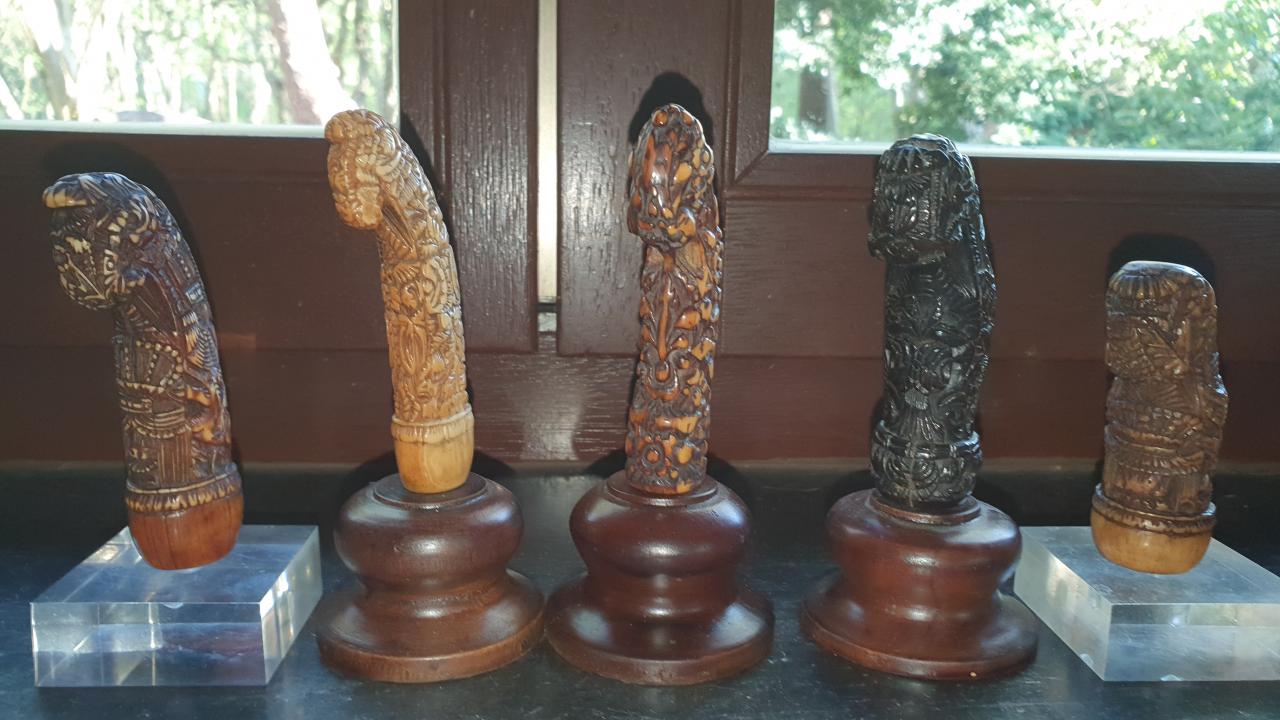

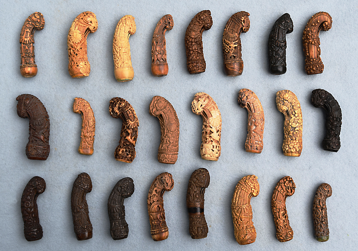

Hello Rob,
The handle is from bone or deer antler. And I agree with Jean and David the holes are pure decorative.
Attached are a few Kojuk Mrenges hilts, the three on the left are ivory, the dark one is wood and the right bone or antler.

Makes sense that a wood insert would be necessary if the marrow cavity of the bone was larger than the pesi. Thank you for teaching me this detail as it seems it would be a sure sign of bone being the material.

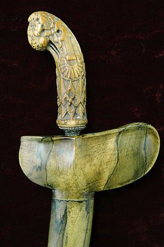

Here is another example of a Kojuk Mrenges hilt in my collection.

This is a rather small example of this style of hilt and is on a patrem. So it his possible it was always this way or perhaps shortened to proportionally fit the the blade better. But if you look in Detelf's examples in post #8, the one in the middle also doesn't have the normal base to the hilt.
