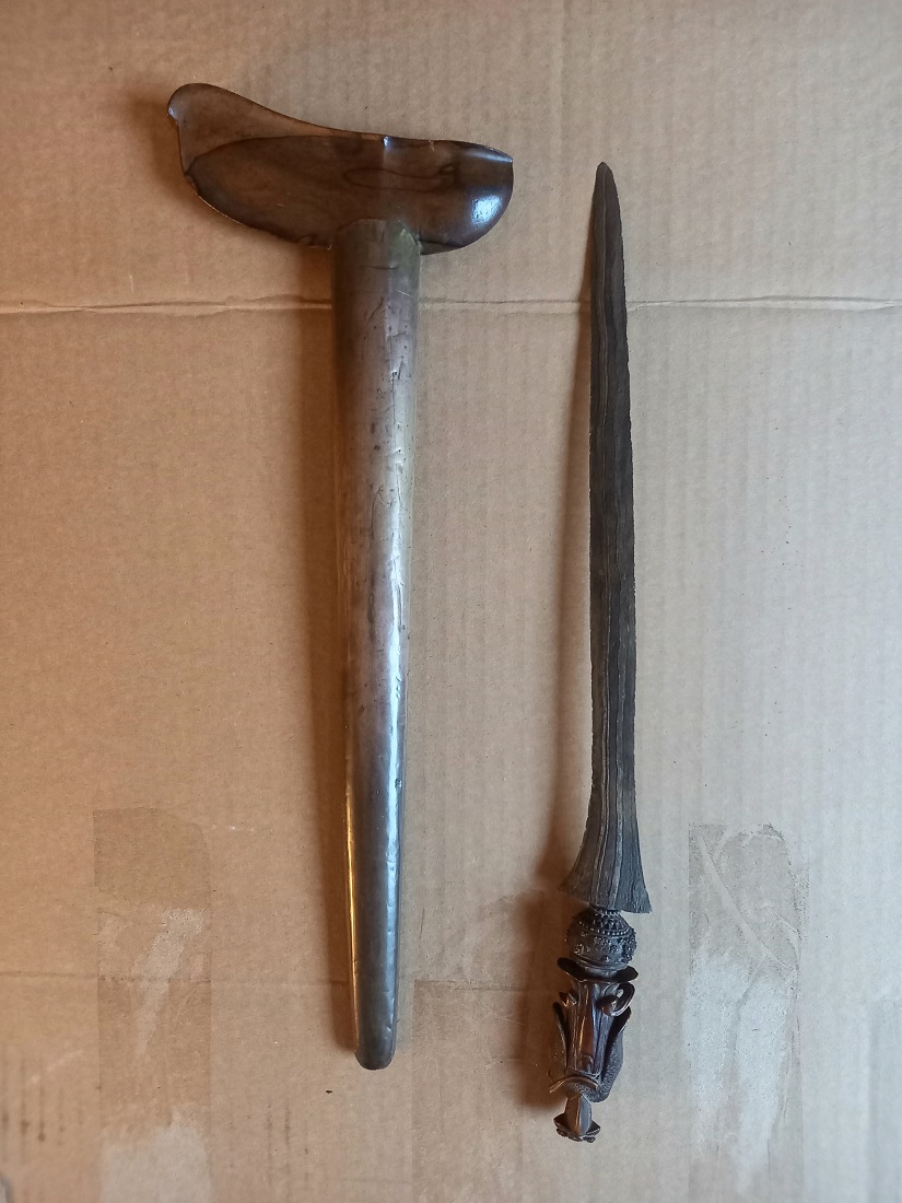

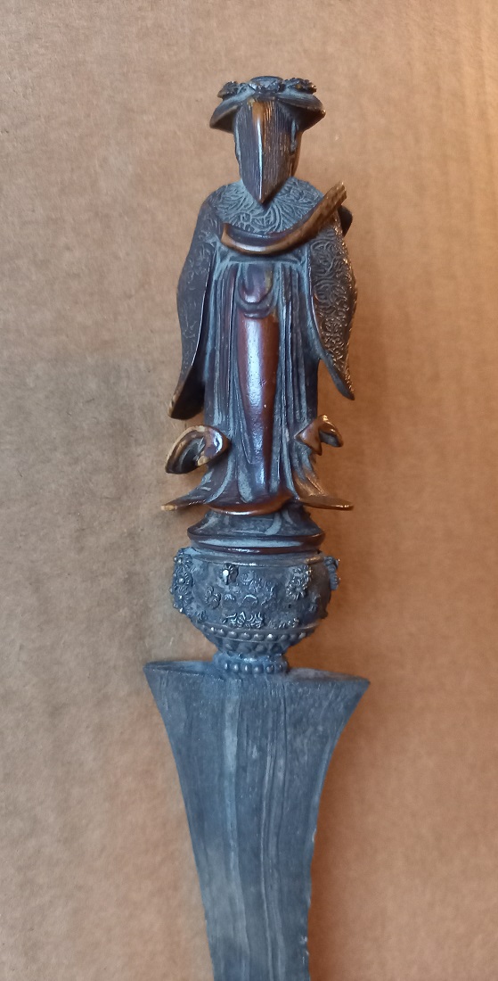

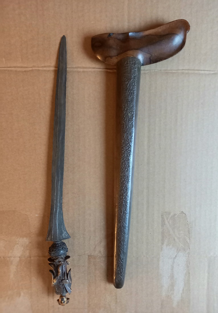

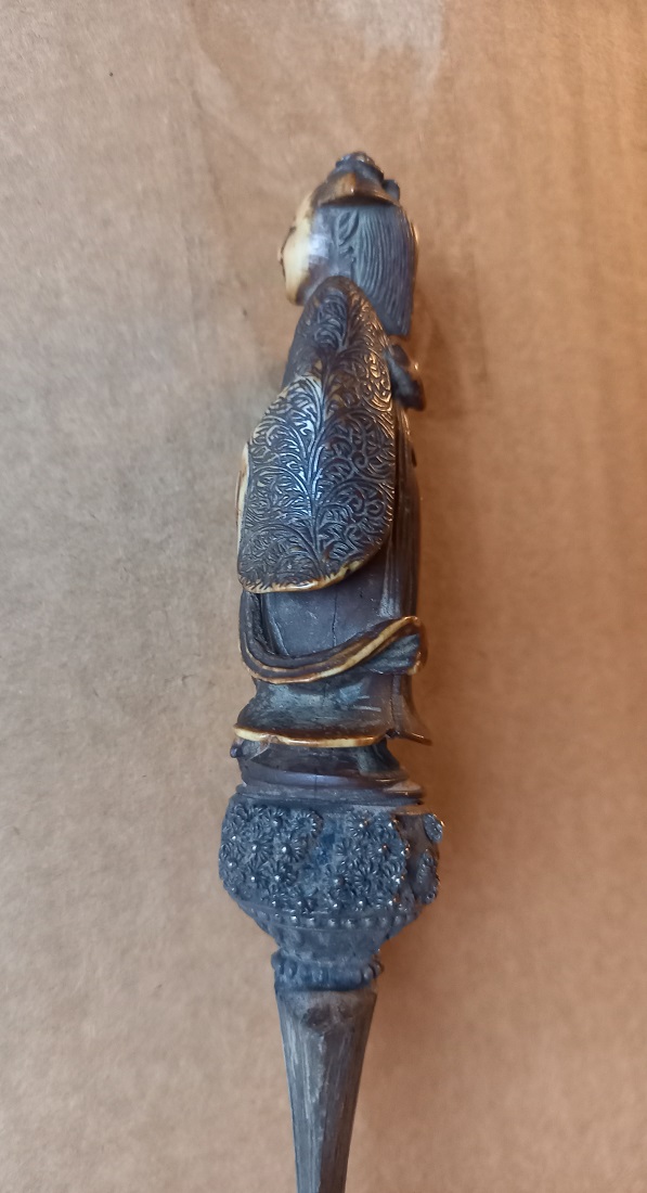

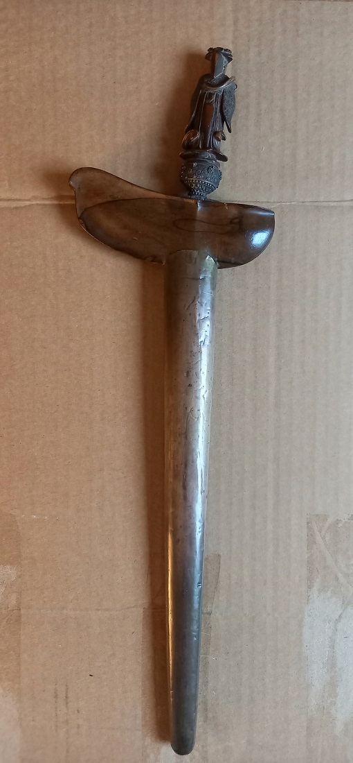

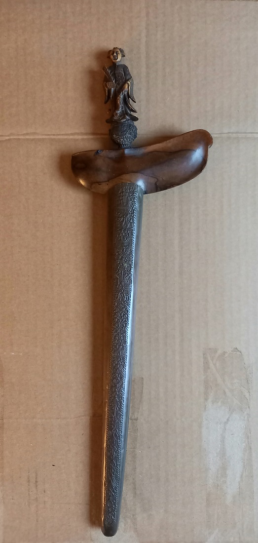

This is the last keris I bought. It intrigues me a lot because the blade is not really a Keris blade and the handle (in ivory) is of Chinese tradition.
The scabbard is from Yogyakarta and was specially designed for this blade (the small originality is most certainly a break that has not been filled, but which has been repolished properly to appear original).
The mendak and selut (sadly very damage) are in silver.
Blade lenght : 33cm

There are a lot of Chinese people in Jawa, apparently one of them decided to make a statement.
Everything about this keris is outside socially correct parameters for Javanese social & cultural purposes.
My guess is that it dates from second half of the 20th century, that it uses an older Chinese carving that has been adapted for the hilt, and it was only ever intended for wear in a Chinese social setting.
Social attitudes in Jawa during other periods of time, and in other than a Chinese environment would militate against other possibilities.
One other thing:- the selut is very recent, I'd say 1960's at the very earliest, this pattern selut is usually plated brass.

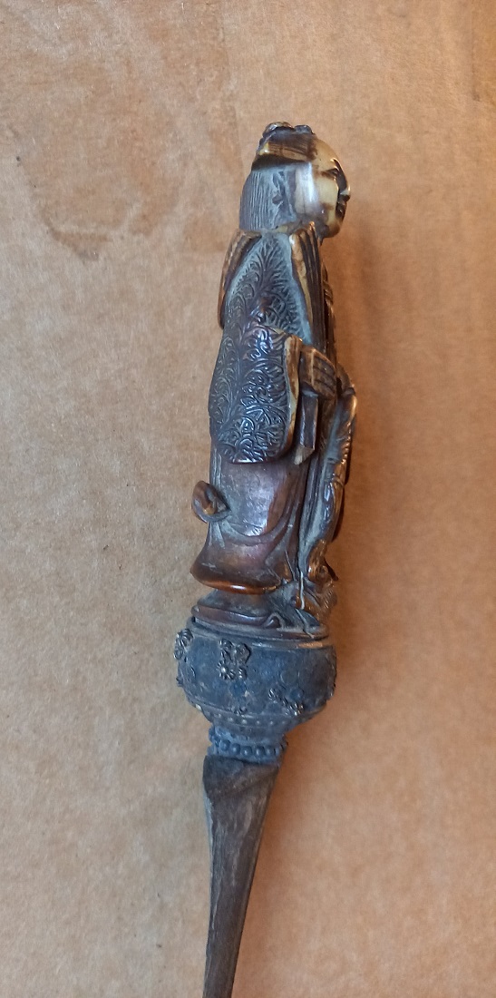

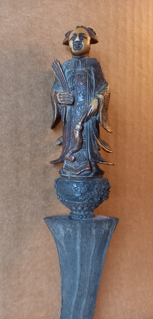

Looks like a Chinese deity.
Old 8th April 2022, 04:35 AM   #4
Posts: 7,255
I'd say almost certainly a Chinese deity Anthony, but which one? Chinese deities can be very difficult to identify from their attributes, firstly because there are so many Chinese deities, and secondly because each deity can be represented in various ways.
In Jawa, particularly along the North coast, the Ming admiral Cheng Ho (Zheng He, or in Jawa, Sam Po Kong) is particularly revered, apart from being in command of a 15th century Ming Treasure Fleet, sent to make tributary states of kingdoms bordering the southern seas he also helped to bring Islam to Jawa. There is a temple in Semarang named after him, I don't know if he had it built, or it was built in his honour.
The Ming Treasure Fleets?
Well, that was an early Chinese attempt at exactly what China is doing now with Belt & Road:- turn the world into Chinese tributary states. This attempt failed because China got a new emperor who had Buddhist advisors and they thought that there were already more than enough problems running the country without generating more problems by putting tributary states on the books. So the "tribute or else" policy stopped.
Anyway, Sam Po Kong is sometimes shown with a fly whisk in one hand and scroll in the other, maybe if we swap the scroll for fortune sticks (kau cim) we might have good old Cheng Ho here.
Or maybe somebody else.

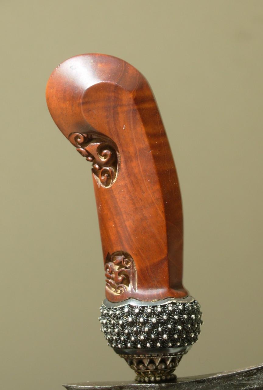

Alan, why do you think the selut is very recent?

The ganja of the blade seems to be missing? This type of selut made from gilt brass is common and recent indeed (tourist quality) but this one may have some age?

I wonder if this was always a kris blade or was it not a pendang blade adapted to be used onto a kris?
as for the Deity , I am not an expert of Chinese deity but I looked up a few images (I like the challenge)
Could she be Mazu? Goddes of the Sea? Especially revered by Chinese living in South-East Asia
Sometimes depicted with an object on her right or left shoulder and sometimes with a fly whisk, she is a Sea Goddess especially revered by Min people

Gustav:- because I have seen literally thousands of this pattern selut, none have been old. They are very common in Jogja, I do not agree with Jean that they are tourist, in fact, in recent years the idea of "tourist" is pretty much something that is long past. People in Central Jawa use this type of selut on decent keris, it is common, and it is not expensive.

Alan, this type of Selut was common in Jogja already around 1900 and most probably at least 20 years earlier. It is depicted in Groneman's plates on some of Karyodikromo's Keris, he calls the motif on this Traptrapan Selut Untuq-Untuq.
The Selut of Athanase seems to be lower in quality, because the upper rim is straight, but low quality in silver is perhaps a bit unusual.

Alan, exactly, that would include the possibility that the Selut was made to accomodate the figurine turned into hilt.
Regarding more recent Selut, I have seen by far more ones with stright upper rim mated to planar hilts, and this is, what I would call lower quality.
If you have van Duuren's edition of Gronemans articles, photographs of Keris with such Selut can be found on pages 267, 264, possibly of higher quality 251.
I own two Keris with such Selut, both came to Europe before WWI.

Could it be a sepang blade missing the ganja?

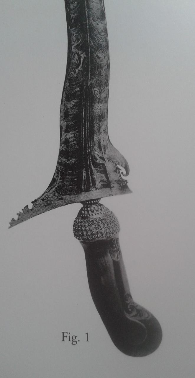

And two from Groneman, one more refined:

The selut is in silver, not brass plated.
Yes I think that a Sepang Keris blade without ganja is the most likely.
The warangka was made after the loss of the ganja.
The thin coper pendok and the good quality of wood make me think that the set was assembled during the first half of the 20th century, but not later (But it's a feeling, not a certainty).
In any case, as Allan said, even if this "Keris" does not respect the Javanese rules, it is not an object for tourists.

Gustav, I've had the opportunity to have a look at my copy of David van Duuren's publication of Groneman's work.
Groneman uses the term "trap-trapan" to refer to the selut shape & method of production, his description in English does not make sense to me, possibly it is better in the original language.
However, his name for the motif as "untuq-untuq" would now be spelt as "unthuk-unthuk" which translates as "little mounds", Groneman tells us that the meaning is "foam", and yes, "unthuk"(singular) can be understood as "foam", but when we double a word it indicates plural, so "foams"? maybe. As far as I can determine, this is not the name of any Javanese art motif, but "little mounds" is a perfect description of the ornamentation shown on this selut style. Actually, this motif shown on these seluts has been given to me by my own informants as "m'rutu sewu", "sewu" means "a thousand", "m'rutu" means "a bug, or a gnat", however, both people who gave the name as m'rutu sewu, gave the translation into Bahasa Indonesia as "seribu bunga" = "a thousand flowers" , I guess "flowers" are much more charming than "bugs".
In general the names of motifs used in Javanese art work are pretty standardised and can normally be found in batik motif use.
Coming back to the word "trap-trapan", this refers to the way that something is arranged. I have not encountered this word used to refer to a selut shape. The other shape he mentions is "tatahan", which (as he writes) means chisel work, and this refers to ornamentation, not form.
Equally the names he gives for motifs are confused, and look more like descriptions.
For many years I was very eager to read Groneman's work, and I mentioned this to David van Duuren a few times long before his Groneman book was published. At that time he told me that there was really no new knowledge in Groneman's work & that I was not missing anything by not being able to read it.
However, I obtained a copy of David's publication as soon as it became available, and the first thing I did was to dive into the translated Groneman text. I found so many errors and misunderstandings and omissions that I came to the opinion that Groneman had not seen, had not understood much of what he undertook to describe.
Isaac Groneman appears to have spent more than 50 years on the Island of Jawa, I don't know how long he actually spent in Central Jawa, because he seems to have been in a number of places, but in light of that + 50 years I would expect him to have been competent in the use of the Javanese language, not merely Malay, so I strongly suspect that the informants he would have been using were either not particularly strong in knowledge of the keris, or were behaving in the usual manner that Javanese people during the colonial era behaved with Europeans, and to a degree, still do today.
I am of the opinion that Groneman's work is of value to us, and David's presentation of this translated work, along with all the other contents of this publication is a great gift to us, but I'm afraid that I cannot have much confidence in the accuracy of Isaac Groneman's writings. But this is probably through no real fault of his own. Things in Jawa were a bit different for Europeans a hundred & more years ago.

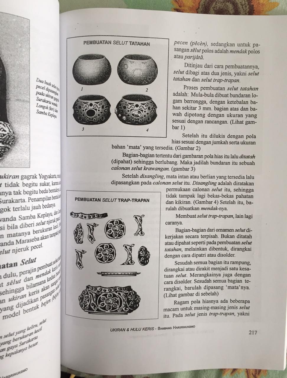

here something about selut from a B.H. book
Old 12th April 2022, 01:46 PM   #21
Posts: 7,255
That's not a bad explanation Marco, as far as it goes.
The exploded drawing of the trap-trapan selut I believe makes it quite clear that with trap-trapan we are talking about what we would perhaps call a "fabricated" selut in English, the parts are made, and then arranged to form the finished product. The word "trap-trapan" carries the meaning of arranging something into its place.
However, after the basic selut has been assembled (ie, "fabricated") the motif is cut into it, and this work makes the basic selut an object that carries "krawangan" work. The ornamentation of the trap-trapan selut can stop right there, but if gems are added, that selut which has been produced by arranging the separate parts together, then cutting a motif into it, becomes a selut "tretes" when the gems are added. A selut such as this has a lot of work in it & involves a number of aspects of the jeweller's craft, carving, sculpting, engraving, chiselling, soldering.
In the old days, the jewellers & goldsmiths in Jalan Coyudan used to do this sort of work , but after about the 1950's keris related work became more focussed I think and craftsmen specialising in keris dress were located in various areas. At the moment some very good seluts of this style are produced in Purwokerto, the trap-trapan selut is usually the size & style that we identify as Jeruk Keprok.
The tatahan selut usually starts with a body that has been cast, the casting is refined by polishing & shaping before the finishing begins. The finishing is usually just the engraving of a motif into the metal using hand chisels & gravers. This then is the selut tatahan.
What Harsrinuksmo says is:- "Bagian-bagian tertentu dari gambaran pola hias itu lalu ditatah (dipahat) sehingga berlobang. Maka jadilah bundaran itu sebuah calonan selut krawangan.(gambar 3)".
So we have a selut tatahan up to the point where the design is cut through the metal, once the design is cut through the metal that tatahan work becomes krawangan work, and we have a selut krawangan. Harsrinuksmo says "calonan selut krawangan'', "calonan" means a "candidate", so the selut that began as a "candidate" to become a selut tatahan, with only an engraved design, or maybe no design at all, can become a selut krawangan when the design is carved through the metal. Then if gems are added --- which would be very unusual with this type of selut, we have a selut tretes.
But there is one thing that does not change:- that selut which started as a selut tatahan will be the size and shape of a selut Jeruk Pecel. Only the selut trap-trapan that is fabricated will be a selut Jeruk Keprok.
There is another kind of selut that I believe is only a recent product, it has the size & shape of a Selut Jeruk Pecel, but instead of the body being cast, that body is made of very thin brass sheet that has a false krawangan work motif stamped into it. These seluts are very low priced.
Blade lenght : 33cm
Looks like great President Mao in an ancient Taoist robe
