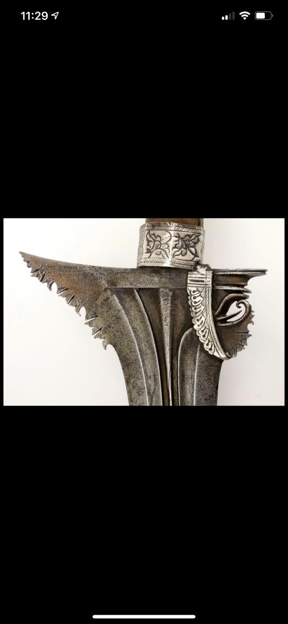

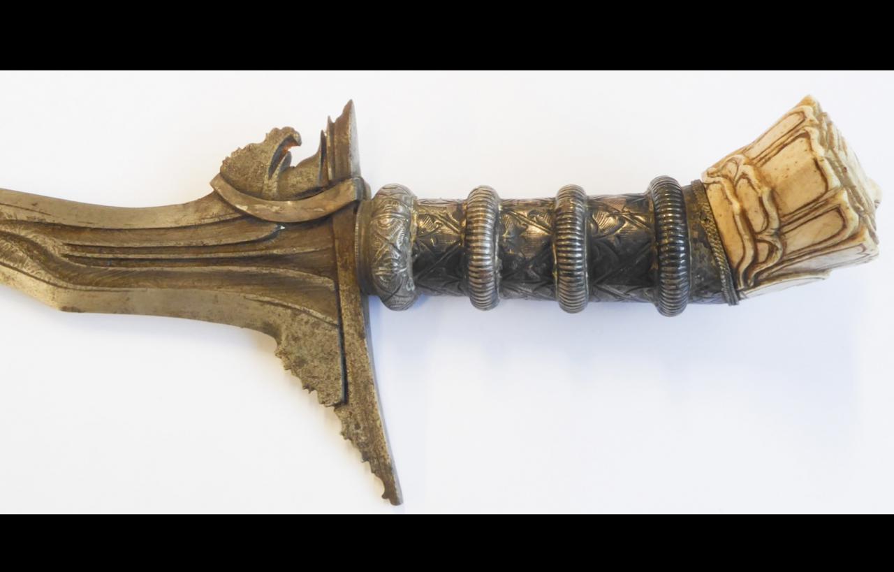

I recently acquired a third Garuda Kris from England. It was collected by a British Naval officer in the 1920’s while aboard a Royal Navy Hydrographical Survey Ship in the British North Borneo region.
Wow, you have been busy - congrats on acquiring these neat pieces, especially the 2 old ones!
Dimensions and a close-up of the sosoran area (base of the blade) taken from exactly above would be great though!
I might stipulate that the link to Garuda is far from established! It seems likely that this type of pommels originates from successively abstracted figural keris hilts (Java, Sumatra, Malay Peninsula, brought to bangksa Moro possibly via coastal Malay communities from Borneo); their exact symbolism is also not convincingly established yet. An originally protective function as well as a root in ancestor worship can be assumed though.

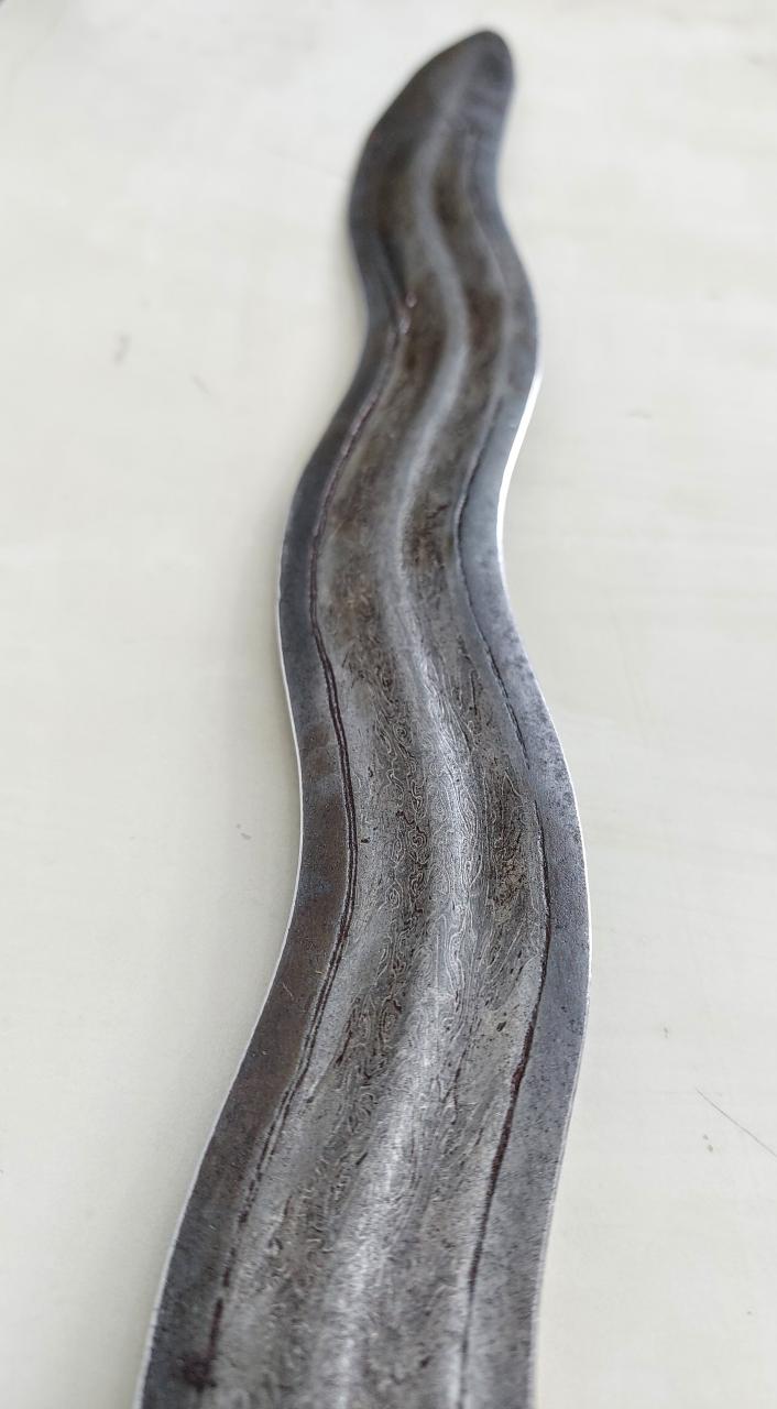

Working theory:
Blades from left to right: Maranao (left); Sulu (double fuller with twist core) (middle); Malay (double fuller with twist core) (right)
The weight of the Malay blade(much lighter) and the corse grain of the steel are significantly different from the other two blade. Also the silver wrapping style of the Left most krisÂ’ hilt is a style seen in Malay kris.
With that said input or theories are definitely welcome and appreciated.
A discussion around the Garuda and symbolism is also welcome. The two archaic kris hilt style, carving and form start to give some basis for comparison. If there are other forum members with examples of this style of hilt form I would also encourage posting those for us to all compare and contrast.
SS

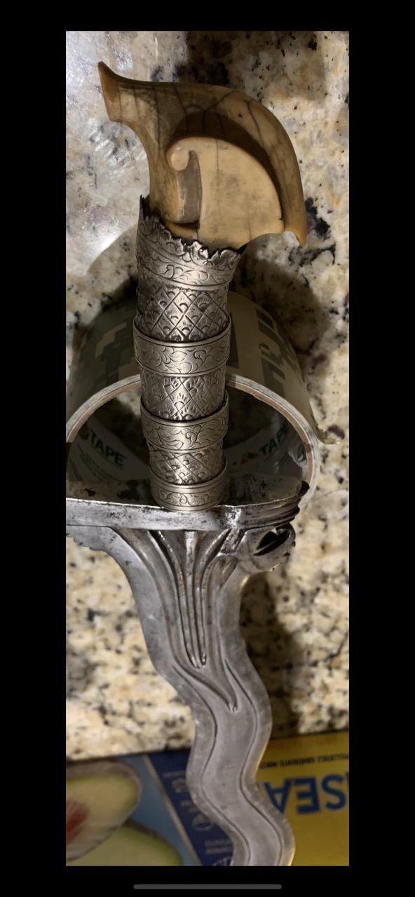

SS, amazing collection. I really like that 3 siko example with the octagonal (?), ferrule.
Here’s one that I have but really doesn’t compare to yours.
This one is really small with a brass or some copper alloyed blade. The hilt has a carving of a “Tree of Life”.

Wow!! Thank you for sharing the example from your collection. The carving on the hilt is very interesting. There is definitely serious symbolism in this hilt style.

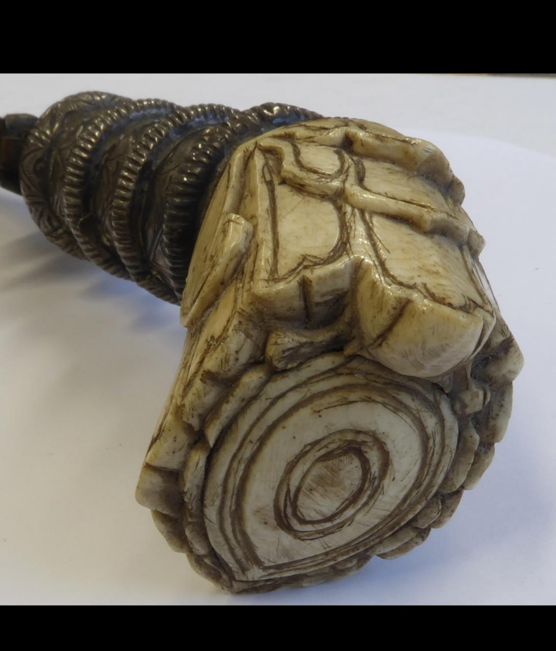

Here are some additional pics of the two archaics.

Both of the archaic kris have very nice twist cores. Have you checked yours?
Albert's blade is made from a copper alloy - so no pattern welding to be expected.
It also seems to be quite a bit younger, possibly with a recycled hilt/pommel. From the design, the hilt might well be from a similar period as your younger example that you got from Charles.
