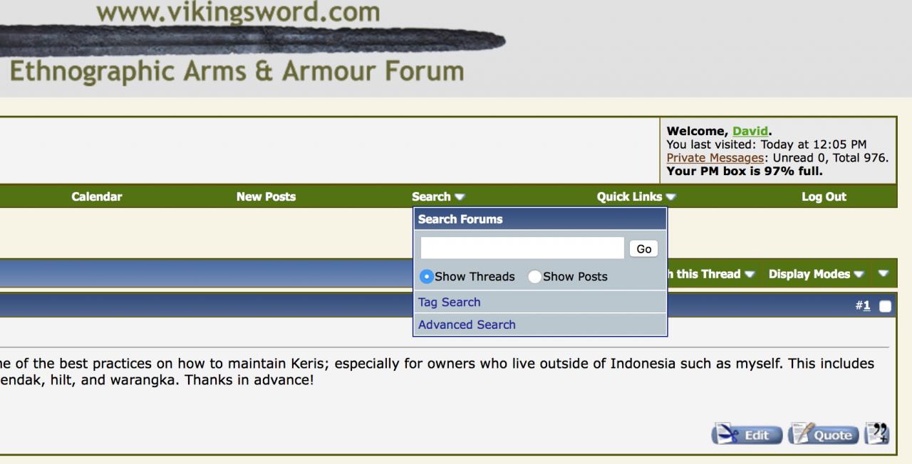

Use the "search" function. Green tab, sixth option from the left. There is an advanced search option also if you want to try to follow a particular members evolution of thought on a subject. Very interesting to watch ideas and knowledge bases develop.

Here is how you search the archives Shadejoy. As IP stated, you can use either a quick search or you can click on 'Advanced Search" in the dropdown menu for a more detailed and specific search.
