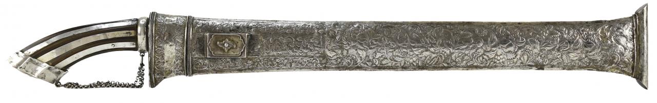

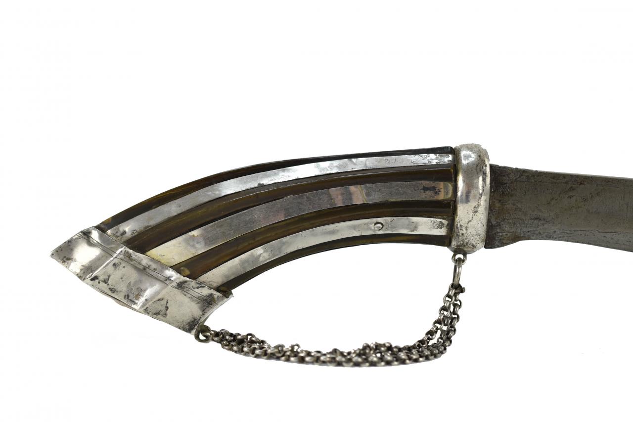

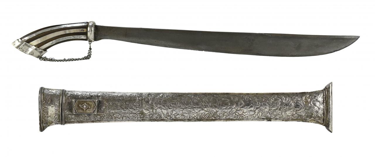

Dear members, a while ago I acquired an unusual sword which was attributed to the Philippines, but it had me puzzled until today. The general outlines are often seen on the West Javanese 'Gobang Bandung' from the Preanger region, yet the aesthetic details like the silver decoration on the scabbard and typical silver sheets on the hilt points me to the Luzon area.
I wonder what your opinions are on this matter.
Thanks in advance!

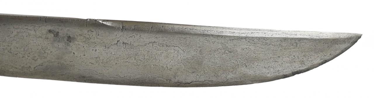

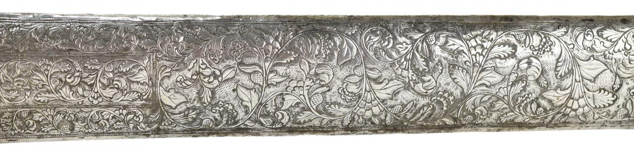

Hello Peter,
I think the style is much more likely Javanese than Filipino. The blade appears to have a pattern that could benefit from etching. Very nice engraving on the scabbard.
Old 22nd January 2022, 06:32 PM   #3
Posts: 7,297
I agree with Ian. The motifs on this sheath look Javanese to me, not Luzon or any other culture from the Philippines and the form of this clearly looks like a West Javanese Gobang Bandung to me.

I agree with both of the above. I would call it a Javanese gobang Bandung, from top to bottom, and a VERY nice one. Did you etch the blade, Peter?

Thank you for your comments gentlemen, I was leaning towards Gobang Bandung, but this piece is not really a textbook example.
I did a light etch on the blade to reveal the pamoresque pattern.

Peter, I can certainly see why this one would give you pause to rethink it, but I believe we can look at it safely as a gobang variant.

I agree that this sword is from western Java; not a traditional highland design though. For example, the chains and the belt hook are a colonial affectation and the silverwork seems to be from the coast.

Yes definitely NOT Filipino. However it is very nice!

Hilts such as the one on this implement are not unusual on Colonial era weapons in Central Jawa.
The scabbard looks very much like Kota Gede or Ngayogyakarta work, the motif is very common in Central Jawa.

One additional thing, I doubt that the blade will display pamor, I think we're looking at sanak, but with a relatively high inclusion of steel rather than iron.
