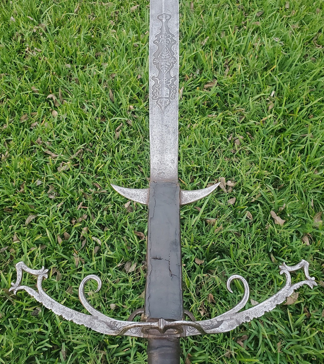

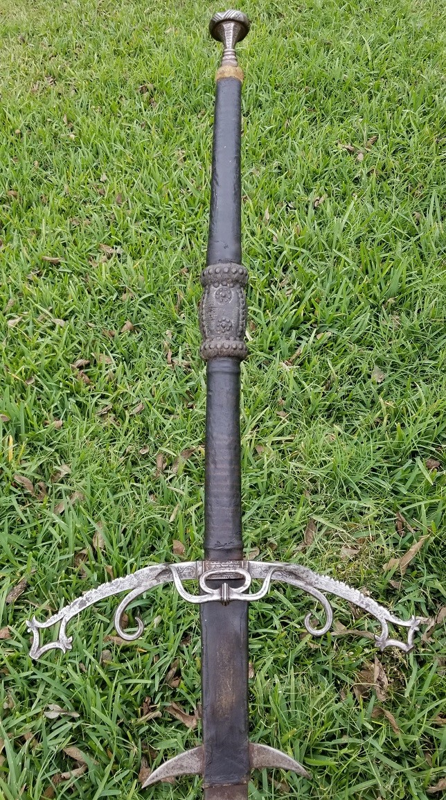

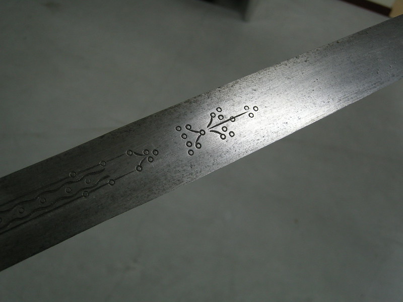

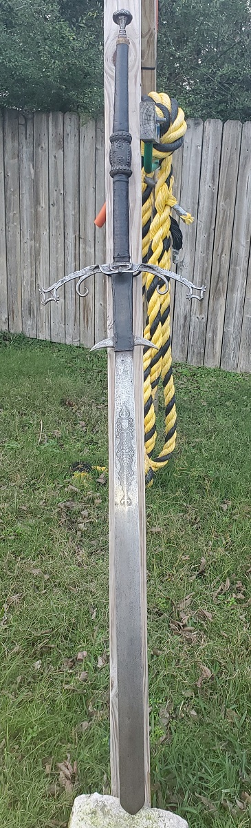

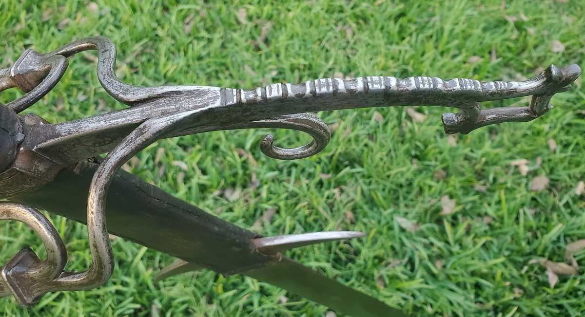

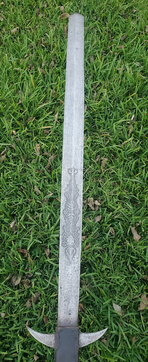

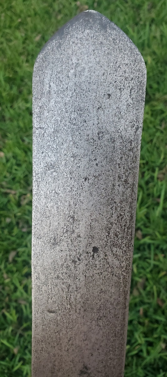

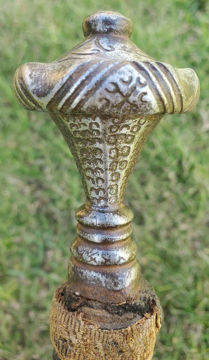

I will mostly let the pictures speak for themselves. My first great sword but I doubt Ill ever find another to replace it. It has it all!
Thoughts on origins? Similar examples of guard, pommel, or blade?

More pics.

Overall length is 189cm.
Center of balance is 84cm from the base of the pommel which is also right at the front of the blade lugs.
Weight is approximately 7.6lbs or 3.44kg.
Its very well balanced and feels fast in the hand for such a monster of a sword. Obviously a good portion of it's length is in the grip which doesn't weigh a lot.
The blade is flexible and 6cm across at it's widest.

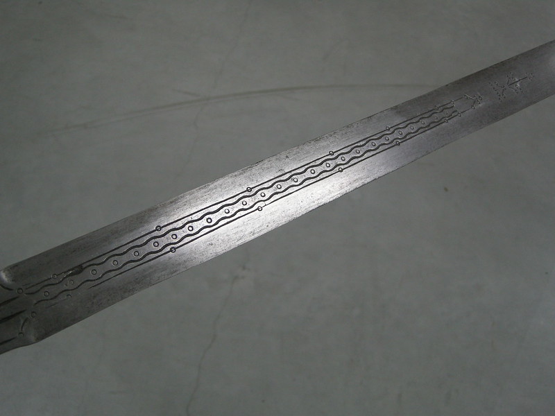

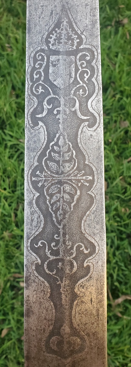

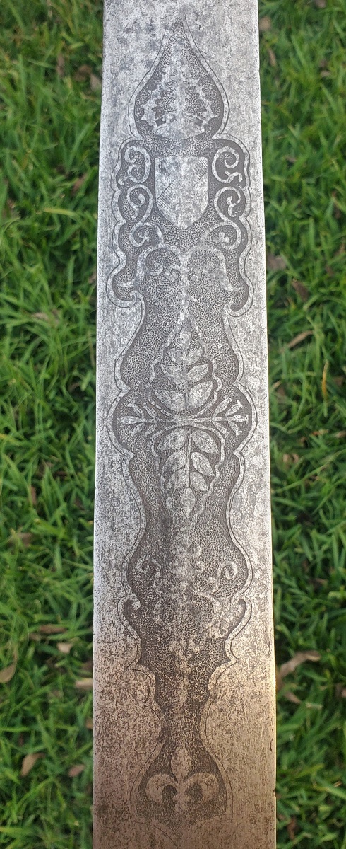

I think that the blade's decoration is not typical for the time such sword has been in use. Over that the coat of arms under this very funny crown is not to be found in Johann Siebmachers book of coat of arms. So I take this for pure phantasy and the sword for pure historism. As I am no expert on such swords I could obviously be totally wrong!

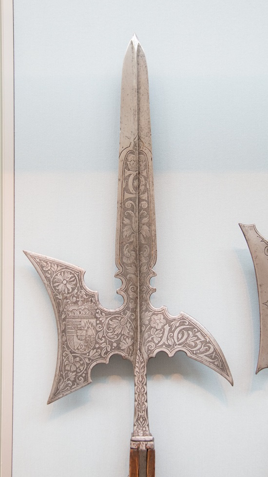

The technique" etching" was used in swords , halberds and armour in the 16th and 17th c , here are some examples .
Its of course good we have books , but not everything they made can be found in books.
On the other hand, just imagine a knight in the 14th or 15th C would order a sword oakeshott type xx at a blacksmith, the smith would not know what to make, and still its in the books now.

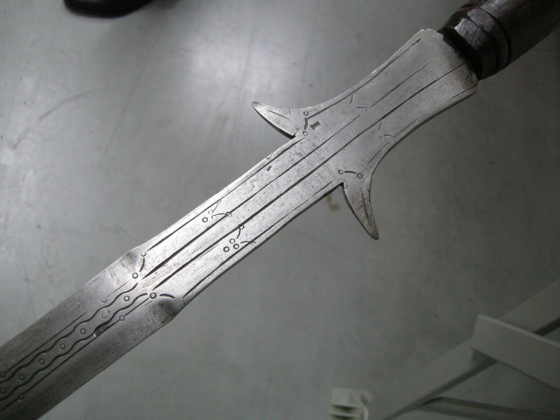

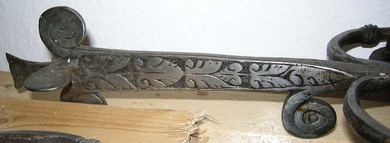

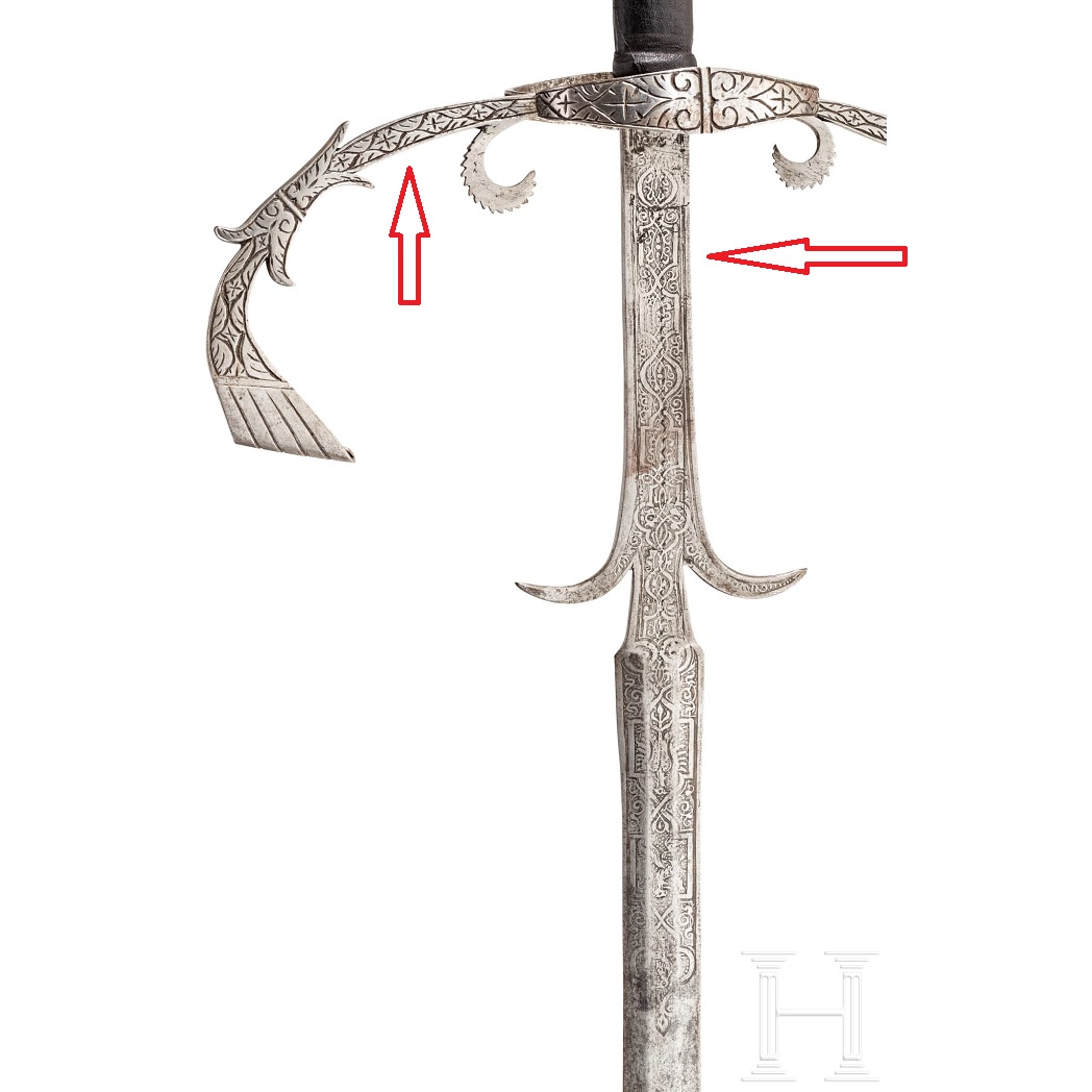

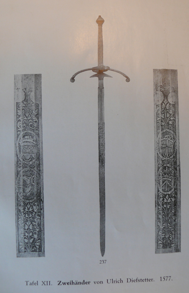

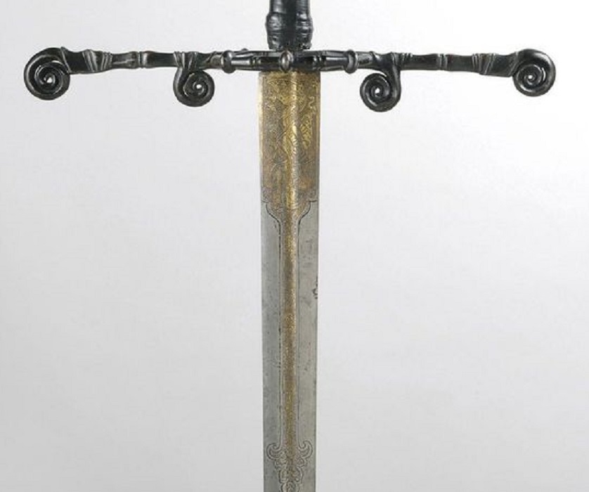

here are two other examples of the period, interesting is the on the first you can see two different results , both of etching on one sword.

Hi Ulfberth, re the Sword of the bodyguard of Duke Julius of Brunswick.
These are different techniques, the quillon is chiseled and the blade is etched.
For the rest i agree with you, like the examples in Wegeli, two hand swords were etched in this matter.

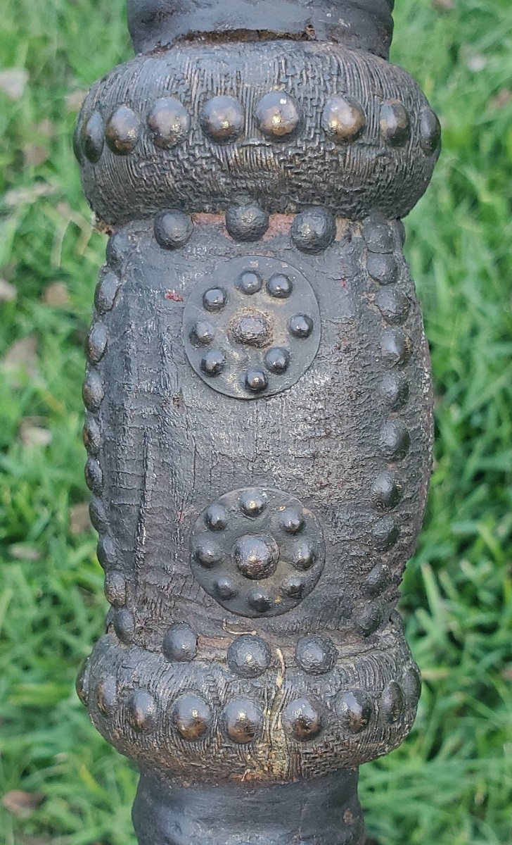

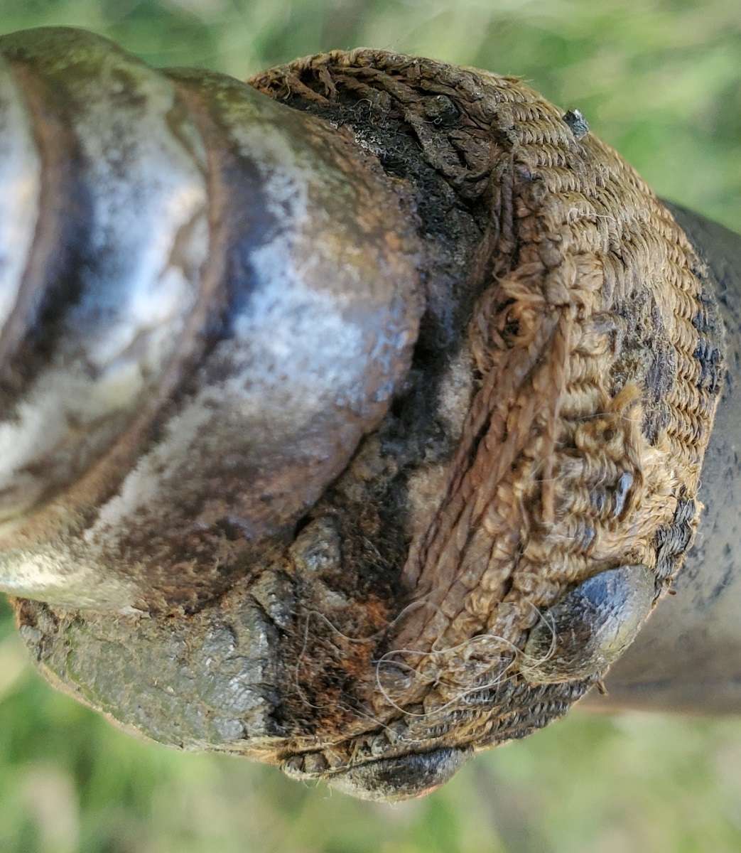

The sword under discussion also looks authentic, in terms of make and patina, the grips also looks good.

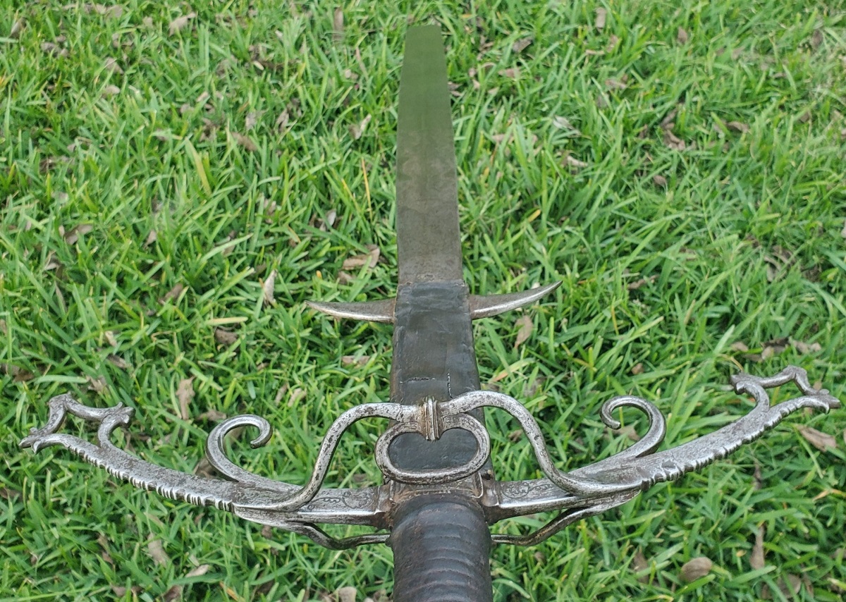

Nevertheless,the only thing that makes me doubt is the unusual pommel style and unusual crossguard style.
but...... like Ewart Oakeshott claimed: that you have never seen it means absolutely nothing at all, unless have seen them all those 100,000+ of swords made.

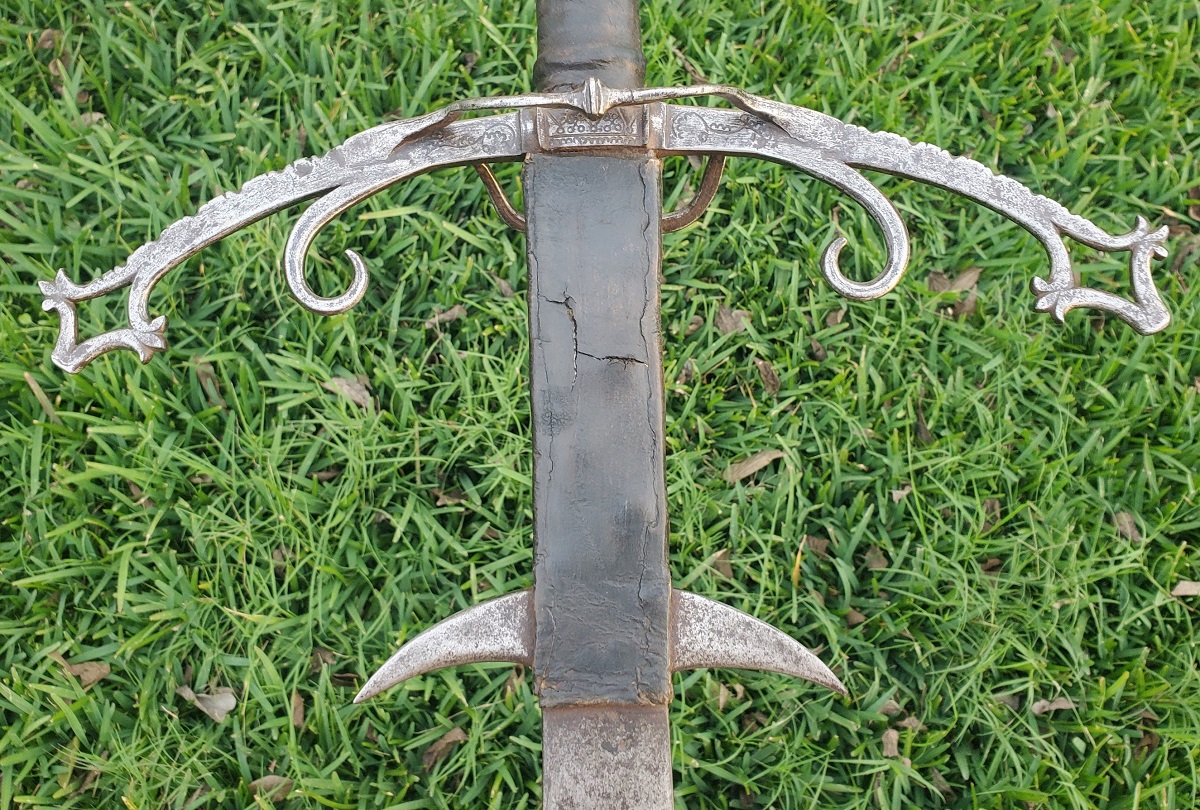

@CsinTX is it possible to see under the leather sleeve if and how the pareer lugs are attached to the blade ?

Hi Cornelistromp , about the Sword of the bodyguard of Duke Julius of Brunswick, that is correct the quillions are chiseled.
However in my opinion after the chiseling work the deeper surface was etched to reach a higher relief. I have had and handled a two handed sword with a crossguard like that in my collection. That one was surely etched after the chisseling. About the styl, most two handed swords in the Italian museums al have more decorative art like styles, this could be Italian work.
The sword of Casey is probably a ceremonial sword and yes it could be more fantasy was used on the blade's etching its not the same a a sword for the field.
These ceremonial or bearing swords were sometimes also used as execution swords in certain towns, it could be a town sword wich could explain the heraldry like etching. However I dont know that its purely speculation.

The sword is indeed a puzzle. I think the etched decoration has been added later on sometimes after the sword went out of service, maybe to perform as a bearing arm - note the huge size.
The guard is weird, but I'm not ruling it out totally. Overall construction appears to be better than usual historismus biedenhanders, and on top of all, the weight vs. length and width ratio is just amazing, I would expect a historismus to be at least twice as heavy.

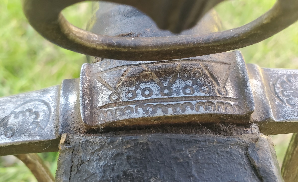

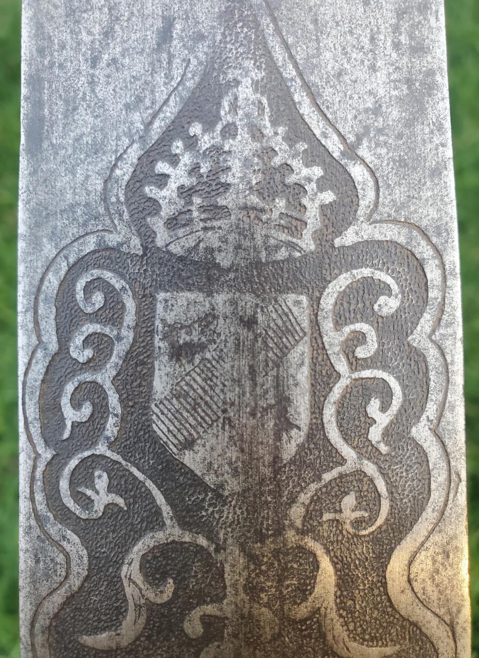

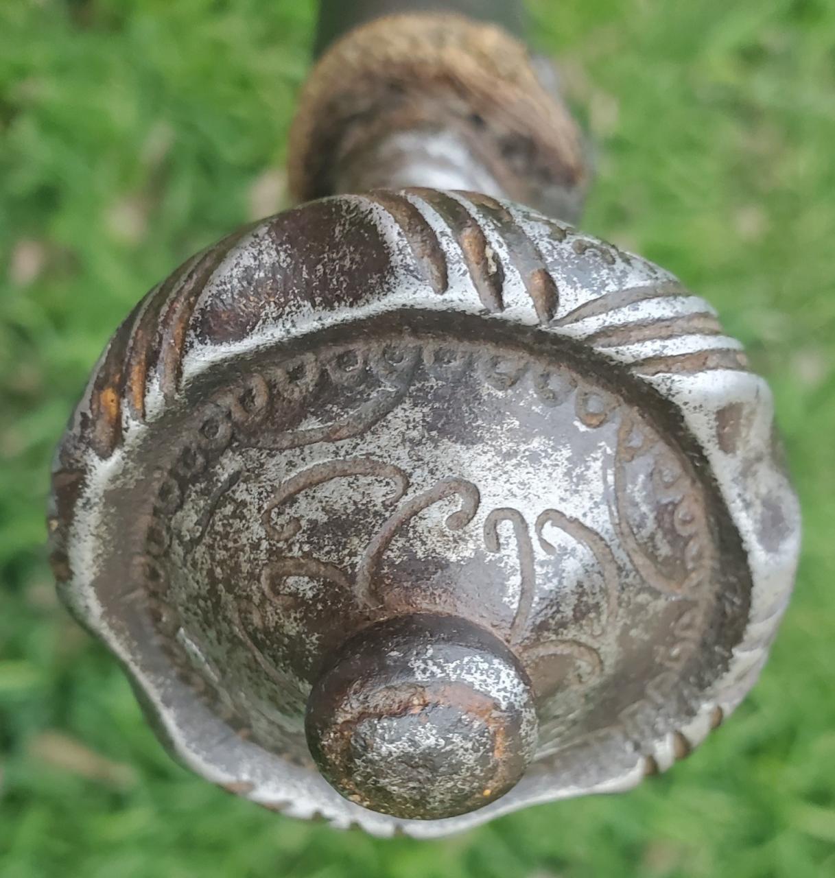

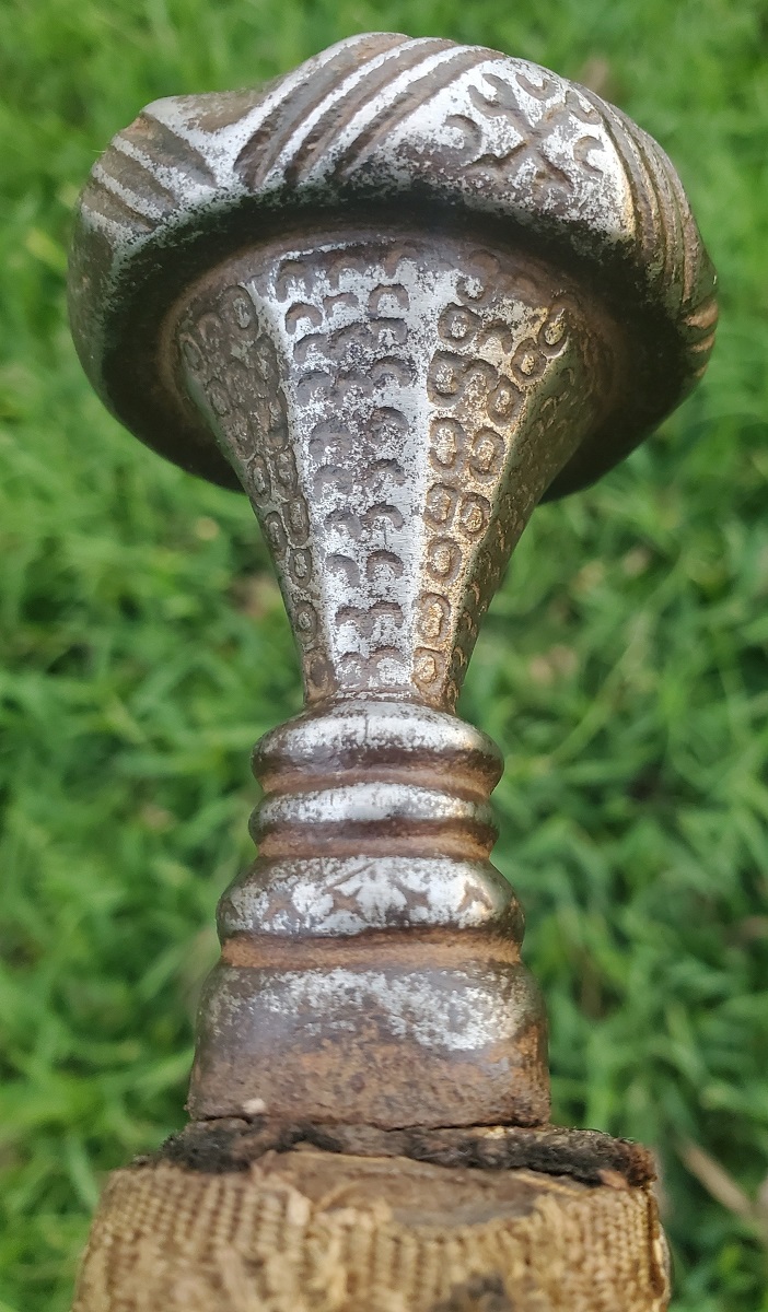

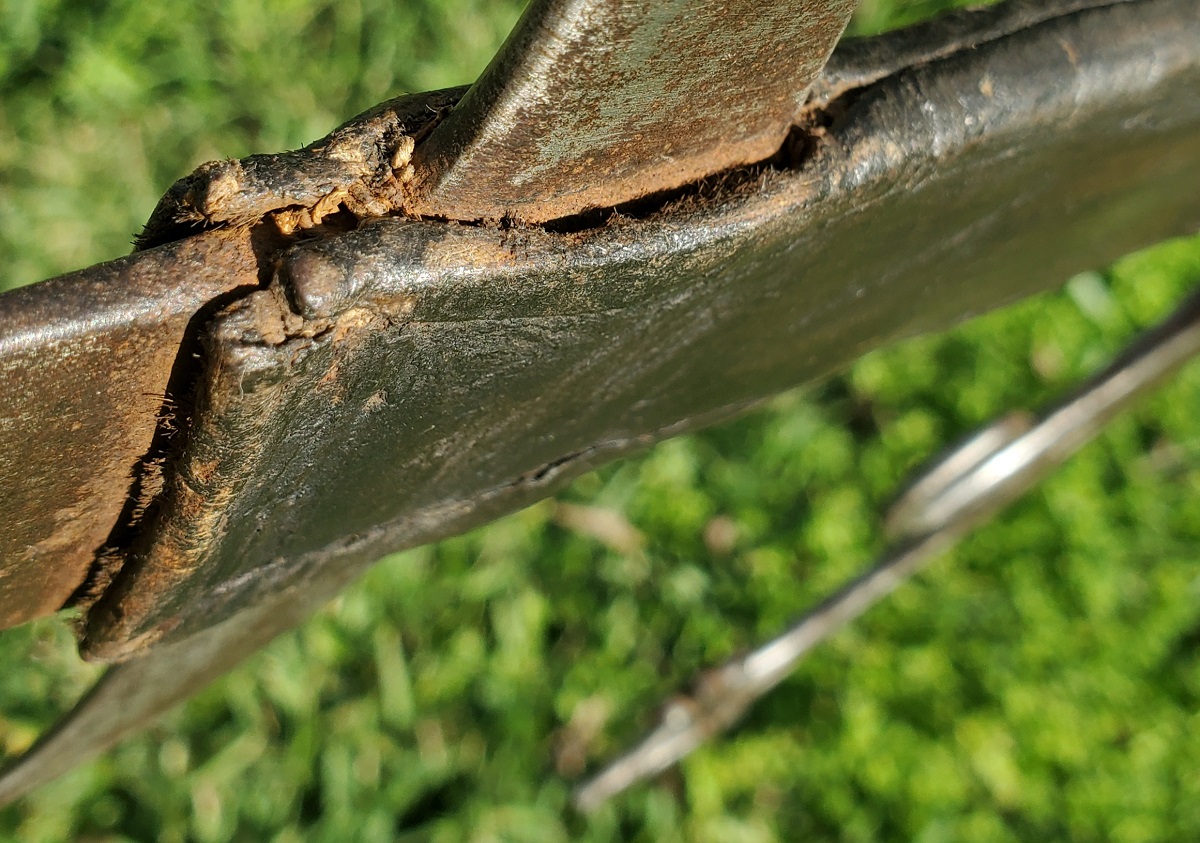

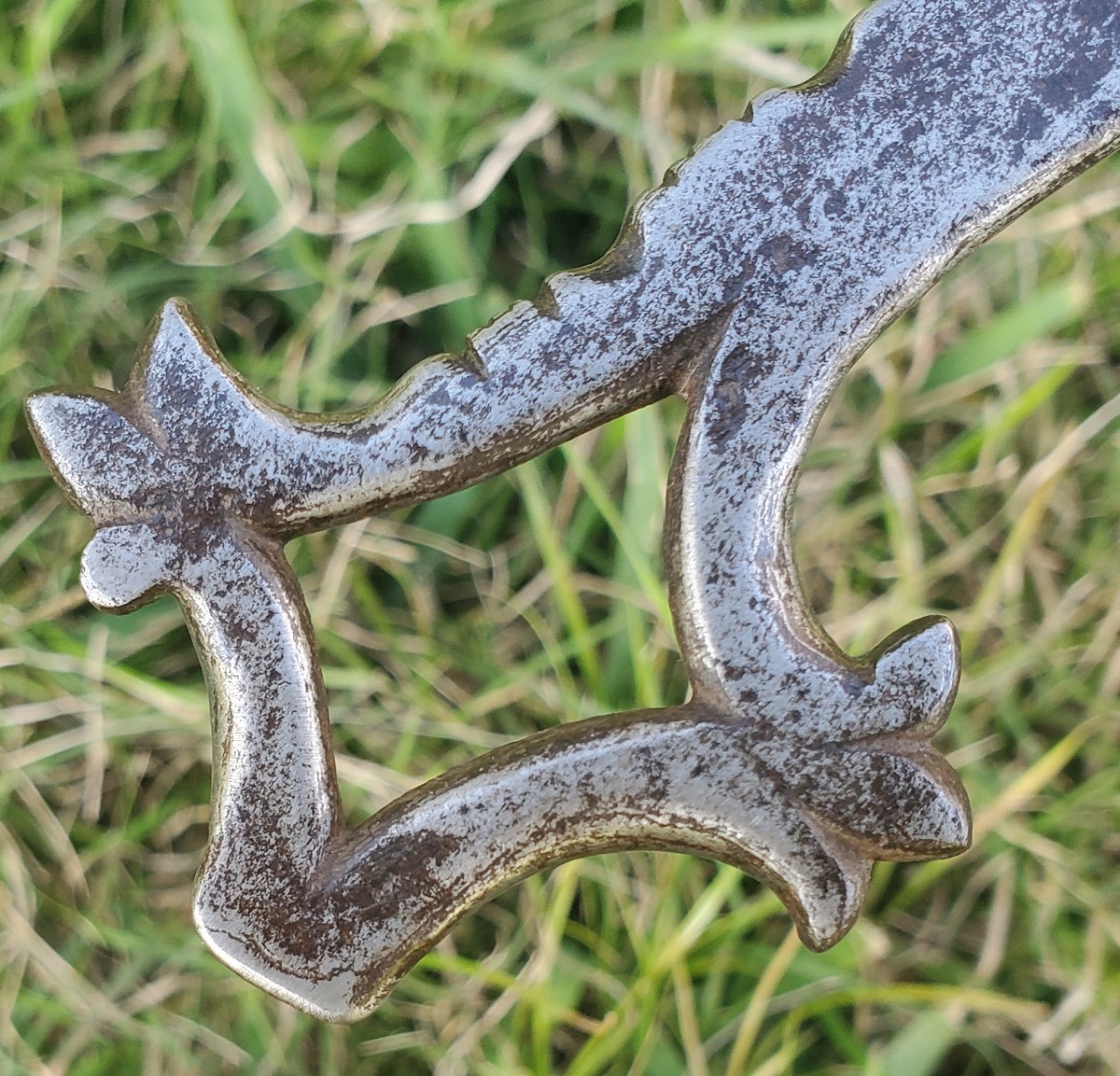

Thanks for the thoughts from everyone. Ive added some more pics. Unfortunately I can not see where the parrying lugs attach to the blade without damaging the leather.
I feel very confident that the sword itself is good. The patina is right, forging lines, highest quality blade, weight, etc. The markings on the pommel match that on the guard.
But I know very little of how stampings, engravings, etc would have been done in a blade. The outer edge of the decoration, that has been mechanically applied, how would this have been done? Could it be done on metal that was not hot (added later)? Or would it need to be done at time of manufacture? There is a distinct grove cut around the outer edge. Ive marked this in green in the final picture.
I like to imagine that maybe this was a bodyguards weapon rather than a piece for the field. This might explain the combination of it being an obviously highly lethal weapon as well as unique and decorated.

Hi Casey, its done with a combination of etching, the center with a punch and fine engraving in the shield and crown.
in the Rijksmuseum depot in Amsterdam there is a blade of a two handed sword, with a stamp which to me looks like Italian.
Interistingly the blade is decorated with similar type of small circle's just as on the pommel and crossguard of your sword, unfortunately we cant see the crossguard because its missing.
kind regards
Ulfberth

the outerline of the engraving the pommel and the guard were done with a hammer and chisel, this was not unusual. see example.
everything looks very good just because the design of the hilt, guard and pommel, is extremely strange makes me doubt.
what I find odd: the shape of the pommel, the diamond-shaped ends of the guard, reminds me a bit of a cleymore.
The ringguards have an unusual outline shape and are forged towards the ends at the cross, and not from the center going outwards.
The small rings on the inside are usually forged on the center block, apart from the outer ring.
The two curls in the center of the quillons are "perfect" in shape, like the relief work on the bottom of the guard, most of the 16thc two-handers show coarse forged ironwork.
The flat diamond-shaped blade did occur in earlier two-handers around the middle of the 16th century.
in the 16th century pareer thorns were forged from the ricasso , while in the 19th century these thorns were often forged and attached separately.
the blades of twohanders later in the 16th century, in combination with this type of pareer thorn, became flat or flat hexagonal, while the blades with thorns pointing towards the hilt are still diamond-shaped.
To me it's kind of a fantasy piece but I can't tell if it was made around/before 1600 or in the 19th century.
best,

If this sword is of the 16th century is anybody able to tell me how and with which tools this pommel was made without some machinery?

I have only just seen this post and agree with the comments on the engraving and chiseling. However I am totally amazed by the style of the hilt - grip, pommel and crossguard. In the course of researching my book I have examined dozens of 2-handed swords in the flesh, so to speak, and hundreds more in photos and have seen nothing like this. The grip is too long proportionally and the midpoint baluster is too fanciful. The pommel and crossguard are just weird even if the actual workmanship is good. For its length as a parade sword it is too light in weight. My opinion is that it is an elaborate attempt to create a 17th century 2-hander, well constructed but horribly inaccurate unless it was intended to be a fantasy sword. Probably 19th century.
The relatively coarse execution of the design tells me that it was chiseled by hand. Looks like a typical level of craftsmanship for the genre, place, and time.

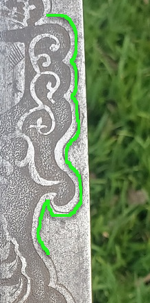

To me, it is not fair to dismiss an item because it does not appear in books or in a museum.
I still have a lot to learn about styles and typeology but I feel like I know a 16th C piece when I hold it. On close inspection I just cannot find anything that says to me that it's later. Weight, quality, forging, impact marks, patina, etc all look correct. If it's not 16th C. then I have to question every item out there.
A few more pics because who doesnt love pictures. I tried to capture the wavy "variation" that is present in good blades when viewed lengthwise.

Sorry, Casey, but that is my opinion, formed from years of studying 2-handers.
I accept that I have not handled your sword and it is certainly a talking point to hang on the wall.
Regards, Neil

Sorry but I concur with Neil's view. Even if this was perhaps a bearing sword not meant for combat, I would have throught something similar would have surfaced in a museum by now.
Sadly, a large number of excellent copies of medieval swords were manufactured as decoration items in the Victorian period and now have age and patina makeing them difficult to spot.
It looks impressive and I hope Neil and I are wrong, but I share his view that this is a decorative piece, maybe late Victorian or even more recent.
The other issue hitting the medieval market now is the practice of smelting down old iron objects to make fake medieval swords that would pass an age test. I am told that this is why so many are now turning up on Ebay.
Naturally I would not expect the purchaser to reveal what was paid for this sword, however price plus the provenance can sometimes complete the picture when it comes to authenticity.

As Cornelis pointed out, the etching work, the brass parts as on the helmets of the period
and also the thicker midsection on the grip can be found on halberds of the 16th C.
