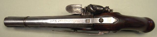

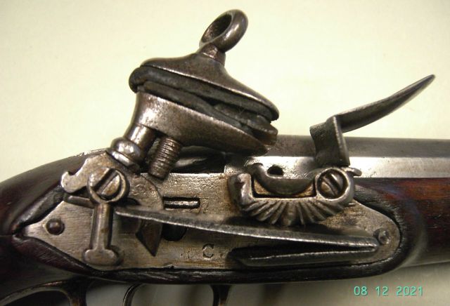

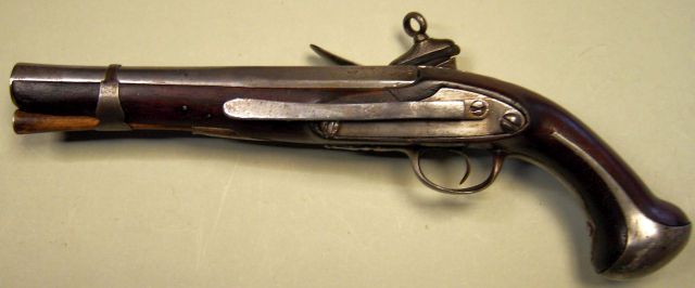

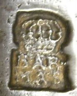

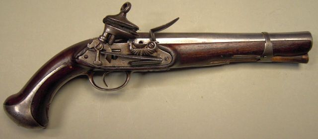

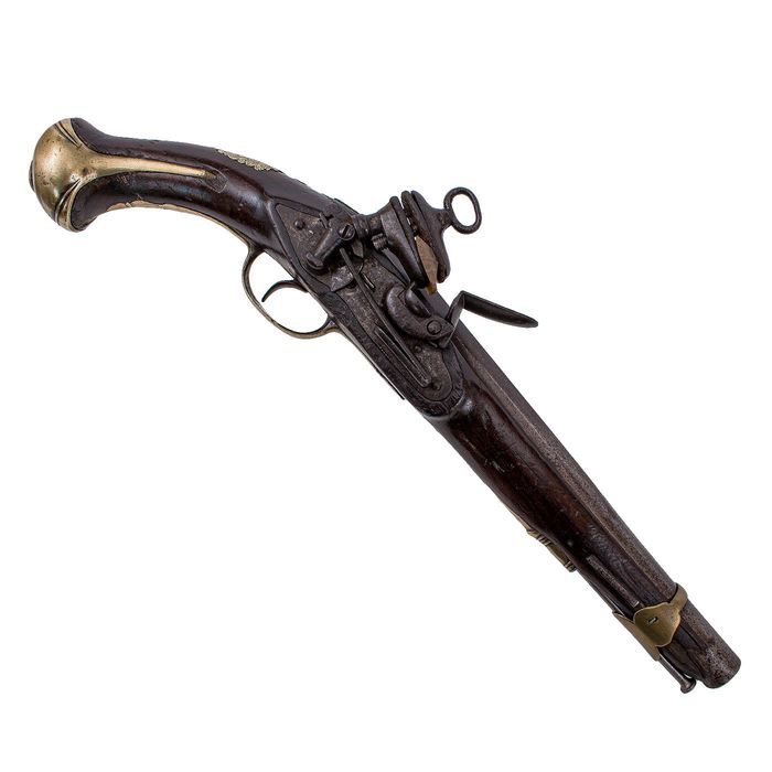

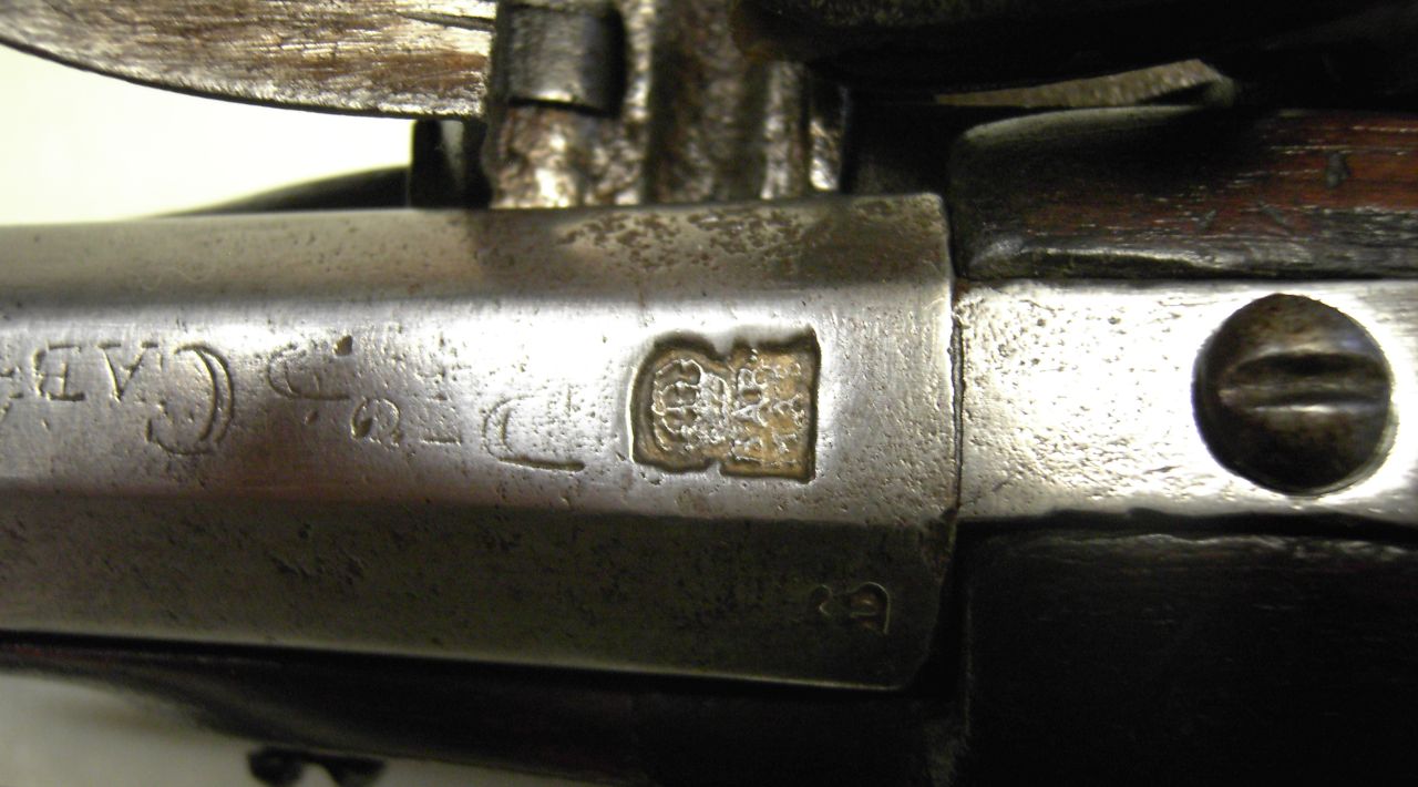

Just to show you a new addition to my collection and to ask your comments. It is as I know a miquelet pistol for the Spanish light cavalry or husars M 1789. A letter "C" at the lockplate says that it was supposedly made in Catalonia, probably at Ripoll. On its barrel besides a regimental signature there is a crowned mark with the letters "BAR/MAS" that I cannot identify - perhaps Bartolomeo Mas?. May be that somebody is able to help.
Old 13th December 2021, 05:30 PM   #2
I am looking in a book at a 1800 Husar pistol, with a 1789 lock. With the barrel with a crowned C for Cataluña, inscribed R. CBA.D HUSS. ESPS..But the punzon in this one is DOM-MAS (Doménech Mas, Ripoll). Could it be family ?
Old 13th December 2021, 11:02 PM   #3
Fernando K
Join Date: Apr 2010
Posts: 672
Ramiro Larrañaga "Sintesis Historica de la Armeria Vasca", pagina 263
"MAS Domingo - Catalan Fines del XVII y prinmcipios del XVIII. Unos sesenta armeros de este apellido aparecen en Ripoll entre los siglos XVIII y XIX"

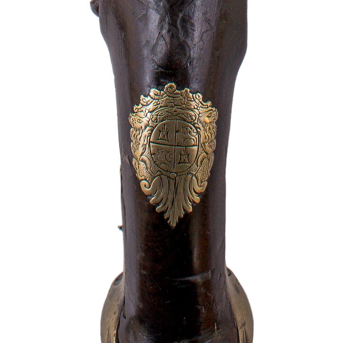

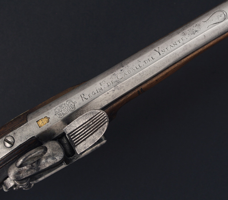

I got recently a 1789 pistol for the Regimiento de Caballeria de Santiago. Also the "short" model like yours.
My furniture, lock excepted is brass.
In the gilded shield at the top of the barrel I have JPP RUIZ, still unidentified.
On the bottom of the barrel, I found the year of making (1788 for me)
and the inspector mark (G for me).

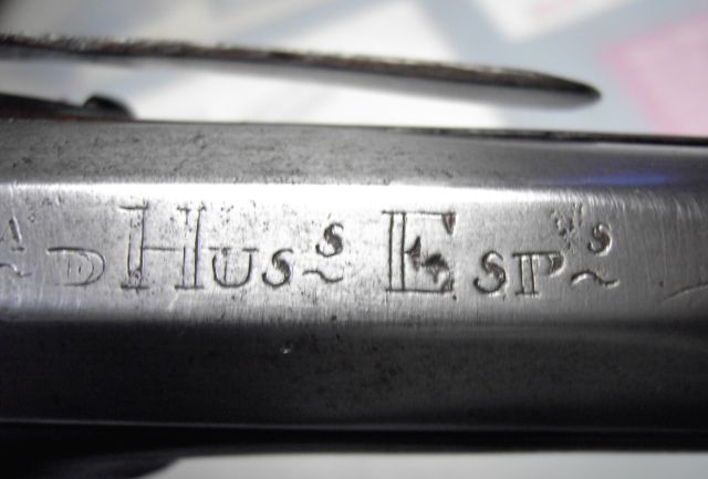

Udo, i would like to know if the inscription on the barrel does include the ESPS in the end.

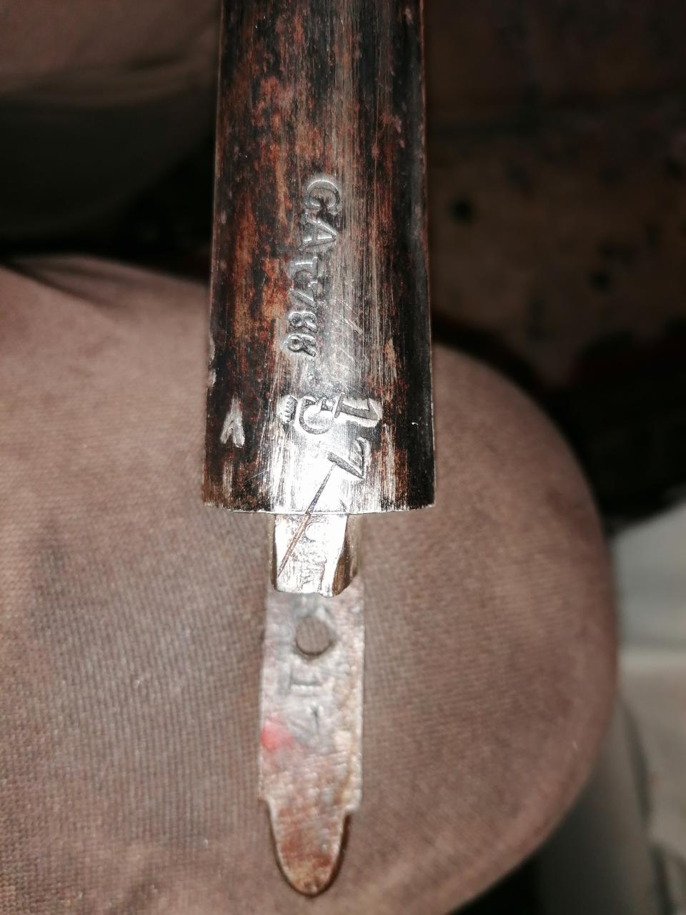

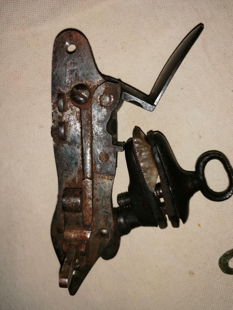

I made some telephone pictures the other day.
As I said, in the 1789 cavalry pistol model there are makings at the bottom of the barrel, hidden by the wood, and in the inner side of the lock.

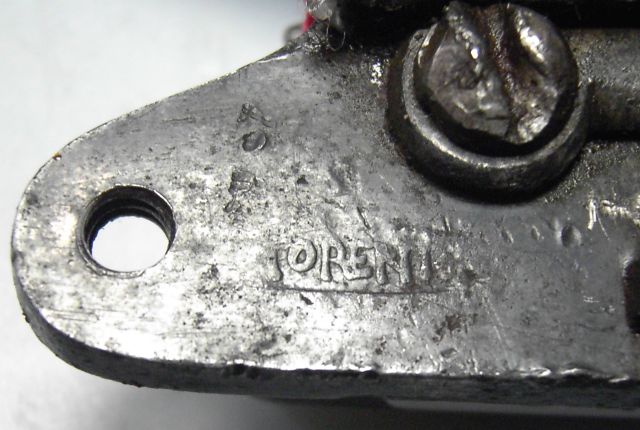

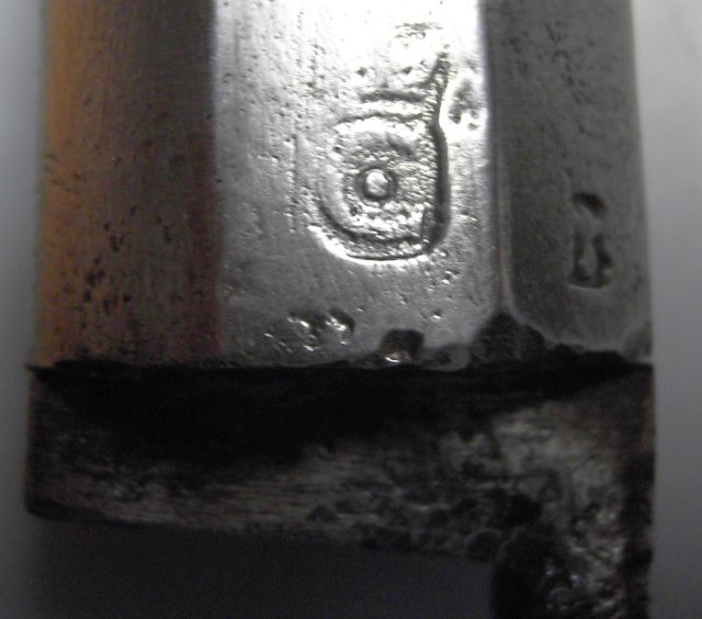

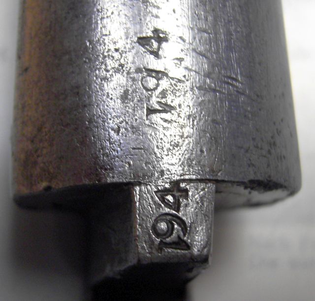

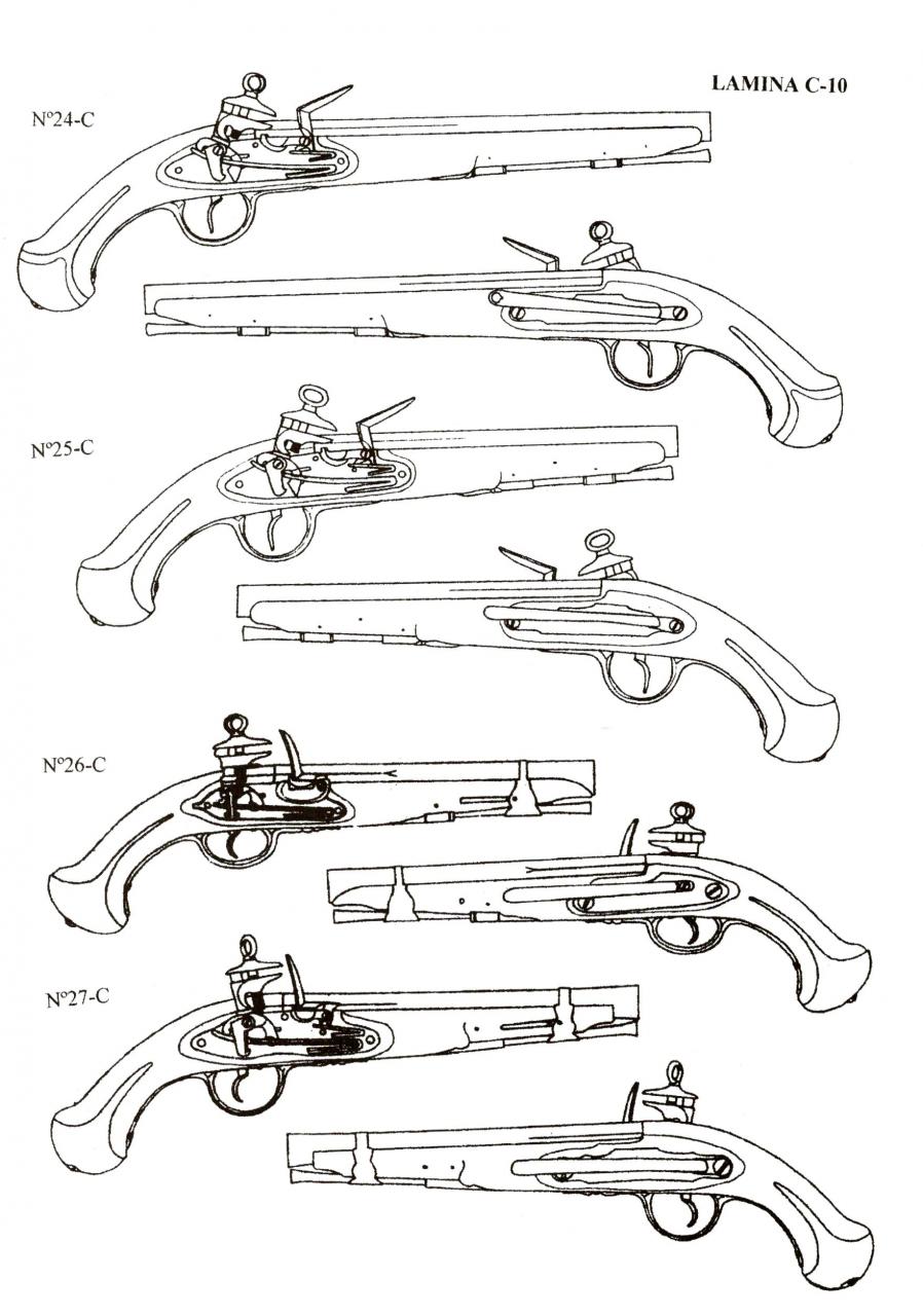

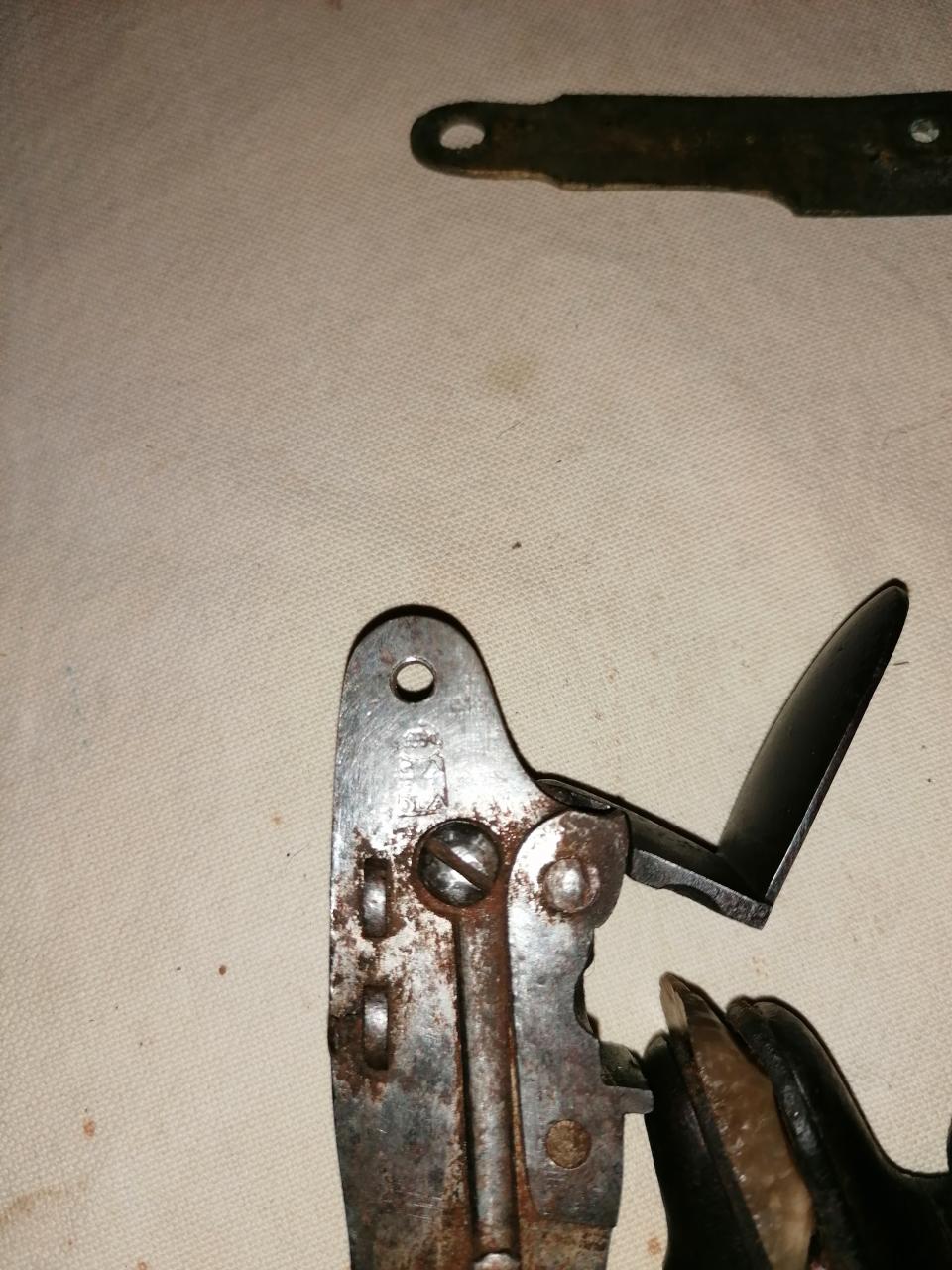

Here come some additional fotos of the marks at the barrel and the lock inside, the end of the narrel regimental marking and the title of Calvo's book as well as the drawing of the Husar pistol 1789. The script at the lock's inside reads TORENTO

Udo, can you tell where you got this 'lamina 6' image. I am reading Calvó's publication ARMAMIEMTO ESPAÑOL EN LA GUERRA DE LA INDEPEDENCIA and viewing his website CATALOGACION DE ARMAS and i can't find it.
In a further book of Juan L. Calvo "Armamentos de Municion en las Fuerzas Armadas Espanolas" you can find other drawings and description of the Husar-pistol 1789 under N°26C

The number 17 at the barrel and at the screw that closes the barrel end is also incised in the wood. I supose it is an assembling code. (194 for Corrado´s pistol).

...In a further book of Juan L. Calvo "Armamentos de Municion en las Fuerzas Armadas Espanolas" you can find other drawings and description of the Husar-pistol 1789 under N°26C ...
Thank you Udo. Same guns, with shorter or longer texts.

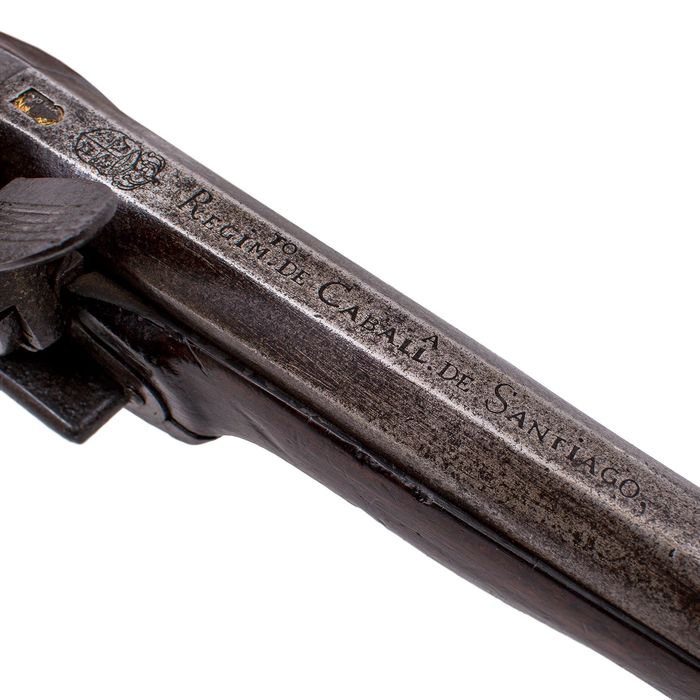

This one is of the long model (lock marked inside DCIARAN, but not shown:
https://matchlock.fr/producto/pistol...-fechada-1789/
Below my pistol of the Regimiento de Santiago.

Me voy a permitir hablar en español, para entender mejor a Calvo. Habla de "pistolas de municion" Alguno podria interpretar que disparaba municion (Como los cartuchos de escopeta). Lo que Calvo quiere expresar es que es munida (del verbo MUNIR que significa proveer) lo mismo que reglamentaria, de ordenanza.
Asimismo, las llaves de 24C, 25C y 27C, son llaves de miquelete a las 3 modas, porque la cazoleta tiene incorporada a la brida del rastrillo, y su resorte esta fijado como en el miquelete a la romana. A diferencia de la llave de 26C, que es un mniquelete clasico, con el resorte del rastrillo escondido detras de la brida (postiza)

Regarding the pistol of post number 18, the signature of the key (lock) corresponds to Domingo Ziaran
Ramiro Larrañaga "Historical Synthesis of the Basque Armory", page 238
ZIARAN, Domingo Ignacio de - Chispero (lock maker) Placencia 1787
In addition, it names Antonio, Bartolome Fernando Jose Manuel, Mateo, Ramon.
Affectionately
