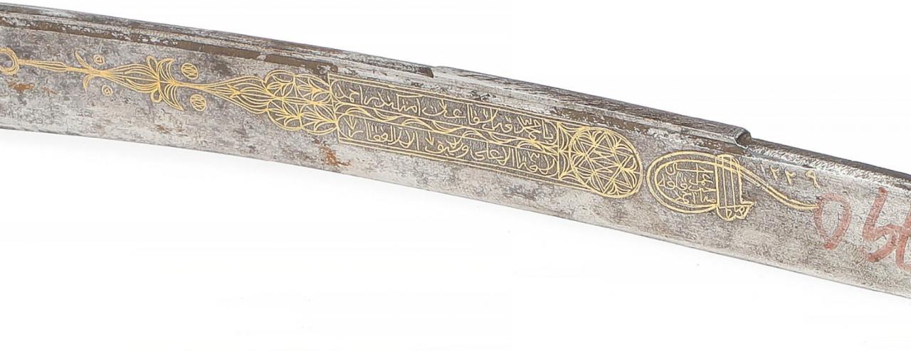

Can anyone please help me with the translation of the text in the cartouche of this yataghan?!How it can be dated?
Is it possible that one of the markings is a sultan's tugra?
I will be happy to share your opinion!

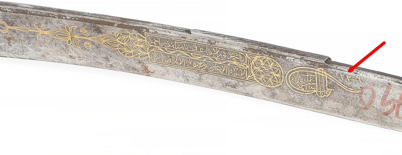

Interesting. I found a date and can read 122(?)
Better photos might help reading the date.

Inside the tughra it says in Turkish
sahib ahmed ‘amel-i hüseyin kalfa
“The owner Ahmed, work of Hüseyin Kalfa”
The tughra form itself might be the word malik, another word for “owner”
The date above is 1229 (1813-14)
The first line of the inscription in the long cartouche is of a type common on yataghans. In Turkish:
ya muhammed kıl şefaat ümmetindir ahmed
“O Muhammad intercede for Ahmed (on the Day of Judgement), he is [from] your community”
The second line is the ubiquitous Arabic phrase:
la fata illa ‘ali la sayf illa dhu’l-fiqar
“There is no hero but ‘Ali, no sword but Dhu’l-Fiqar (Zülfikar)”
For another piece by Hüseyin Kalfa
https://www.alifart.com/osmanli-yatagan-272436/

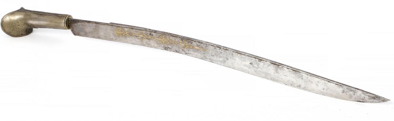

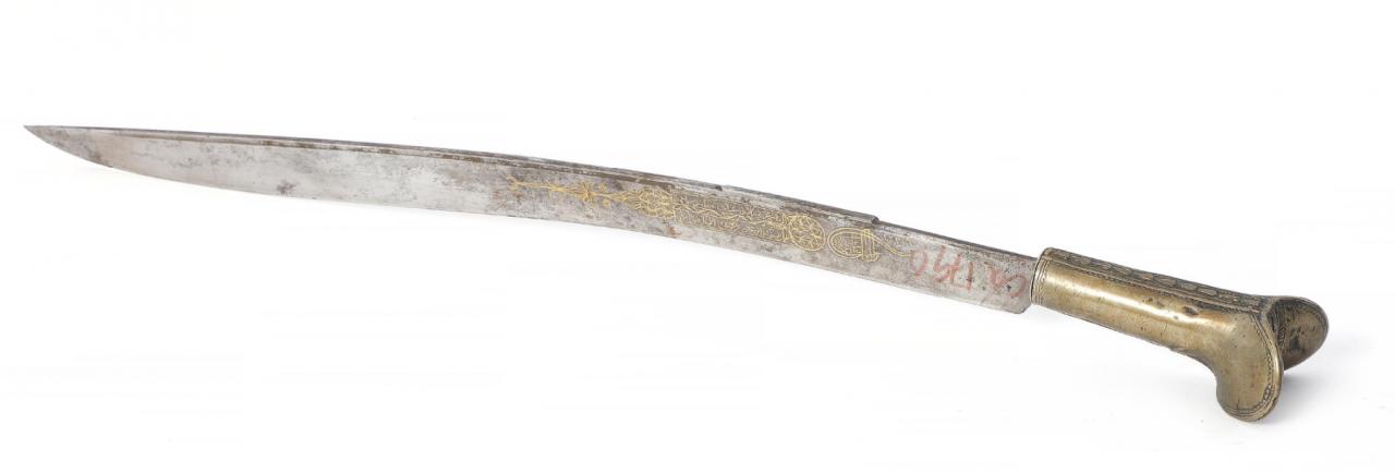

I have another question. Can anyone guess the region where it was produced?

I can guess. Guessing is easy... I guess...
I guess the blade is Turkish (as in Made in Turkey)... and the hilt is not original but a replacement, that wasn't made neither in Turkey, nor in the Balkans.
