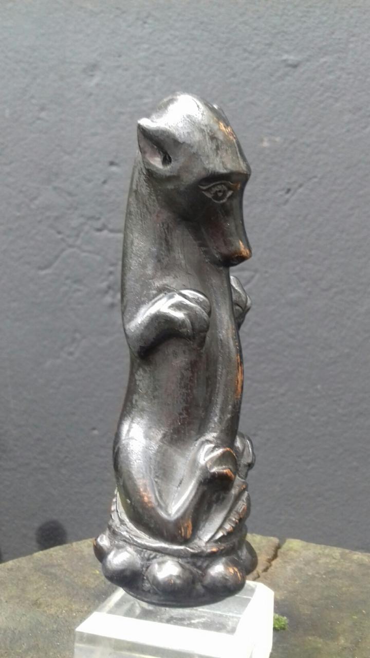

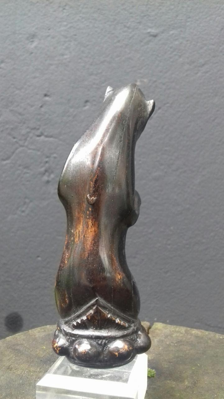

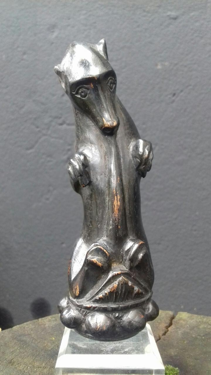

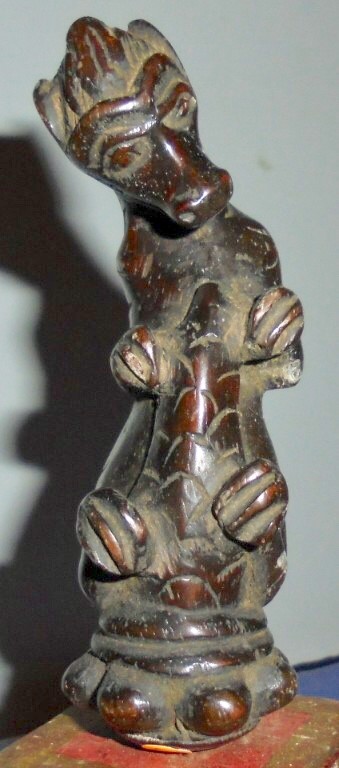

I bought this keris hilt, mainly because I like the carving as an object.
But once in hand the questions arise.
What kind of animal is it ?
Is it a trasitional hilt form our tourist object ?
The seller thought it is an ape. A friend thinks it looks like a bear.
I think it looks more like a dog. Any suggestions ?
Willem

Well, i've never seen anything quite like this in a Balinese keris hilt. There are bears in the region, but this depiction looks a bit slim for a bear. I agree it looks more like a dog. But i have never seen either bears or dogs in keris iconology.
You say you like the carving. Is this wood. In you photos it's hard to tell. It looks either like metal or wood that has been painted silver.

Hello David,
Despite the rain we have at the moment there was a bit too much light for this picture. But it is wood, painted wood. the yellowish spots is where the paint has worn off.
Willem

Looks kocetan to me, but not enough legs, and poor body condition. I hope it was not intended to be a dog.
I once saw a keris hilt for sale... To me it looked like a guy in a baseball cap with the visor flipped upwards, sort of inverted, and with what appeared to be a perforated shower pipe coming up behind him and making a 90 degree angle over his shoulders. I've since learned a few things, and I believe that hilt was intended as some sort of avant garde self-stylization in the form of Hanuman. I did not buy it.
I once bought a keris hilt with a similar "tail", but the face was a lot like the naga we all know and recognize when we see it. I think it was billed as a danganan Hanuman, but I had other ideas when I bought it, although I said nothing to the seller about it. It may be some sort of raksasa, or a bhuta. The hands display a mudra which I have not yet looked up. It may well turn out to be Hanuman after I figure out the meaning of the mudra.
I don't know much, but I'd call it a danganan kocetan, for no reason other than having seen other "horse headed" danganan kocetan in the past, and I am predisposed to view this hilt as having a "horse head", although it may actually be intended as the head of a beetle or pupa. The back does not look like any caterpillar I've ever seen, though. I can only presume that the carver knew what he intended to represent, though perhaps he saw it "as through a glass, darkly". At night when attempting to aim an air pistol at a target, I can only barely make out the front sight post in the U-notch rear, but I'm not missing the 1'x1' plywood piece at about 25'. In the dark I'm not even trying to hit the fox face I drew on the pizza box, or the beer can on top of it.

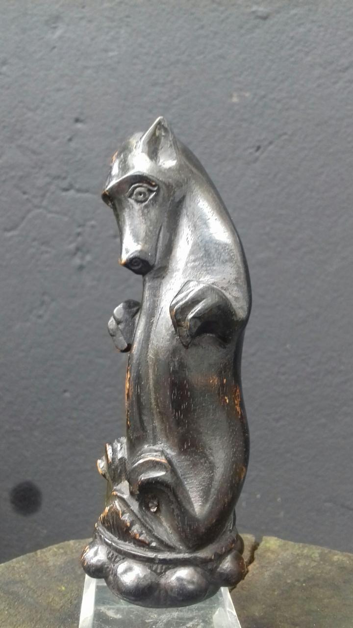

I saw similar thing before recently which according to the Indonesia dealer, it is a dog and I feel it is a new invention for hulu. I think dogs are important part of the Balinese culture, a symbol of Tyaga, meaning bhakti, or sincere devotion. I have recently made a new Balinese keris with painted warangka. I ask the painter to make decision for me and he painted dogs which is my most favorite animal.

I received some information from a fellow collector.
I already noticed the pronounced claws with 3 nails on my hilt, but considering the overal appearance of the carving I thought these were just crudely carved.
Well these nails might be the key to the question.
Maybe these nails are correct and the rest of the carving is freestyling by the carver.

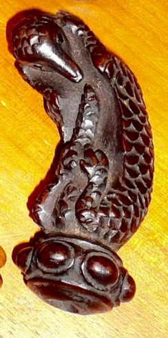

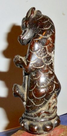

I received pictures of hilts depicting a pangolin.
According to this fellow collector a sasak motif.
Willem

This is a very interesting post asomotif. I have not seen a pangolin used as a hilt motif, in fact, I cannot remember seeing a pangolin used as a motif at all in Islamic era representations.

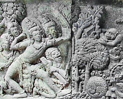

In pre-Islamic Jawa the pangolin was a powerful symbol, he was the guard of Rawana's pleasure garden, through the relationship of the pangolin with ants & flying ants in particular the pangolin was used to symbolise destruction of enemies in warfare and destruction of evil forces/demons in particular --- in Old Javanese literature ants can symbolise rakasas, pangolins eat ants. Probably a pangolin was sacrificed in the construction of one of the minor candis in the Joro Jonggrang complex, Candi Nandi (?), and used in esoteric ritual.
There is a basrelief on Candi Siwa at the Loro Jonggrang --- ie, Prambanan --- complex near Ngayogya that shows a pangolin.
In pre-Islamic Jawa the pangolin was a big deal, but maybe not so much in Islamic Jawa. My guess is that the pangolin symbolism arrived on Lombok with the 14th century immigrants from Jawa.
Really good to see survival of this symbolism, I had thought it was all but gone.
EDIT
This edit is the addition of the Candi Siwa pangolin, you can see him curled up at lower right, just near the mushrooms.
