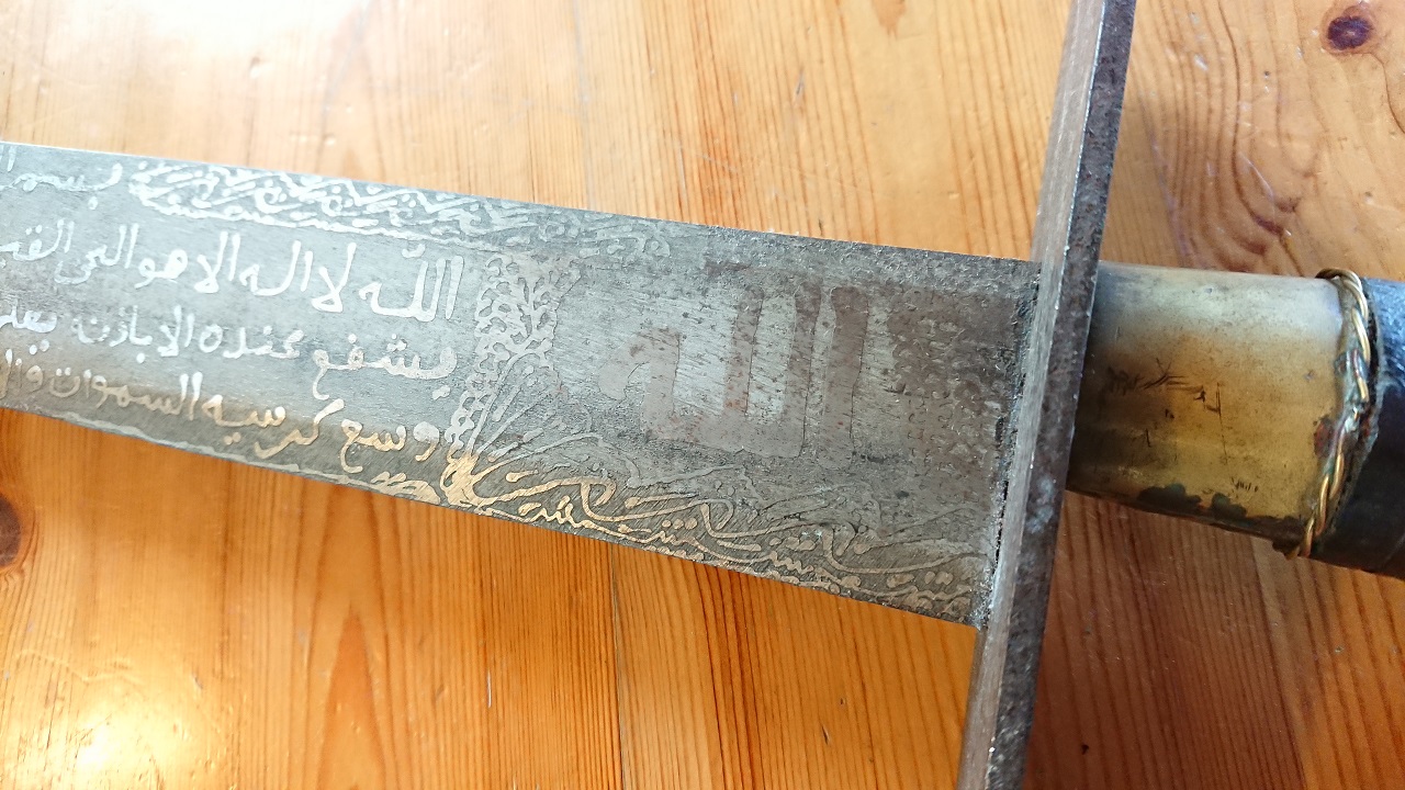

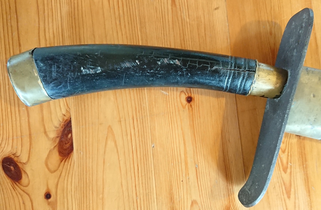

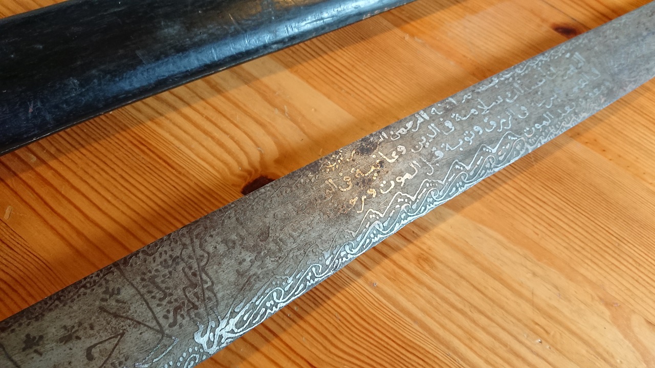

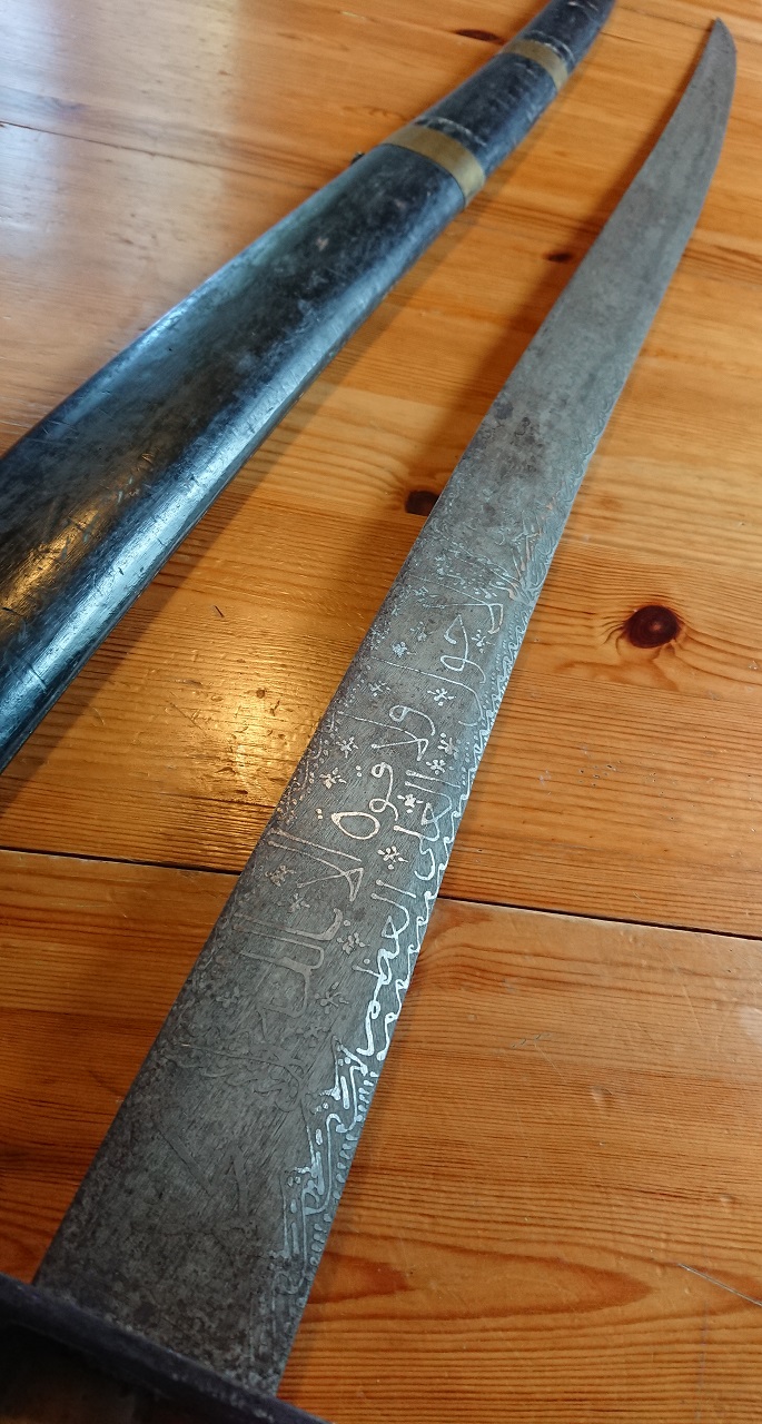

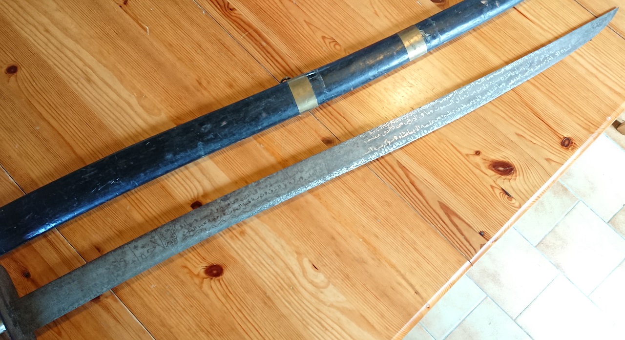

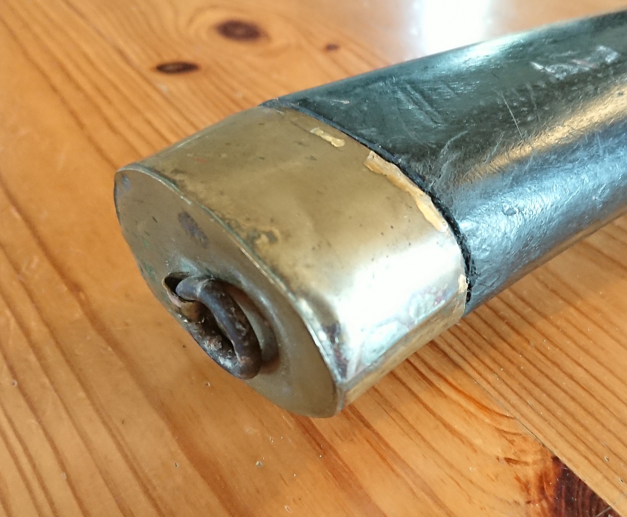

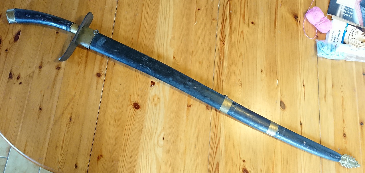

I'm emptying my room at my parent's house and I found this big sabre that I bought when I was a teenager (most likely because it looked cool and old). It doesn't really fit my collection nowadays, but I still am curious to learn more about it. Is it just a (very) large and fancy tourist item or maybe something else ?

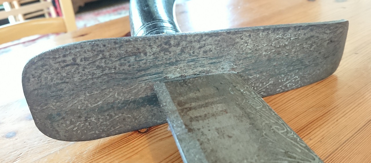

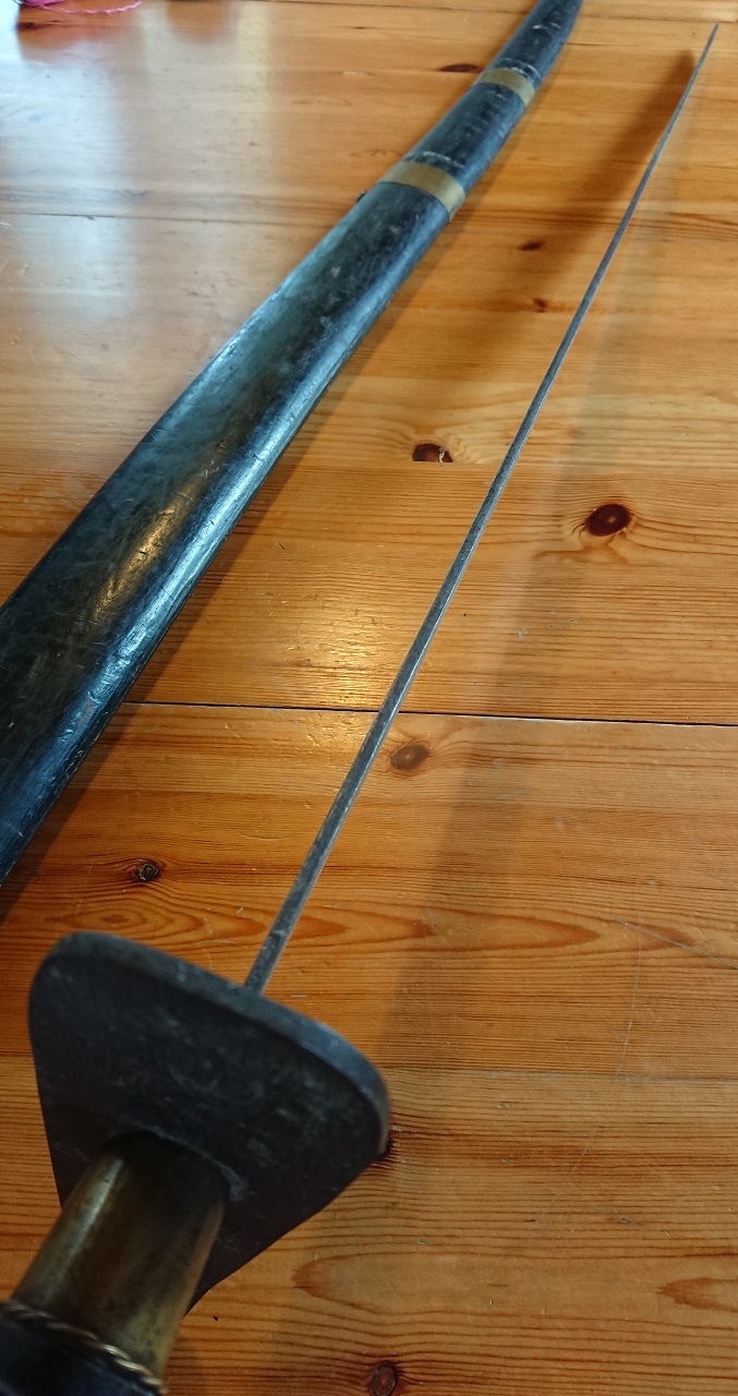

If I should guess, I could see some resemblance with the Vietnamese guom but not much more. It was obviously not made to be used : extremely heavy and unbalanced, the blade shows no distal taper and was most likely cut from a steel sheet, as well as the guard. The hilt and scabbard are made of white wood painted black, the fitting are made out of brass sheets soldered with tin (I think), the whole blade is acid etched with Arabian script (coranic ?) but isn't particularly neat. Overall, it looks impressive from a distance, but is rather cheaply made.
Total length is 138cm, blade length is 108cm
Any information is welcome ! My main area of knowledge is Africa and I'm quite stumped here ... Feel free to ask if you have any question or need more info ! (And sorry for the poor pictures, the house is badly lit)

I would guess that this is a Javanese pedang. Not only does the hilt look Javanese, but it would explain the Arabic writing, possibly in Jawi.
And yes the letters were acid etched. I recognize the name "Allah" a couple of times on one side of the blade.

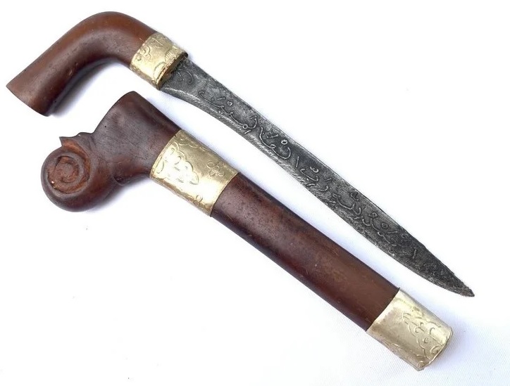

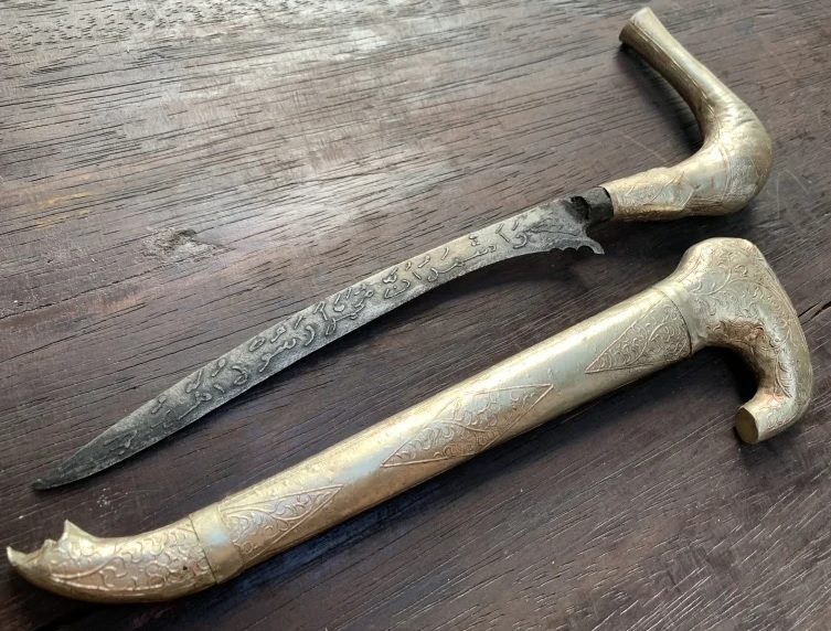

The only thing that I've seen similar is that some modern tourist items have acid etched Arabic on the blades (see attached examples). I believe these are made in Borneo, but occasionally you see this style on something like a modern tourist kujang.
Thanks,
Leif

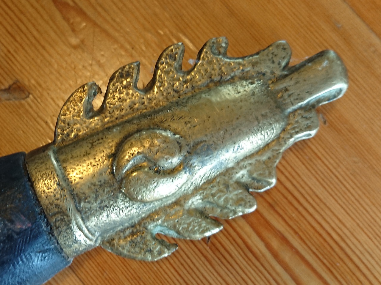

Good observation as re physical characteristics. The guard reminds me of an abbreviated version of the full knucklebow as seen on later (Nguyen Dynasty) sabers. Same for the scabbard profile, the tiny loose-ring for carrying mounted on the throat fitting (instead of on a separate band or sleeve as with most saber scabbards from other cultures including Chinese), and the flame motif on the chape. However, on Vietnamese officials' regalia sabers, the flames mostly appear on the dorsal side of the throat and suspension fittings; their location on the chape must be quite an impediment to wearing the saber at the belt since the little prongs can easily catch on clothing, or whatever.
The Cham people have an interesting history. Immigrating from south India early in the medieval period, establishing a flourishing civilization based on piracy and trade in central and southern Vietnam, introducing a Sanskrit based writing system to the area thanks to their Hindu faith, leaving behind some impressive architectural and sculptural achievements, and finally being conquered and (largely) dispersed through conquest by the Vietnamese in the 15th cent. Their islamicization seems to have occurred post-conquest. The remaining Cham in Vietnam are a minority which is rural and Muslim.
This saber could well be from the Cham community, in a locality somewhere in "Indochina" or Malaya because of the inscriptions and the design of the mountings. There is quite a spillover of influences in arms design in the traditional weaponry between the various parts of mainland SE Asia (not to mention foreign stylistic elements from China, Japan, and France) so trying to separate the sheep from the goats can end up being quite an exercise.

but the flaming ying yang is a dead give away on that sheath.. as hui are fond of all these type of things..... being chinese they mix these things in with islamic themes. .

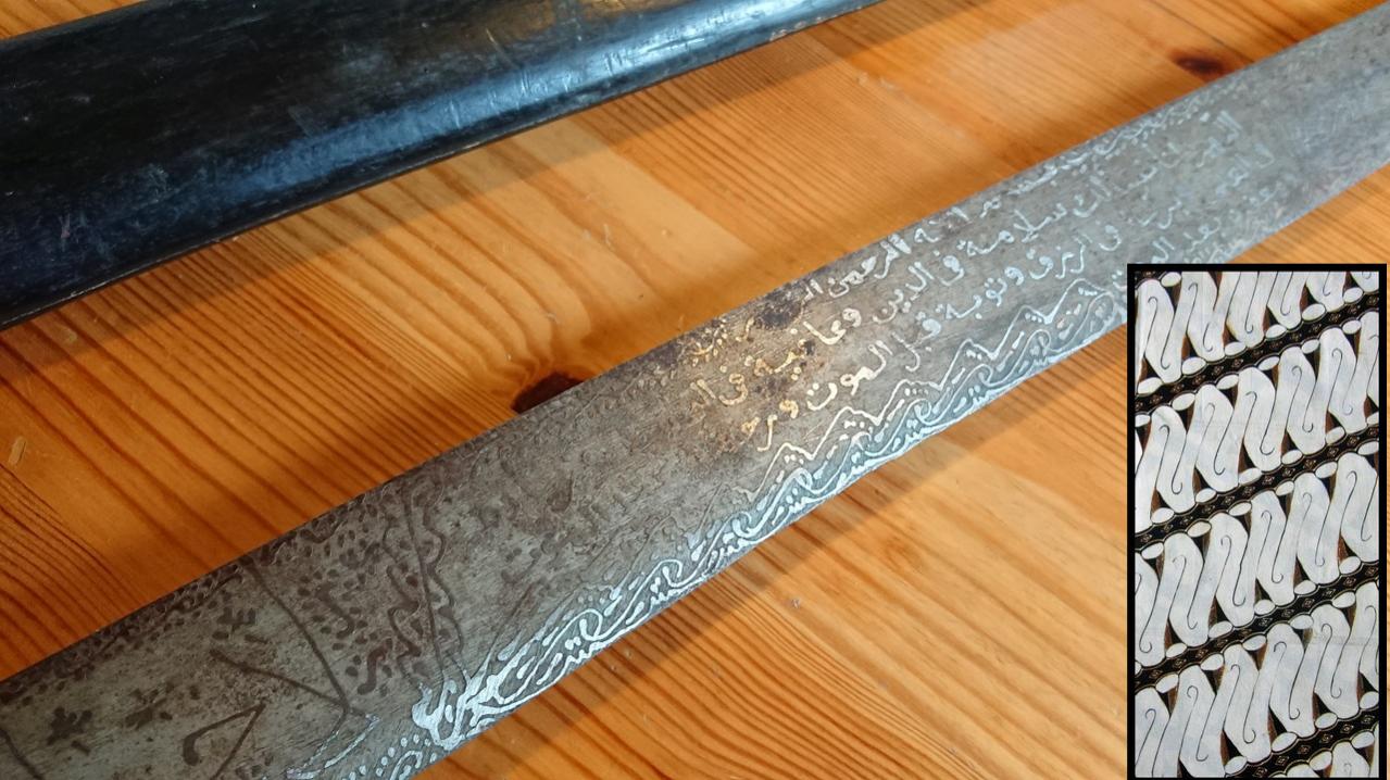

Has anyone noticed the ornament along the edge? It seemed familiar to me and I did my little research.
This ornamental motif is called Parang Rusak - "Broken Sword" and is originally present on batik textiles in Central and North-West Java.
According to legend, it was created by Sultan Agung, ruler of Mataram in 1613-1645. He was inspired by the picture of huge sea waves crashing against a high rocky coast. This ornament has become a symbol of wisdom, fortitude and courage of the ruler, as well as responsibility to the people, ancestors and God. At that time, clothes with motif Parang Rusak could only be worn by the Sultan himself and the closest members of his family, for the rest it was a "forbidden pattern". Now, of course, direct prohibitions no longer exist, but respect is still there.
