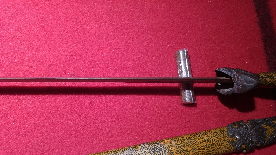

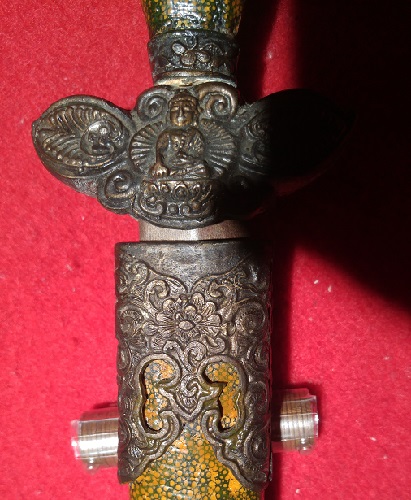

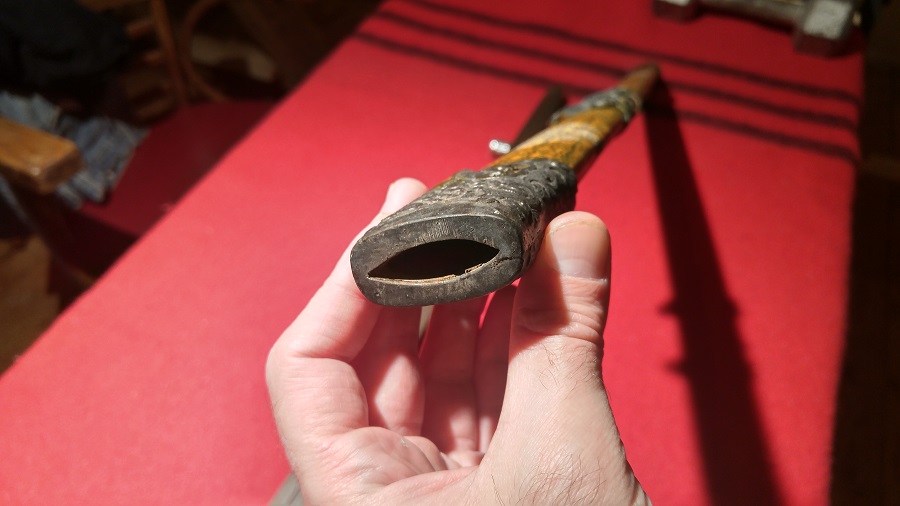

Default Jian Sword Buddha

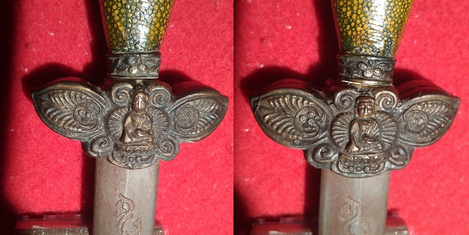

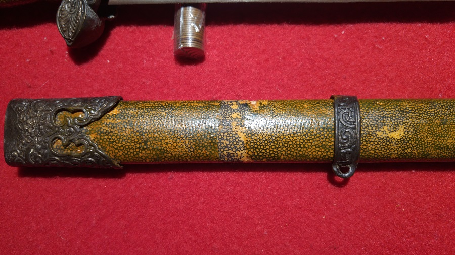

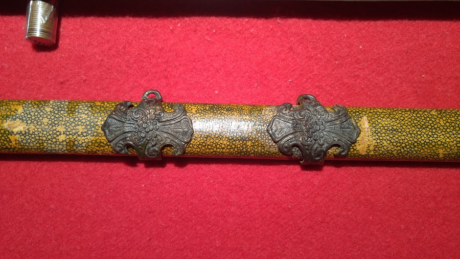

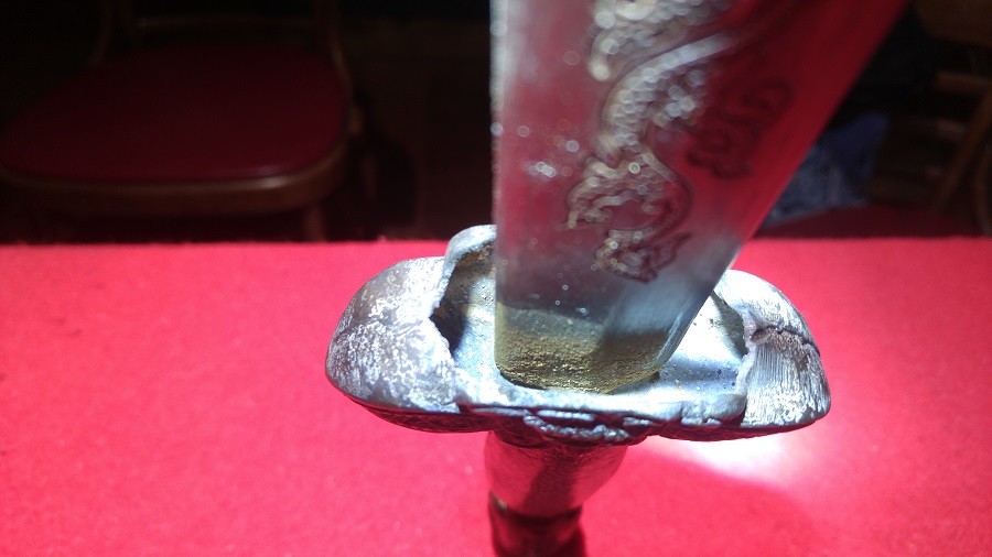

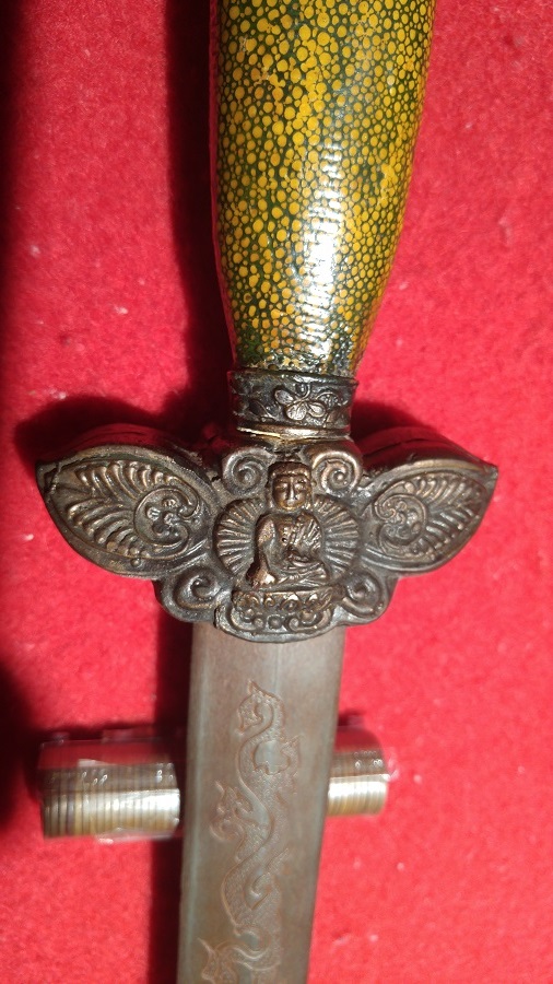

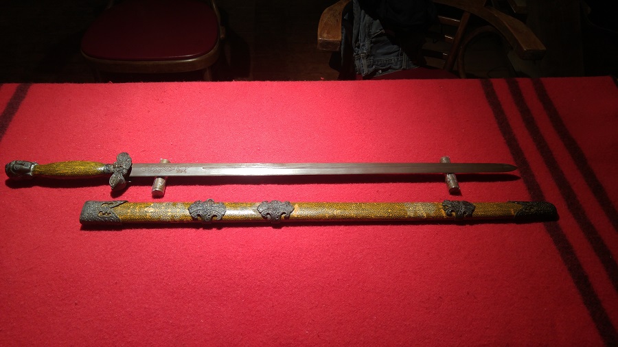

Looking for opinions on age, origin, purpose, info etc. also to share, thanks

JoeCanada42
JoeCanada42's Avatar
Join Date: Jan 2021
Location: Canada
Posts: 259

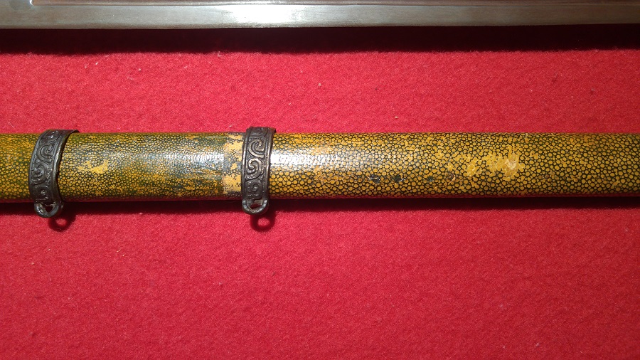

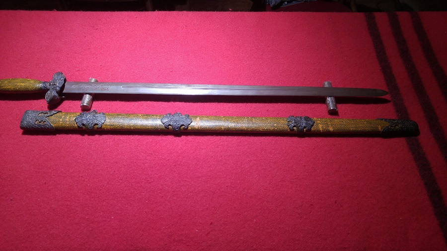

mores photos 2
JoeCanada42 is offline   Reply With Quote

more photos 3

more photos 4

last of photos

I hate to be the bearer of bad news, but the form and design is consistent with modern made pieces flooding out of China the last 20 years. They are very good at making recent versions look 100-200 years old, but they typically throw in designs that were just not commonly found. Kind of like making a modern fantasy sword design look old by aging it with chemicals etc.
I bought 2 similarish ones 20years ago for $500 each. The cost of the study.

hll. sad to say it is a very recently made crude chinese fake.

Possibly made in southern Yunnan where there are ethnic minorities following Buddhism.

Thanks for stepping in Jim, I was just about to say the same.
Thanks Ian I did try looking for some examples of Yunnan "village Jian" swords earlier today and I will keep looking. I have not found any examples yet.
Ausjulius , what is very recent in your opinion? and if you could give me some reasons why you say this one is fake please?
I have seen many Jains sell recently and have some I believe interesting research and different Jian swords photos to share. I may be wrong but I do believe I see genuine age in the Jian I posted .

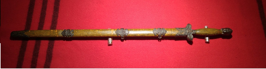

I will give some details about the sword. I got it from an American eBay vendor with good feedback who I don't believe sold such a sword before. I payed the second time 300$ Us, i did have to pay customs also and in Canadian dollars this was a bit expensive for me. Originally I purchased it buy it now for about 120+60 Us. it was confiscated by eBay global shipping program.
I then found it for sale with the known eBay liquidator. the Original seller was nice enough to buy it back and sell it to me the second time. all this took a lot of work and the sword went on quite an journey to get to me.
that being said the price I payed kind of defeats the point of making a fake.

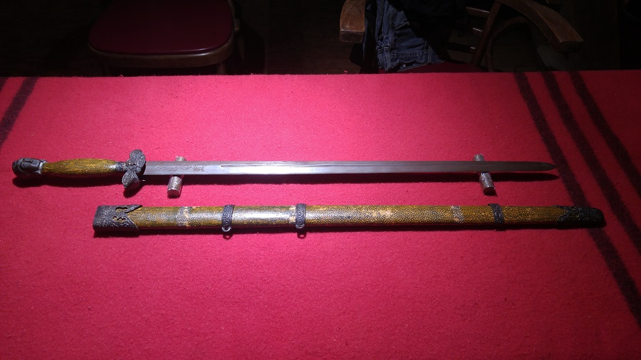

the sword is 35 1/2 inch , the blade is little over 28 inch, the scabbard is a little over 31 inch. the sword in the scabbard is about 39 inch.

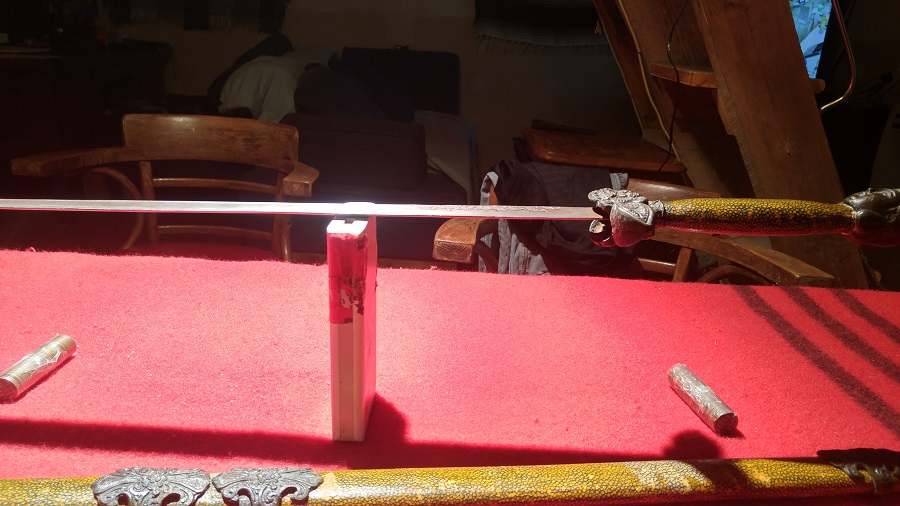

I don't know the weight yet, I have a photo of it balancing on the balance point.
I see one similar Jian, when I search for antique Jian, the guard is the same but without buddha, and the scabbard fittings are the same... although I cant post a photo of this similar sword currently, it also has a different more standard pommel and longer signed blade. but is the same color and very similar to mine, it is dated 19c.

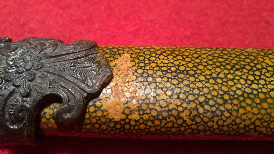

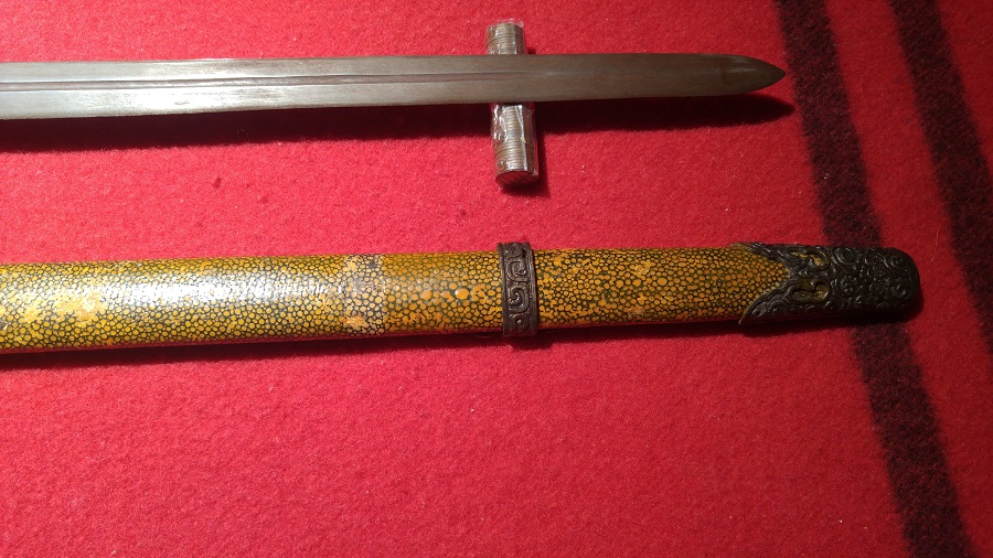

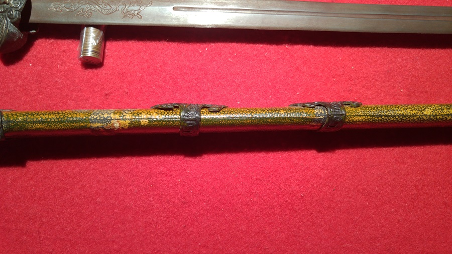

On my sword I see the ray skin is shrunk, and the blade has rust under the guard, the guard is also lose, the blade is solid, all scabbard fittings are lose. there is many flaws in the metal work. most modern replicas are of better quality, I think this may be primitive work., the dragons on the blade and the faces on the pommel and the sitting buddhas on the guard all have discrepancies. the blade is a known blade shape and thickness, and is sharp with a few dings. i think the guard is Tibetan shape, the handle is large enough for two hands.
the blade definitely feels real, I also looked for about a month and can not find any other Jian with buddha elements at all.

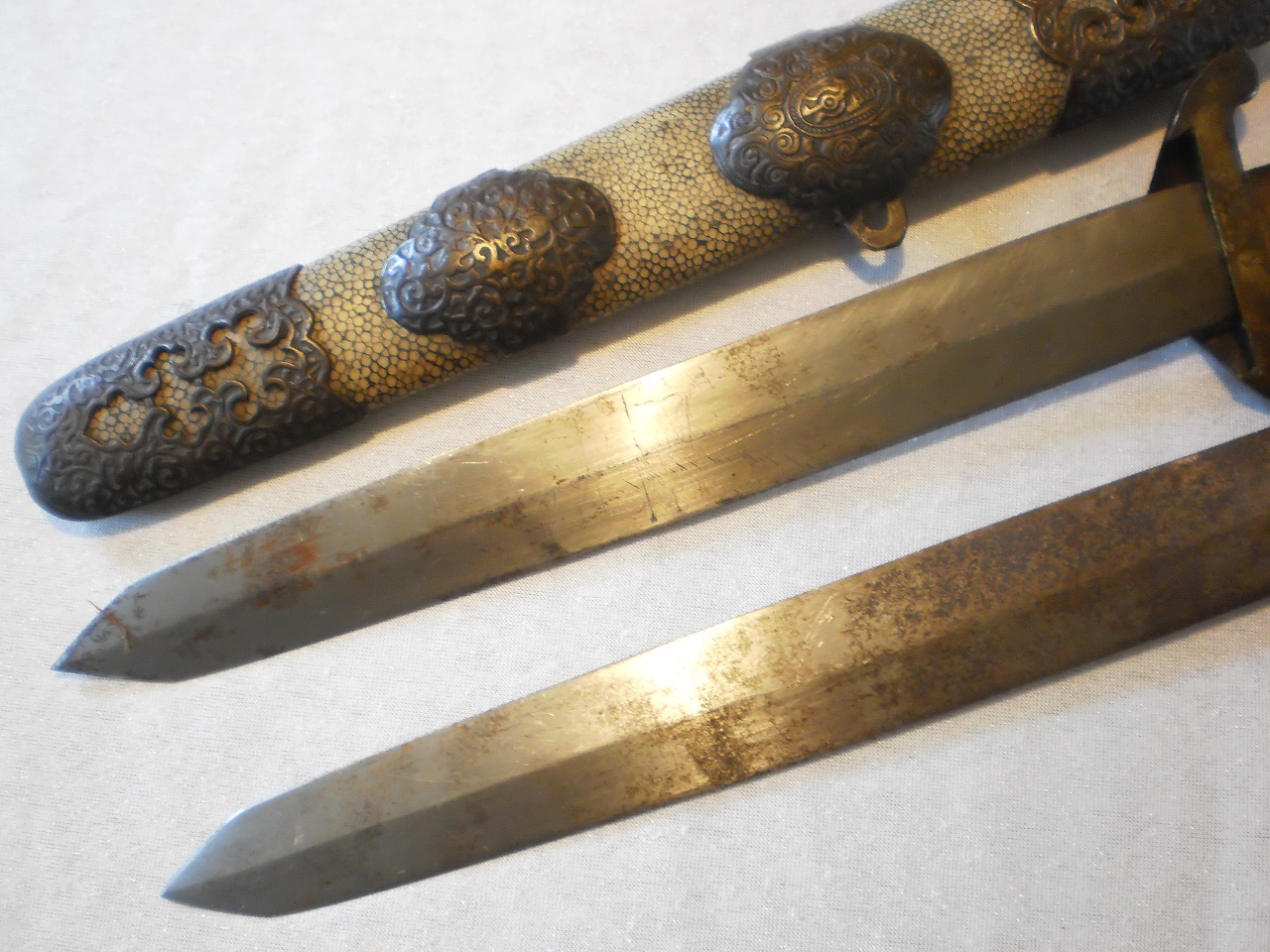

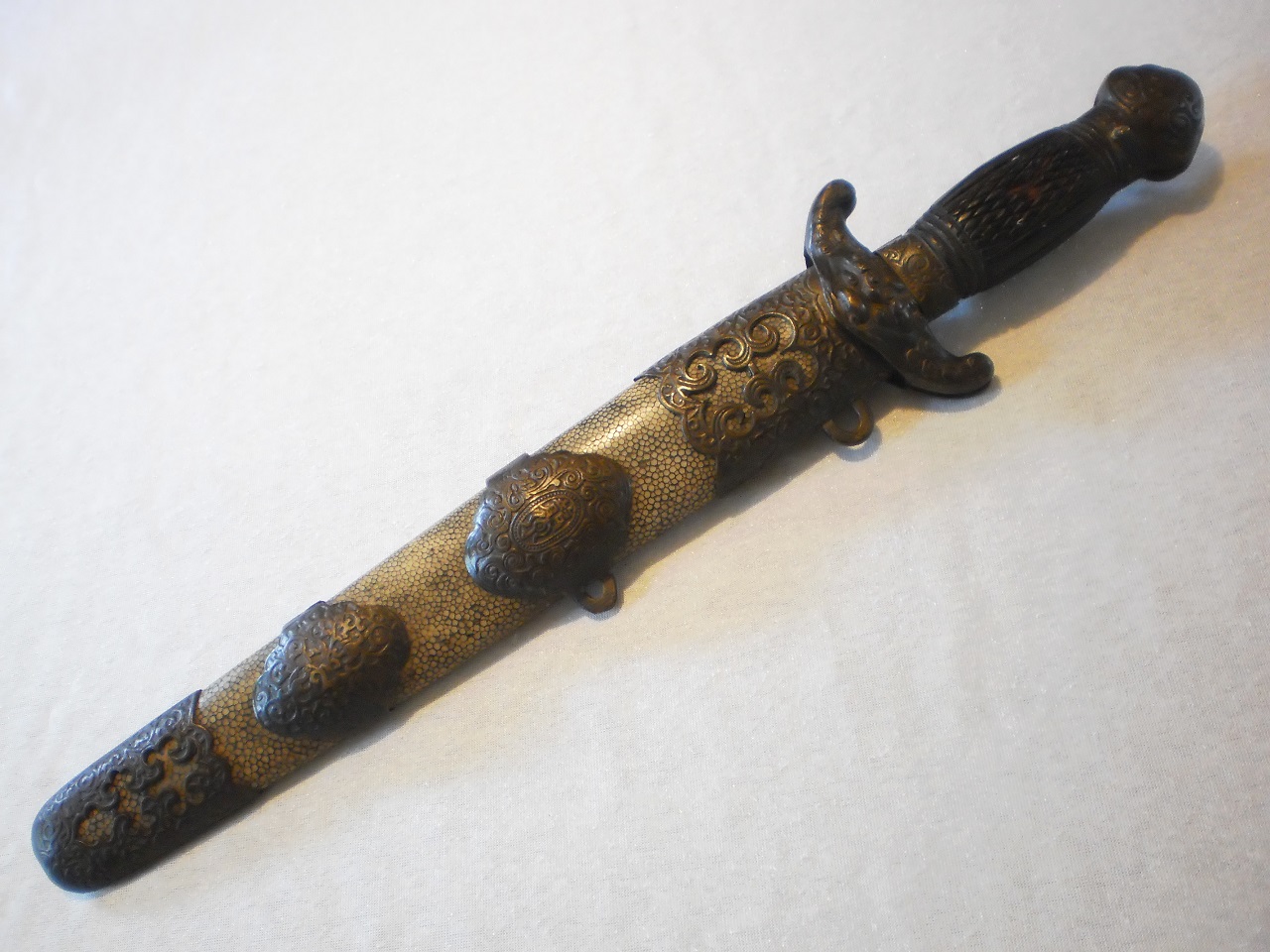

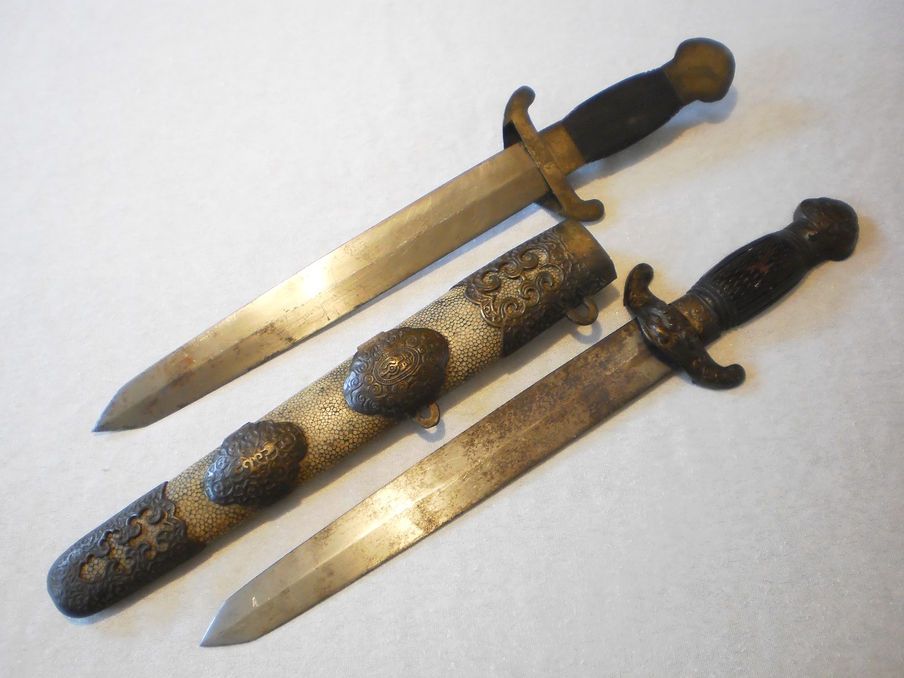

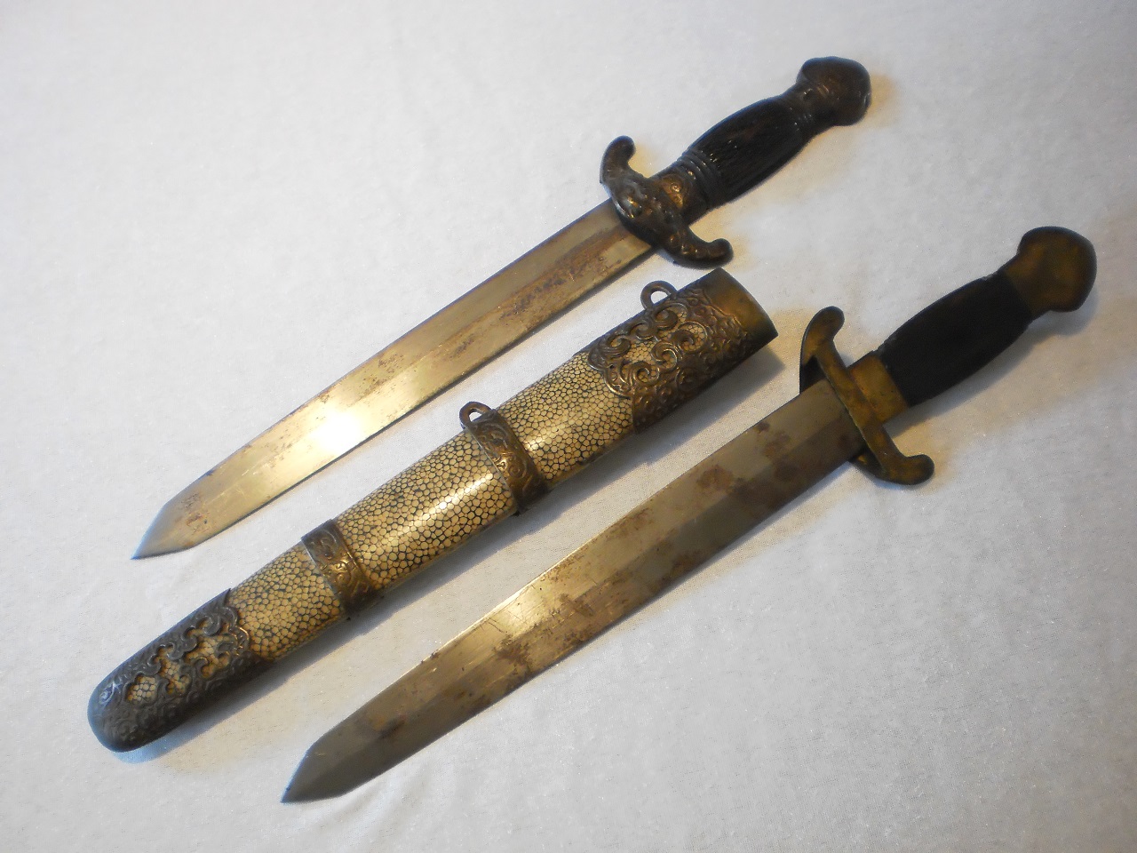

I'm a bit sceptical regarding the age, too. For comparison I show my chinese Jian-style double dagger, made around 1900. The blades are relatively simple but the blade of the showed sword is not the part I have a real problem with. The ray skin looks a bit strange to me, it could be an imitation. The quality of the bronze mountings is also not very good.
Original swords of this type or pieces like my double dagger were probably only "touristic" pieces for the colonialists in there time, so the quality claims were not the same like for an officer's or warrior's sword. But the showed sword is under the quality I know from such antique "touristic" pieces.
Robin

I will admit right up front that i know very little about this type of sword. But from simple observation it is clear to see that the fittings on Joe's Jian are rather poor for anything with legitimate age. We can clearly see the difference between what Joe has posted and the dagger that Robin has posted. And as Robin points out, even in 1900 when he estimates his double dagger from, these were most probably being made for European tastes.
I also agree with Robin that the ray skin looks a bit suspect on Joe's sword. The general quality of the piece seems low. It may be vintage, but i have serious doubts it is genuinely antique. Either way i suspect it's purpose was most probably not as a user, but a wall hanger.

Again, while I cannot speak with any sort of authority on these Chinese weapons, I do have what might be considered a 'working knowledge' of them from researches many times over the years.
I will say there seems to be a notable presence of 'souvenir' items in circulation, many of which do have notable age in that they were acquired in the 19th into early 20th c. Obviously China has restricted the trade or export of their antiquities for many years, so authentic items would have had to circumvent the normal channels (uh, not that this could not happen).
What I am wondering is, in all areas of production of material culture items and goods, is it not feasible that there were varying degrees of quality in items? With this being the case, perhaps makers with lesser skills tried to copy the work of other artisans in a kind of 'underground' setting.
If I have understood correctly, there were considerable restrictions upon civilians toward owning weapons, considering the constant presence of prospective insurgency, i.e. secret societies against the Qing rulers.
I have often heard of jian regarded as 'students' and that for some reason these individuals were allowed them, for reasons I do not know.

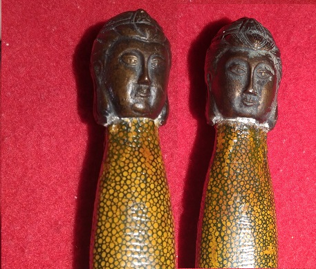

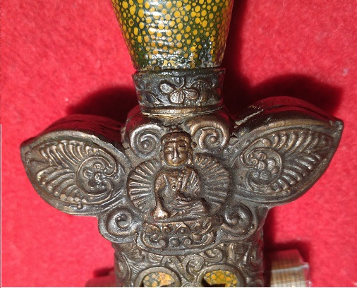

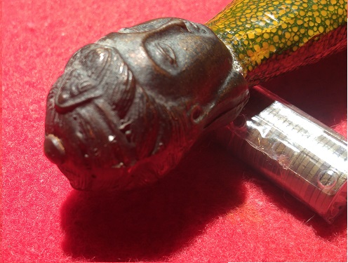

Regarding the example discussed from OP, it does not seem to me that Buddha was depicted in the elements of swords, and the pommel on this seems atypical. There seems to be a ferrule or some sort of element that should be under it to correspond to the one at the grip base.
It would seem that rayskin would be unusual to place on a weapon intended for commercial (souvenir) traffic. There are types of faux rayskin used in Europe since early 19thc. but this does not seem feasible for use when cheaper more effective materials would be available.
I have a saber which has an unusual tortoise shell material not commonly seen on Chinese swords, but it has been deemed authentically mounted, but likely for use as a gift possibly for diplomatic presentation. This may be a consideration here as well. The suggestion of Tibetan styling involved, as well as the presence of the Buddha, could indicate Tibetan production, and again, as I have understood, Tibetan artisans in border regions often produced weapons for Chinese overlords in a 'tribute' type arrangement.
Consideration of 'age' is also quite relative, and it seems there is a good volume of Chinese and Tibetan items which were acquired during the colonial occupations and travel in late 19th into 20th c. (1930s).
I think these factors are important to consider as we look at items such as this. To me, even souvenir items have some degree of legitimacy in the actual items or culture they represent. This jian has distinct character even with perhaps some flaws in its elements.
Just my perspective, and I look forward to same from those far more experienced in this field.
The 'butterfly knives' (shuangian=double jians) were not popular until early 1820s, but by end of 19th c. were used notably by so called 'river pirates' who were Chinese martial artists often employed as 'security' forces. At the end of 19th c. during occupation of China by European legations they were among the many types of weapon acquired by people there. Constant displays of martial arts using 'exotic' weapons intrigued the Europeans so they sought them for display in thier parlors.

I don't like shape of the points on those daggers.
my ray skin looks pretty much the exact same as yours, just with extra orange die on top. you can see some parts of my ray skin which don't have the orange, looks just like your ray skin if not older. could you tell me what looks off about it? the fittings do look very similar and a little better quality. I doubt mine is more recent than the circa 1900 tourist pieces.

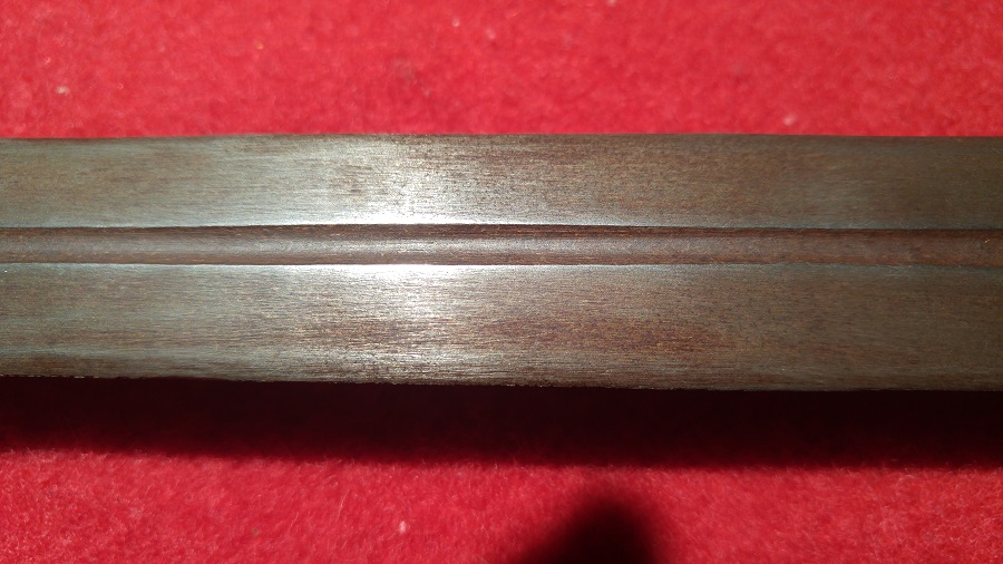

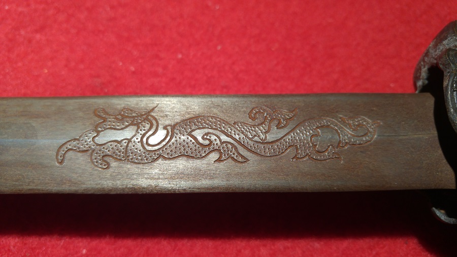

the blade on mine looks like a forged, fullered, carbon steel. my sword may have had new fittings put on for one of many reasons(maybe to bypass laws preventing sale of items over 100 years old.),maybe the original scabbard broke ,or original fittings were silver etc., I am thinking it may be a real weapon blade, made into a personal talisman sword, temple/exorcism sword or Daoist sword. Tibetan? (not for tourist) and I think the reason the fittings are crude is really just because its village made , and primitively made, maybe the master bronze caster just died. maybe the village fittings were more crude before perfected for the tourist market. they actually look pretty good compared to most plain simple 19c military examples.
I don't think my sword with buddha is military or meant for battle. but it would certainly work, feels like a quality sword.
anybody maybe know where this type of buddha face comes from? with the large earlobes, hair style, etc. also I notice a stain at the top of the fuller on both sides. any ideas what that's about?

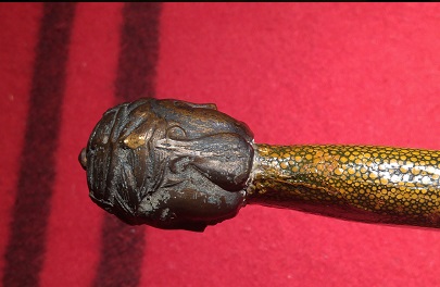

Jim I am not sure what you are describing about the pommel etc, and a corresponding part?
the pommel looks like it was pinned in place

That is interesting, would the Buddhist minority in Yunnan regions be due to other religion dominating, Islam?
In China and in Yunnan province in particular, Buddhism is not a minority religion. But most Chinese people follow Amidaism. The Thai and Burmese peoples inhabiting Yunnan adhere to a different direction - Theravada. This is the main direction of Buddhism in the countries of Southeast Asia. It came from South India in the 5-6th centuries AD.
P.S. The details of JoeCanada42 sword do bear some resemblance to the Theravada Buddhist depictions.

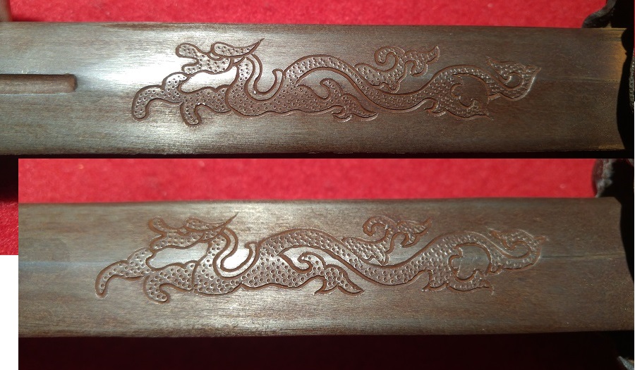

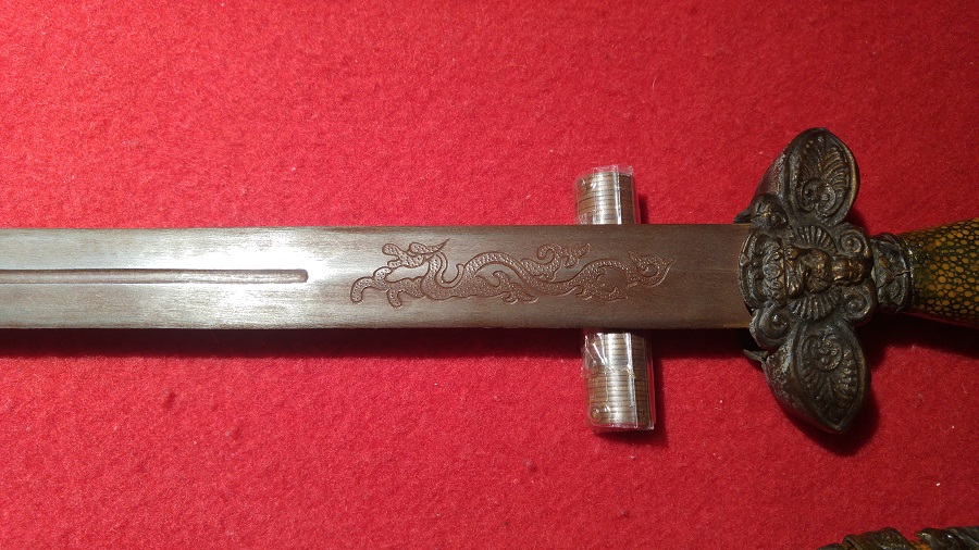

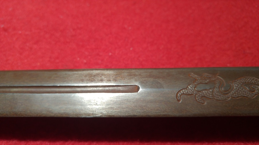

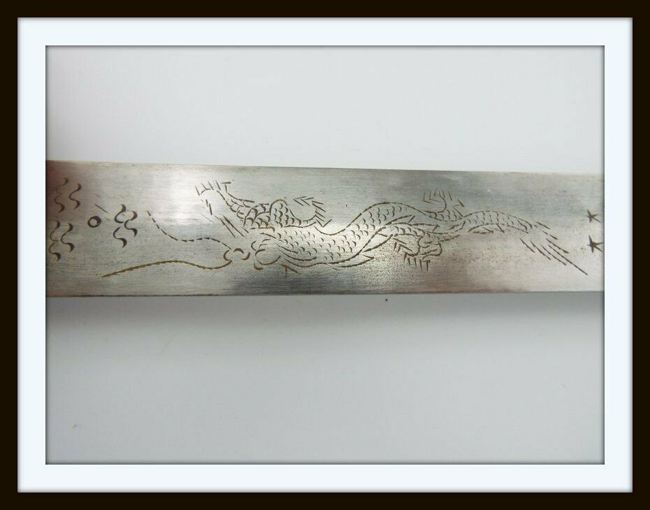

To me, the dragon engraving on the blade is not consistent with blades that I’ve seen. A lot of the recent reproductions went crazy with Mulan looking dragons on the blades, and Wild engravings of characters.
The casting of the fittings to me is crude, in my opinion, if a sword were to have such ornamentation, the pierce work would be exceptionally refined. Why go to such lengths to make a fancy jian, but only make rough work with the fittings.
The patina on the fittings seems off to me too.
The patina and appearance of the rayskin/sharkskin looks off.
I’m no expert in original pieces, but I have observed a huge amount of modern reproductions over the last 20 years. Mostly by photo.
I would wonder if a sword was real, then click on the buyers page and see what else they had. Only to see insanely grotesque caricatures of Chinese weapons.
In my opinion, if the workmanship is crude, then it will be crude throughout. So if having fancy Buddhist icons on it, it would be done impeccably, if at all. Crude pieces that are original are crude from head to toe. A refined sword would have no telltale signs of crudity, unless damage, or parts replaced.
That’s my take. I’m no expert, and I go by feeling still, until I become more astute at identifying the tell tale signs of modern fabrications.

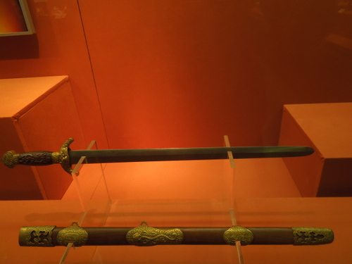

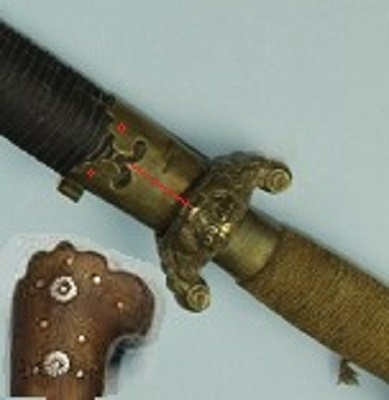

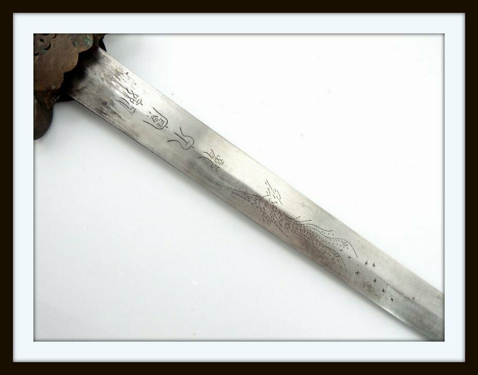

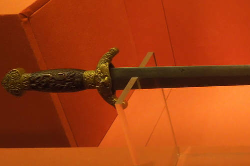

For comparison, here is something similar from the Chinese Sword Museum - unfortunately my knowledge is minimal and not much improved by my visit, as almost all text was in Mandarin.
The sword was however captioned in English 'Longquan Sword .Qing Dynasty'

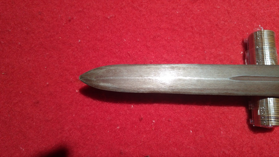

how about the blade of my sword? looks like its got a good distal taper, and everything else looks good to me.

I found this Jian awhile ago and wanted to share the images, as I was previously talking about the Jian bird and the sword.

also concerning the Jian bird and the sword I wanted to share this
