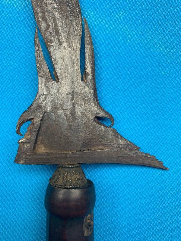

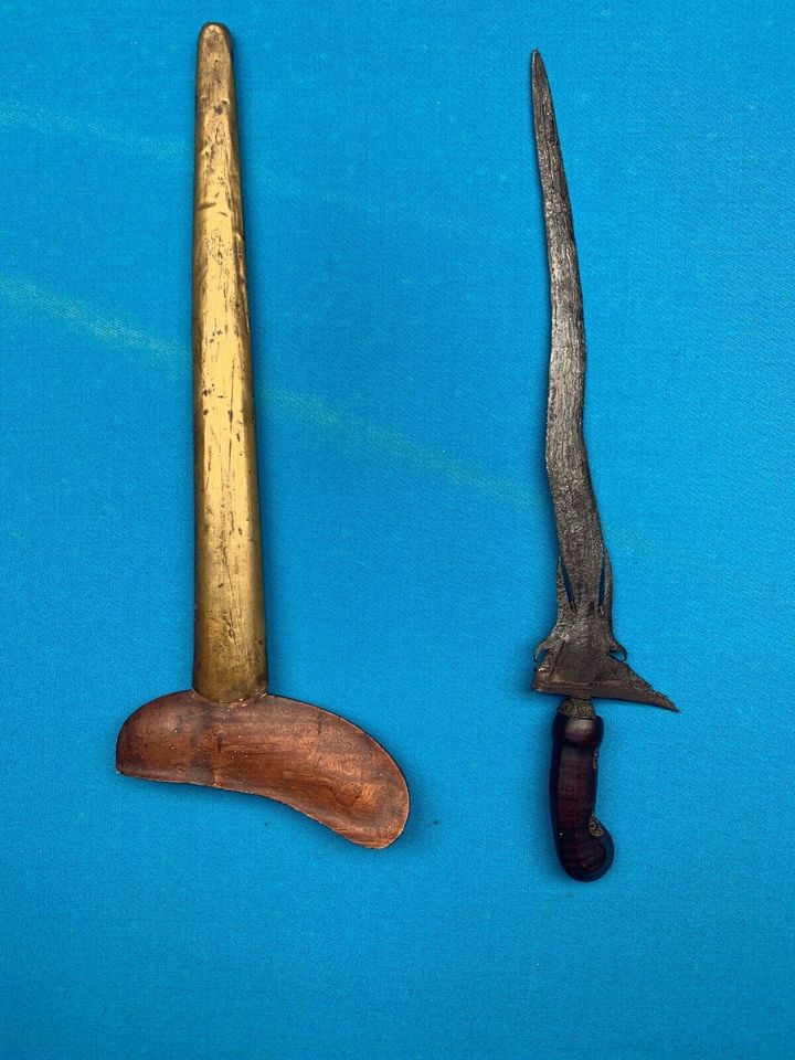

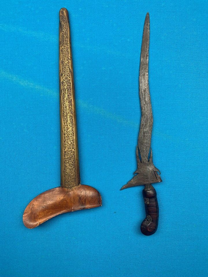

The last time I posted on here with help on a Keris, I recieved many helpful pieces of information and advice. Thank you for that. Today I won a eBay auction for another Keris, and I'd love to hear your thoughts on it regarding age and regional style. Personally to me, nothing really sticks out except for the complex Dapur. I have yet to see one that is as "Extra" as this one is. Again, many thanks for your thoughts and time...

I wonder if this is a modified blade. The work on the sorsoran is of extremely poor quality .
I have no idea of what dapur this may be called.

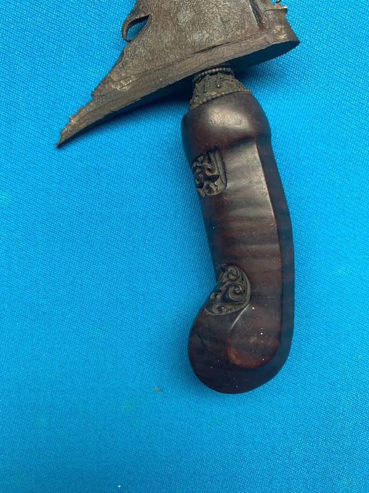

The mendak looks old and the wood of the ukiran seems to show very nice figuring in the grain.

mariusgmioc
mariusgmioc's Avatar
Location: Austria
Posts: 1,918
I don't know about kerises, but the two cuts were made at a later time by mechanical means (most likely by sawing or grinding).

The wrongko could probably use a gentle cleaning, it looks dingy in your photos.
There's no erosion of those edges of the cuts which I would take as evidence of modification done there.

Posts: 7,297
Oh, i have no doubt this keris was modified, and not with any particular skill either. I am sorry to say that this was most probably done to make a low grade keris more interesting for sale in the marketplace. You can find this as a legitimate dhapur which i believe might be called dhapur trisulo, but this would not be a good example of that.
IMHO, also the second kembang kacang (near greneng) were added at a later time.
Original Dhapur (before being modified) might be Dhapur Mayat.

Posts: 7,229
Yes, altered, what we call "keris robahan".
Originally this was a pretty reasonable village level keris, then somebody took to it with an axe --- well, maybe not an axe, but a file or hacksaw or something. Pity.
Ive seen this alteration done to better quality keris, and done skillfully, and they don't look too bad, but this alteration has been roughly done.
I do not know this form, nor anything like it as a legitimate dhapur, but Dhapur Sategal sort of comes close.

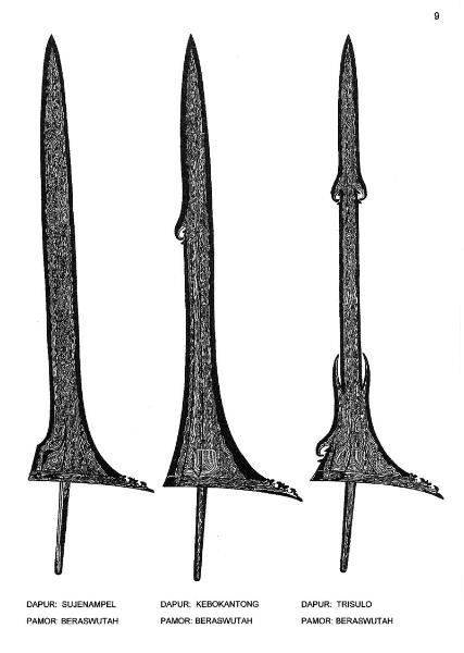

David, I've never heard of Dhapur Trisulo for a keris, where did you pick up the name?
I hate to say that i am uncertain which book these dhapur drawing come from. I believe they may have come from Empu Djeno. I don't own the book they are from so i can't confirm that. Anyway, i downloaded a bunch of them off the web a while back. The one called Trisulo is a little different, with two kembang kacang near the tip of the blade.

Isn't the handle on backwards?

Thanks David.
Yeah, that looks like it comes from Pak Djeno's dhapur sheet:-
http://www.kerisattosanaji.com/DHAPU...NGTODJENO.html
I regret I cannot make a favourable remark here, so I'll say nothing.
Yes it is. A 180 degree turn would set it correctly.

Thanks David.
No worries Alan. I was simply trying to establish that at least some people see this dhapur as a legitimate one. I don't know that i have ever seen this dhapur on a keris that was originally forged this way though. I've personally never been fond of this type of alteration.
